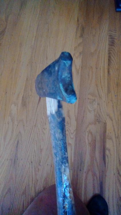

What is the name of this top fuller?
evfreek replied to evfreek's topic in Tools, ID, and pictorial reference
Hi Frosty. Thanks for the reply. It does look like it would be good for fullering pipe, like for a candleholder. I prefer a spring fuller, since I usually work alone. A search on "pipe fuller" mostly turned up spring fullers. Anyway, I was curious if there was a proper name for this tool. -
Hi. I found this tool at a garage sale, and the seller didn't know what it was. I know what it is, but I don't know what it's called. My name for it would be "fork fuller" for obvious reasons, but that's not the correct name. I don't see any of these on eBay. Does anybody know what they are called?
