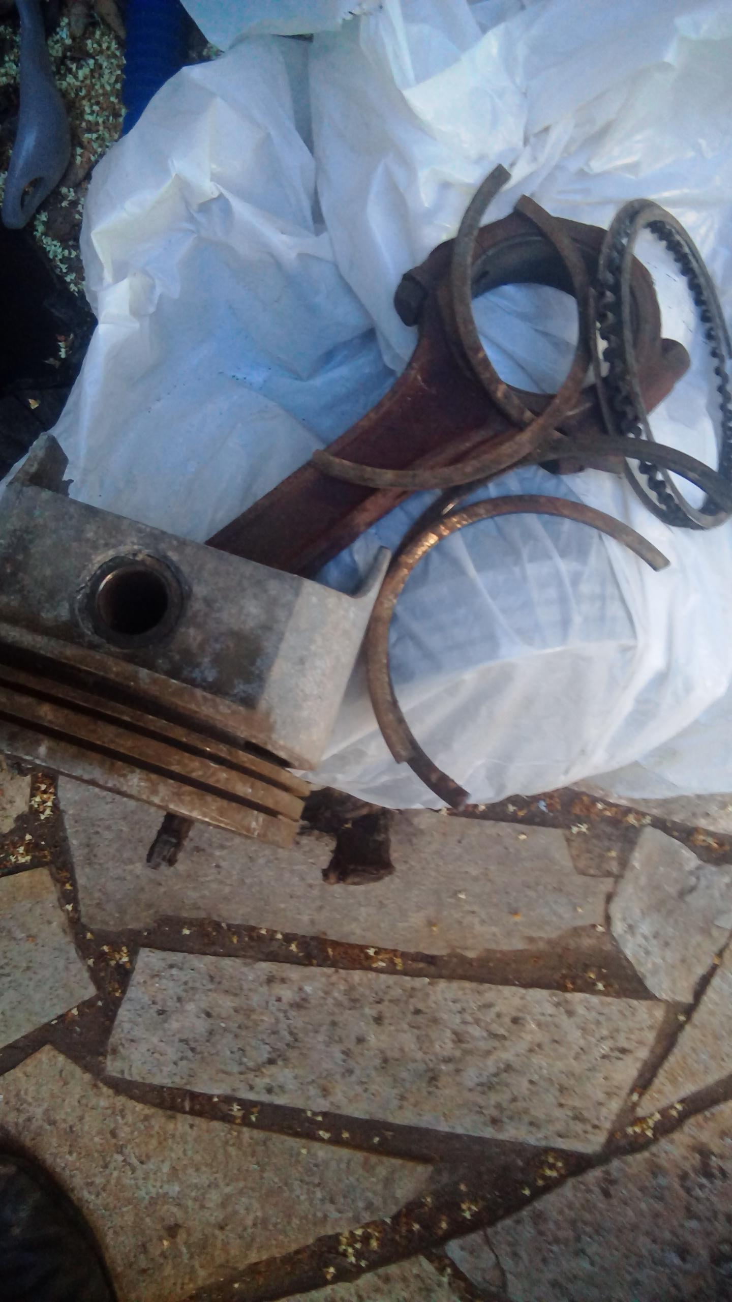

I looked extensively at Craigslist and EBay, but only found expensive new rings. I've never seen these at garage sales. Then, at a storage unit clean out, I finally succeeded. They were seized and brittle, but I managed to break a couple out. They spark tested as cast iron, so that's good. They seemed a little hard, but a file will cut them. The third ring groove had a wavy thing and two thin springy rings which sparked as spring steel. I guess I can repurpose the pistons as pistonium as soon as I get a foundry setup working. Thank you for the suggestions. I'll report back on how well they work, but I have seen good results reported from the web. -

Wow. I overhauled an engine once, and just threw the old ones away. I don't have any friends who do this now, since the engines last so much longer. For now, I'm going to just use old pieces. But I will forge a tiny pair of tongs to feed the pieces since pliers don't work well and aren't safe.
