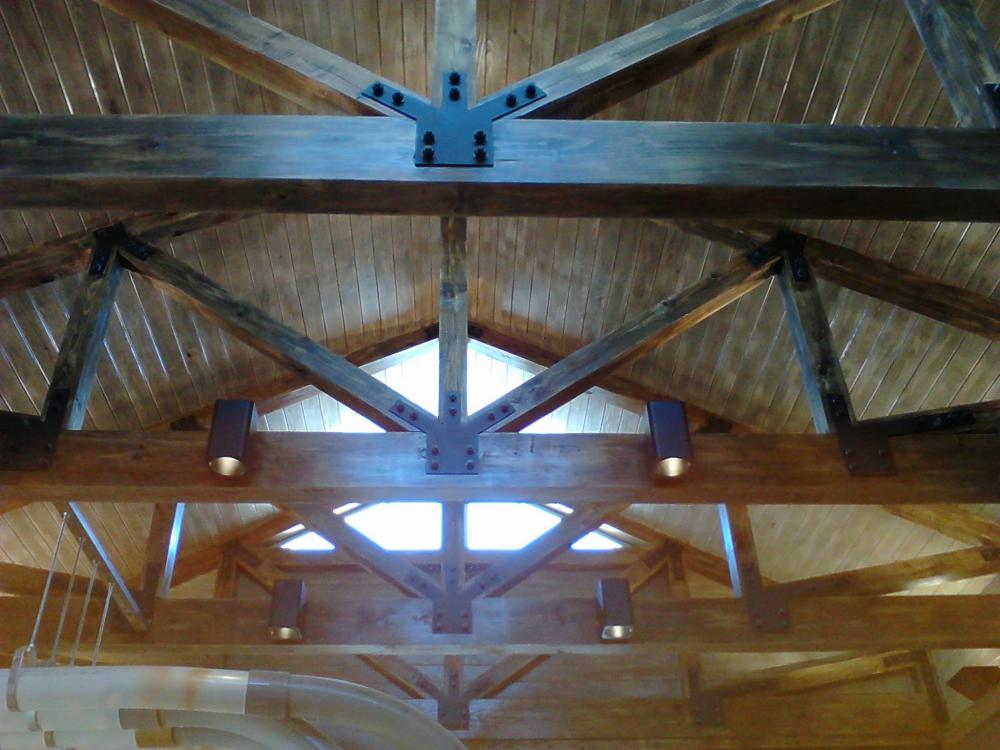

anvil Posted December 20, 2018 Posted December 20, 2018 (edited) #23: proper setup, proper tools, proper job. Clean all the boogers and traps from your workspace, then figure out what stock, rivets, collars, detail,samples, tooling, full size drawings etc you need. Then make any needed tools and make sure all needed are functional and ready for the job. An example of the latter is say nuts and bolts. In my shop, these are not consumables. They are used as tools to hold my work together then each are replaced by a rivet. So, it's a real xxxxx to start assembly and have the nut or bolt hang on bad threads, so I always run a tap/die over the threads to clean them up, and make sure they are straight. Edited December 20, 2018 by Mod34 Edited for inappropriate language Quote
