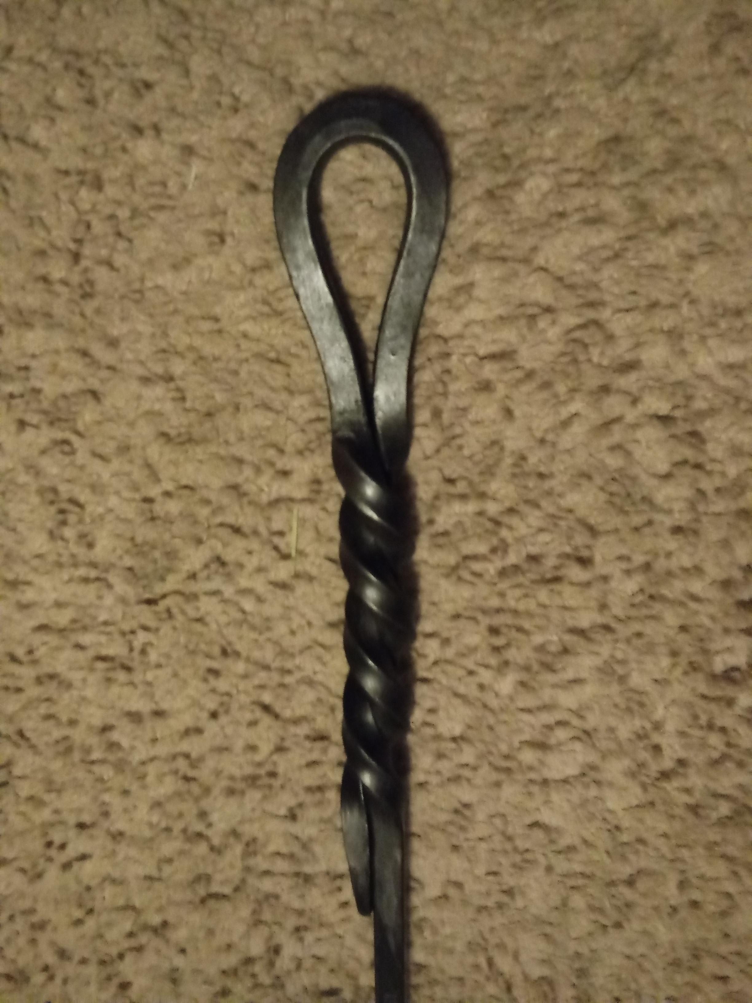

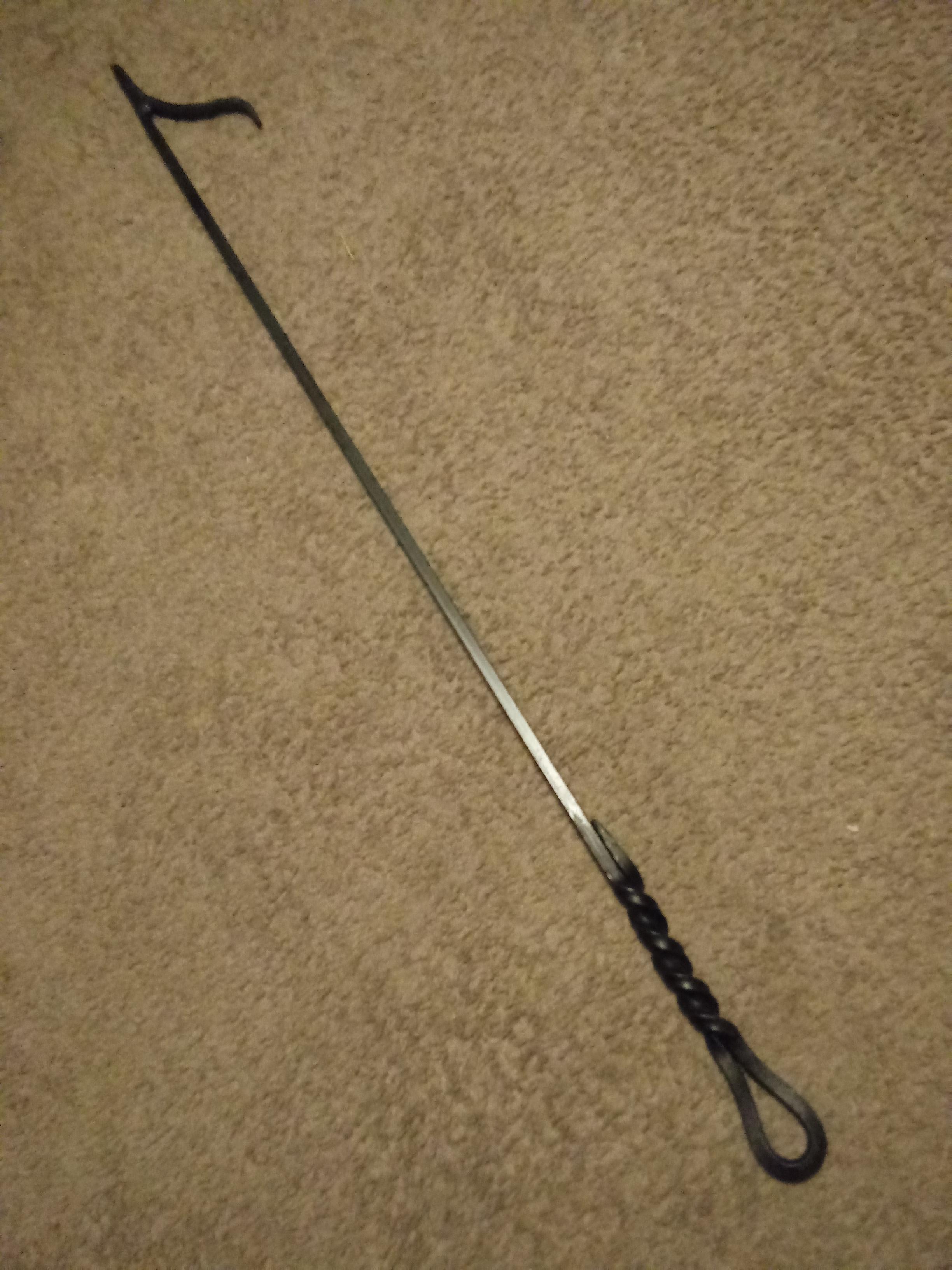

Nothing new or exciting here, but I'm actually happy with how this is turning out (which might be a first :rolleyes:). I need to do some cleanup on the tip and I plan to twist a 4" section or so near the middle for a little visual interest. I'm also working on a shovel and ash rake for the set, but progress is slow. Material is 3/8" square HR.
20190409_193709.thumb.jpg.76df0f781c747f00d1cd3c6e87c5577d.jpg20190409_193643.thumb.jpg.63cbb3b92797376a4825e866f2d49558.jpg
Looks good Snuffy, I really like the handle, it came out very well.
SFC Snuffy, My compliments on that handle. Well done.
snuffy well done indeed..  I've never done a twisted handle like that.. I might have to give it a go.
On that note I have 1 or 2 more handles to make..  here is a compilation of the last few all together to make it look like i've been really busy...
Snuffy, that's a really neat poker. The twist in the middle will add interest. You have a lot of room there - how about a reverse twist?

ausfire,thanks never even thought about the number of handles.. Just want concepts I wanted to see come to life..
 the reverse twist is a great idea...  the visual will be nice..
