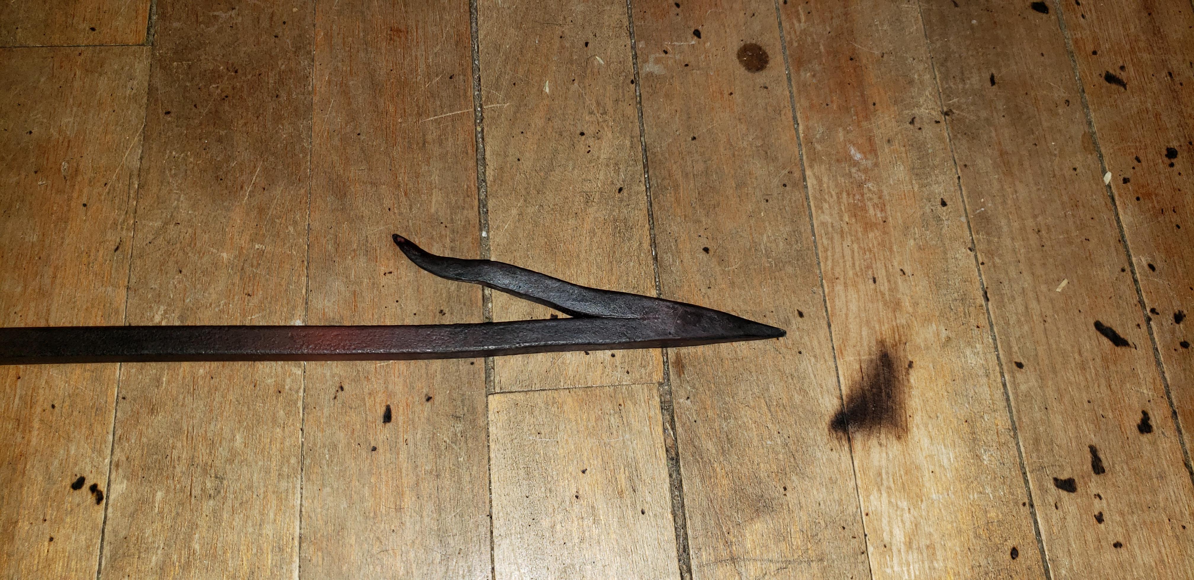

Forged another longhorn poker. I usually forge the puller on the end of the poker on the left at right angles to the bull's head. That gives the poker a right-handed use. With this one I folded the head without lining up the point and it has the tang on the poker end vertical when held.
I could easily have made a twist in the shaft to align it in the usual way, but it seems to be perfectly usable in that position. It only takes a small rotation of the wrist to have the puller on either side.
OK, so what do you guys do? Do your fire pokers have the piece that you fire weld back on the left, right, upright or what?
Sorry about the poor photo. Bit hard to get the depth of field along the poker, but you get the idea.
Nice job Aus, often the part the item has to play dictates the relationship of motif to handle eye, and also the working end alignment,
Things to take into consideration are
Is it a seperate item,
If it is to be suspended how and where, it could be vertical on a wall, part of a companion set, laid down or on andirons,
All situations have a bearing on the design being used.
To sum up, position is relative to function, make them to suit

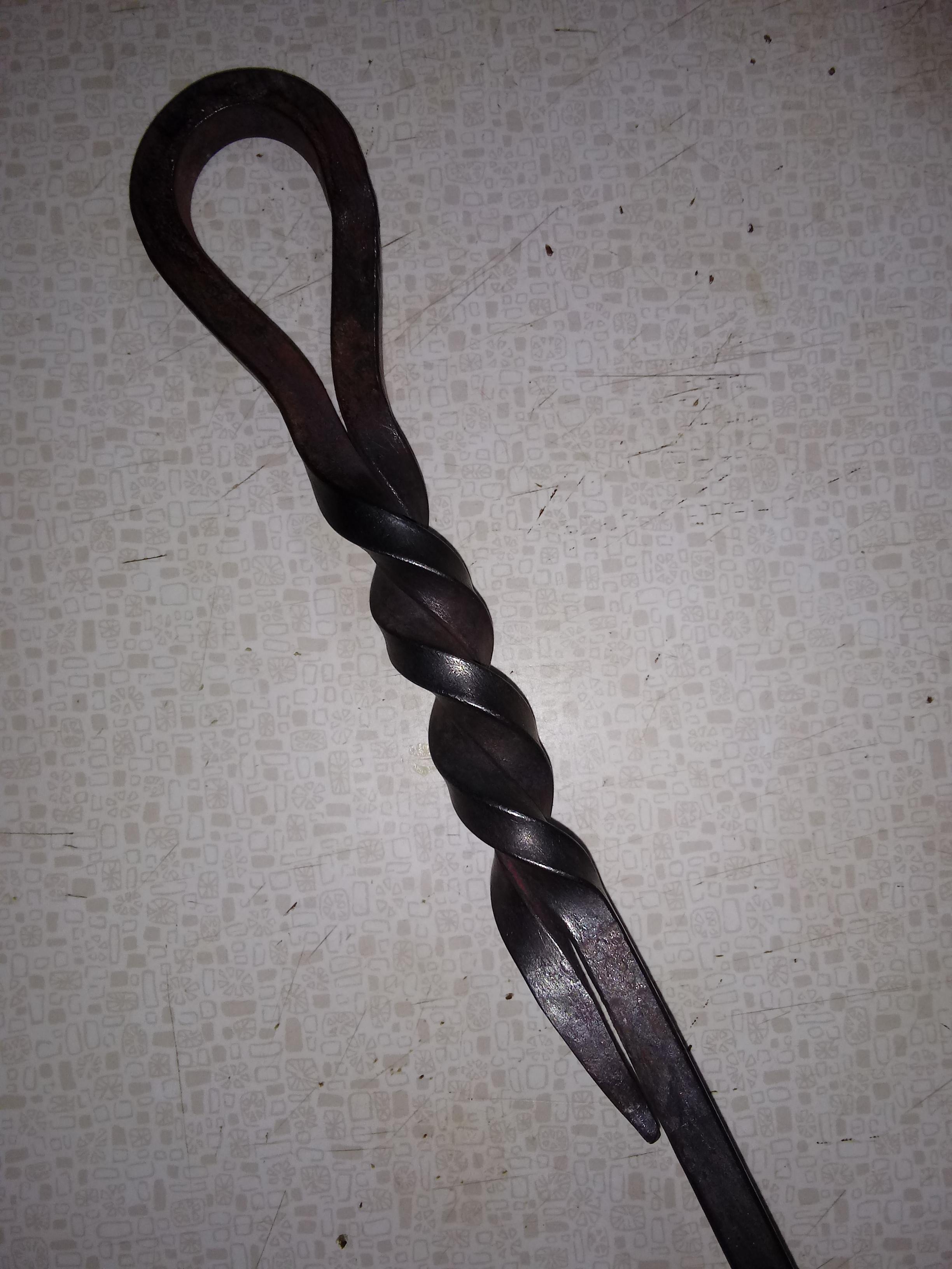

I could use some virtual tutelage and opinions from you more-experienced smiths. I'm using 3/8"-square HR, and aiming for something like the twisted handle John B. showed on page 3 and described on page 4 (and that ausfire put his own excellent spin on, above).
This is what I ended up with:
20190226_184626.thumb.jpg.f6da7e1efb70b6ce205c5c897a1ad739.jpg 20190301_195417.thumb.jpg.c81682a2156a877c642629e873e55600.jpg
And while it isn't *bad,* per se, the loop is a bit misshapen. I had trouble getting the punch marks aligned, and real trouble getting the loop into a symmetrical shape. I've got a pretty basic bending jig... maybe my heat wasn't even? Maybe I didn't isolate/freeze the right areas? Do I need different or better tooling? Maybe I just need to do it a dozen more times for practice... sigh. :unsure: Any advice would be greatly appreciated.
Below is a pic of my bending jig. I have a few other sockets, but I was aiming for roughly a 3/4" ID loop.

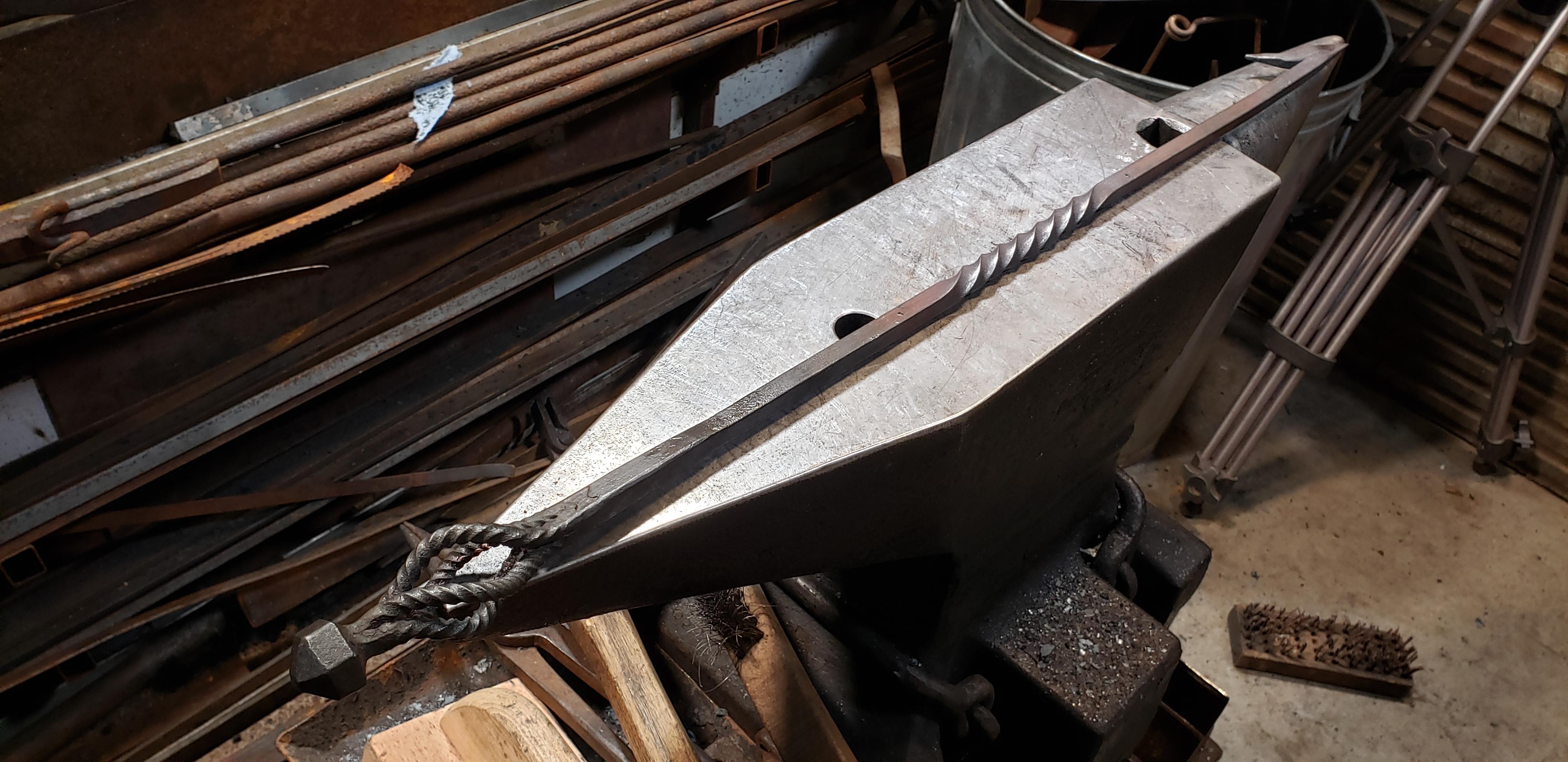

After a discussion with a fellow smith over low count handles and not having the same character as higher count baskets.. This was one sample i did to show there can be another type..
i did a how to video on it but used a new video software and the whole edit of footage was no good.. it won't sync the dual screens..
Have to do it again..

Hi Snuffy, Nothing wrong with your loop shape, it's a forging exercise, not a ' make the same'  its also from a different sized material so different parameters are in place.
The adage usually is   If it looks right, it is right,   and then its down to your own standardsperfection is nigh on impossible at this craft.
You used a bender arangement, I don't, just the anvil, hearth, hammer and a leg vise.
Method is
Mark out for end length, mark out for circle circumference dimension and centre punch at these dimensions
Forge the end taper with the punch marks to the side so you can see them when bending.
Take a heat at the centre of the circle dimension and over the anvil,  bend into a U lining up the punch marks
If the punch marks are not in alignment, use the leg vise to individually adjust them to align, keeping the U shape,
When they are in alignment, reheat and bring the  tip of the taper to touch the long edge. Place in the vise so the punch marks align with the jaw ends and tighten vise to make the pieces come together, this will give you a loop/eye on the end.
You can adjust the shape of the eye by using a soft faced hammer/mallet to make to a rounder shape or whatever shape you like.
(Strike the end to push the sides out reducing the teardrop shape to a fatter one until round or what you like)
Then when you can live with the result, reheat and twist the handle section
The forge the other end to whatever you want there.

Here's 1 I did today for another "how to" video on basket handles but think it might be more than most can handle..
