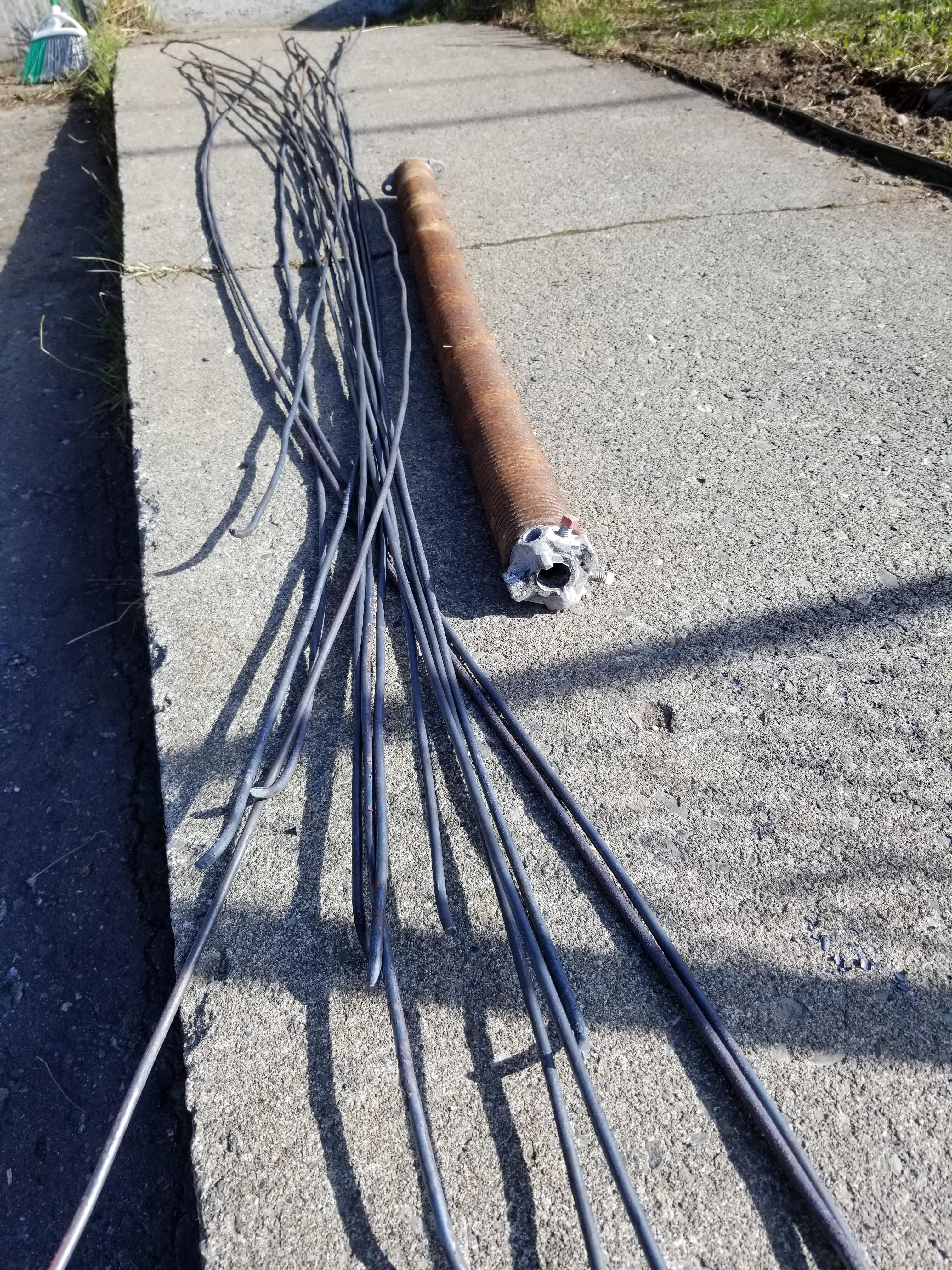

bajajoaquin Posted August 24, 2018 Share Posted August 24, 2018 Posed a while back in the "It Followed Me Home" section that I saved some garage door hinges and springs from the alley. However, now that I look at them, they're of course a small diameter wire, so of limited use for punches, drifts, etc. What other uses are they well-suited for? Forge welding into billets for pattern-welded steel is the only thing that comes to mind. Quote Link to comment Share on other sites More sharing options...
Zrognak Posted August 24, 2018 Share Posted August 24, 2018 Not exactly sure how thick they are but are we talking like 1/3th of an inch or 1/4th, anyway either way if they are 1/6th of an inch I could still use em myself, since i carve wood and other things I would forge carving knives out of it, as well as small chisels and other carving tools, maybe even make a touch mark or two for smaller projects. Quote Link to comment Share on other sites More sharing options...
Glenn Posted August 24, 2018 Share Posted August 24, 2018 Do not put it in a box and call it spring. Dump it out of the box and think of it as metal. Quote Link to comment Share on other sites More sharing options...
George N. M. Posted August 24, 2018 Share Posted August 24, 2018 I have used 1/4" garage door spring to make fire steels. However, I have seen some that are an odd alloy and do not harden well. Also, if you re making them for sale make sure you give the customer a piece of flint with each fire steel. It's no fun to buy a new toy and not be able to strike sparks from it. Also, you can use this size of spring steel to make a nice little bodice dagger. Quote Link to comment Share on other sites More sharing options...
ThomasPowers Posted August 24, 2018 Share Posted August 24, 2018 Chasing and Repousse tools! Chip carving tools! Springs for your treadle hammer? Quote Link to comment Share on other sites More sharing options...

teenylittlemetalguy Posted September 1, 2020 Share Posted September 1, 2020 I like to pull them out into a generally straight configuration so they are in the rack and handy when I need them. they are not perfectly straight so I know what they are. Anytime I need smaller stock I use them, very handy and you don't have to harden it. I have all kinds of small brackets made out of it. I can straighten about 10' at a time by myself in one heat. Quote Link to comment Share on other sites More sharing options...

Latticino Posted September 2, 2020 Share Posted September 2, 2020 Per the OP, I have made some rather nice knife tang hand broaches out of standard garage door springs. The ones I had hardened very easily, but they weren't a lot of fun to forge since they were such small diameter that they cooled extremely rapidly. I think mine must have been smaller springs, perhaps from residential garage doors. Quote Link to comment Share on other sites More sharing options...

johnnyendeavour Posted October 23, 2023 Share Posted October 23, 2023 I have a bunch that is from larger shop doors - the 20' wide sort of doors, so the springs are 6" in diameter or so. I've made small prybars, handles for garden tools, plant hangers, and just had fun testing different twists. Though about making some 'wands' for the harry potter types.... I do find as soon as I've tapered it down or flattened it then it is tricky to work as it cools so darn fast and is tough stuff. One coil I had was square which was better. I've been wondering if I could use a bunch of the circle shapes in a gate, table or similar piece without much forging at all. Quote Link to comment Share on other sites More sharing options...
Frosty Posted October 23, 2023 Share Posted October 23, 2023 How large is the wire in the coils? Being around 60pts. carbon spring steel is good for most hand tools needing that dia. stock. Or is you normalize the piece when you're finished making the . . . thingy it will behave like stronger than normal mild steel. I used to pick up coil springs when I say them, the overhead door springs I have have coils just under 4" with wire almost 1/4" dia. I use it where I need something stronger than mild or for scribes, punches, chisels, etc. It's all round good stock to have on hand. I don't use leaf spring very often and haven't brought any home in probably 25 years. I don't let people drop any off anymore either. Frosty The Lucky. Quote Link to comment Share on other sites More sharing options...
