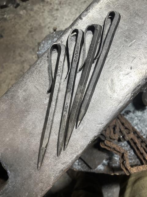

From last Christmas, I made a pitch fork from the garage door spring then made a few of these from floor scraps.  IMG_6445.jpeg.06ab3056b50044ea35b0a64c045fa426.jpeg

I made up a bunch of these scribes as giveaway items over the past couple years:
The wire diameter of the spring was maybe 5/16” with the tip water quenched for max hardness. Just a couple coils straightened out went a long way… I’ve also welded bits into the cutting edge of chisels that were made out of larger diameter garage doors springs.
Garage doors springs also make really strong S hooks. Basically, use it in place of mild steel whenever you want more strength, but a delicate look. Just remember to normalize (and not to quench the pig tale scrolls on the ends of a hook before bending like you would with mild steel).
