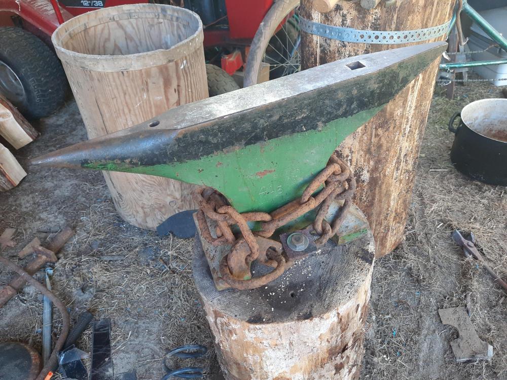

  10. I had reason to disassemble a small engine a while ago and salvaged these counterweights. Judging by the spark test they've got a decent amount of carbon, so my mind goes towards edged tools. In particular, I'm wondering about an adze (I need one in any case)but not sure if I'm letting a superficial resemblance trick me into a fool's errand. Any ideas folks? Anyone bashed on one of these things before?
  11. Jlp : she weighs in at 41.5 kg and measures 67mm wide and 61cm tip to tip. There's also a stamp "1912", but I don't know if that's when the anvil was made, or the original pattern design or the company (Söderfors) start date. Any ideas? Frosty : thanks! After your warning I looked around a lot for ideas and this was the result. We'll see how long it lasts, but with only two screws it's not much bother to make adjustments.
  12. Nothing fancy, just wanted to celebrate having finally got my anvil attached to something! A proper old piece of chain, complete with shackle which we dug out of the forest last autumn turned out to be exactly long enough to wrap around twice. A couple of square plates and washers, two longish (could be longer) coach screws and two layers of roofing felt have turned a deafening 'TING!' into a much less bothersome 'clonk'. I won't dispense with ear protection but it might be nice to use something a bit more comfortable than my chainsaw helmet
