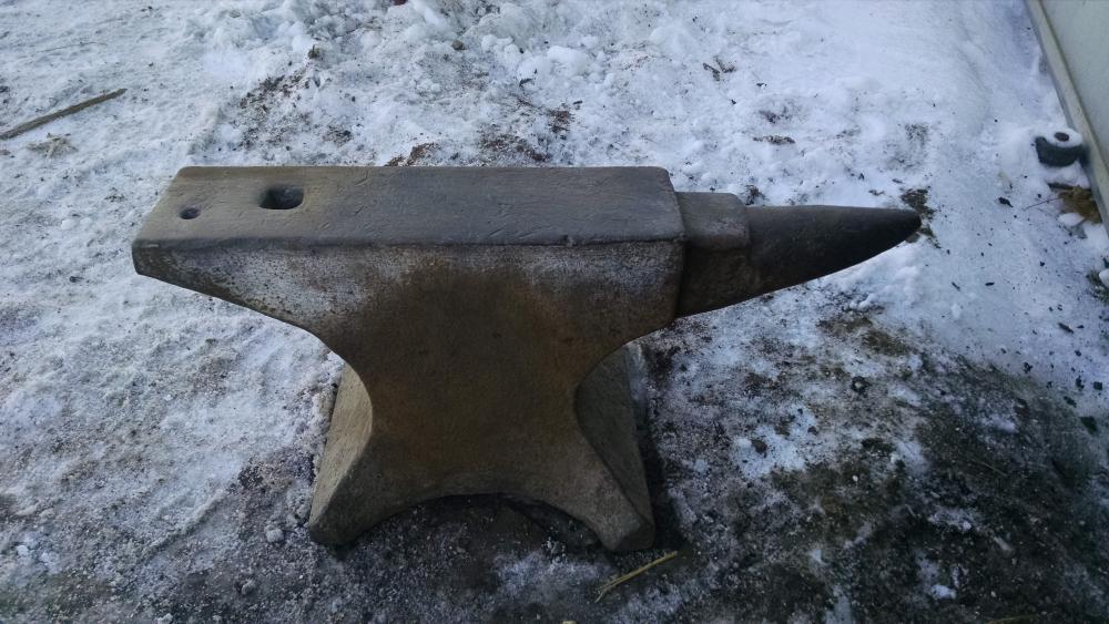

  14. The Anvil weighs around 175 pounds, I think the middle number is a 2.
  15. So I took a better look, on one side it has the numbers '1' '?' '5'. On the other side I think I can make out OL then underneath that HOL.
  16. Ok thanks Thomas, I will have a better look tommorow and write down what I see.

  18. Hello guys, i picked up this anvil for a good price this weekend. I cleaned it up with a wire brush and can only distinguish a few letters and no numbers or words. I would love some help itentifying it if its possible just by visual qualities. Any help is appreciated. Thanks

  22. Hello Frosty, thank you very much for your wisdom I'm going to heed your advice and just work on it how it is. I think there is a couple of decent flat spots on the anvil that I could use. Do you have any idea the age of this anvil?
  23. Hello guys I need help identifying the age and material that this anvil is made of. I picked it up at a barn sale for a pretty good price, its got some damage on the face and sides and I was wondering what I could do to fix it up. How deep are these old anvils hardened? I need to take off a good 1/4" from the face to clean it up, could I get it milled down? Thanks
