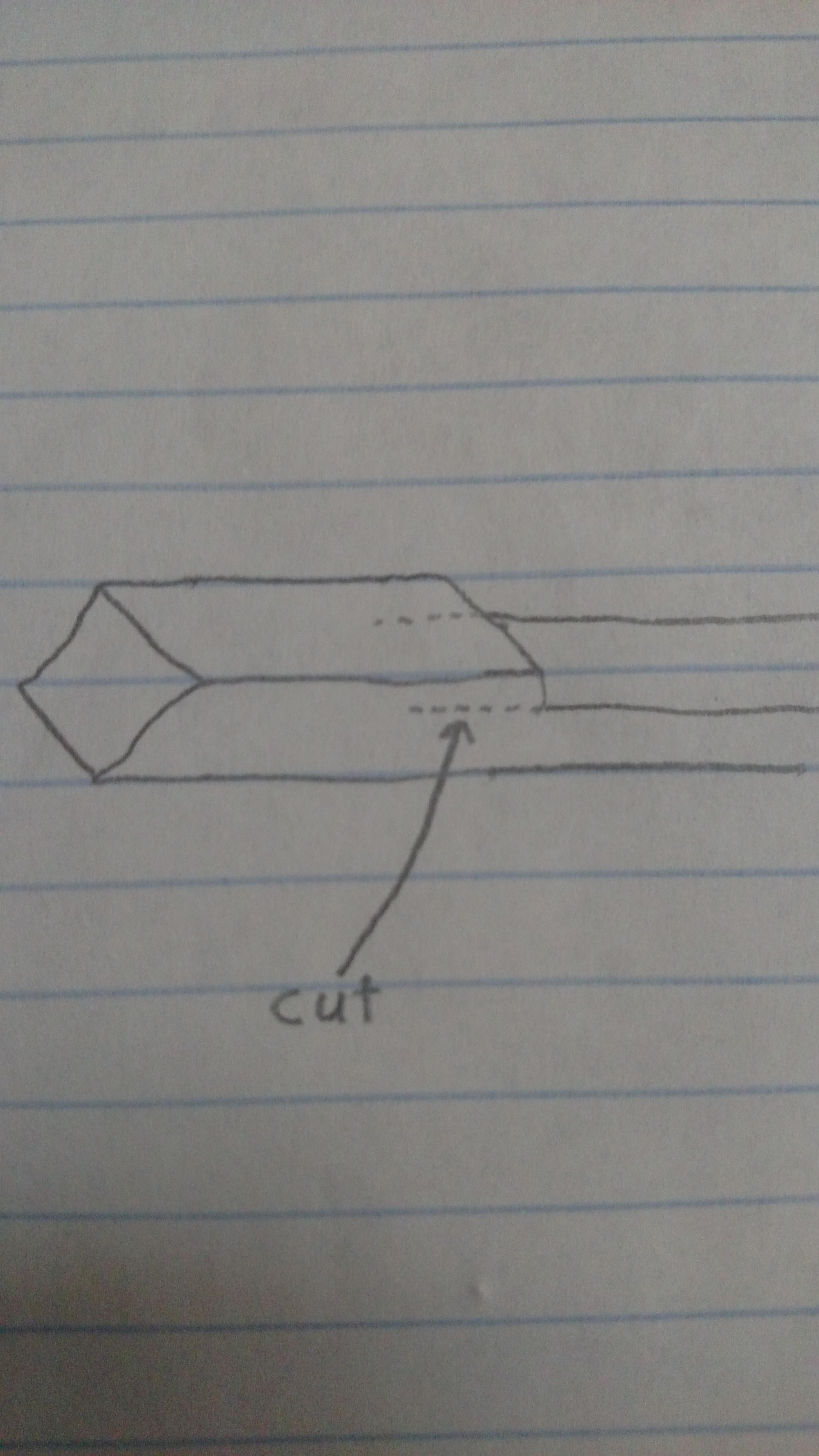

Was thinking this is how I will do it next time around. For this I made a set down and left about 2 1/2" untouched on the end of the bar. Took a grinder and cut into the untouched material to make the horns. Hope the drawing illustrates it to make sense.
No,no,no, split out and rough forge the horns FIRST, then fold over for the head. don't forge them thin but rough them out enough that when you get the head folded and forged close to finished you can then spread the horns and forge them thin and pretty. You don't want to forge the horns to final size before doing the heavy sections or you're much more likely to burn them off. However it's so much easier to forge a shoulder, draw down and split an inch on the end of a bar than it is to try cutting, spreading the fold as you illustrated, (I started to write "drawn" and realized that could be confusing the issue) THEN, drawing down splitting and finishing horns.
Rough the horns first and save the fine details for the final steps before brushing and finishing.
An eye punch and small curved chisel for nostrils improves the appearance too.
Frosty is describing better than I do but his way is what I mean. In case you want a thinner neck it is easier to fuller that down before you bend the head. I do it this way starting with stock twice as wide as thick. There are good descriptions with picks on the net but I cannot find the URLs
#1 Split the stock at the end approximately the intended horn length but do not start drawing out. (They will become longer but i is easier to cut than to lengthen).
#2; Fuller the neck to square section. The distance from the split about 2,5 times the length of the intended head
#3: Bend 180°in the middle between the split and the neck and forge weld.
#4: Shape the head, put in nostrils and mouth and make a slight step in front of the horns for the eyes (or do not). Put in eyes. For a dragon's head one can set up the mouth end and/or fuller a little between nostrils and eyes and create a forehead for the eyes by making the step.
#5: Bend the neck after shaping the head. It is easier to fix it in the vise (or on the anvil) and put in eyes etc before bending the neck
#6: Separate the horns (which are now free), draw out and shape them. Doing them last this way  decreases the risk of burning. They are also thicker at the base so some heat comes fom the head.
#7 Finishing touches.
Frosty and gote, thanks, doing it as you guys described sounds much easier than the long process I went through. You are right that spreading the horns and then drawing them out was difficult, what I did was just what I came up with in a spur of the moment "I'll try making a longhorn". I'll probably try another in the next few weeks, thanks for the advice.
