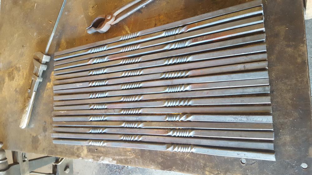

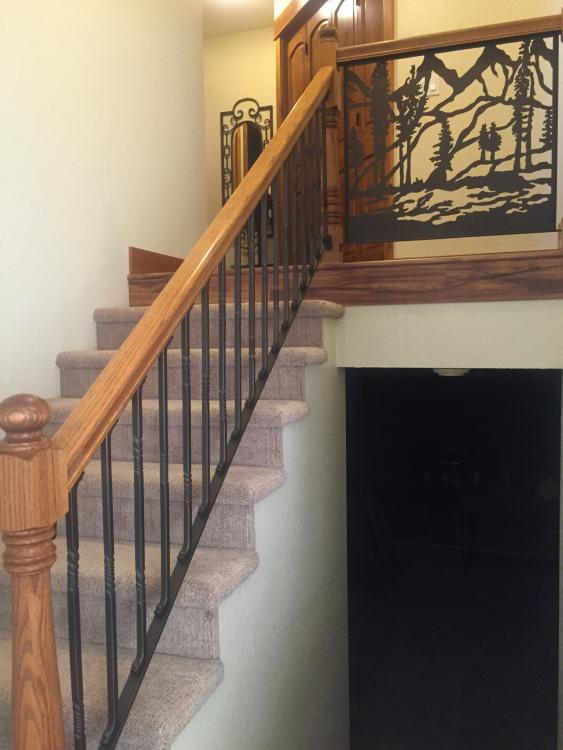

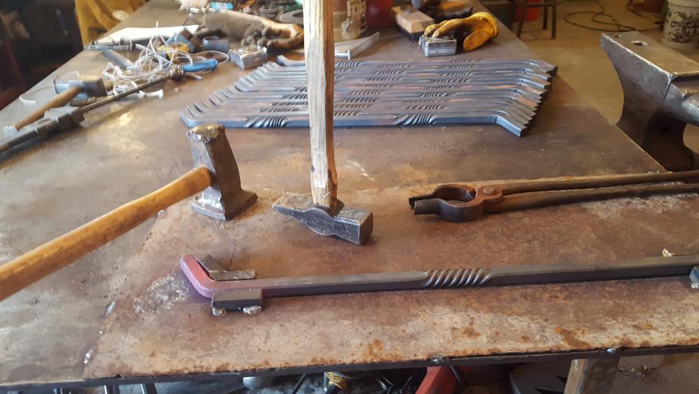

  7. This is a hand rail project I wrapped up last week. The pickets are 5/8" solid bar. I broke the edges and hand twisted. The pickets alternate one twist or two twists. I riveted the pickets to the top and bottom rail, but blind plug welded the bottoms of the rivets. I needed the top to be completely flat to fit into a groove on the wooden hand rail. I also wanted a slight amount of flex so the railing could be slid into place. I had the works powder coated an oil rubbed bronze. Comments welcome and appreciated. John
