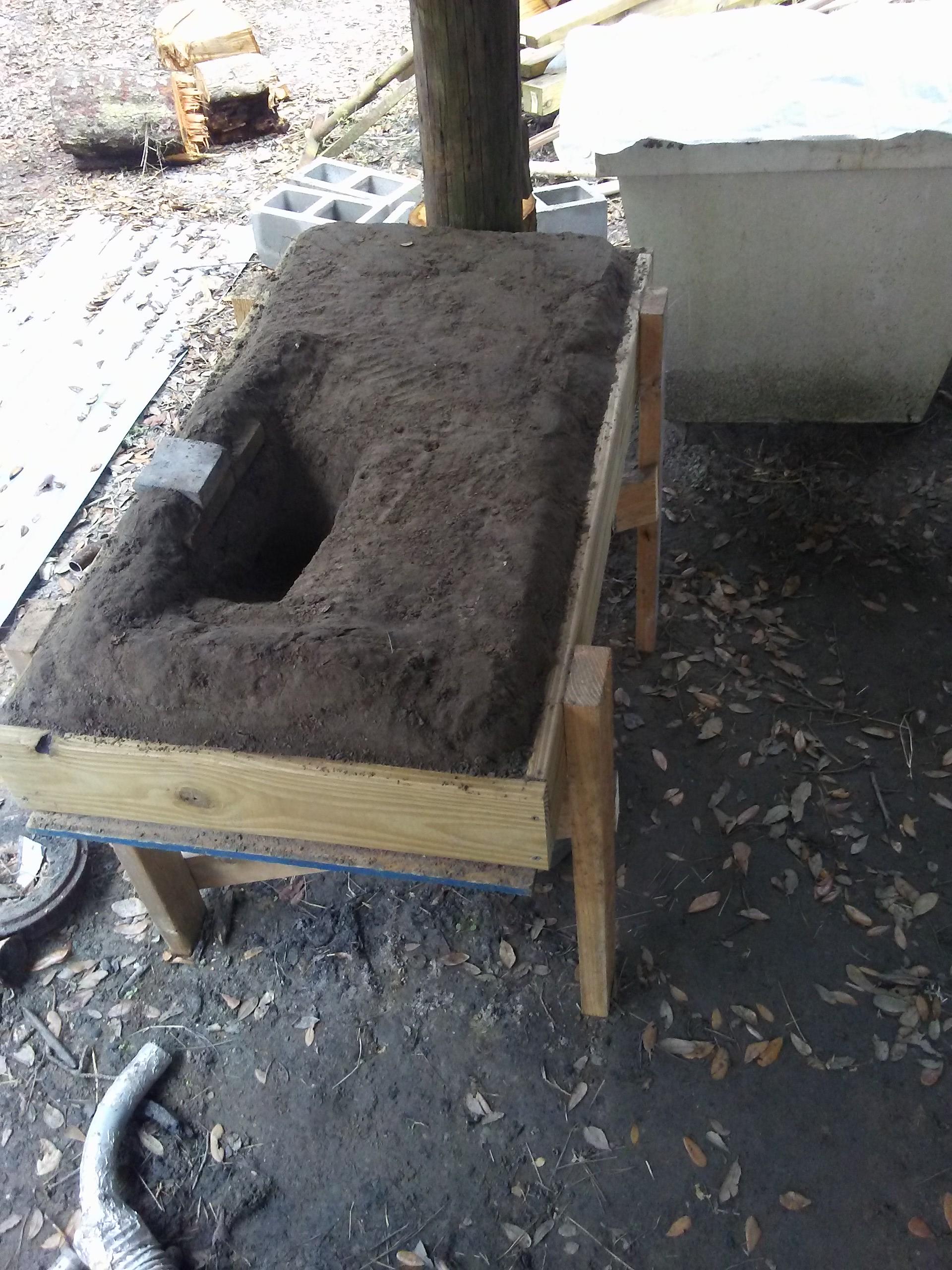

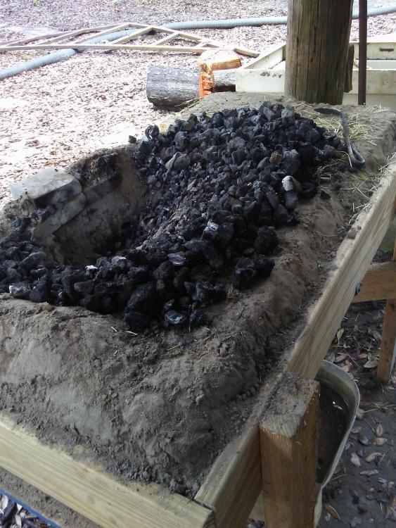

Ok here's the coal forge I made using the guidelinesIMG_20190202_133519.thumb.jpg.e95b62071d25cab650a02cbb95cbe614.jpgThe blast is near the bottom.IMG_20190202_133631.thumb.jpg.3cedce68bb323ae294557fb3e39d2b5c.jpg Here it is after an unsuccessful forging attempt this morning. IMG_20190302_120347.thumb.jpg.6651cf238b83cfce9e485c966ef491f6.jpgIMG_20190302_120352.thumb.jpg.2502824e48e984c4e747884da23620e9.jpgThere was a fireball in the trough and the coal was piled up a few inches. The metal was a 3 ft pipe that I laid parallel to the table surface. It just wouldn't heat the pipe much. How do I make a useful fire in it w/ coal. Does the fireball have to be huge or what's the minimum size? Should I make a cave or trough?
Air moves threw the pipe, thus cooling the area in the fire and heating the end your trying to hold.
Now coal behaves just a little different than charcoal. First it likes a bed about an inch deeper  than charcoal. So about 4” aboove the tuyere. Second you need 4” above the hearth. Soft coal sill clump but not hard coal.
So tell me what kind of coal, size if tuyere, deepth below the hearth and air supply?
I heated the eye of a pick with hard coal and drifted a large pin threw it to make a tin stake so i know it will get hot enugh with the set up I used
Charles the tuyere is 3/4" diameter, it's 3 1/2"below the hearth and I'm using bituminous stoked coal.
