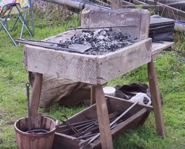

Why is the trench design better? I'd like to know the pros and cons of it and the original hole style.
The trench is eased to clean and seems to give a better fire over all. I modified the forge (cold chisel) before forging a pick into a bick
It also holds just a little bit less fuel, the sides make holding the fuel in place easer and it reflects the heat.
Down side of the double walls is that scrolls don’t fit well. Single wall works well and one can always grab a brick. I have one that I melted
Single wall is similar to Viking style, no? Only I was at a demo a while back where Darrell Markewitz was showing off a setup involving a box of sand, two single lung bellows,  and a bellows stone (more durable than a clay wall I guess?)
He was basically piling up charcoal against the stone, with a shallow depression in the sand to lower the fire somewhat. I was impressed by how small the fire was whilst his bellows thrall needed to be watched in order to not burn the work.
Link for reference: http://warehamforgeblog.blogspot.ca/2013/10/viking-age-sand-table-forge.html?m=1

Exo, some how I missed your coment, Soap stone melts at more than 2900f wile iron melts at 2800. In comparison, granite melts at 2300f and marble decomposes at half that. So yes, the use of a soap stone bellows guard works very well. Clay and clayed soils melts in excess of 3200f. So unless you can lay hands on soapstone, good old cob, adobe or brick is the answer. The down side of clay is the affinity it has for silica slag.
Mr. Markewits forge works well, but as all sand filled forges suffers from the issue of slag, buy keeping the bowl shallow and the charcoal pile exposed he gets around this. One also assumes that he has less sand to carry and as demons are theater it has a certain cool factor. Mr. Mrkewits is dang good at what he dose and very knowledgeable. The easiest way to se his work is to rent Outlander. Not a great piece of cinema but it showcases his ironwork.
If I had a reliable thrall I would certainly build one like his, tho clay cat litter would probably be my fill.
