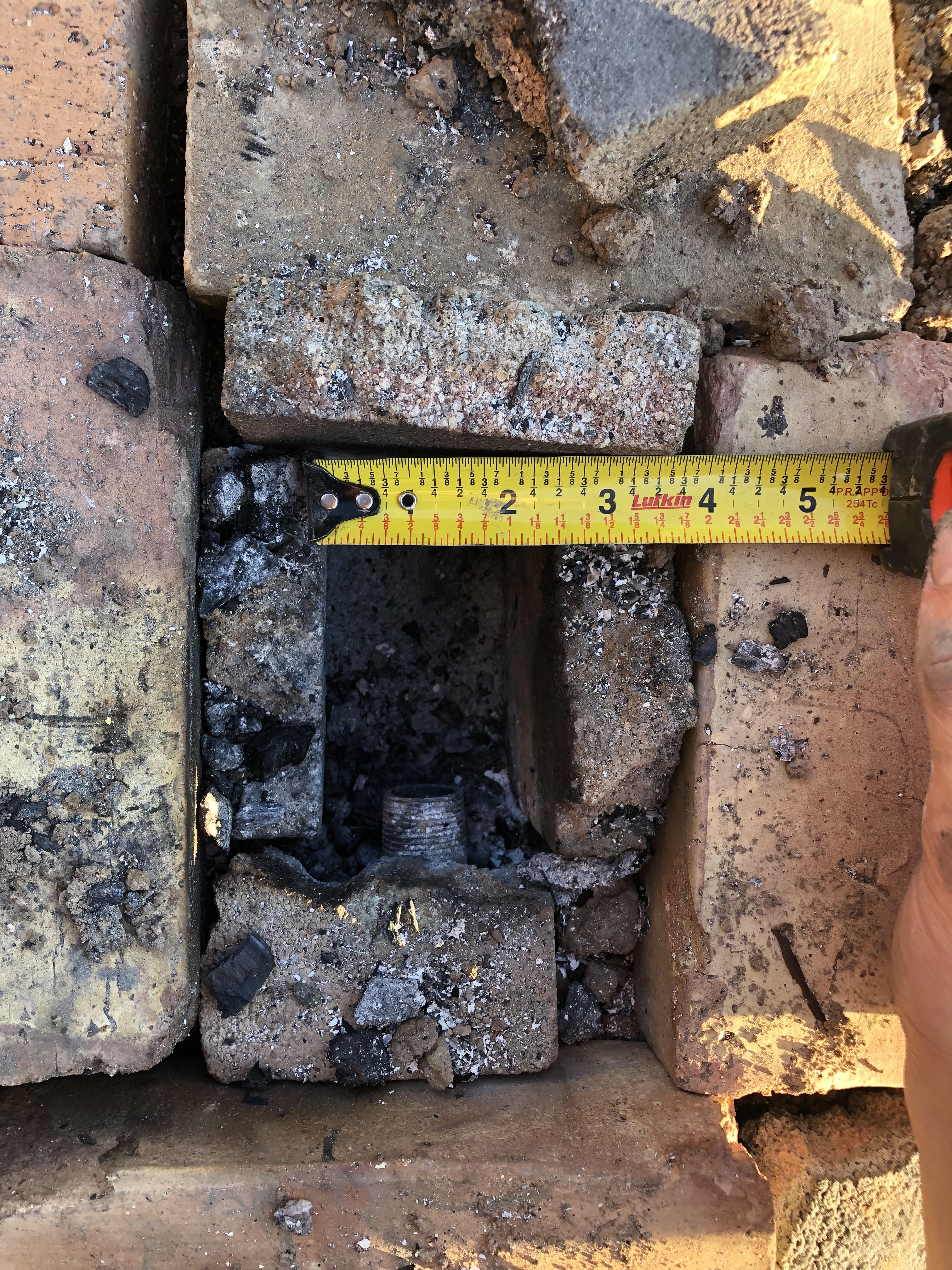

Will Brouwers Posted November 2, 2022 Share Posted November 2, 2022 I have more questions: I remade my fire pot to be not as wide, but I still had a very hard time lighting the forge, as well as getting my charcoal to get hot enough. It seemed like the fire didn’t want to spread to the rest of the charcoal. I wonder if I was just too impatient to let the charcoal catch? I had this same problem the last time I tried to use a side blast charcoal forge. I am attaching pictures to see if what I made should get me the results needed, because then I have narrowed it down to operator error. P.S. The 3/4 pipe is 1 inch above the forge floor Quote Link to comment Share on other sites More sharing options...
Charles R. Stevens Posted November 3, 2022 Author Share Posted November 3, 2022 Forge design and fuel management are related but different issues. I find a trench 4” wide, 6” to the bottom of the tuyere and about 8-12” long. I slope the ends to the bottom. As to fire management, I start the fire with wood kinling and paper, then add charcoal and air. Quote Link to comment Share on other sites More sharing options...
Will Brouwers Posted November 3, 2022 Share Posted November 3, 2022 Thanks Charles. And which side should the tuyere come out of? The 4in or 8-12 in? Quote Link to comment Share on other sites More sharing options...
Shainarue Posted November 3, 2022 Share Posted November 3, 2022 Hi Will, here's what my charcoal grill forge looked like (mine was formed from ground clay rather than brick, but same concept). Mine was a bit on the wider side at 7" rather than Charles' suggested 4" (and it did burn up more charcoal than I needed) - and sloping from 7-10" long - and tuyere about an inch from the bottom (on the long side) and protruding about 1/2 inch. The pipe was smaller than the hole cutout so I had to add clay to keep it in place - and inevitably would chunk a piece off during forging when removing clinker - so ignore the visible protrusion in the pic. I would have covered that back up with clay before my next forging. I kept the excess charcoal on the front & side ledges so I could just push them in when needed. The best position I found for the metal was horizontal just above the tuyere - which is why I added the cutouts on the sides. As for air, I used a hand pump and I saw above that you have a hand crank blower so that's good. When I used charcoal, I would give a few hard pumps to blast the air and then just slow steady pumps after that for as long as the metal was in the pot. Too much air would just push the heat right on past the metal. Not enough air wouldn't keep it hot enough. Quote Link to comment Share on other sites More sharing options...

Charles R. Stevens Posted November 4, 2022 Author Share Posted November 4, 2022 Charcoal has a sweet spot, lol. The historic record seams to indicate tuyere of 3/4-1” ID. As 3/4 schedule 40 pipe comes in close to 7/8” (schedule 80 is almost spot on 3/4”) from there we experiment with what it takes heat 6” of 1” stock to welding heat. For me that’s about 5-1/2” know as a demo forge I use a double action manual bed pump with a 1/2” schedule 40 tuyere. 2” is the sweet spot for welding heat on 1/2” if you make a template that is 6x6” square and then cut on the diagonal you have a good shape. If you then measure up an inch and a half from the 90 degree corner and drill a 1” hole (he 1-1/2” mark being the center) for the tuyere. If you cut the template from 1/4” or thicker steel you can weld 4x6” plates on the six inch sides and have a fire pot. I have done this, adding a 1” rim and welding the tuyere in at a 5 degree down slope. I have found this shape and size to be efficient. A 4” high wall 8”down each long side helps contain the additional fuel to be placed over the stock. with this set up an electric bed Inflater bypassing about 1/2 the air forges up to 1” (I have pushed it to 1-1/2”) Quote Link to comment Share on other sites More sharing options...

Charles R. Stevens Posted November 4, 2022 Author Share Posted November 4, 2022 I was raised buy one of those, it still bites me in the butt some times. The original forge I posted here was the second addition, I started with an 11 inch deep box with the tuyere about 4” off the bottom. I had to cut down the sides to get down to the hot spot. This one was based on those experiments. I have progressed beyond this one as well. I am up to the mark IV. I have built a side blast steel fir-pot based on what the have learned as well. I recommend if you are planning in building your own steel fire pot or side blast masonry forge you mock it up with a pile of dirt and experiment with the design first. Quote Link to comment Share on other sites More sharing options...
