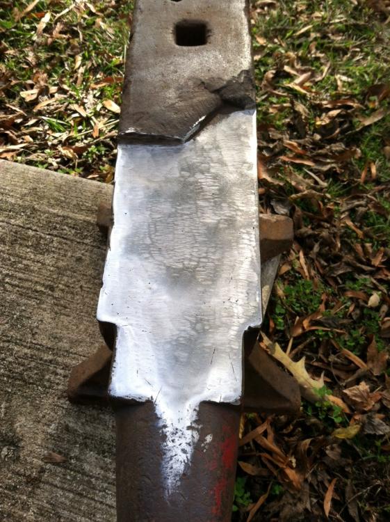

A good friend of mine "gave" me a Peter Wright Anvil (It is 150-170# at least) to work on but there is a problem.  The striking face is broken.  Part of the top, forward of the Hardy and Pritchel has broken away leaving a very uneven surface.  Sort of looks like the state Florida actually.  I have a friend who is a very good welder and he has offered to work on the anvil and try to restore it to a better working condition.  I understand the value both monetary and historical but I would rather have the anvil flat and more useable than original.  What do you guys think?  Let him fix it and use the crap out of it or let it stay original and use the horn when needed?
I've seen anvils made as good as new and anvils destroyed by very good welders.  Does he actually know anything about anvils? (if not make sure he reads up about the Robb Gunter method of anvil repair and can do the preheat and use the correct rod and not get spooked by what happens when you weld on real wrought iron.  Generally not much historical value as these things were made by the shipload!  I'd like to see a picture of it before I really say Yea or Nay though.
That is some catastrophic damage. That's not so much repairing an anvil as furnishing a new face. Yet it can be done, if you use the right rods. I just bought some stoody rods like is suggested here to repair mine: http://www.anvilmag.com/smith/anvilres.htm

Peter Wrights are wrought iron bodies, and they weld very differently than modern steel does. That anvil can go from still being useful to junk pretty quick if it isn't done right.

Whatever you do, don't think you'll get away with repairing that anvil for less than a couple hundred $. I repaired one in much better condition for a fellow two summers ago and he spent $150 just in rod. The guys at the local welding supplier just happened to have an open box of build up rod in the oven and I got the deal of the year on it.
Build up rod till it's less than 2 passes from finished, then no more than 2 passes of hard facing to include enough bead above the face surface to grind it flat. I used a cup stone on my 9" Milwaukee grinder while the face was still HOT. Preheated and post heated to 400f. Tempil stick verified.

I fix anvils all the time & have done one like that also -- theres alot of work & time there !
this is what I would do
first torch cut or grind off the piece that sticks out & make it sq & 90 degs that way all welds are the same leanth when welded
you NEED to read Rod G anvil repair !!!!  --- Build up base rod  110-18 is my choice for this ---  7018 will do also
pre heat to 350 or so that much welding will keep it hot -- build up until you're about 3/16 from top & flat
grind high spots as needed
use stoody 1105 rod as top build up rod & yes you can do more that 2 pass with it !
an air scale needler makes it easy to descale welds & peens the welds @ the same time --- chipping hammer AT LEAST
to do above --- by the time you finish welding you're welds will look much better !! that's a good practice piece
to learn with would be nice if you you welder friend there to give pointers then its just time bead after bead you get the Idea LOL **  when done wrap with leathers or pink insulation or something that keep heat in over night
then theres the grinding :o

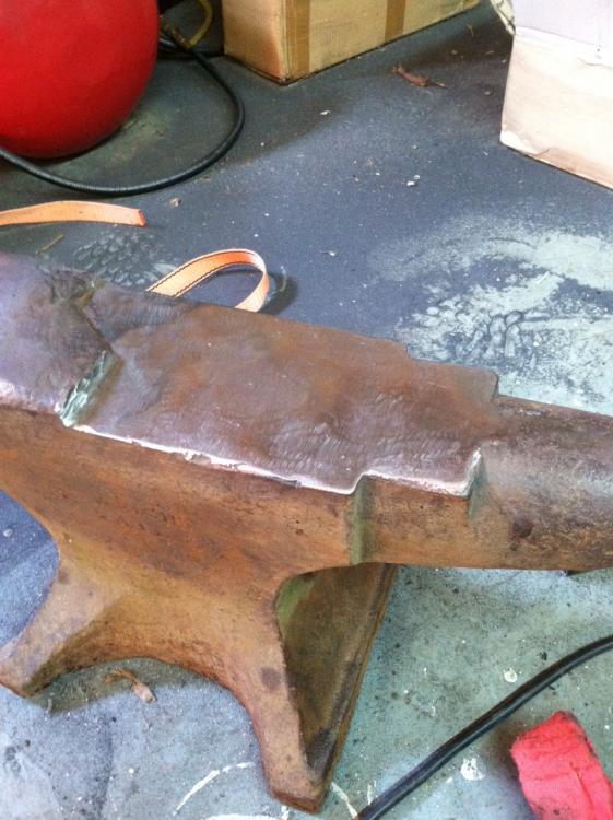

I really appreciate all of the advice on fixing the anvil.  My friend worked on it and it has a pretty decent hard flat section now that I can do some light work on so I am going to leave it as is and put my money into a "new" old anvil in the spring.  I hammered down on it this weekend drawing out a piece of school bus leaf spring and it held up well, no dents or new damage.  It does seem to ring more now than it previously did but I know how to dampen that well enough.  Again, thanks.
Picture?
