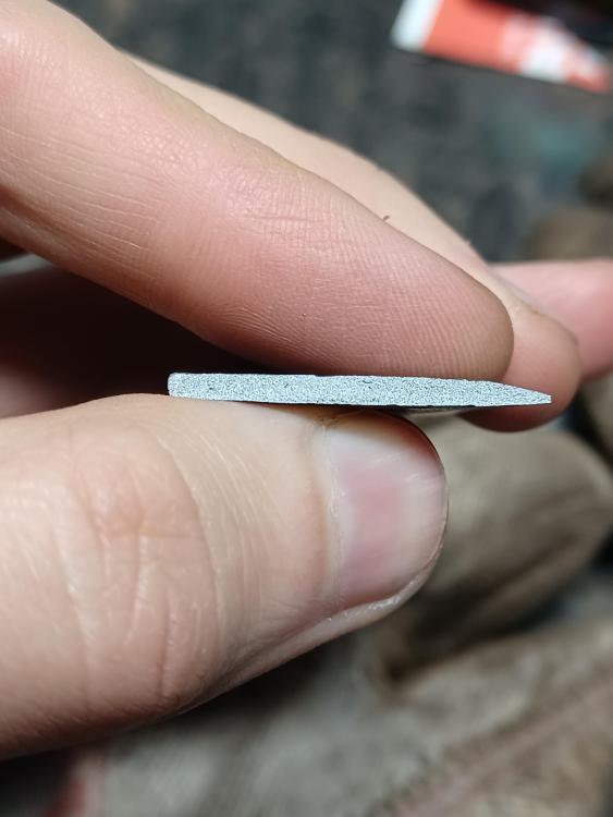

  1. Buzzkill, you've got it. I tend to cheat and straighten the blades at very low working temperatures, usually near the tip and the bolster! I thought I was getting away with it since it's 5160 and it would get normalized in the end anyways. Looks like I've got a dozen knives to heat treat again. Practice makes perfect right? And Thomas, yes I've seen that before with my big post vice. Though I didn't know exactly why, great info. Thank you gentlemen!
  2. You could certainly be right, I suppose my eyeballs can't be trusted anymore. I also didn't know the temperature reached for normalizing could make a difference, typically I just heat to my normal forging heat and give it time to cool. Thanks for sharing, I'll give your method a try.
  3. I don't normally check with a magnet, thought I knew the color well enough. If anything I was worried I was quenching too hot, but sounds like I'll need to check with the magnet next time. Thanks!
  4. So I've got some strange behavior and discoloration that I don't understand. I'm using known steel, 5160. I forge my knives and then normalize 3 times followed by a nice and even pre-grind. I quench between red and orange (by eye, using the forge), making sure to have a really even temperature throughout the blade. I use parks 50 at room temperature for the oil. Then temper at 400 in the oven for at least an hour, two cycles. I've had great results overall but have noticed this discoloration on the few breaks I get, in this instance it happened both at the bolster, AND the tip of the blade. Any clue as to what this could be? Also while you're here, how's my grain structure? Thanks!
