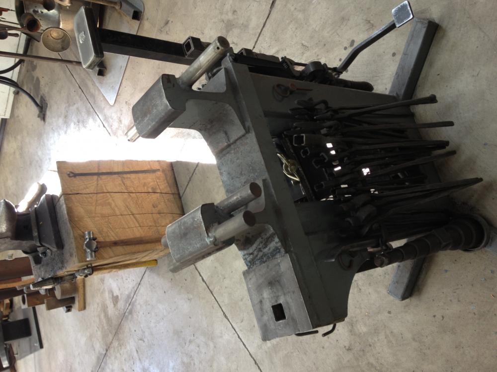

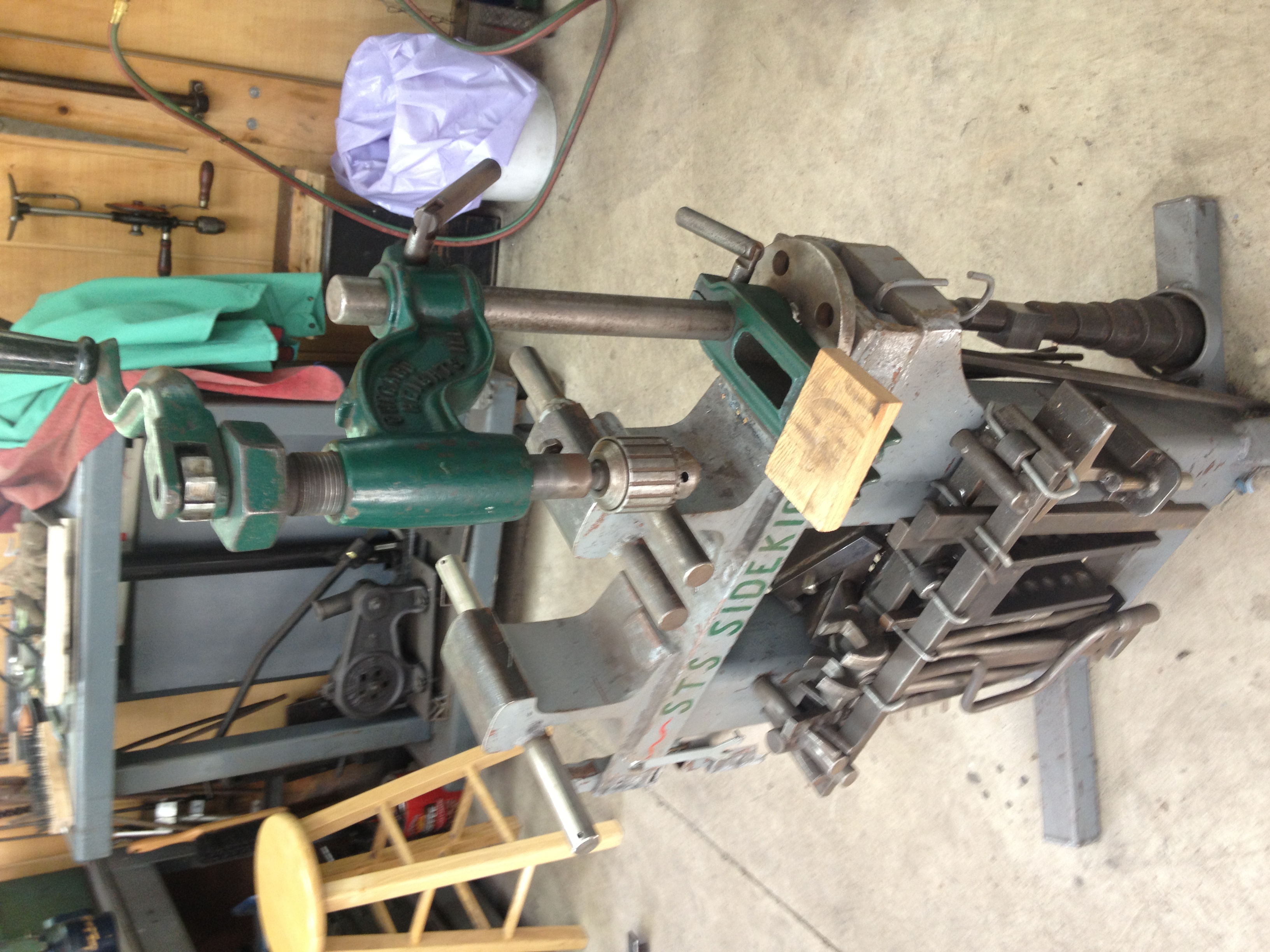

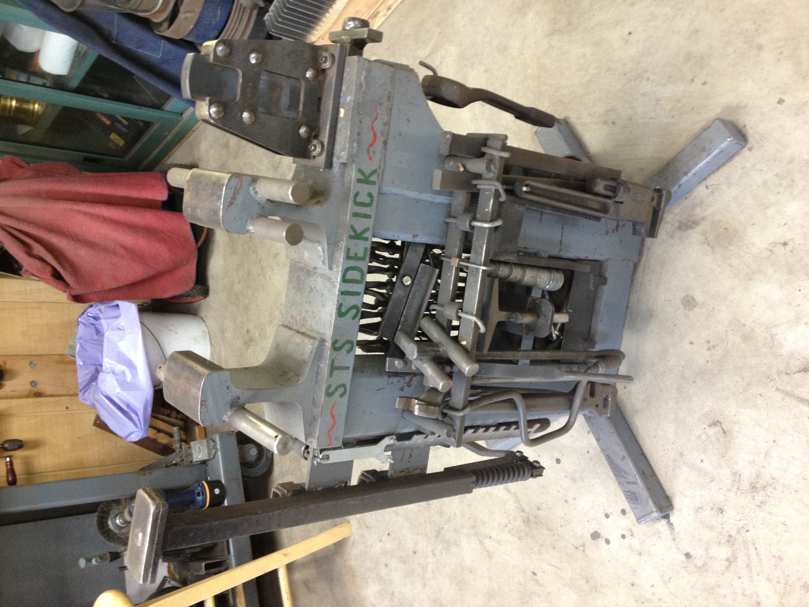

Just throwing this out there;
You can make your own Hossfeld bender
Make it exactly the same as a Hossfeld so you can use Hossfeld dies.
For the most part I make my own dies but I bought the top gripper and the over 90 die cheaper than I could make them.
