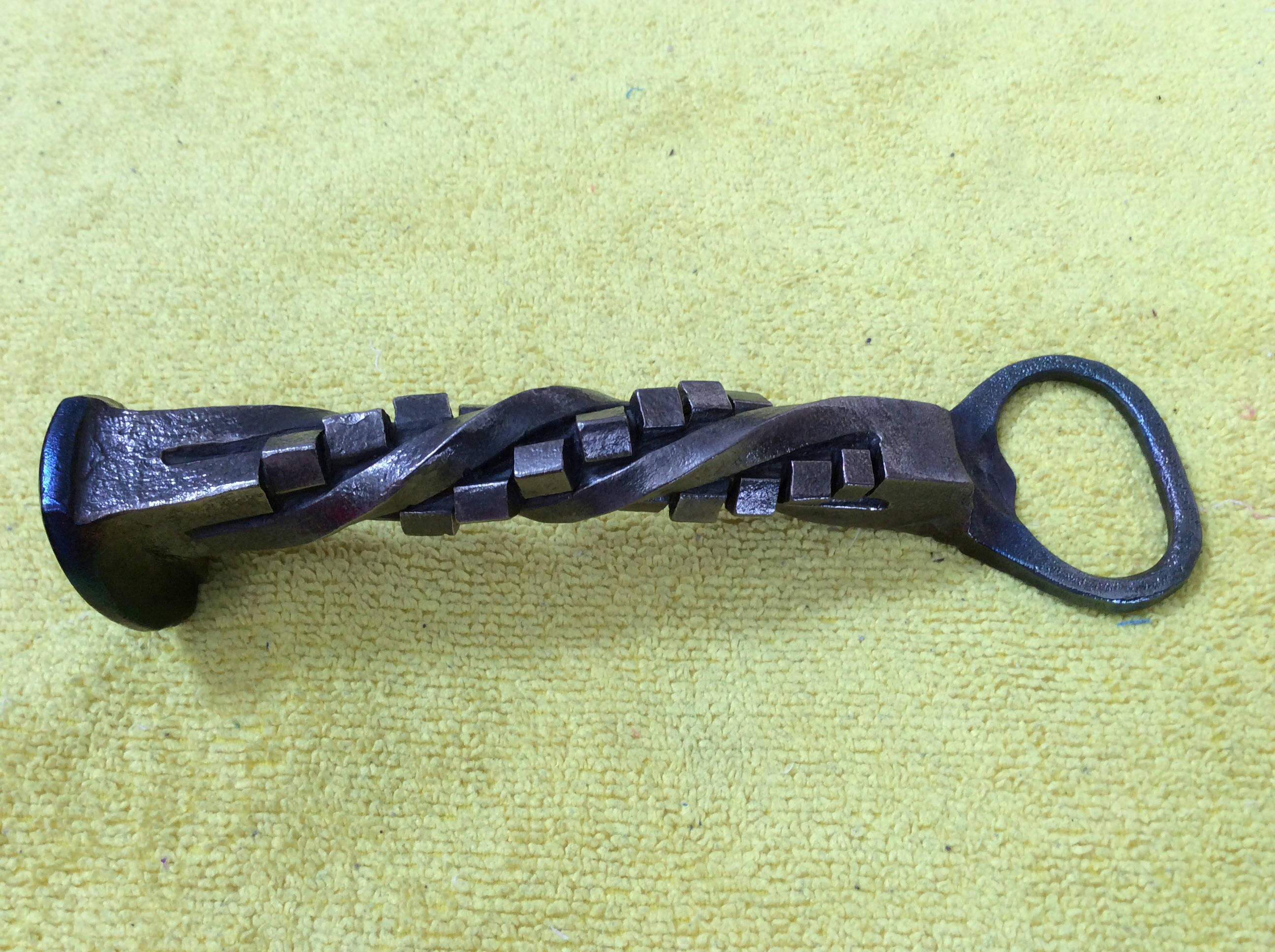

Frozenforge Posted March 8, 2015 Share Posted March 8, 2015 Finished this one this morning. My wife told me to keep this one. My first staircase twist. Quote Link to comment Share on other sites More sharing options...
carlson Posted March 11, 2015 Share Posted March 11, 2015 (edited) Wow Frozenforge that's beautiful! For the circle/flattened circle style what diameter do you open them up to? Edited March 11, 2015 by carlson Quote Link to comment Share on other sites More sharing options...
Frozenforge Posted March 12, 2015 Share Posted March 12, 2015 Have never had a specific dimension, just eyeballed it. Approximatly 1 1/4" to 1 1/2" Quote Link to comment Share on other sites More sharing options...
