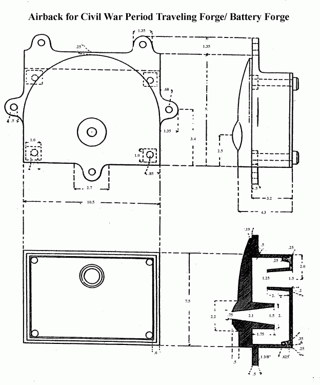

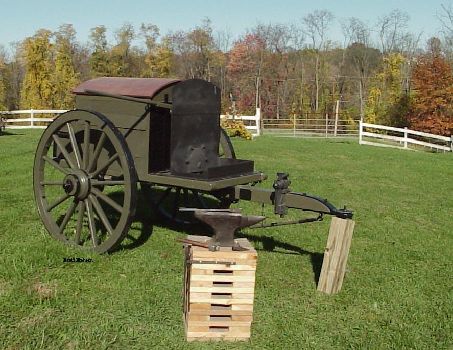

In U.S. versions of wheeled "Traveling Forges" the fireplaces are flat because of wooden members under and on all four sides of the fireplace. There is a slight air space below and on all four sides of the fireplace for the mid-1800s Army Traveling Forge to prevent the frame and stock of the forge from catching fire. An indentation in the bottom of the fireplace would likely cause the hot metal to contact wood. I reexamined the drawings of a mid-1800 British Traveling Forges, the semi-circular indentation in the fire pan, yes that appears to be part of the design of the British Traveling Forge. The indentation is possible because the forge is in the rear of the forge, and the wooden frame is only on the sides of the fireplace and no part of the wooden frame is under the fireplace. Because the fireplace is in the front of the mid-1800s U.S. forges, there is a heavy wooden member less than an inch from the bottom of the fireplace. That is because that wooden member is necessary to pull/attach the Traveling Forge to the limber. There is no wooden member under the middle of the back of the Traveling Forge because nothing is being pulled by the Traveling Forge.
I built two side blast forges, both are my attempts to reproduce mid-1800s U.S. military one Army and the other a Naval forge. For the Army forge, I used reprints of the period diagrams the army gave to factories to produce the forge. The diagram is the official government drawing of the "Airback" at the rear of the fireplace.

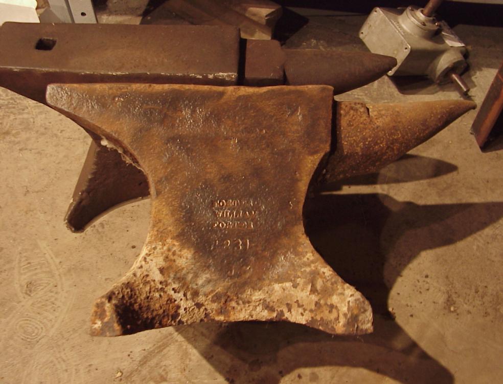

Wife's family William Foster anvil. They bought it new when they built their barn. The smooge is mud. It was found buried in the mud in the foundation.

100 lb anvil was used with wheeled forge. This picture was taken in Antietam in 1862. Sorry it has taken until now to figure out how to post this image. I had to change browsers. -
