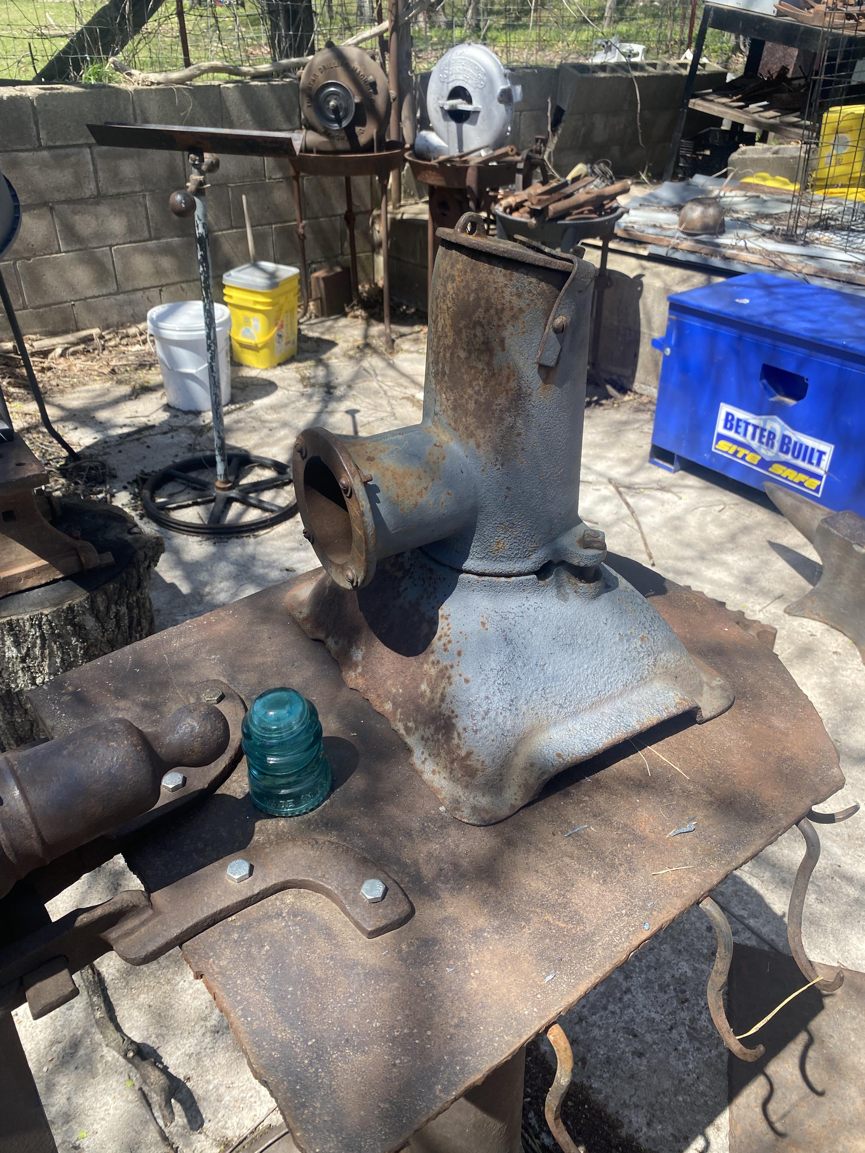

I saw this peeking out of the pile at the scrapyard, 4" Wilton Bullet.  I'm going to get it in good condition and see if anyone wants to pay for my power tool repairs/maintenance! (Of course I'd be out the 25 USCents a pound I bought it for...)
(The Bader in the background is purring sweetly on 220 VAC)
Saddens me to think of how many good quality tools that just need some tlc didn't get saved and have been melted down.
Good save Thomas.
I think the same thing Das. Good thing I have a friend who works as a mechanic at the scrap yard looking out for things for me!

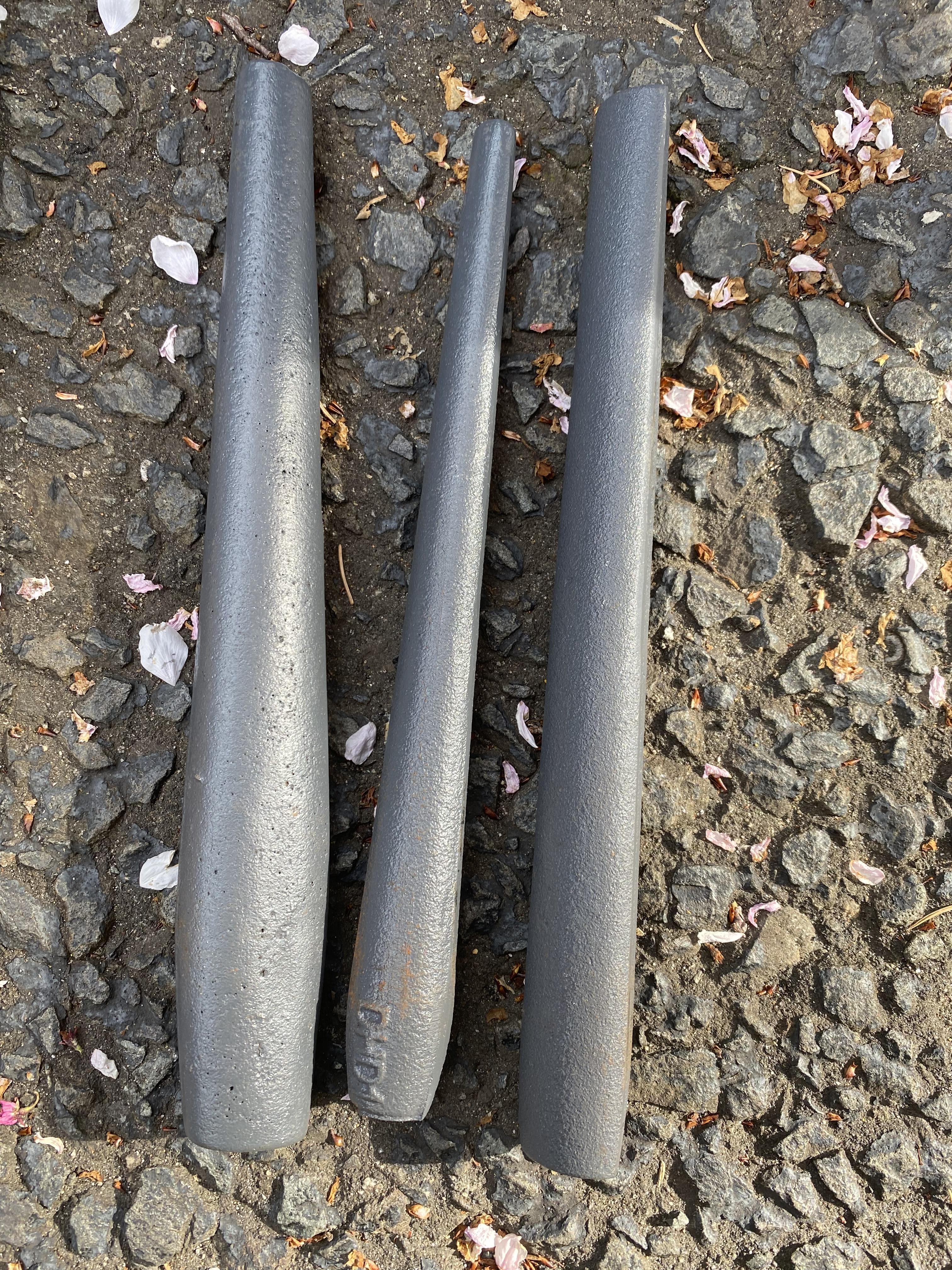

They’re doing some bathroom renovations in my building at work, so I snagged a few bits and pieces from the dumpster.
Should come in handy for a bending jig or two, and the thread protectors will be useful for another NARB.

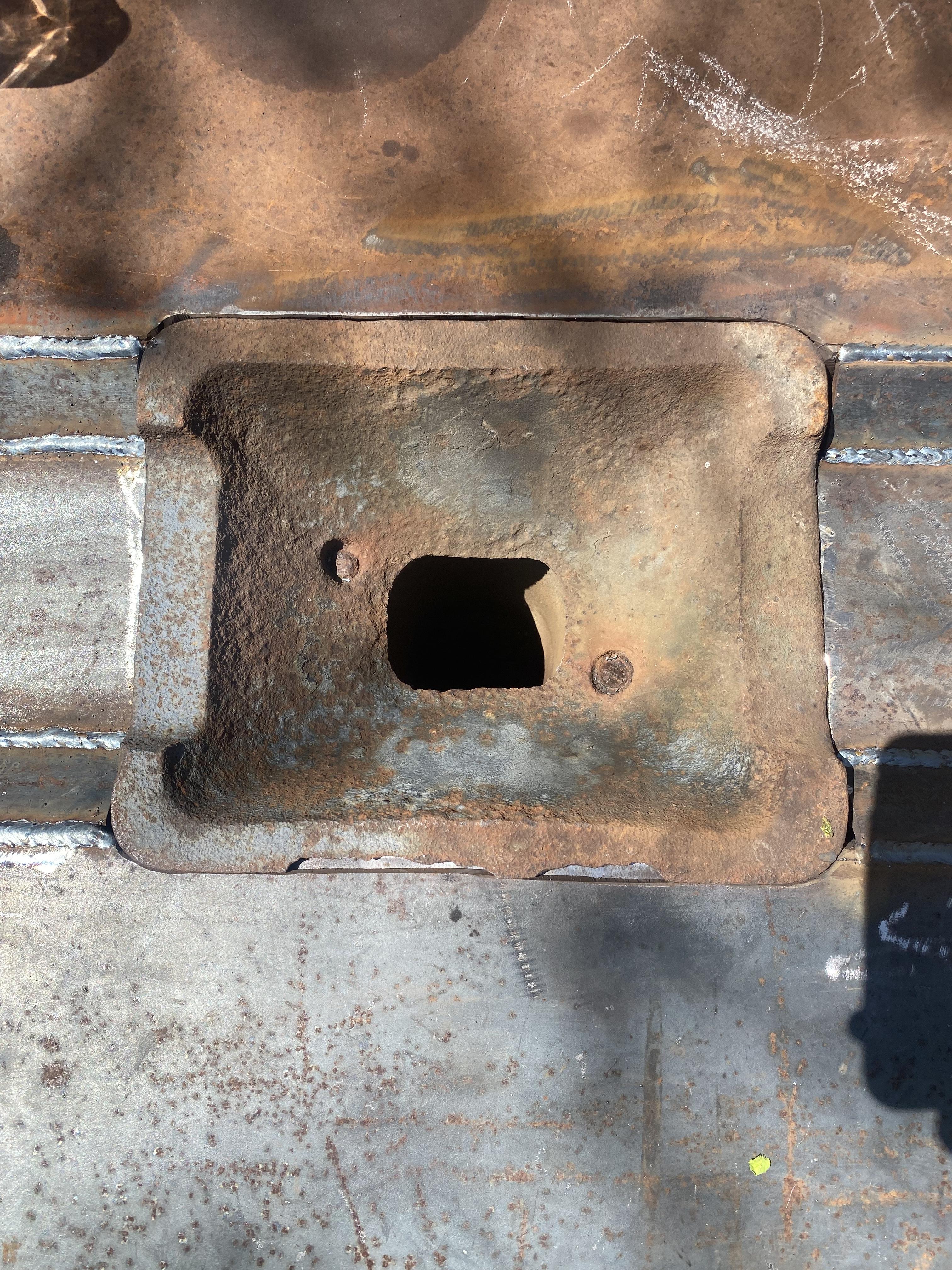

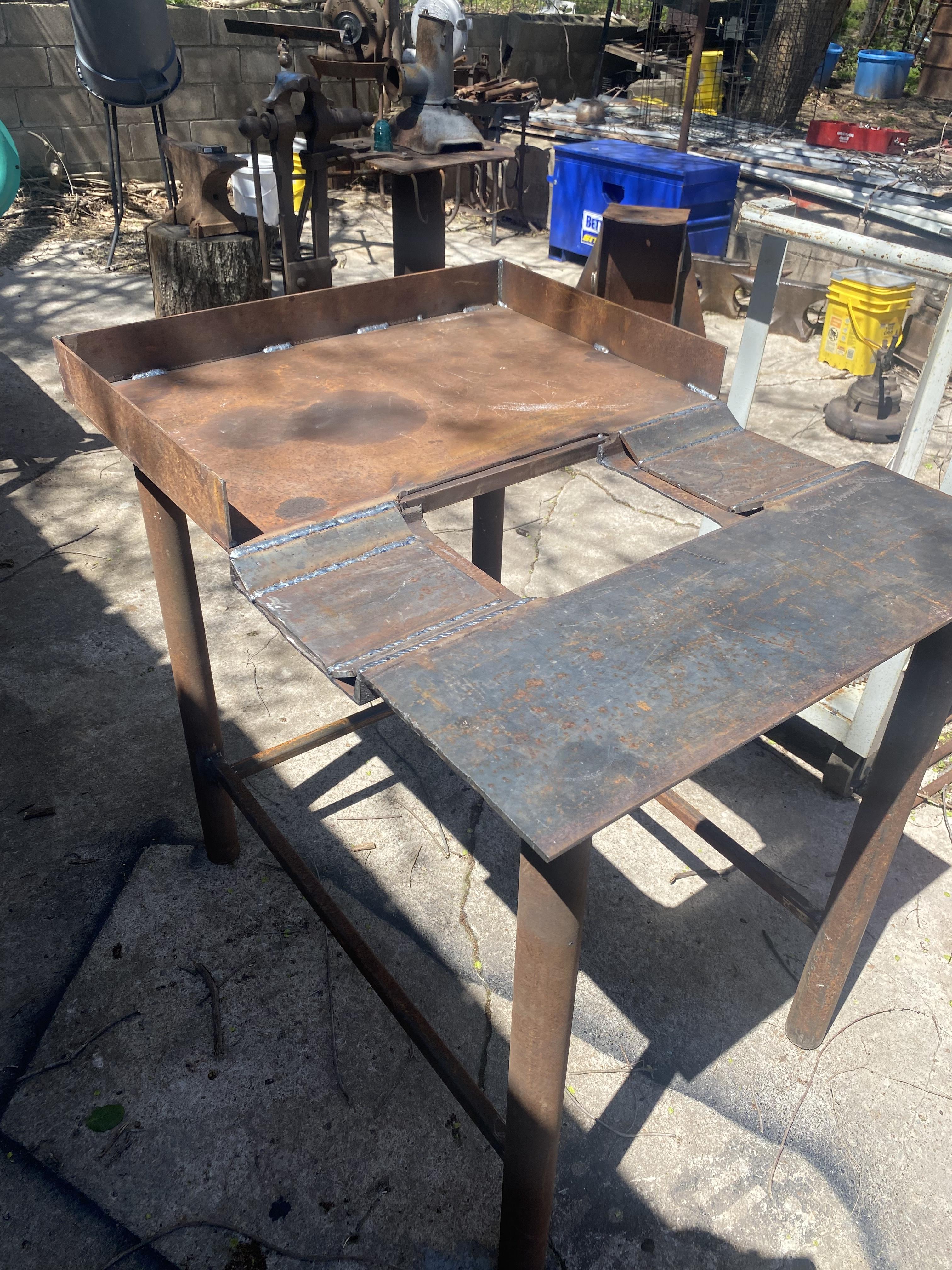

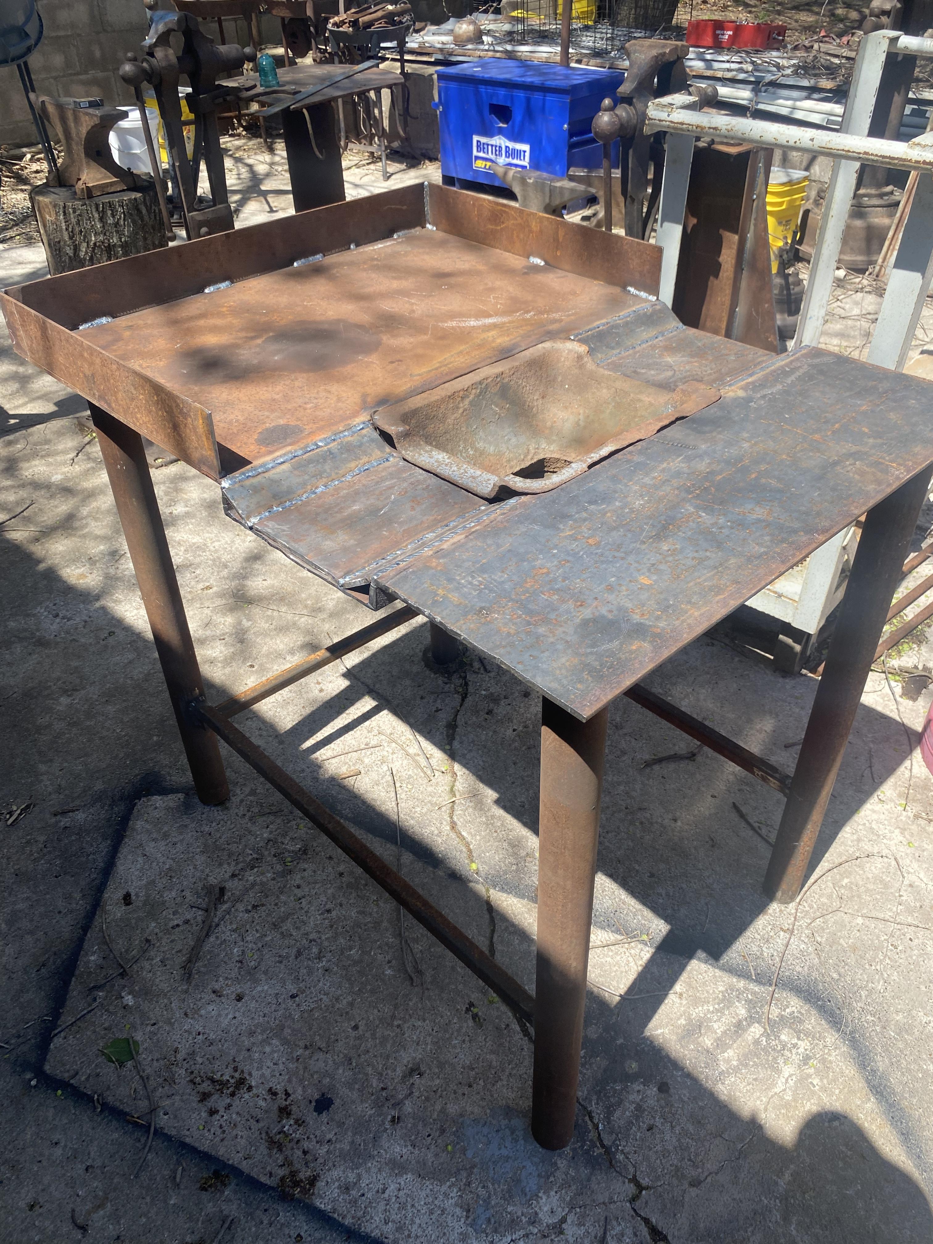

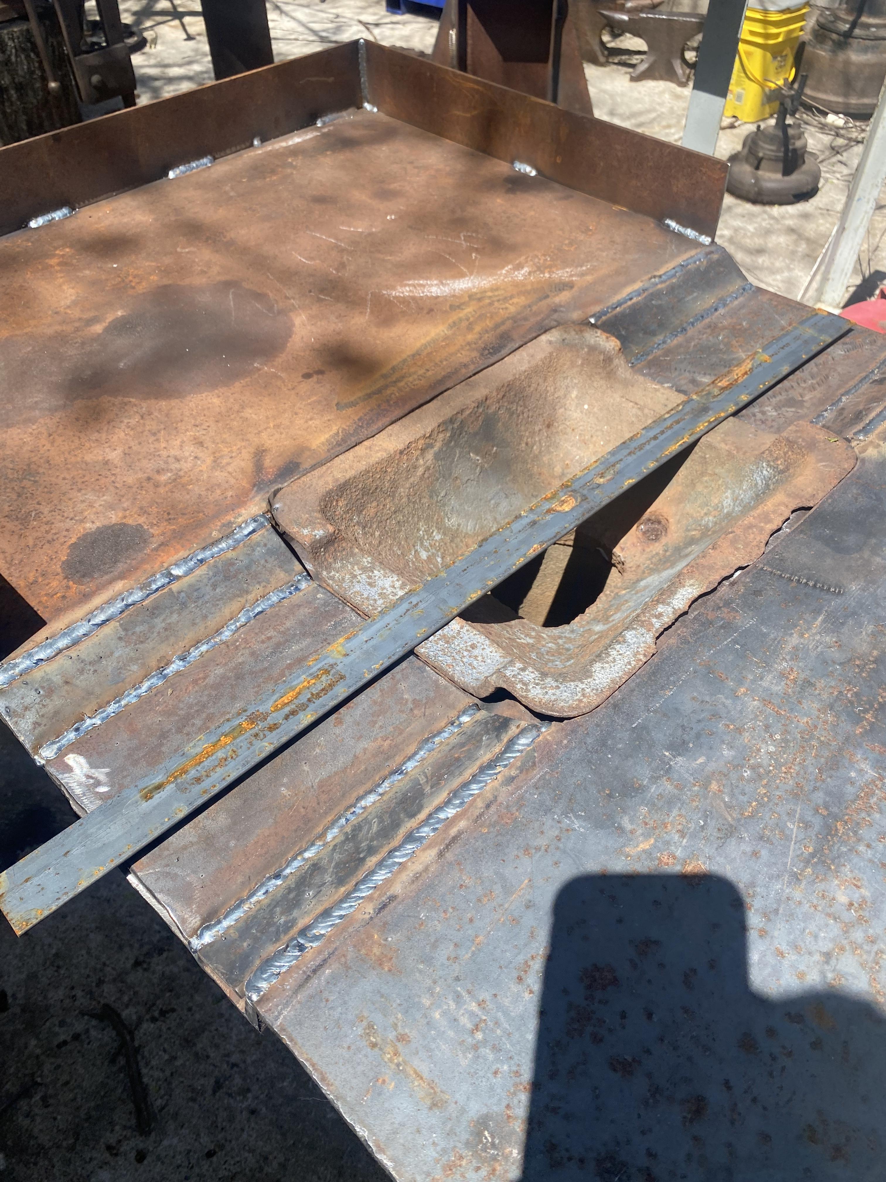

Back in October I decided I wanted to make a forge for a big firepot I found last summer,
I dug through may metal piles and come up with an idea to set the firepot flush instead of setting on top of the forge like my big Buffalo is built,
normaly I build my own forges and post step by step pictures but….
This time I got lazy lol :ph34r:… and hauled it all over to a friends shop who has a bigger plasma cutter and better welding equipment then me and had him cut it all out like I wanted and weld it up for me,
The forge is 30”x40” all material is 1/4” plate an the legs are schedule 40 2-3/8”
the big firepot is unknown brand but it kinda looks like a champion compared to others I’ve seen,
it’s missing the clinker breaker so I’m thinking about borrowing JHCC idea of cutting some triangles out of 3” flat bar and welding them together, but for now I’ll probably just make a tuyere grate,

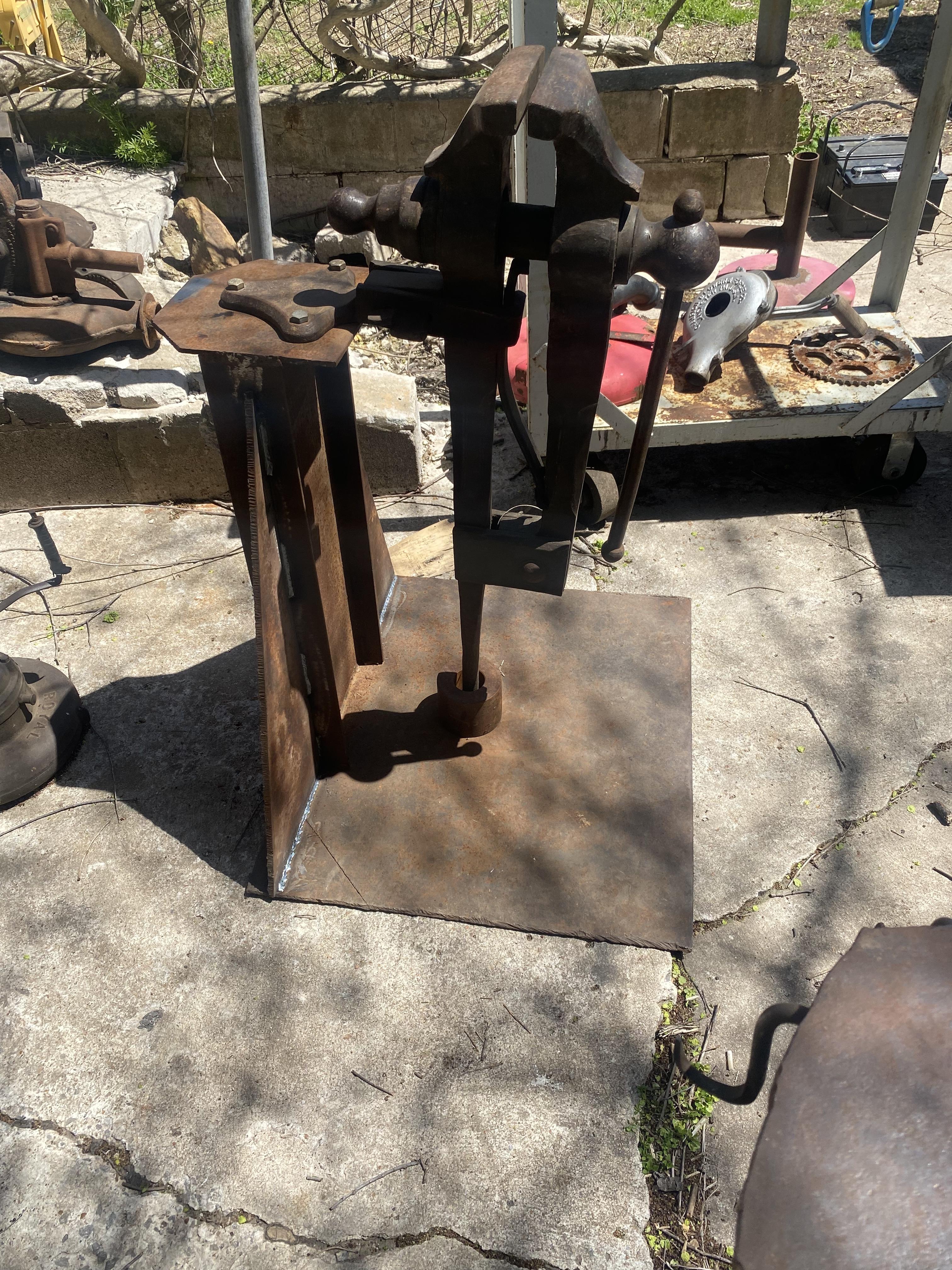

I also took over one of my vise stands and had him cut out some 3/8” plate for some gusset’s because the 12”  ibeam had some flex when I mounted my big 140 pound Trenton post vise to it, that fixed the problem it’s pretty ridgid now,

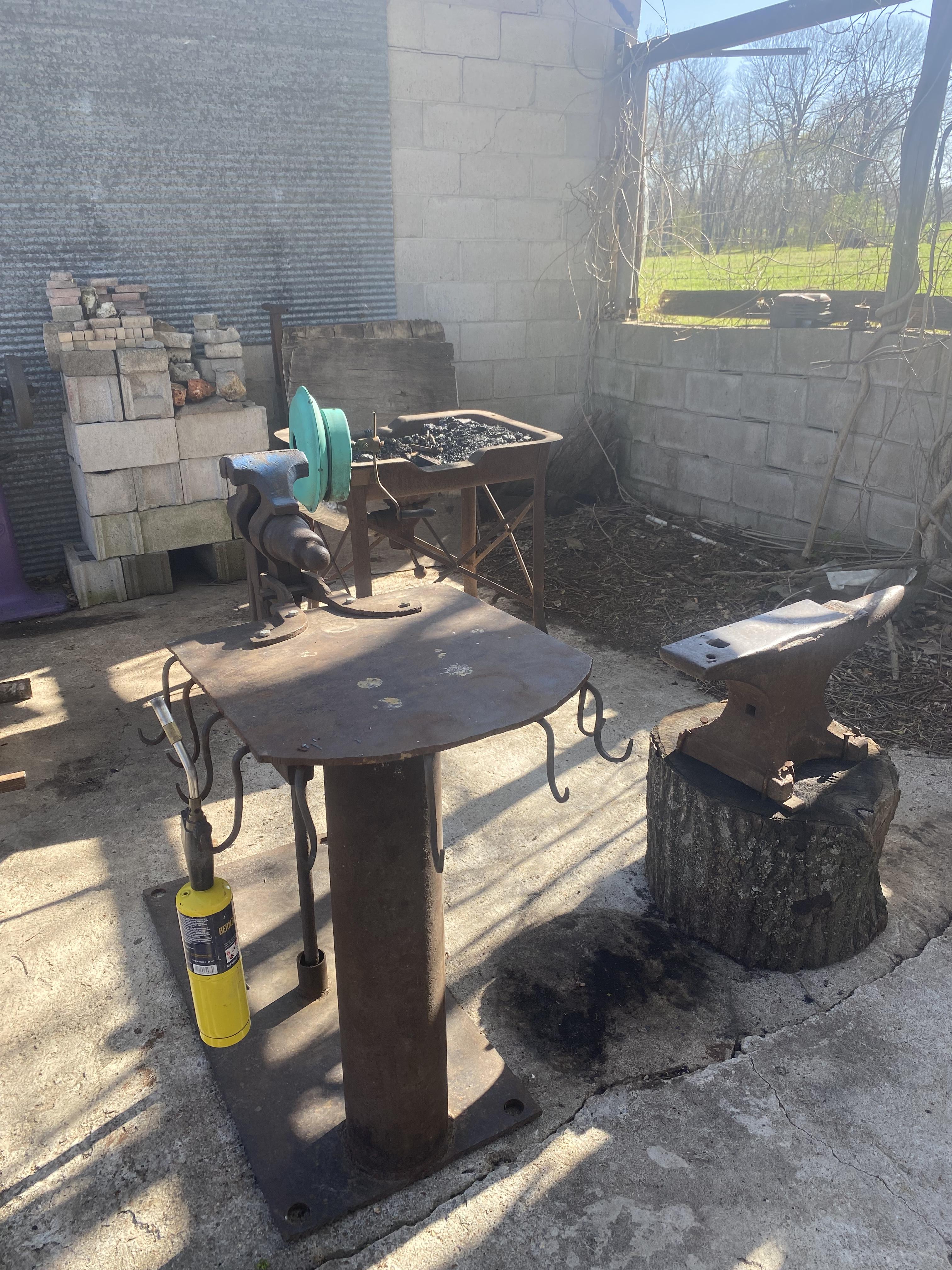

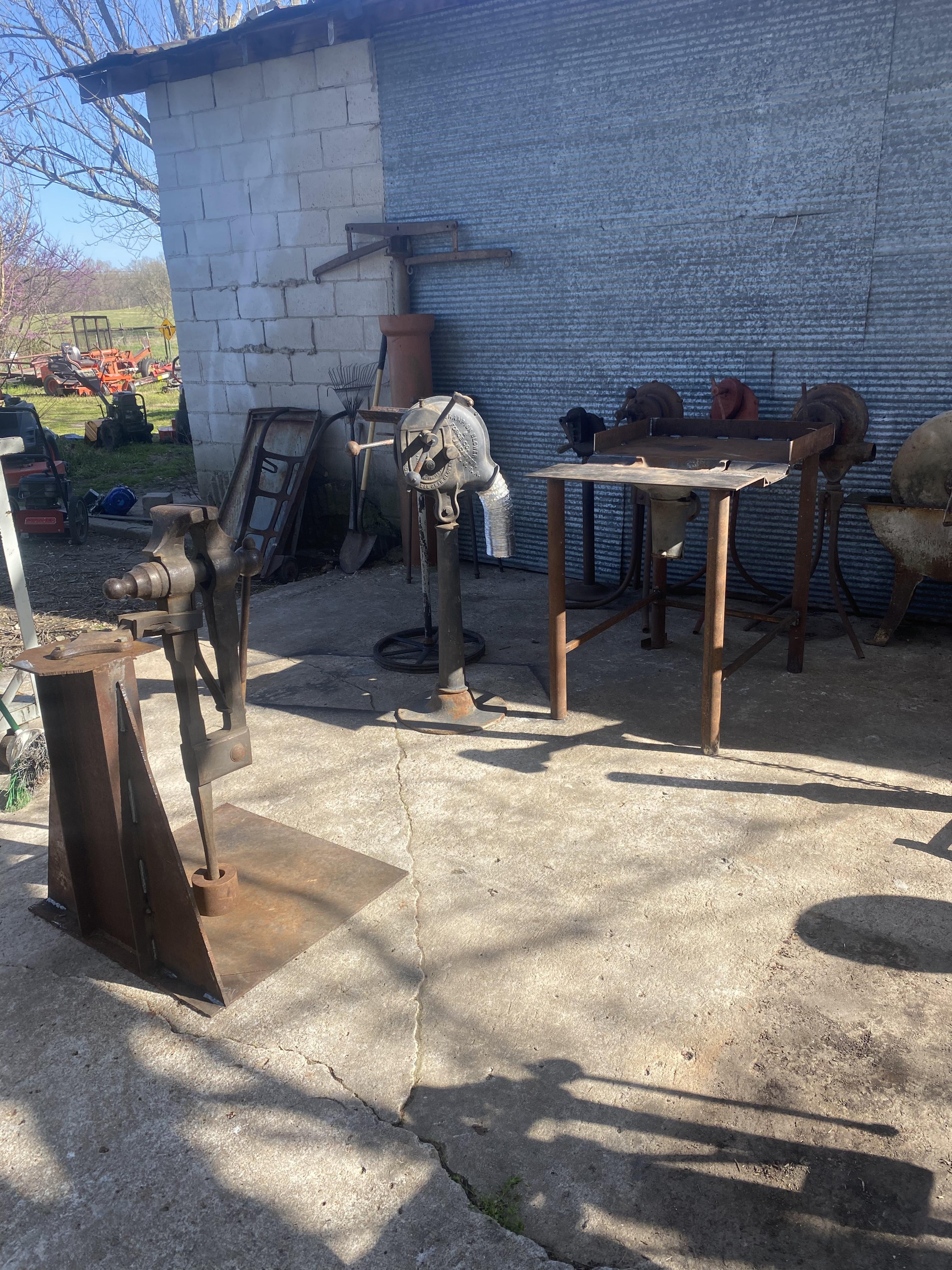

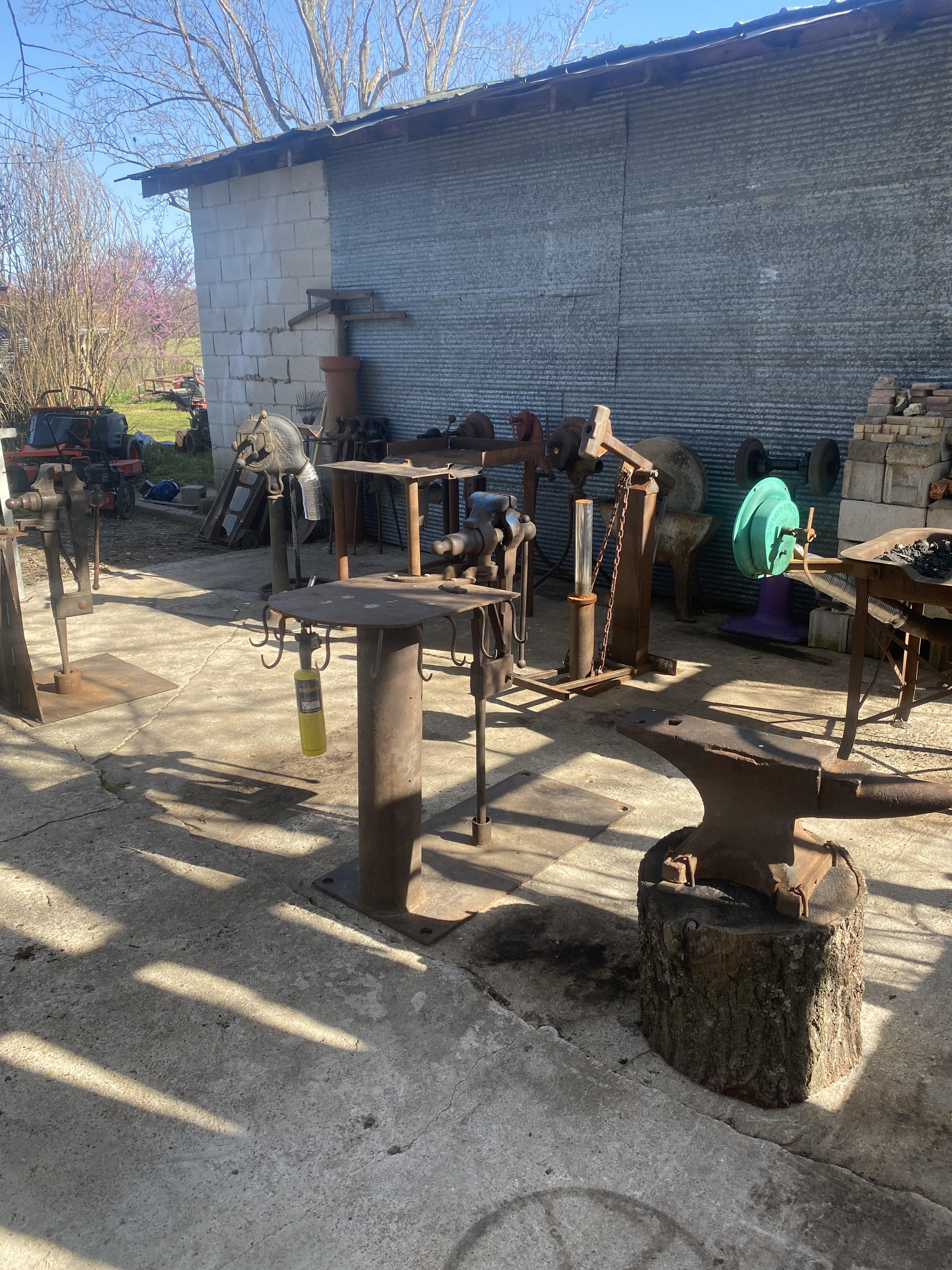

Well I swept up all the leaves and sticks an rearranged to set up a second forging station,
I moved the treadle hammer to the center between the two big forges, ive still gotta anchor it to the concrete
I put two post vises within a quick step of each forge
im for sure gonna add a tool hanging bar on the new forge and am thinking about adding a hood, I’ve got a feed hopper from a commercial poultry farm I’ve been saving to use sometime, but I haven’t decided if I’m gonna use it on this forge or not,
Soon I’m gonna try out a few different blowers to see which one works best with this fire pot
no forging today but I’m happy with how things are coming together in my rusty junky outdoor smithy!:P
  Your new forge looks great, Billy.  I may have to build a similar one and switch to coal....:)

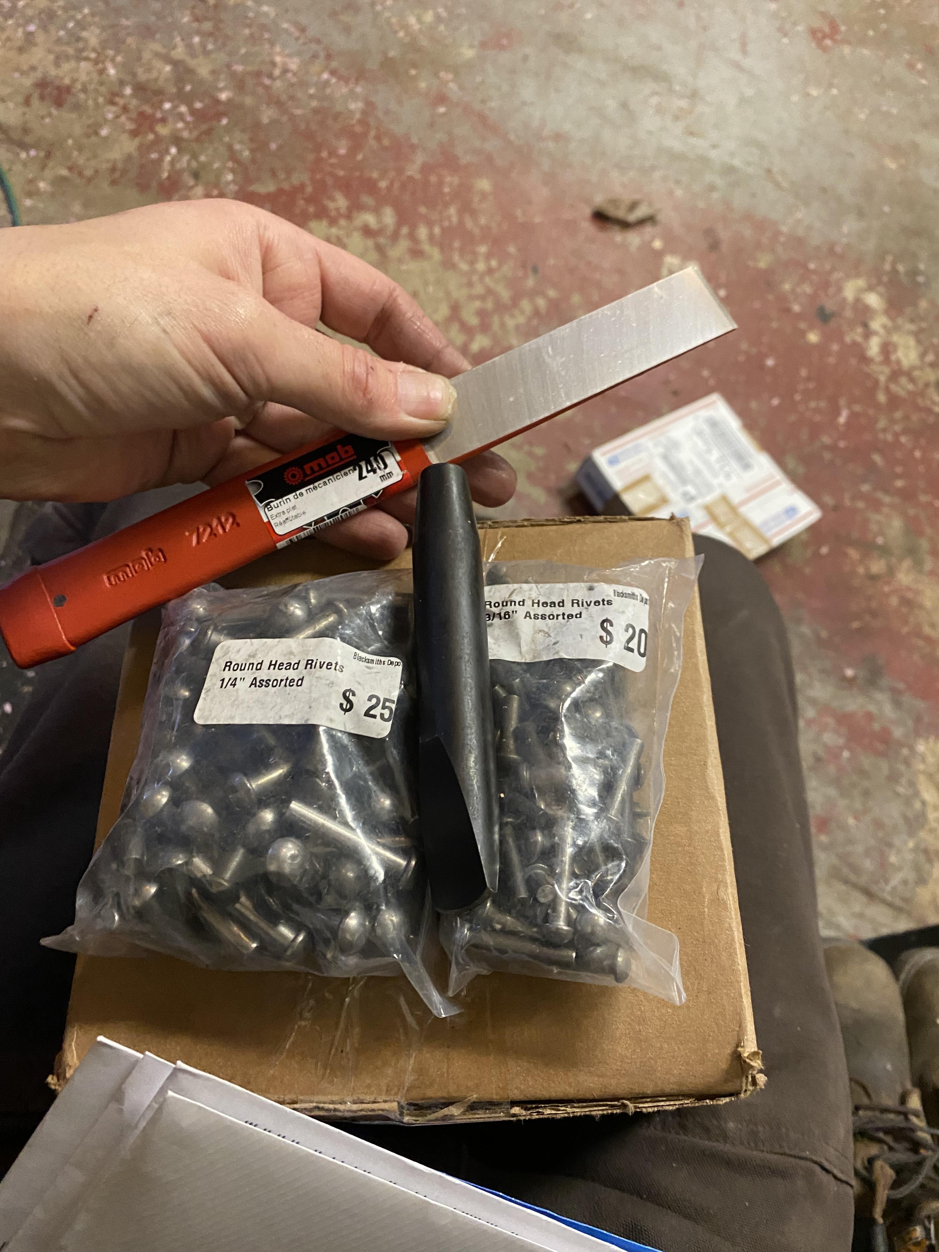

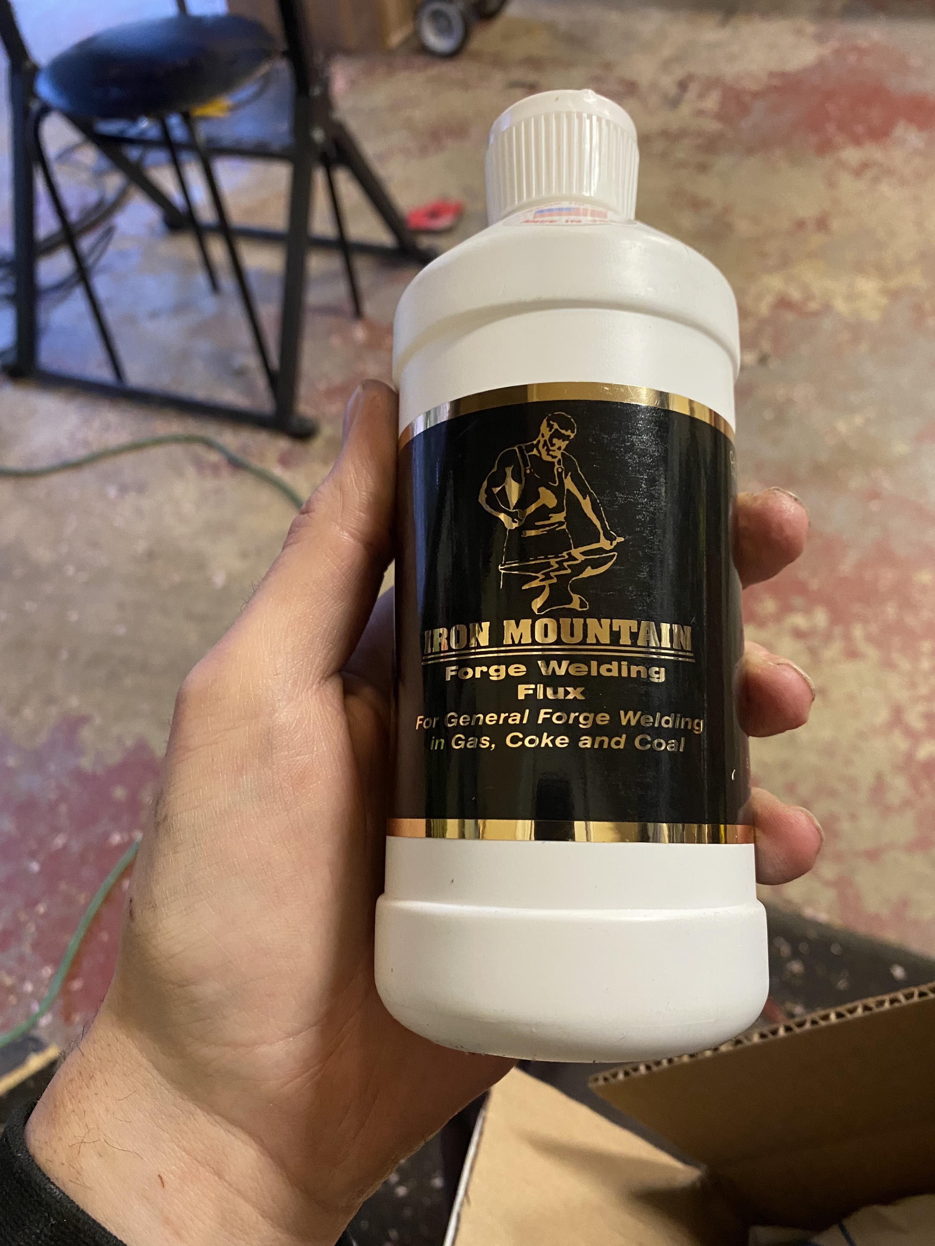

Got some goodies today. Iron mountain flux - from Amazon so I hope it’s not fake stuff and the three piece drift set. I don’t know if they’ve got paint on them or what but they definitely need a good dressing down - maybe a worn out flap disk to smooth everything out. And then two h13 slitting chisels and assorted 1/4” and 3/16” rivets from blacksmith depot. This thin slitting chisel is awesome and is what I picture when I think of a slitting chisel. The other doubles as kind of a drift I believe. But the the real reason for the post is I have to give a shout-out to Cathy. Somehow I double ordered the chisels so I had two of each coming. Cathy Kayne who I believe is one if the owners went way over the top to get in touch me with me to see if this was a mistake. First she called me and I saw a NC number so I figured it was one of the xxxxxxxx robot calls I get every day and sent it straight to voicemail. She emailed and it went to my spam file. Finally she tried calling again and bc I saw it was the same number I picked up and she explained why she was calling. She could’ve just let it go and had an extra 60$ worth of tools sold - because I can tell you now even though I absolutely do not need two of each of these I would’ve kept them bc I’m a tool junky but instead she made sure I only paid for what I actually wanted and refunded me for the two extra chisels. I think it is a little over priced but I’ve never been disappointed with a purchase. This honestly and effort was just the icing on the cake - great shop, great people.
Don't use a worn out abrasive anything; just use a finer grit.
I’ve purchased several items from online and and always had excellent customer service, including getting calls from them to discuss the most inexpensive way to ship items In order to save me money. Definitely a customer oriented business.
My only complaint, I stayed I a cabin about 10 miles from their business while on vacation last fall and didn’t realize it until I ordered something this spring and saw the address. I feel like a big dummy every time I think about it.
I have a set of those drifts, I smoothed mine off with a 60 grit flap disk using light pressure and they work great
