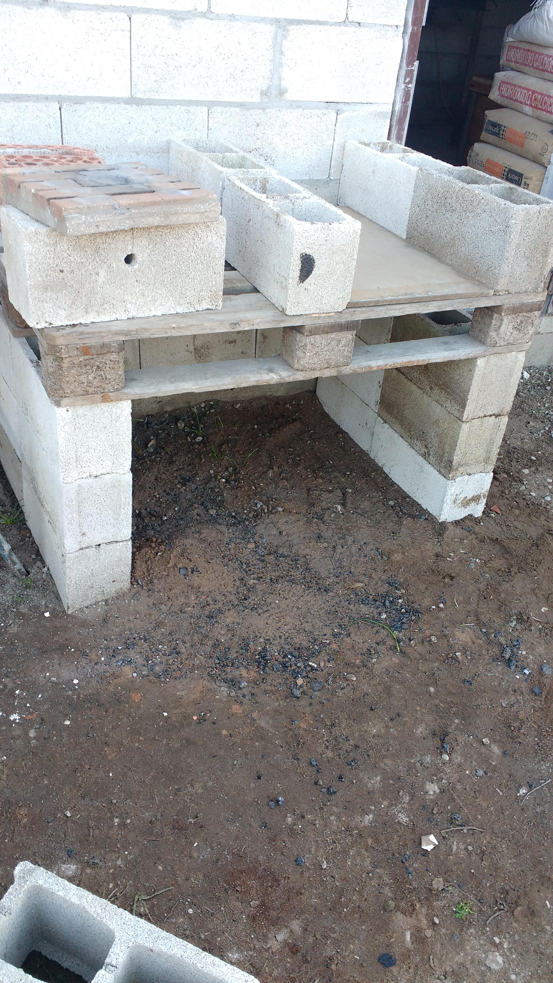

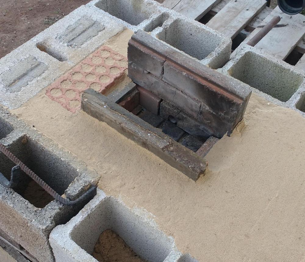

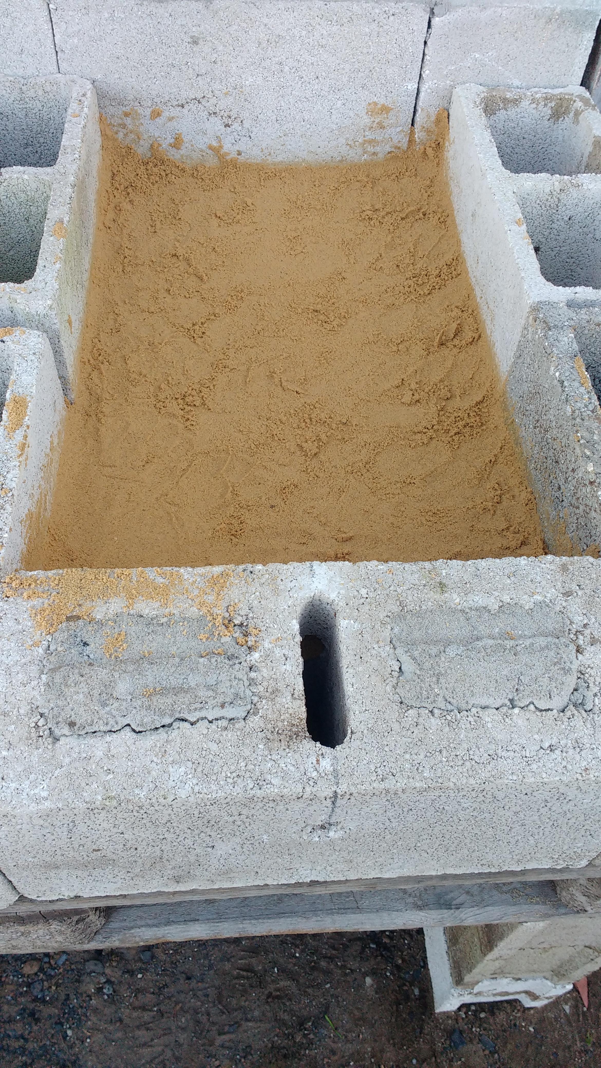

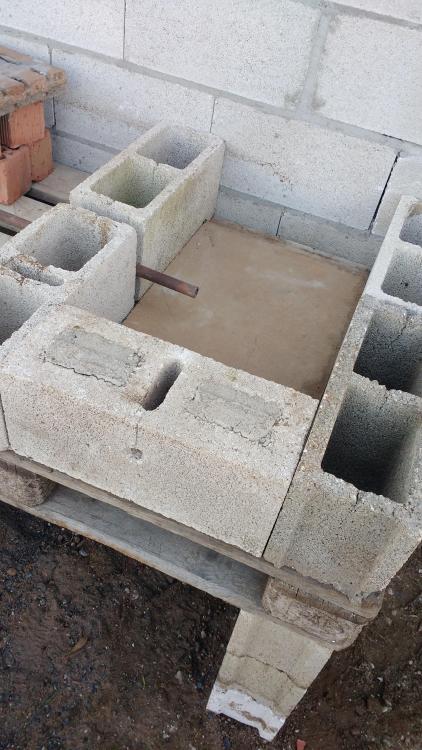

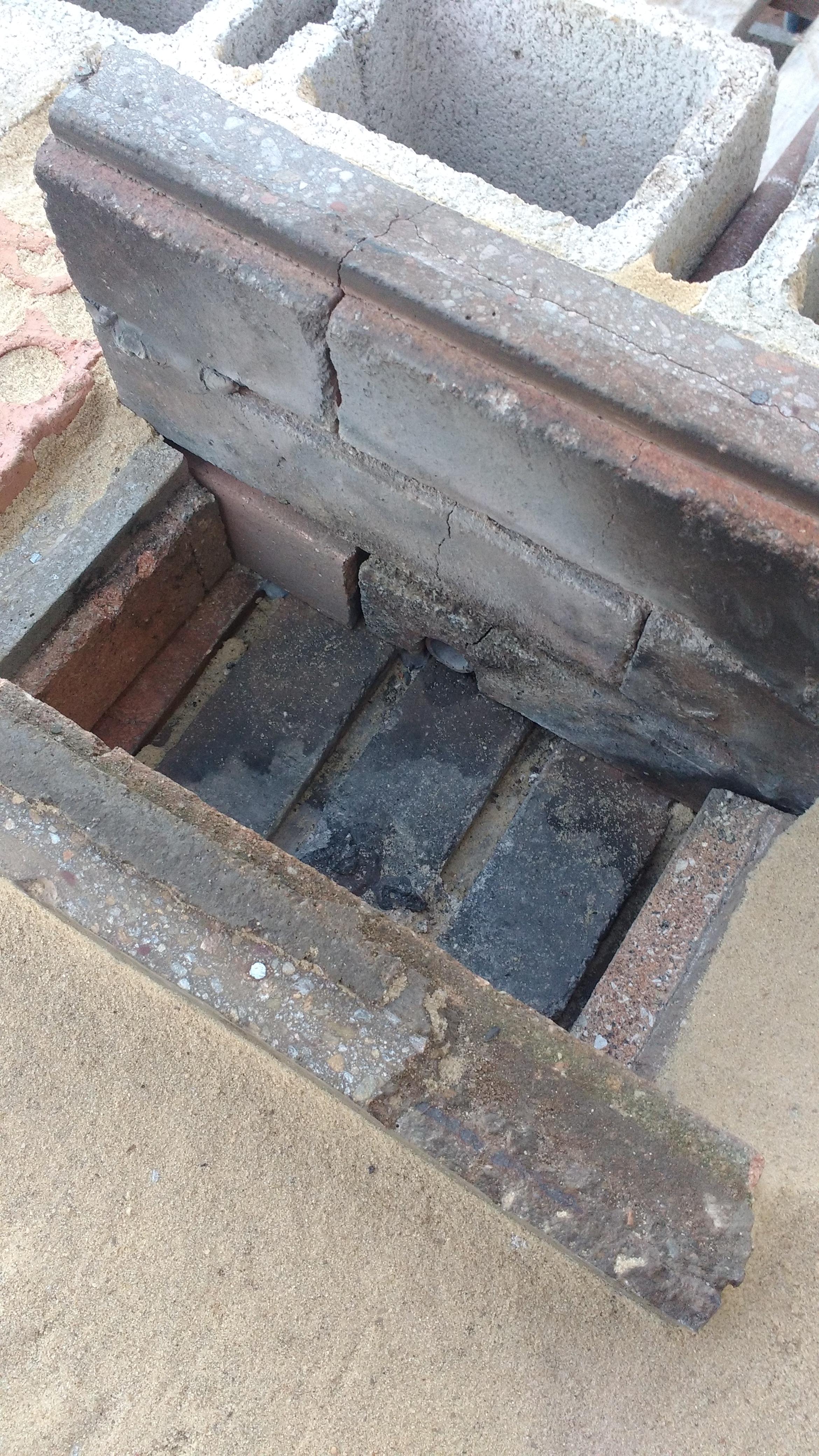

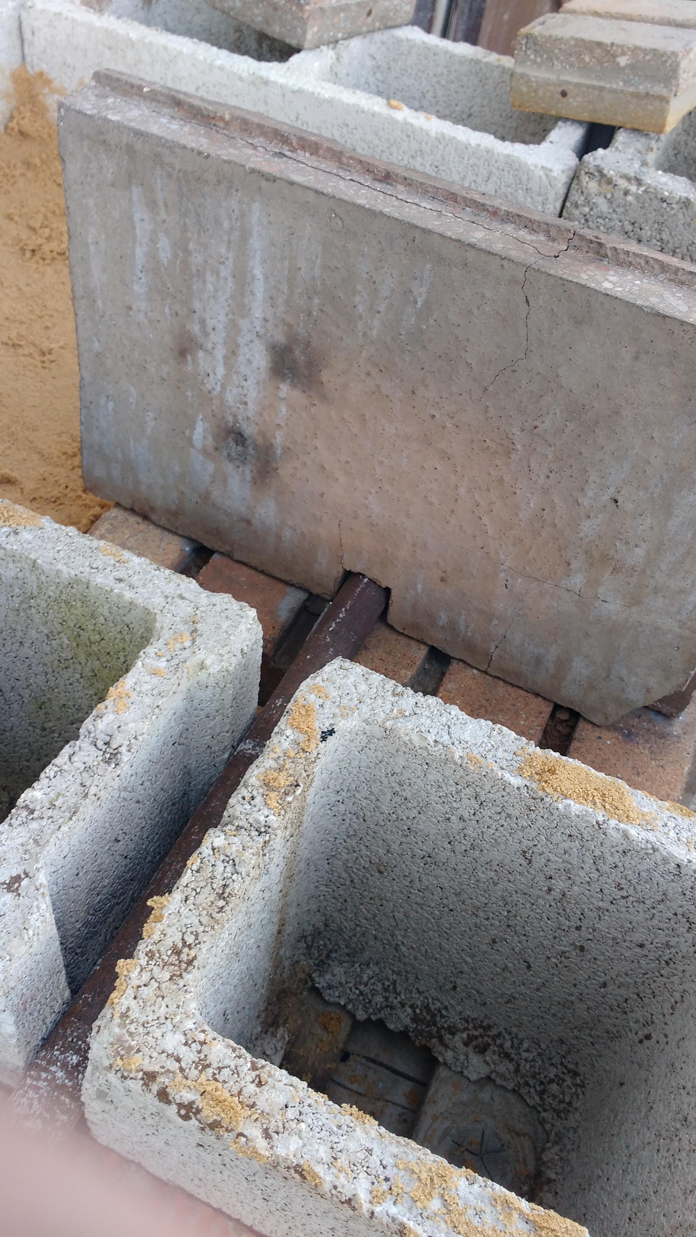

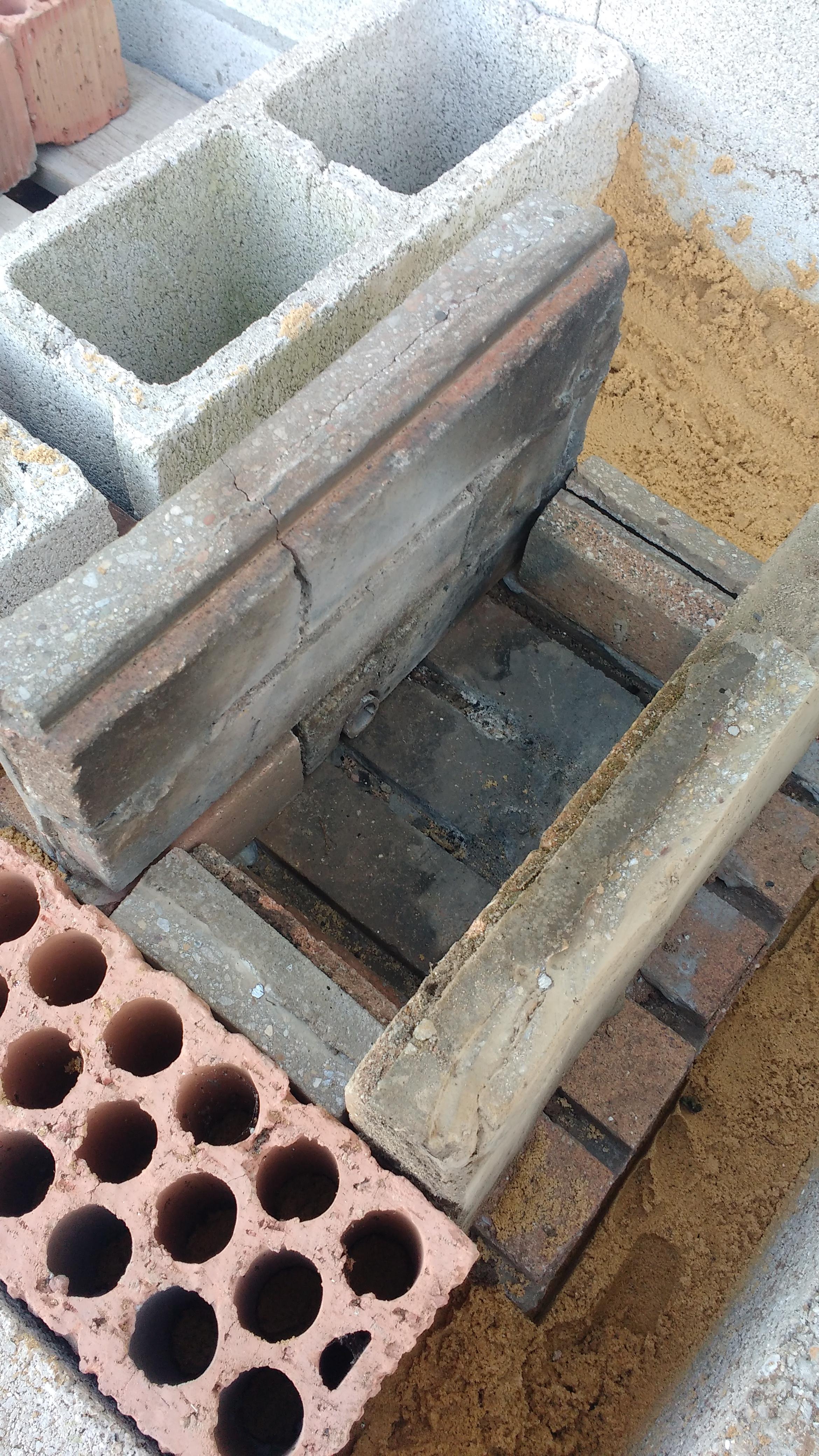

  10. Here's my take on a JABOD, thanks everyone for sharing your valued knowledge which gave me the insight for my creation. I took all my inspiration from this awesome site. My initial thoughts were to keep everything as simple as possible and using materials I had at hand or that can be sourced easily. It may not be the prettiest but it's easy to erect and dismantle without the need for cutting or screwing timber together. The basic idea is to stand a pallet on top of some blocks to create the platform at the desired height and then arrange blocks to hold the dirt, sand or whatever material you choose to hold everything in place. I went with a 2 x 1 block formation which leaves plenty room to move stock around comfortably. The blocks to the left have a slight gap to enable the tuyere to be inserted. Ideally a block should be placed at the back but I'm just butting up against my workshop for now. A scrap piece of ply stops the dirt falling through the slats in the pallet. I didn't have any fire bricks or regular bricks to hand to make the sides which would most likely be used. I found a slab of refractory fireplace bricks that had been reinforced with some sort of mortar and steel at my local refuse site so cut this to size. I've used this several times already in my first attempt at a jabod and so far it's holding up fine but will no doubt have to be replaced in the near future. Instead of having the bottom of the forge just dirt I used a piece of the refractory which is sat on a 2" bed of sand. Next was to add the sand, but dirt will do just as well. It's basically to hold the sides together. The dimensions of the pot are roughly 8" long by 4" wide and 2" deep. I've been using a mattress inflator for air feed aimed at the tuyere from a distance of a few inches which works great but it's noisy and a pain to drag a cable outside. I'm going to try using my battery operated leaf blower which has a neat setting to adjust the 'revs' from low to high and anywhere in between and leave it running hands free. It barely whispers at low setting and is no way near as noisy as the mattress inflator. I'm new to this in every respect so any feedback or suggestions for improvement are more than welcome. Gonna fire her up tomorrow!
  11. Thank you for the feedback and advice. I'm going to ditch my original plan and settle for something more traditional and safer. I've found some really cool ideas for a proper stand just browsing this site. Seasons greetings all
  12. Yeah the cinder blocks are a bit fragile but I'm going to beef them up with rebar and then fill them with concrete then later clad with wood. The materials I have kicking around after building my man cave so won't cost me anything. Hopefully it will hold up
