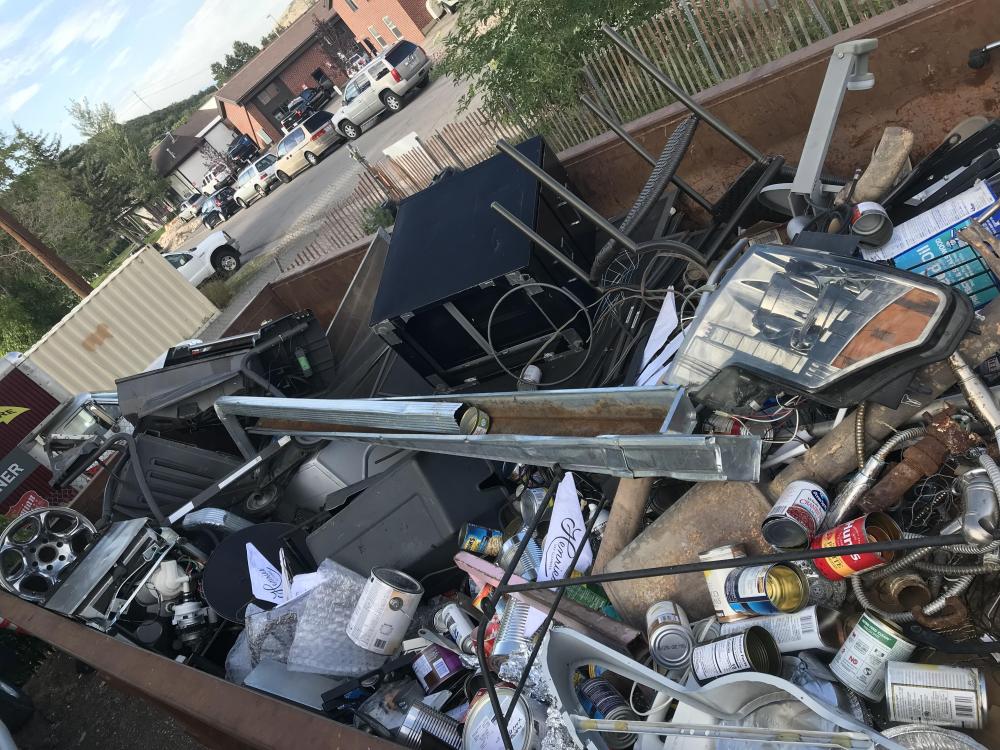

Now what I didn't bring home:
Forge bodies
Note the RR rail cattle guard thrown out above the tanks.
Improvised anvils: chunk of 4" thick steel
RR Rail in a more easily dealt with size:
