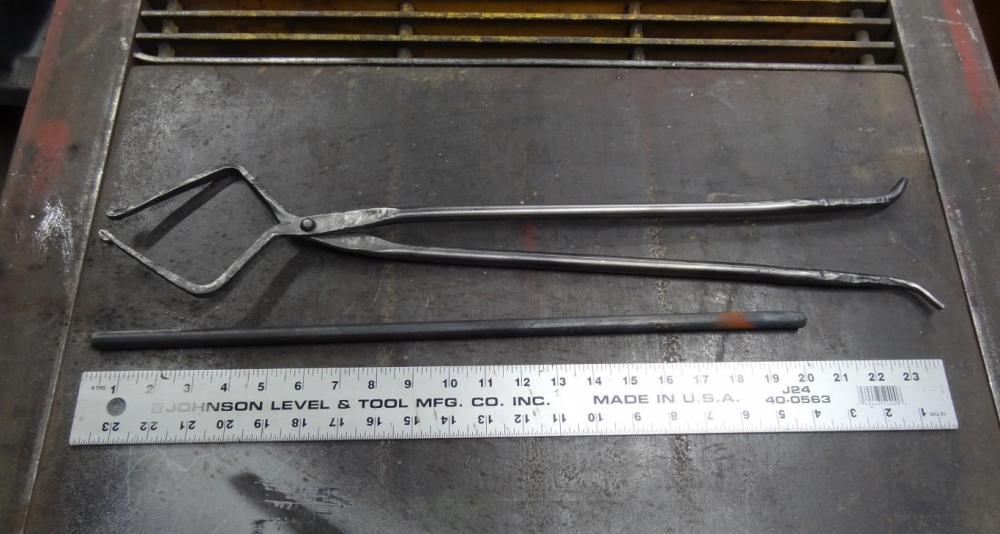

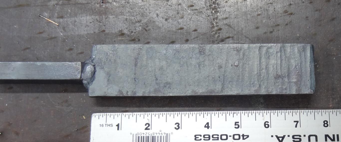

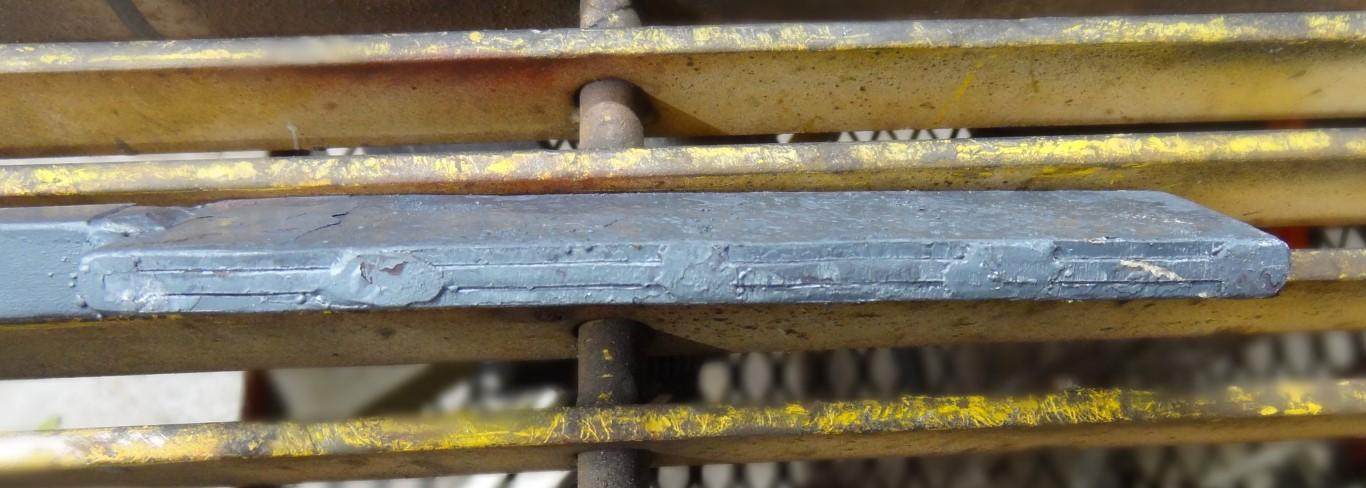

Going to try a few folded eye hawks, but had no hammer/hawk tongs. So today I made this crude pair from 20" pieces of 1/2" round. Amazing how hard it is (for me) to get the second tong handle to be a nice clean mirror image of the first one. Ha. Also tried another dry weld test project, 1/8" 1084 sandwiched between two pieces of 11 gauge mild sheet. Welding went fine, so I did a "test" flat grind on one side of part of the resulting billet and etched it. Very happy it went so well, I really like the look of a dramatic transition line between MS and HC, I actually like the looks of low-count san mai better than zillion-layer "damascus". Now I'm gonna have to make some knives that way. -
