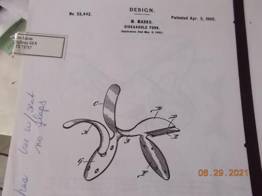

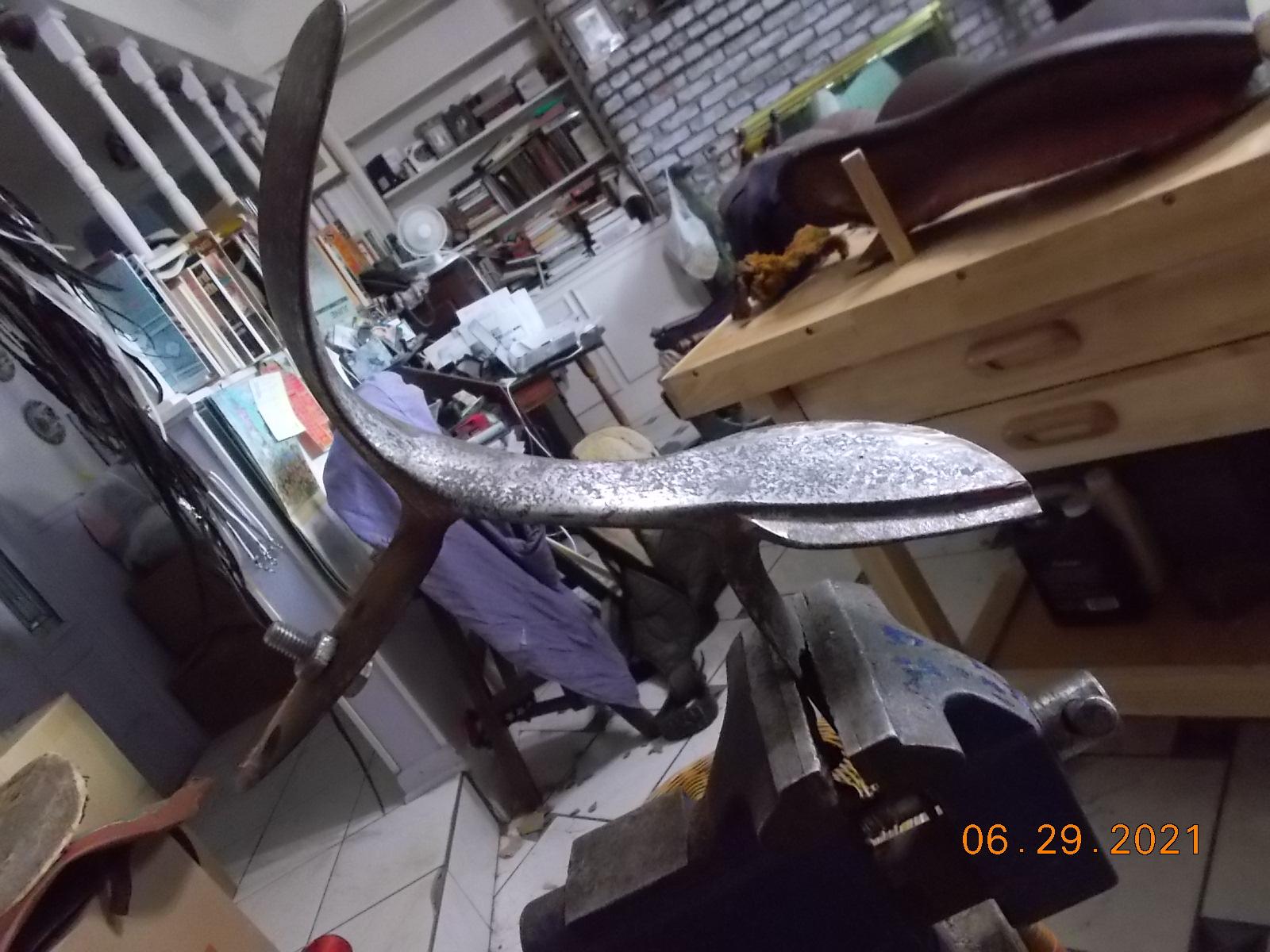

sidesaddle queen Posted June 29, 2021 Author Share Posted June 29, 2021 cast iron sidesaddle fork ductile or normal cast iron?? will only sparks tell?? lol!! can you use your magic wand and tell me..?? Quote Link to comment Share on other sites More sharing options...
Frosty Posted June 29, 2021 Share Posted June 29, 2021 Deb says NO to using my wand anywhere else. I doubt the type cast matters. If a gal riding can put enough force on it to break it she'd be safe. The poor horse would be laying on the ground. The pic is bringing up more scenes from the Mel Brooks head movie. The voices want more pics! Something very like that is now part of the dwarf's hat. Oh yes, the voices are positively chattering! Frosty The Lucky. Quote Link to comment Share on other sites More sharing options...
ThomasPowers Posted June 29, 2021 Share Posted June 29, 2021 Time period? (What was available at that time?) Quote Link to comment Share on other sites More sharing options...

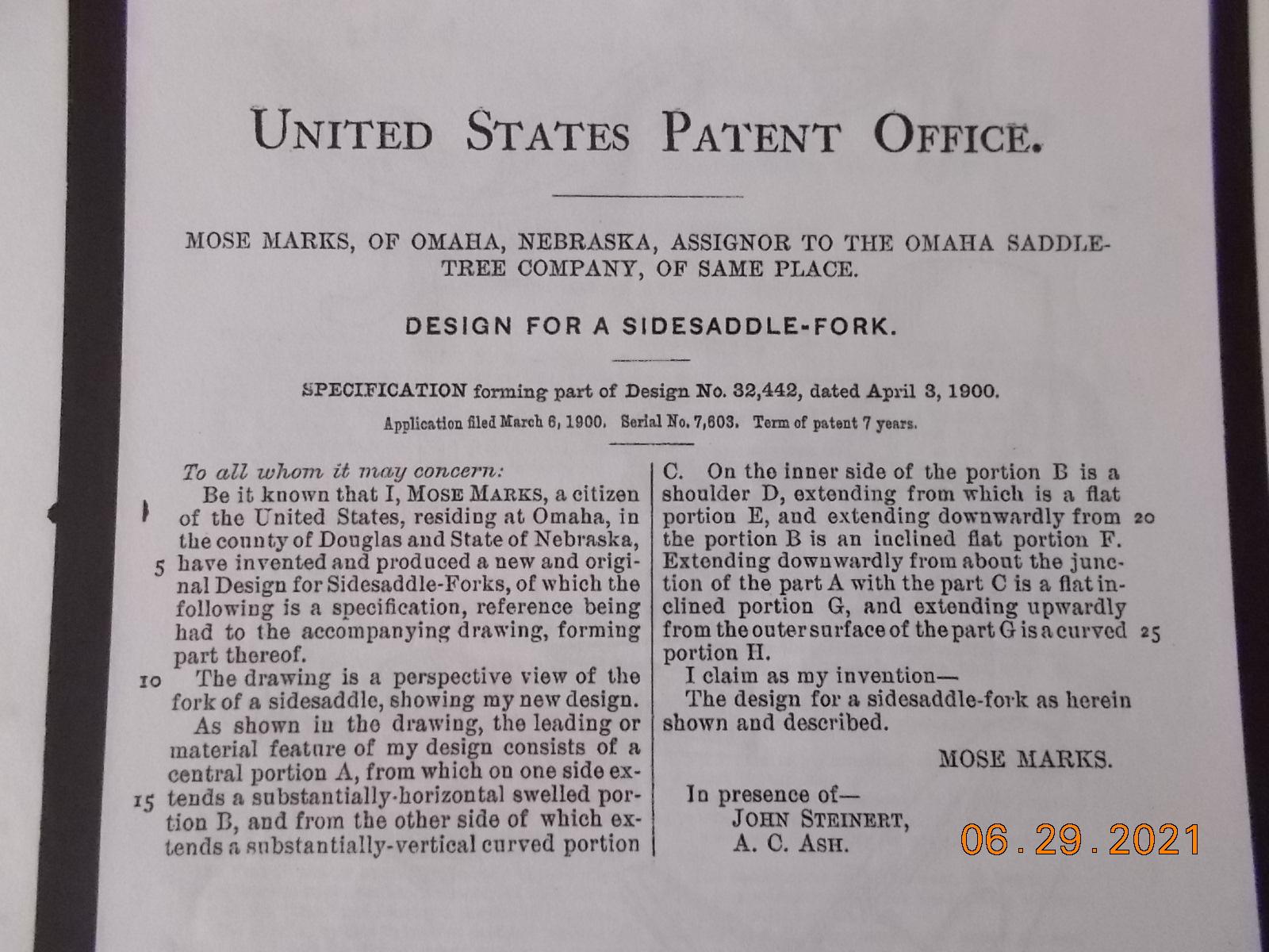

sidesaddle queen Posted June 29, 2021 Author Share Posted June 29, 2021 do not want to break it.... want to reshape it,, from a saddle made in late 1890s-1905 american patent is 1900 could be older than 1890s but not real way to know,, things changed slowly back then. Quote Link to comment Share on other sites More sharing options...
JHCC Posted June 29, 2021 Share Posted June 29, 2021 Ductile cast iron wasn't invented until the mid-20th century, so that wouldn't be it. It might be malleable cast iron (which has been around a lot longer), but I wouldn't recommend trying to reshape it. Quote Link to comment Share on other sites More sharing options...

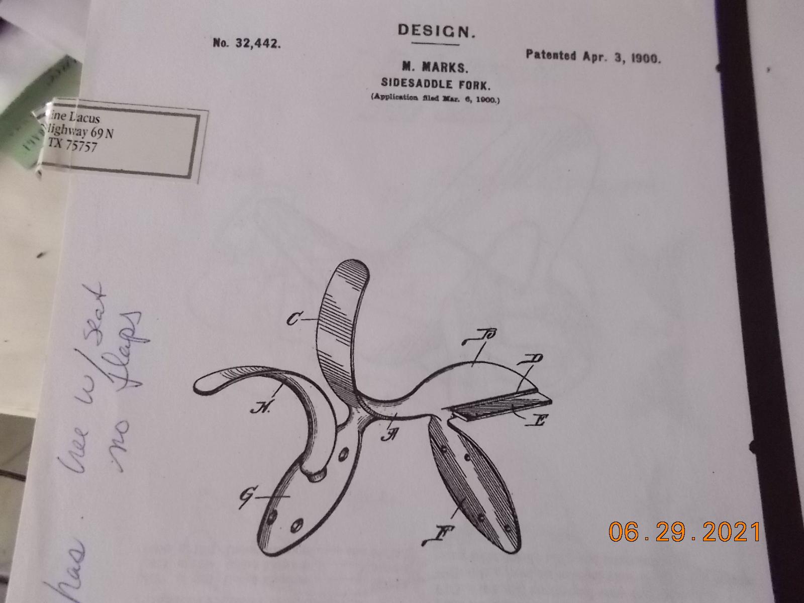

Frosty Posted June 29, 2021 Share Posted June 29, 2021 Outside of cutting and grinding reshaping is unlikely to be successful. Not unless you WANT to break it up of course. The patent drawing helps me visualize the thing. Definitely the Dwarf Hat! More bobbles and bling of course but that's the right shape. Hmmmmm, now the voices are sending a "Time Bandits" buzz. Frosty The Lucky. Quote Link to comment Share on other sites More sharing options...

sidesaddle queen Posted June 30, 2021 Author Share Posted June 30, 2021 i own time bandits but do not remember the pink bunkadoo.. lol!! will have to watch it again,, i searched malleable cast iron and understand the differences now, thank for the info... i never knew about malleable cast iron ..lol!! what ever the the leaping horns are made of they do bend under extreme force.. like a horse falling on them but it seems i will not be able to heat them and reshape.. so. i guess i will have to make new ones and replace them,, another reason for me to learn to forge.. lol!! there is a guy making replacement horns but they are coarse and not shaped right,,, can be reshaped but i had to have a friend completely rebuild the one i bought so why buy one from him at all,, Quote Link to comment Share on other sites More sharing options...

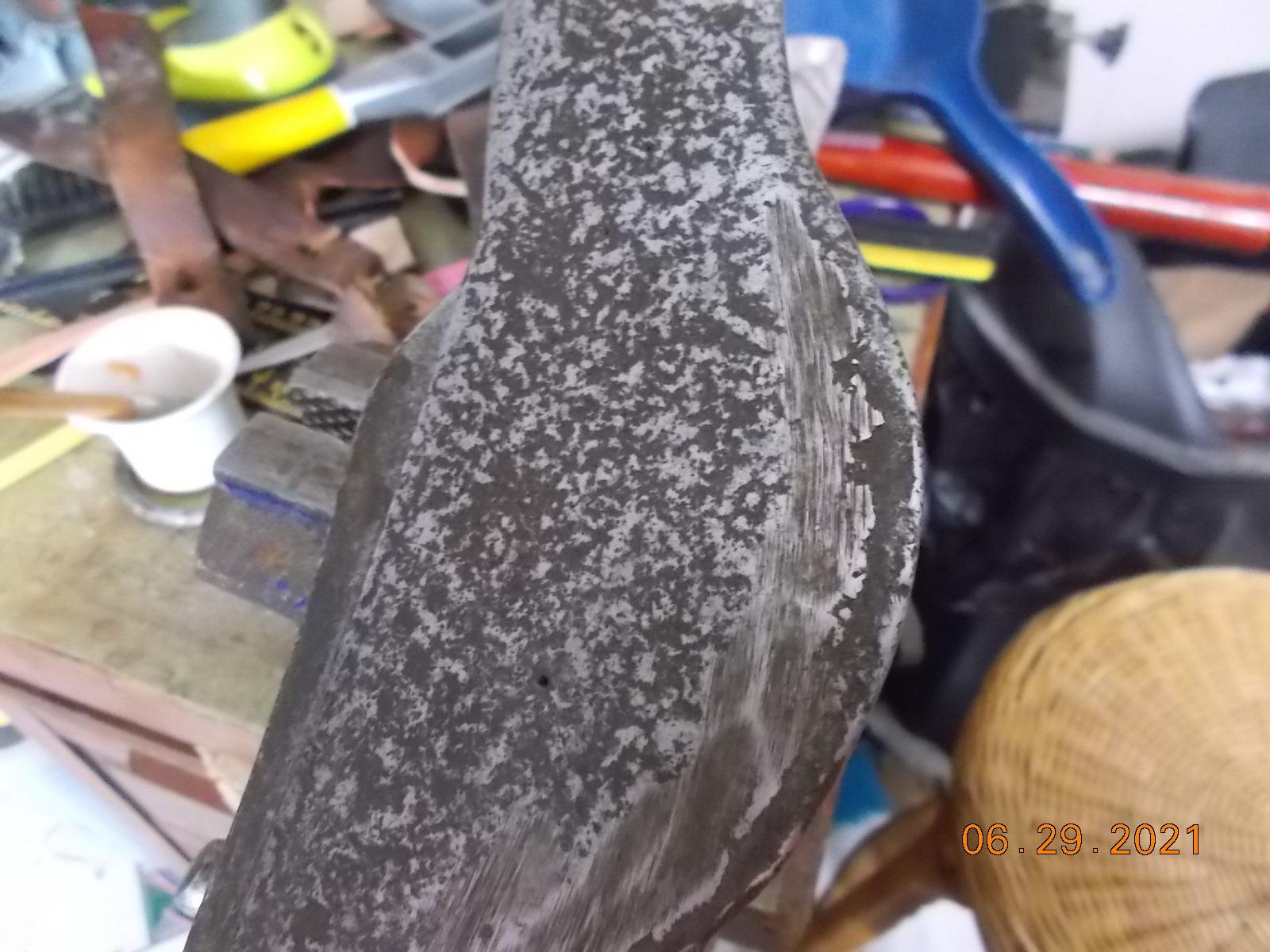

sidesaddle queen Posted July 1, 2021 Author Share Posted July 1, 2021 what color will the sparks of malleable cast iron be?? i am pretty sure that metal these sidesaddle components are made of.. i dropped the pommel fork off the work table when i shifted the saddle parts .. it hit my tile/concrete floor with a bounce,, luckily, it didn't break my tile but did bend the corner of the flange on the fork.. so.. like bronze, a sharp hit can make it bend rather than fracture,, i found that very interesting,, so i tried to straighten the bent corner with a small 8 oz hammer and a 2lb hammer .. i was able to move metal with both.. fixed the corner like it never happened.. thoughts?? Quote Link to comment Share on other sites More sharing options...
