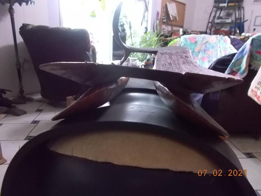

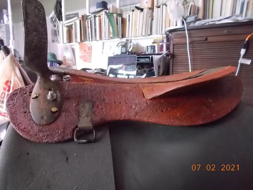

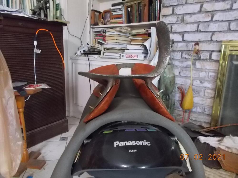

sidesaddle queen Posted June 9, 2021 Share Posted June 9, 2021 hi, many times my sidesaddle trees need the leaping head (the part that goes over the thigh) reshaped, either to fit the new owner or because it is bent , either in a horse fall or mishandled thru the yrs,, most are easy to do and can be heated and shaped like any mild steel but lately i have come across some that are cast. sad to say the first cast one we ruined not realizing what it was .. broke it in half because we spot heated it.. snapped like a popsicle stick!! lol! now when i find a cast one i do not try to change it .. if badly bent ,, i have to replace with a newly built one which is expensive .. plus, i like to keep them all original if i can,, recently i read there was a ductile cast iron that could be heated and shaped.. is the true and if so how can i tell the difference,, Link to comment Share on other sites More sharing options...

sidesaddle queen Posted June 9, 2021 Author Share Posted June 9, 2021 thy are very very old saddles... 120 -150 yrs i understand what cast iron is,, i just didn't expect it in a sidesaddle part that is normally shaped to fit the rider.. so i blindly forged ahead..lol!! pun intended and asked a friend to heat it and rebend it,, i told him to hea the whole thing but he decided he knew better and just quickly tested the spot e was going to bend.. lol!! he was so surprised.. lol!! some sidesaddle were cheaply made, like saddles now and they probably cast them because they were making them all the same shape and size rather than bespoke/custom the one i broke was very bent.. curled up . but it might have been made that way to fit a thin thigh.. lol!!! thank you so much , i knew there was a spark test but didn't have that in my info!!!! so, another question.. could the cast leaping heads be mild steel cast ?? rather than cast iron? and the rough texture fooled me?? i will see if i can dig one up.. i had one made to place the one i broke,, Link to comment Share on other sites More sharing options...
