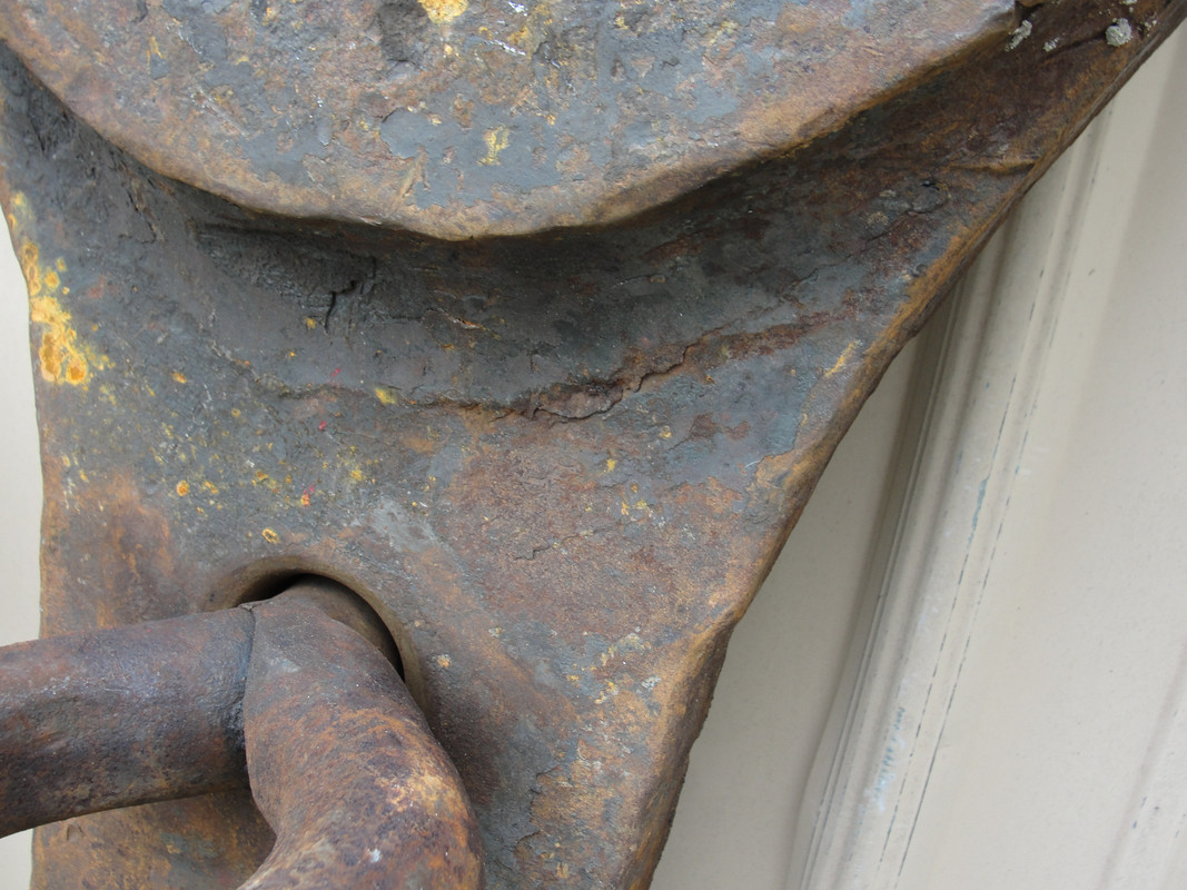

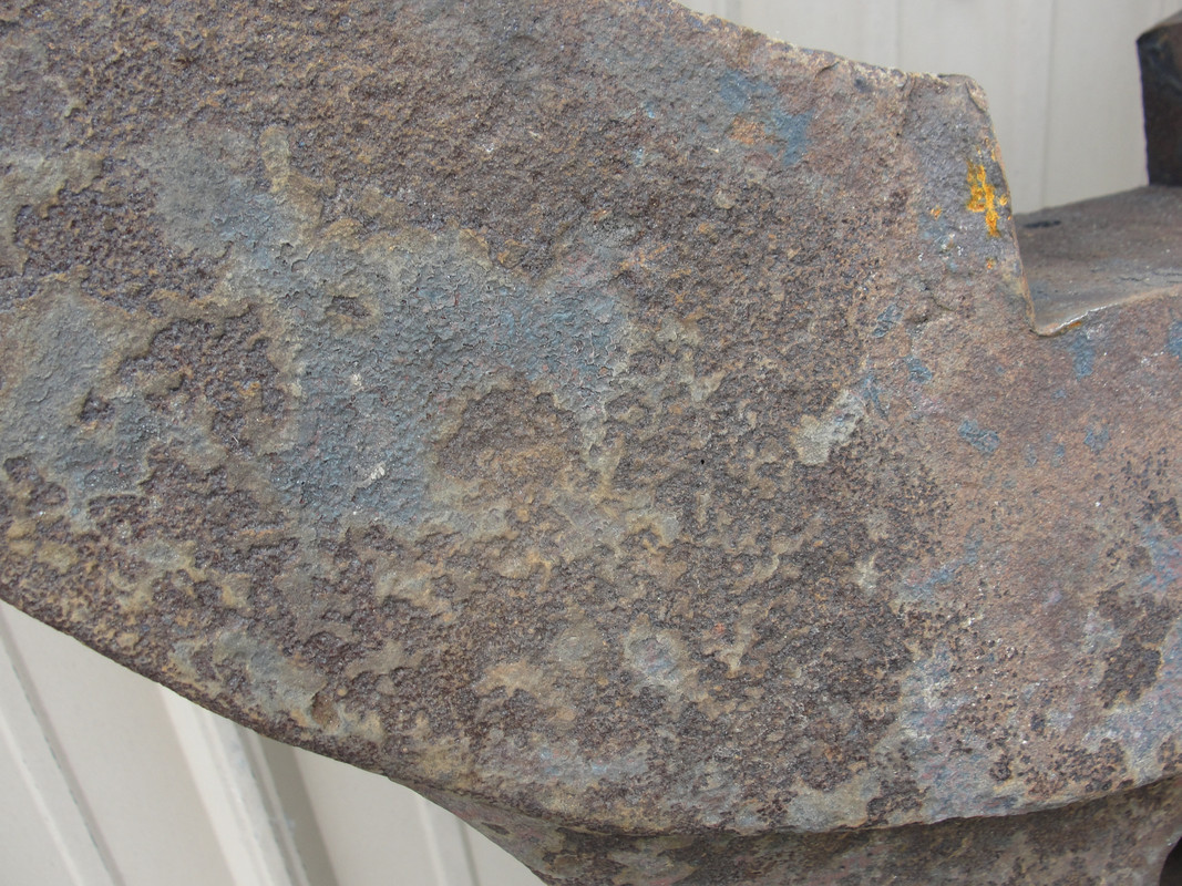

The simple way to tell a casting from a forging is that with a casting the various marks tend to be raised from the background while in a forging then tend to be stamped in. That is not definitive but is generally true. With respect to telling the difference between materials, a spark test is helpful. Cast iron in its various forms will have a different spark pattern than the steels. Also, steels will generally ring if tapped with hammer while gray cast iron will not. These are all just ball part trials but they can get you fairly close. They are not all non-destructive and telling the differnece between cast ductile iron and cast steel by site or the ring test could be pretty tough.
