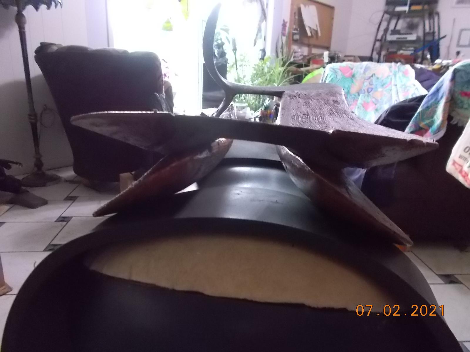

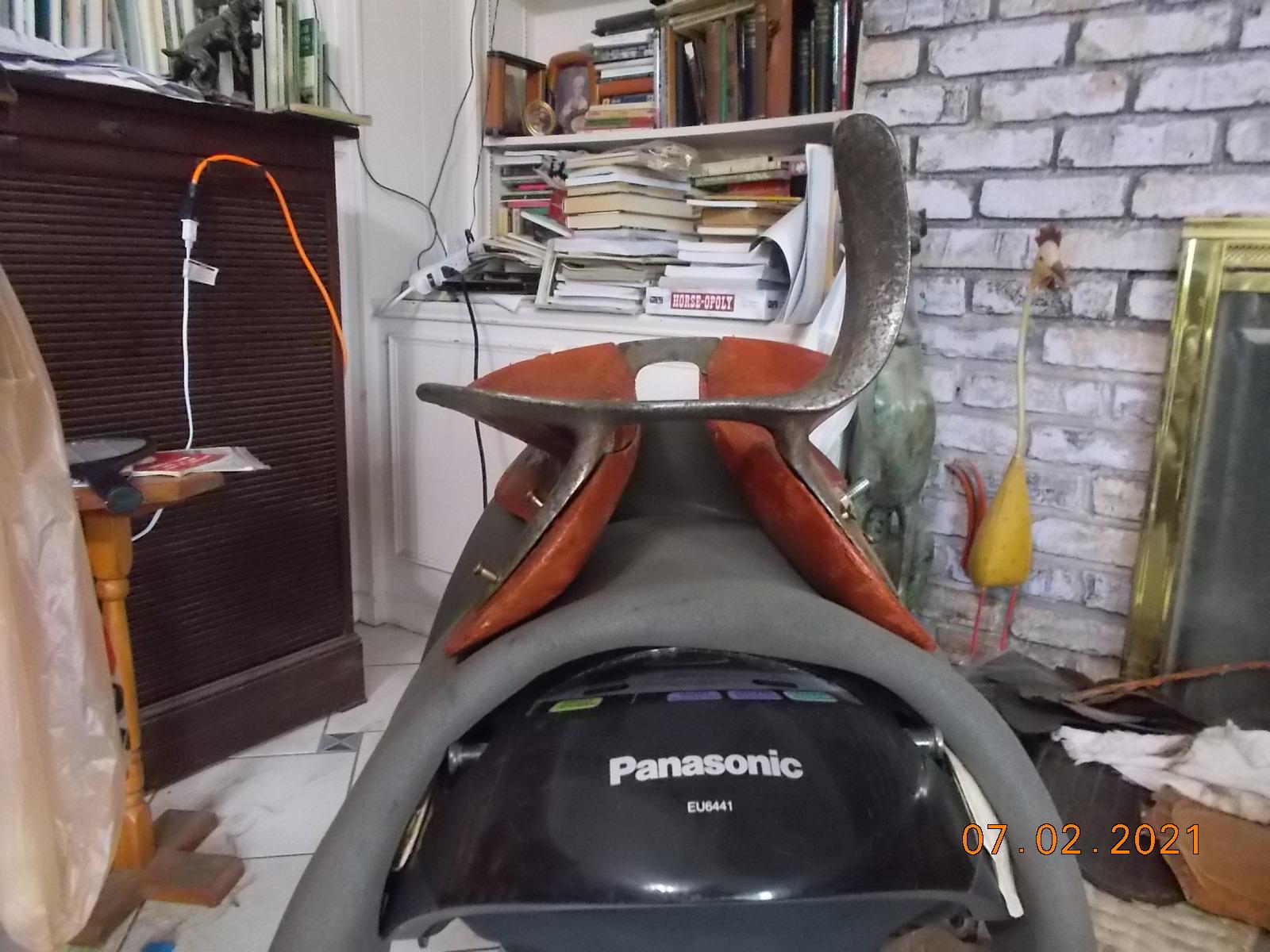

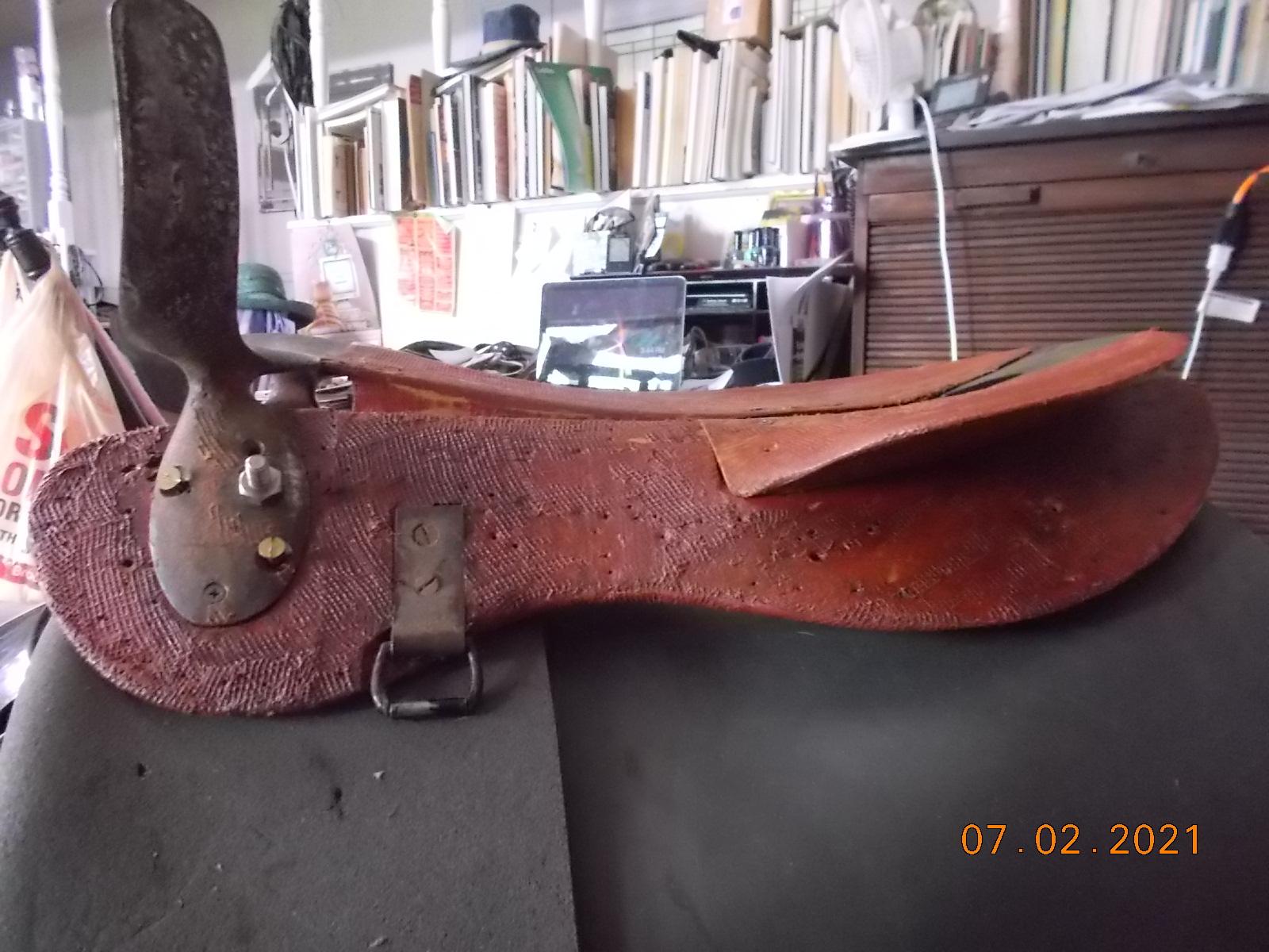

saddle with cast iron fork and cantle piece back together and ready for leather,, she turned out pretty.. important since i am a girl...  lol!!

I for one know very little about the innards of a saddle, so it's interesting to see one... skinless? naked? in the process of construction? Not sure which descriptor is best. It is pretty though.

they are very sculptural , i collected as art way before i started riding them.    they are so different form each other ..  each tree maker has his own idea of what would work,,  many don't lol!!
i call it  a bare tree ...
i am making wax copies of the metal work this week.. then will put the saddle back together and put it on a horse,,
