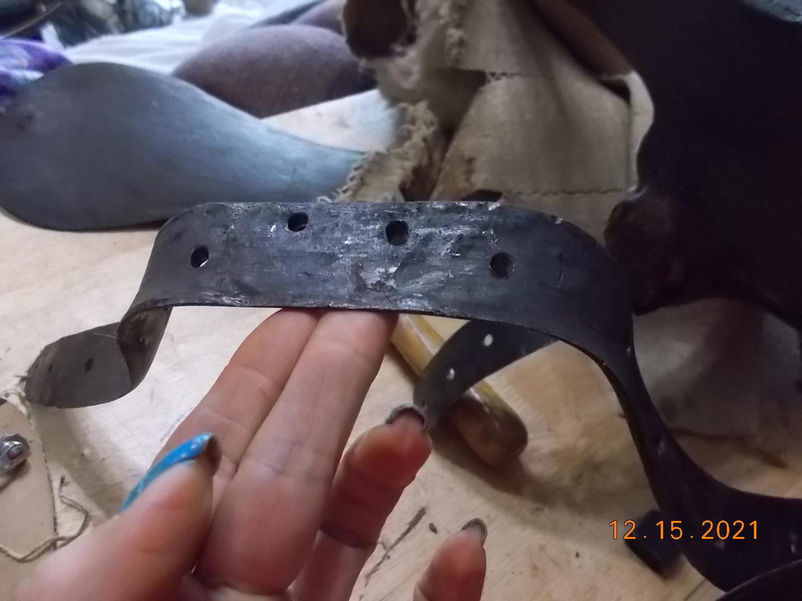

i have been heating it up in the spots i wasn't to move but the result shifts of the rest of the metal has created issues.. lol!!! i understand the metal but can't find the correct process to make it happen i can tweak the ends no problem, i can move them cold or heat with a hand torch..but the center and first 2 bends are 1/4 thick.. it will not bend cold , the twists and turns of the piece do not really show in the photos.. i need to get a torch but though i would see if i could do it with my forge.. by annealing the whole thing i can reshape it to the new wood shape.. tweaking 1/4" thick 1 1/4" wide piece like this needs heat to do it right.. the rider's safety depends on it

lol! sober might be better,, hehehe, i proofread it , i promise.. i am always sober now days.. maybe some wine would help.... thanks for the info.. i have read and studied but hearing it in simple terms is nice.. i only have a small gas forge.. i can heat all but 4" of the long point , but i do not need to reshape the part much so i figured it would be okay.. i wish had a torch, i know how to a torch for all kinds of things.. .. i used mine in sculpting but i gave it to an old boyfriend and never got it back.. lol!! the money from this saddle repair will buy me an new one i bought a larger gas forge but don't have it set up yet..

the forging is the original work.. i am trying to rework it.. working small areas is not the way to go.. it is moving where i don't want it to .. not much but enough there is tiny areas of daylight i can't have that.. so i am thinking annealing all of it and making the whole thing sober will be easier to reform it.. if i anneal it to make it easier to work.. what color to heat it to? Burning it in to the wood to fit is what caused part of the damage to begin with, so that is not a choice,..

the rebuilt wood tree front.. with gullet iron in place, the metal goes from 1/4" in the middle tapering to 18 g at the points with curves everywhere.. lol!! you can see the forge marks near my fingers..

HI!! thanks, for the quick response!! I am working with a gullet piece from a late 1890s saddle that is forged ..thick center to thin ends ..it is driving me crazy trying to reshape.. I was thinking about just annealing the whole piece and then reshaping it.. what color should I take it to?? When I repaired the tree I made it wider to fit a modern horse.. lol! not thinking about the gullet steel.. it is a biomorphic Form and the changes I need are small, but, that makes it harder.. hehehehe. it is above my skill range .. for the moment.. so I can weld a piece of modern mild steel to the old stuff for repair?? that would help a lot.. save me some time too. I have been rebuilding the whole piece if part of it was missing. I am doing great!! lots of saddle work getting done, starting to work some horses , even rode a couple... and finishing halter breaking my foals so I can sell them... it is warm here so I am playing outside as much as possible,, how are you..?? getting any forging done?? want to see a photo??

I work a lot with older mild steel on my sidesaddles.. I was wondering about the changes in composition and if there are things should or should not be done to the old metal.. do they anneal the same way?? can I weld them together ??
