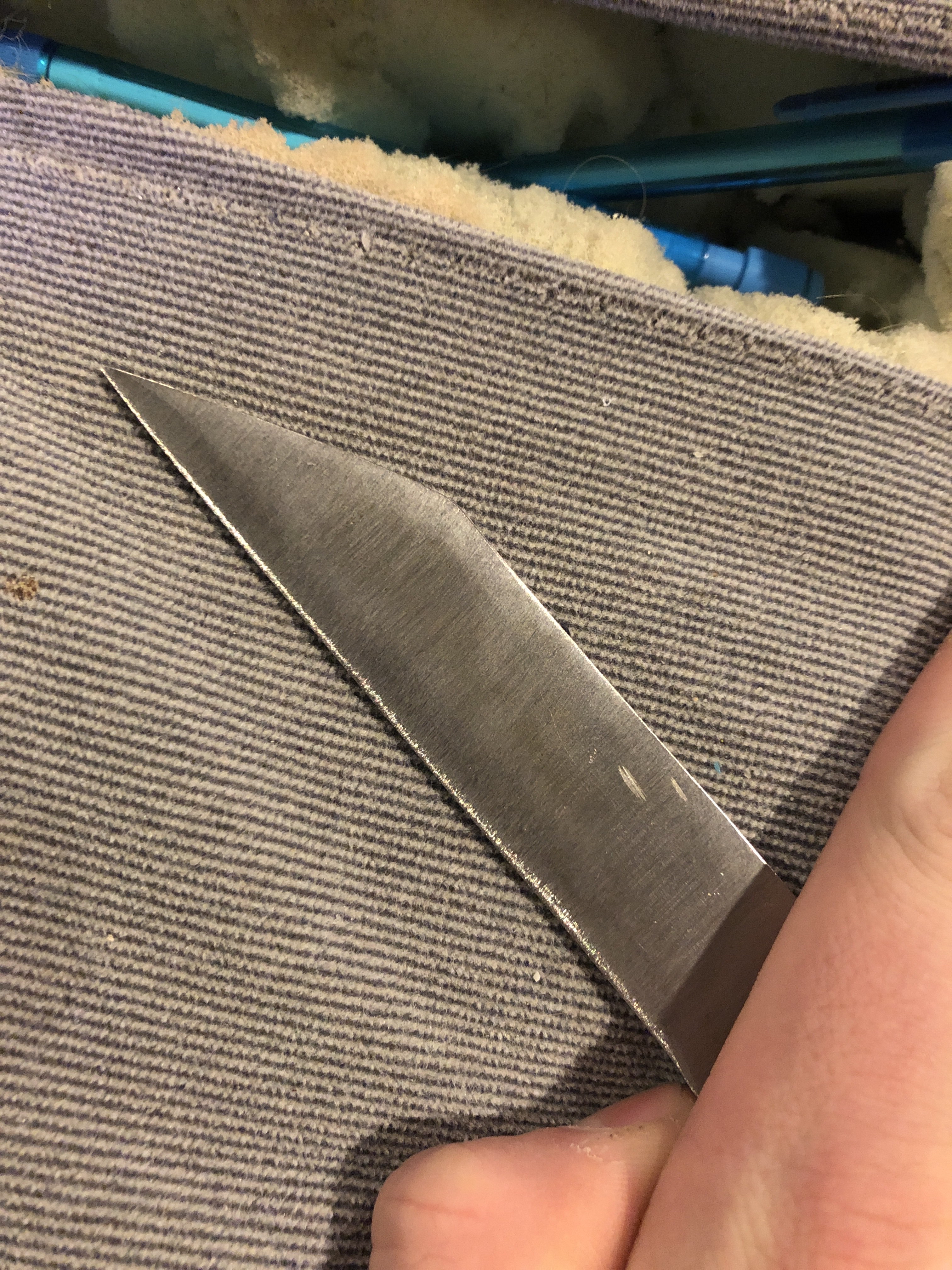

Kexel Werkstatt Posted February 17, 2021 Share Posted February 17, 2021 Little more work done on my first Yakut knife. I don't like how the shape of the tip ended up, but I can adjust it somewhat. Otherwise it's almost done. There is a scary sharp edge on it and I haven't even hardened/tempered/finish sharpened yet. Handle will be a spare piece of hammer handle I have stuck aside. Quote Link to comment Share on other sites More sharing options...
George N. M. Posted February 17, 2021 Share Posted February 17, 2021 Kex, is that an old file or do I just see filing marks? I only sharpen blades as a last step because of safety considerations. If you HAVE to put an edge on during the fabrication process cover it with tape while you are doing the rest of the work. Particularly if you are using power tools (belt grinder, wheel grinder, buffer, etc.) having your work piece "scary sharp" is just asking to have your precious bodily fluids scattered about your shop. Stay safe. "By hammer and hand all arts do stand." Will, check out the German group Corvus Corax. Also, google "White Man's Rain Chant." "By hammer and hand all arts do stand." Quote Link to comment Share on other sites More sharing options...
Frazer Posted February 17, 2021 Share Posted February 17, 2021 Plus there is no point (ha) sharpening before heat treating, that thin edge is going to heat up faster leaving it more prone to decarb/burning up/overheating. General best practice is to break sharp edges before hardening, not create them! Not the end of the world though it'll turn out fine. Looking forward to seeing it done! Quote Link to comment Share on other sites More sharing options...

Kexel Werkstatt Posted February 17, 2021 Share Posted February 17, 2021 Yes I got a little aggressive with the belt grinder... got caught up in the profiling and before I knew it, it was an edge. I'm going to knock it down a bit before I harden it for the reasons stated and I want to change the tip a bit anyway. I'm just surprised how dang sharp it is from just profiling it. Yes it is an old file George... scrap, dull file that I figured would be perfect stock for this. Nice convex side profiled, flat side with the fuller done. Thomas - I might go for a matching scabbard made from the same hammer handle so it just looks like a chunk of wood with some leather on it. Thanks guys! Quote Link to comment Share on other sites More sharing options...
