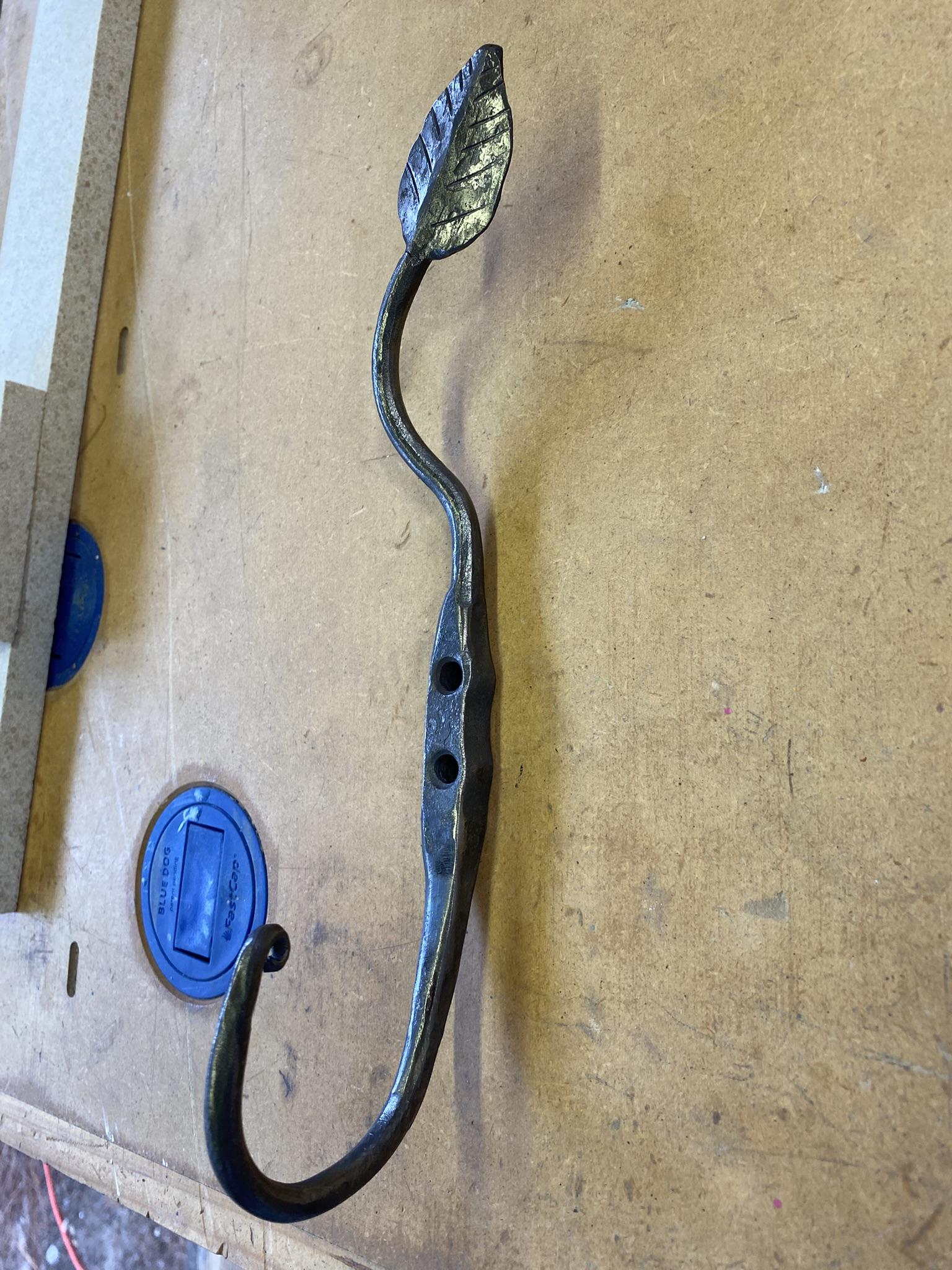

My wife asked me for a hook for the bathroom, and, of course, I dashed out to the smithy and lit the fire.
I took the opportunity to practice this Brian Brazeal/Alec Steele drawing out on the edges of the anvil technique.  It's almost clicking in my head.  I still reverted back to the horn after doing the very rough drawing out.  Overall, it was a good day.  I'm painting this one a gloss sage green because 1) she's done with black steel and 2) it's for our bathroom.
