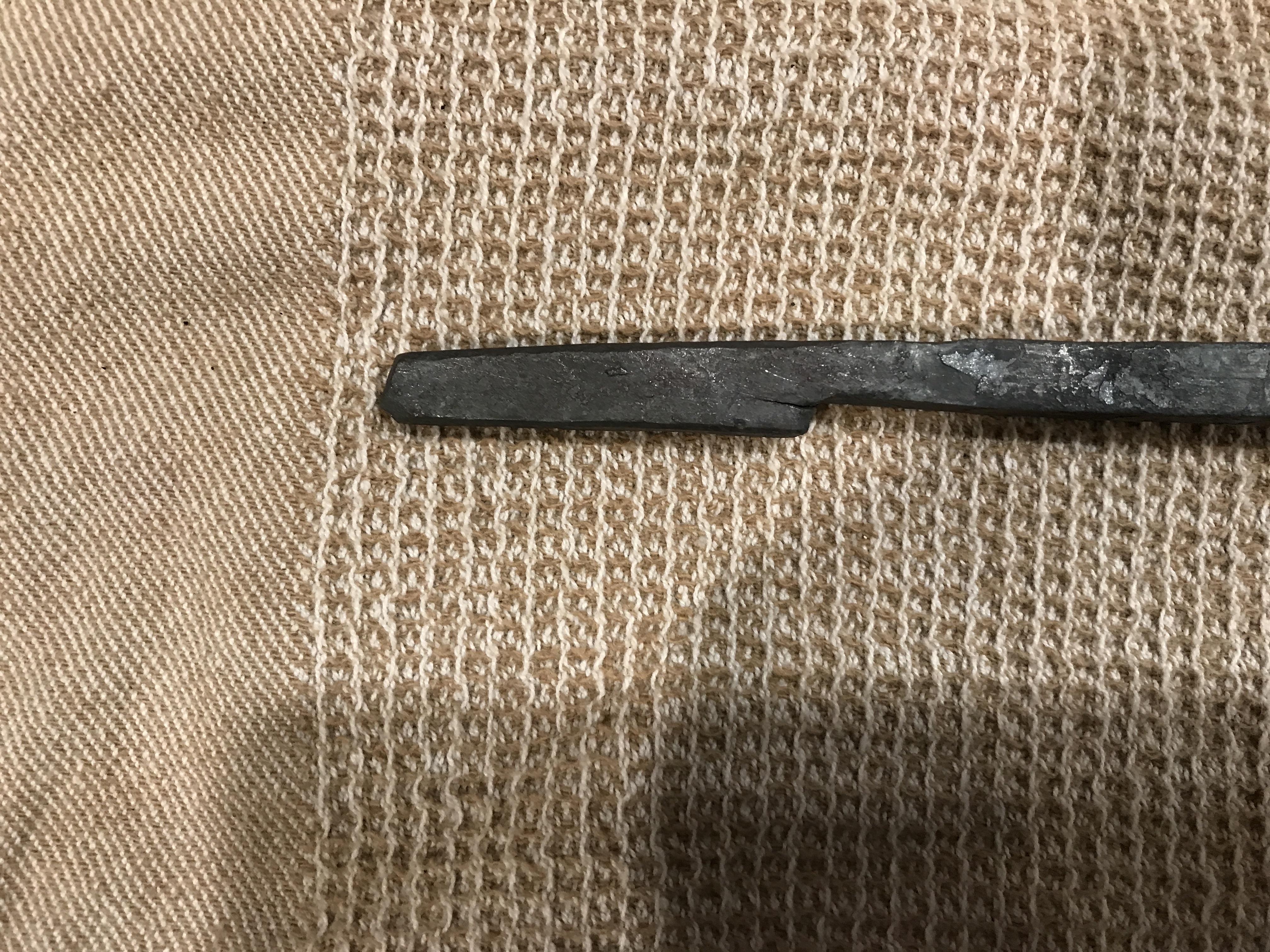

Picture of the actual cut or it didn't happen. :P
Really clean and can hardly see it now or i would.   Only reason I still have it wrapped is in case it springs a leak again.  Actually it's embarrassingly clean and small now that I really look at it.   Looked bigger when I realized what I did.  Kinda like when that 36 grit belt blew apart on the grinder and smacked me.  Lot of blood at first then, oh wait it's not that bad.

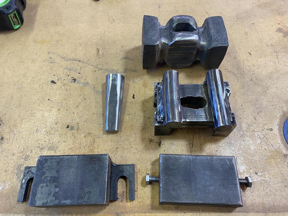

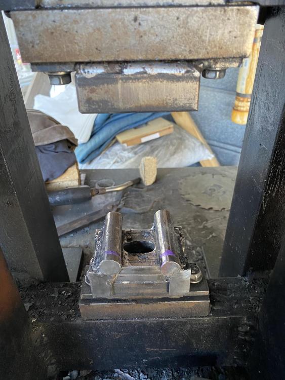

Finished the bolster today.  It will fit both my hydraulic press and the power hammer.  Tomorrow I'll try it out.

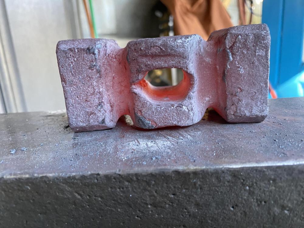

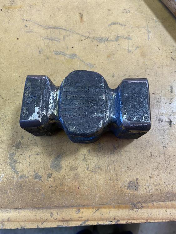

I tried out my drift and bolster on my hydraulic press.  Worked great, and knocking out the drift was easy.  After using the press, I was able to use my long drift and a hammer to max it out.  The only frustrating thing from today's session is the hole shrank back some.  I can't really over-size the hole, now, unless I make a larger drift.  I may just finish this hammer then make a larger drift for my next hammer.
I normalized it, then went to Walmart to buy 5 gallons of canola oil and a large enameled canning pot.

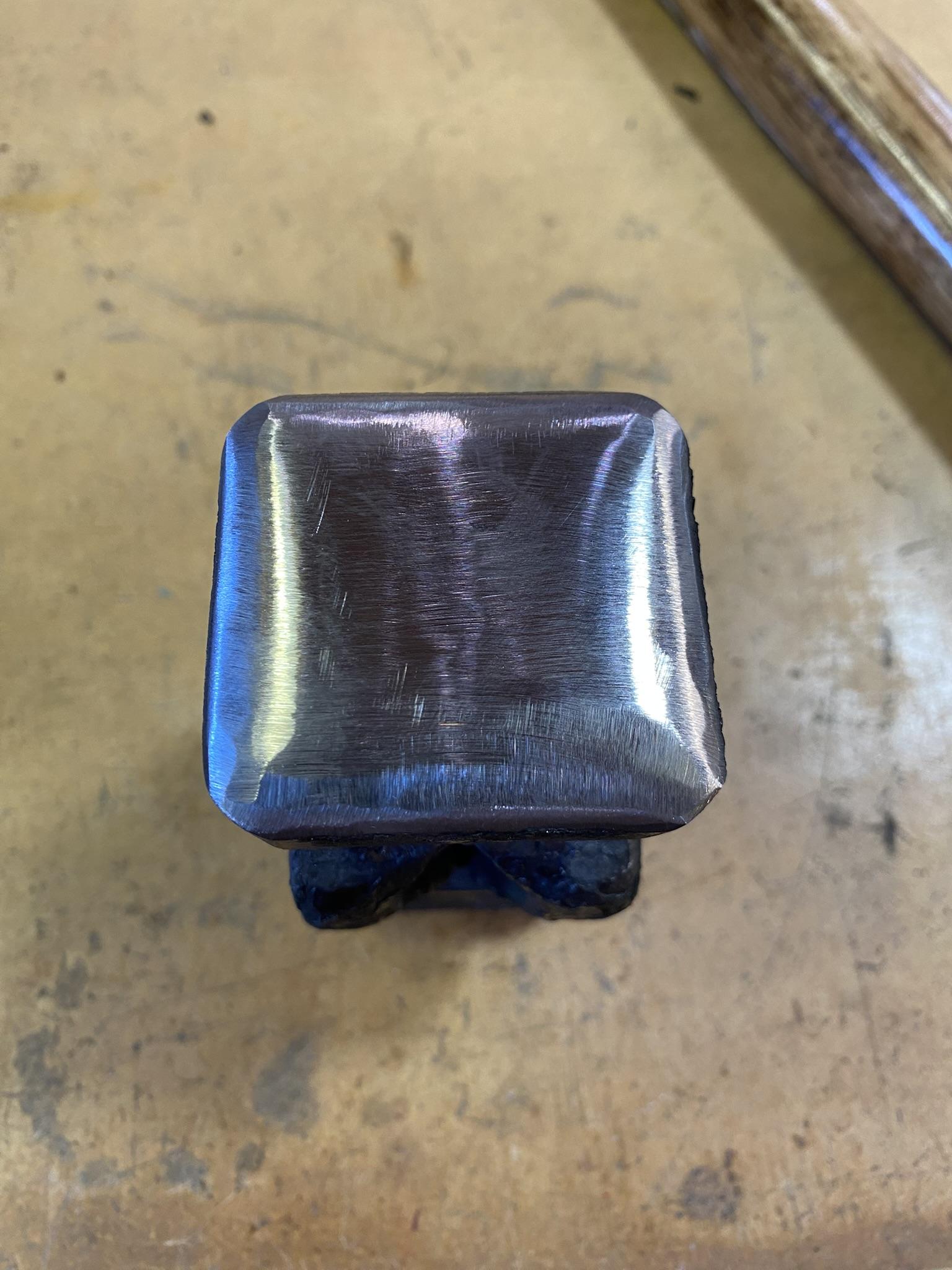

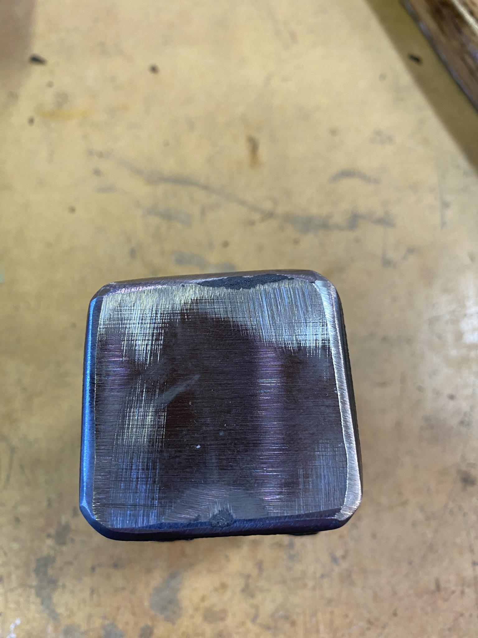

The faces are pretty square.  The camera perspective makes them look trapezoidal.
That'll move some metal! Looks great!

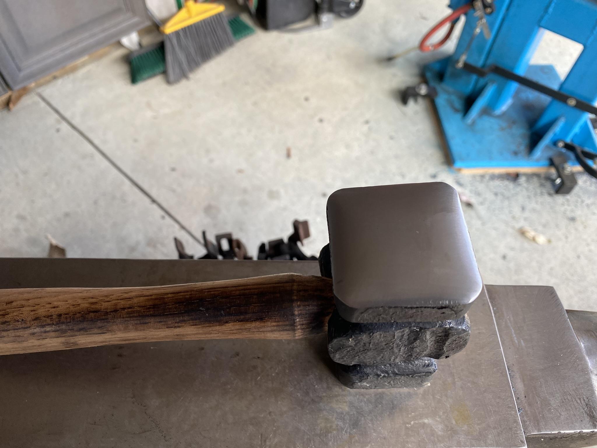

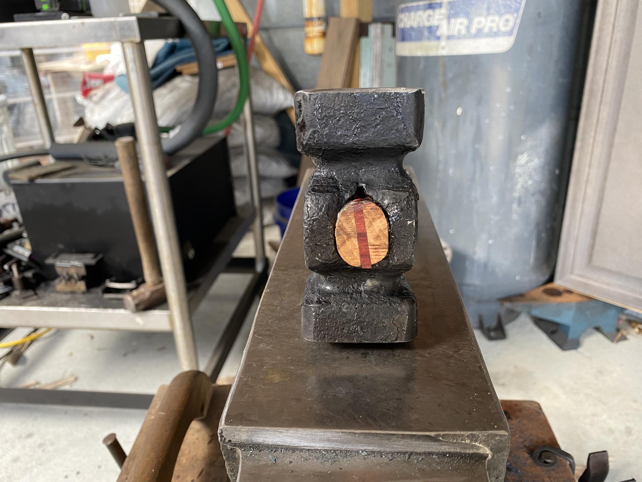

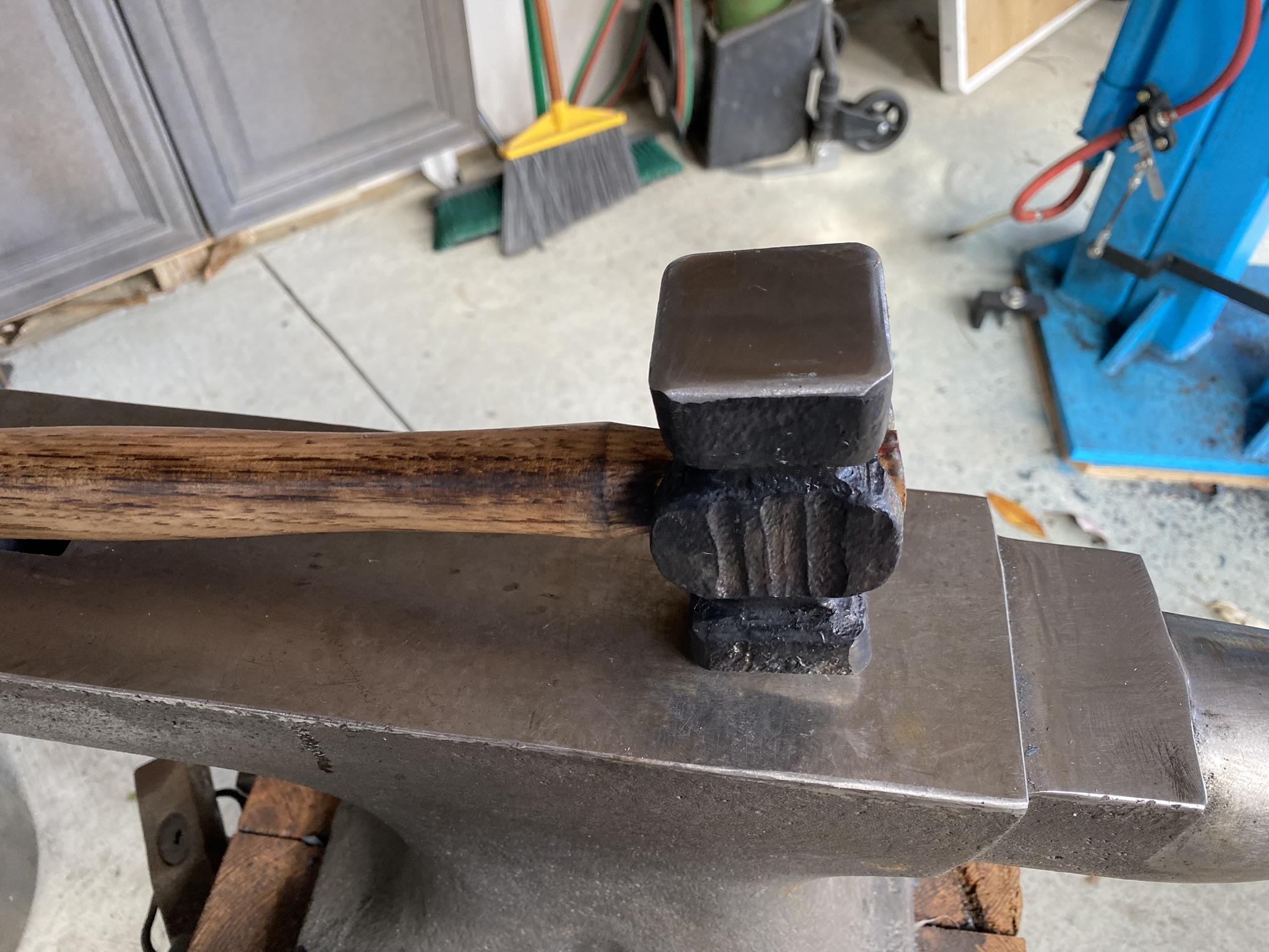

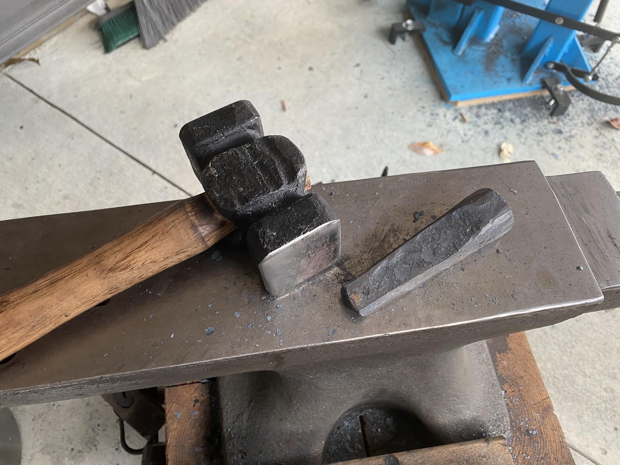

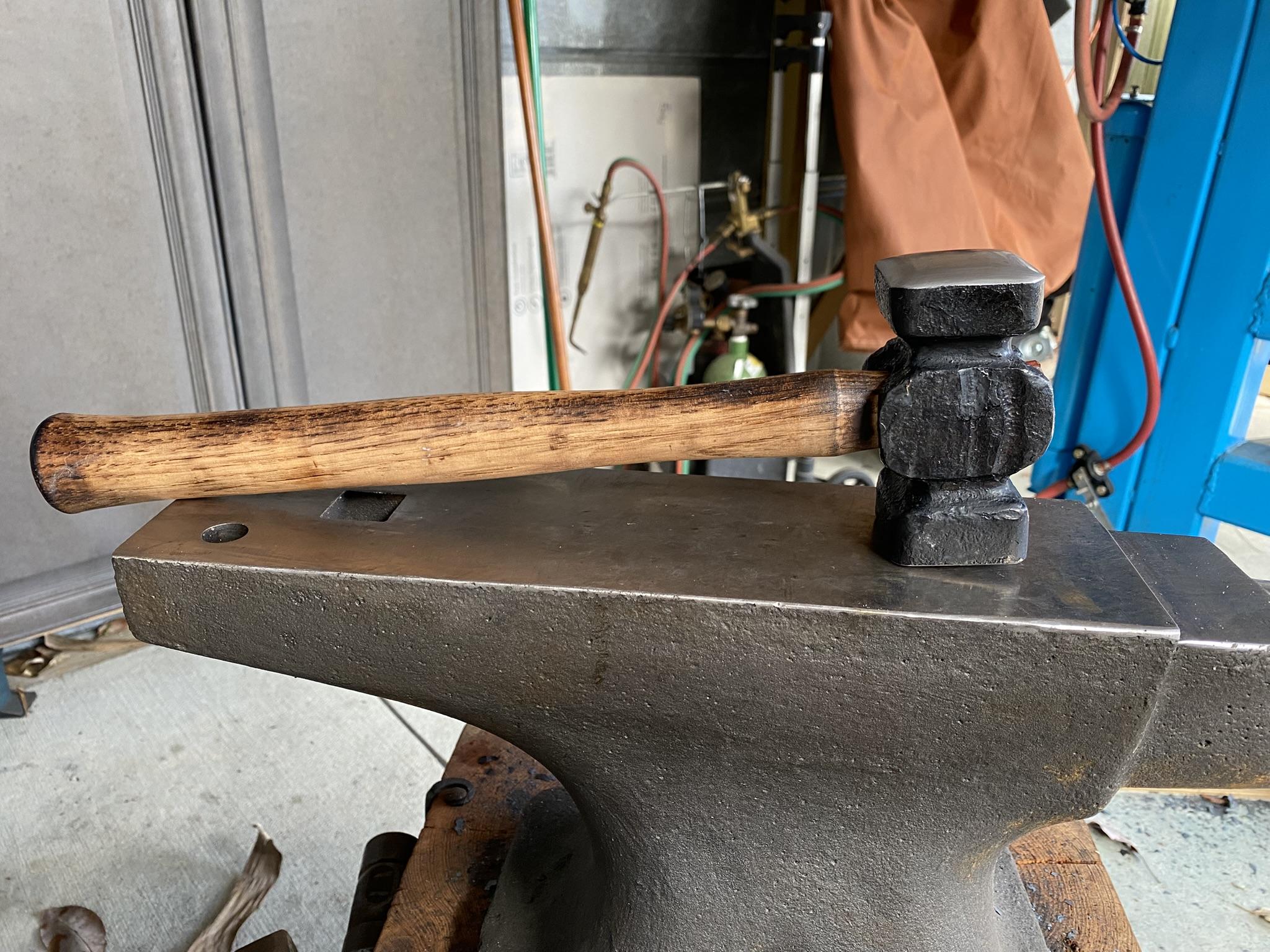

Thanks for the encouragement, guys!  I heat treated the hammer this morning and installed the handle this afternoon.  It has some flaws, but for my first hammer I'm pretty pleased with how it turned out. I used bubinga for the wedge.  I hate the way the metal ones look because they split the wood, but I may have to eventually use one.
It's got nice rebound.
Can't wait to use to tomorrow.
Soak the head in a pan of linseed oil. It will soak into the handle and swell it up.

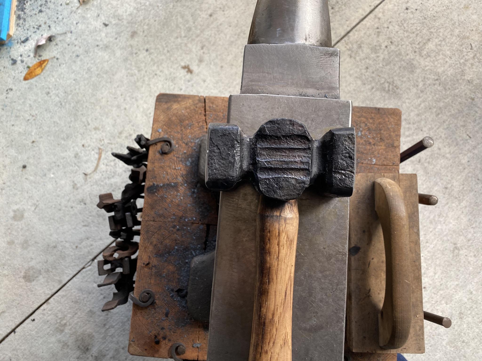

Your first hammer is beautiful. You did a great job keeping the eye in line with the hammer faces, and they themselves look good and smooth. Impressive work .
Nice hammer! You might want to soften the face edges just a bit more, but otherwise it's looking good!

I'll probably round over the edges more, but I wanted to try it out today.  I did most of the rough tapering on my power hammer, but did some finishing manually on this new, larger drift.  The hammer felt really good in my hands.

No boiled linseed oil in my workshop.  Lowes has it though.

No boiled linseed oil in the shop is kind of sacrilege as a blacksmith.
