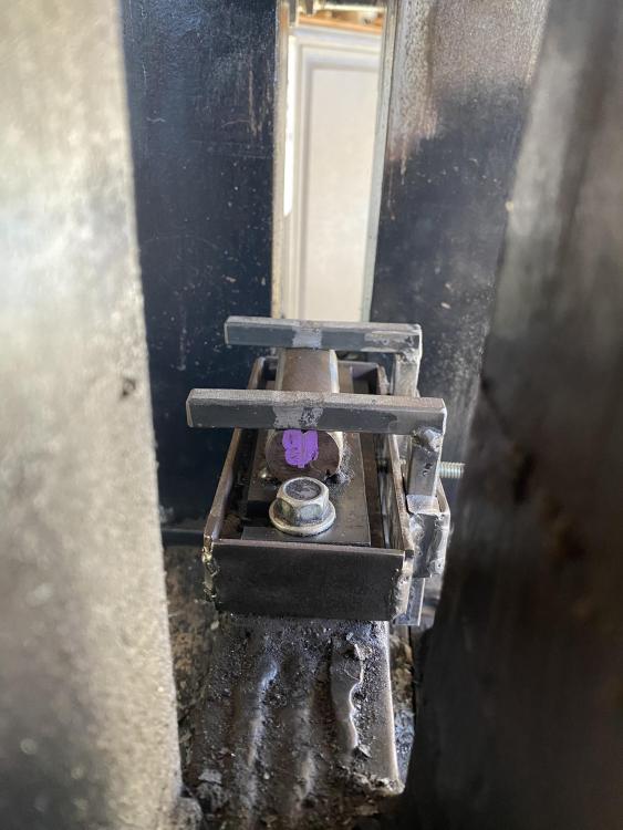

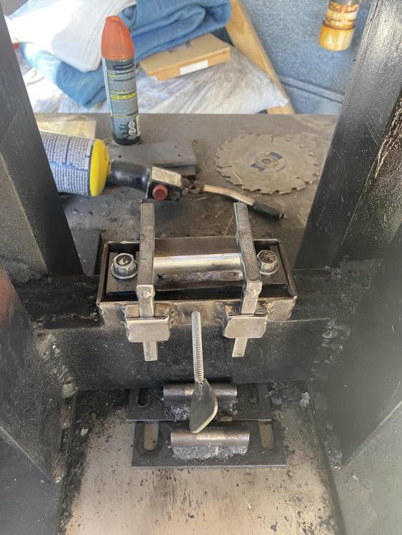

My DKE12 hydraulic forge press needed this jig to keep the operator (me) from over-squishing a work piece as it is drawn out.  The nice thing is I can easily make stops of different thicknesses by changing the top horizontal pieces while keeping the 3/8" square bar vertical pieces.
Good idea, Ridgeway.

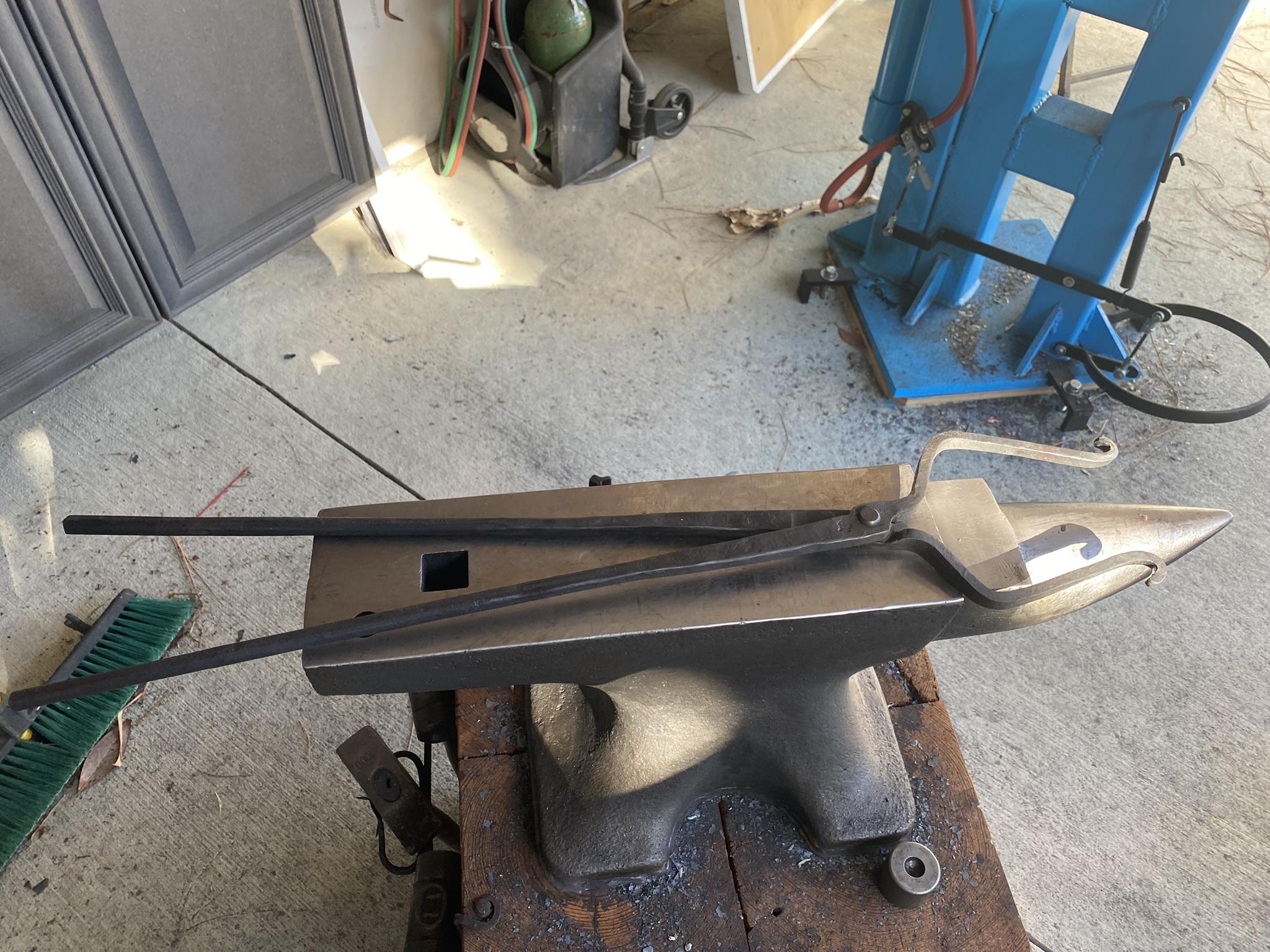

Lit the coal forge and finished my pickup tongs.  Compared to one of the first Ken's tongs I made years ago, it's pleasing to me to see progress.  I didn't even draw out and round the reins.  :lol:

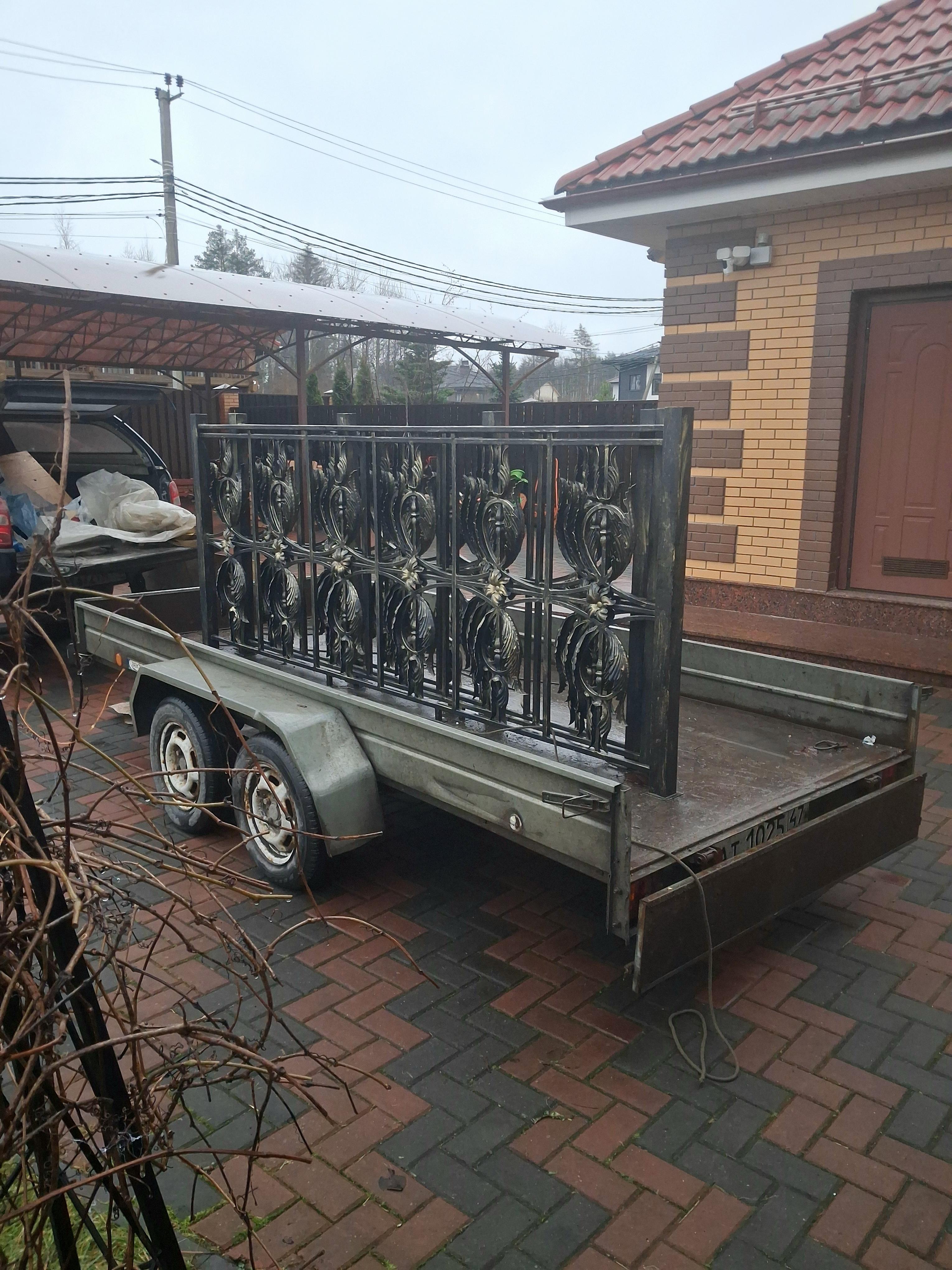

Saturday turned out to be a very busy day. In the morning, I went to the other end of the region to install a barrier on the highway at a bathhouse. In the evening, I went to Gatchina. My wife and I stopped at our favorite pub. We quietly downed five liters of beer, although my usual limit is no more than half a liter. And then there was a night stroll through the city on New Year's Eve.

Your work is as masterfully beautiful as always Alex.
Looks like a beautiful walk in Gatchina amongst the lights. 5 liters!:o Deb and I couldn't get outside that on a party night. I'd actually enjoy half a litter on occasion.
