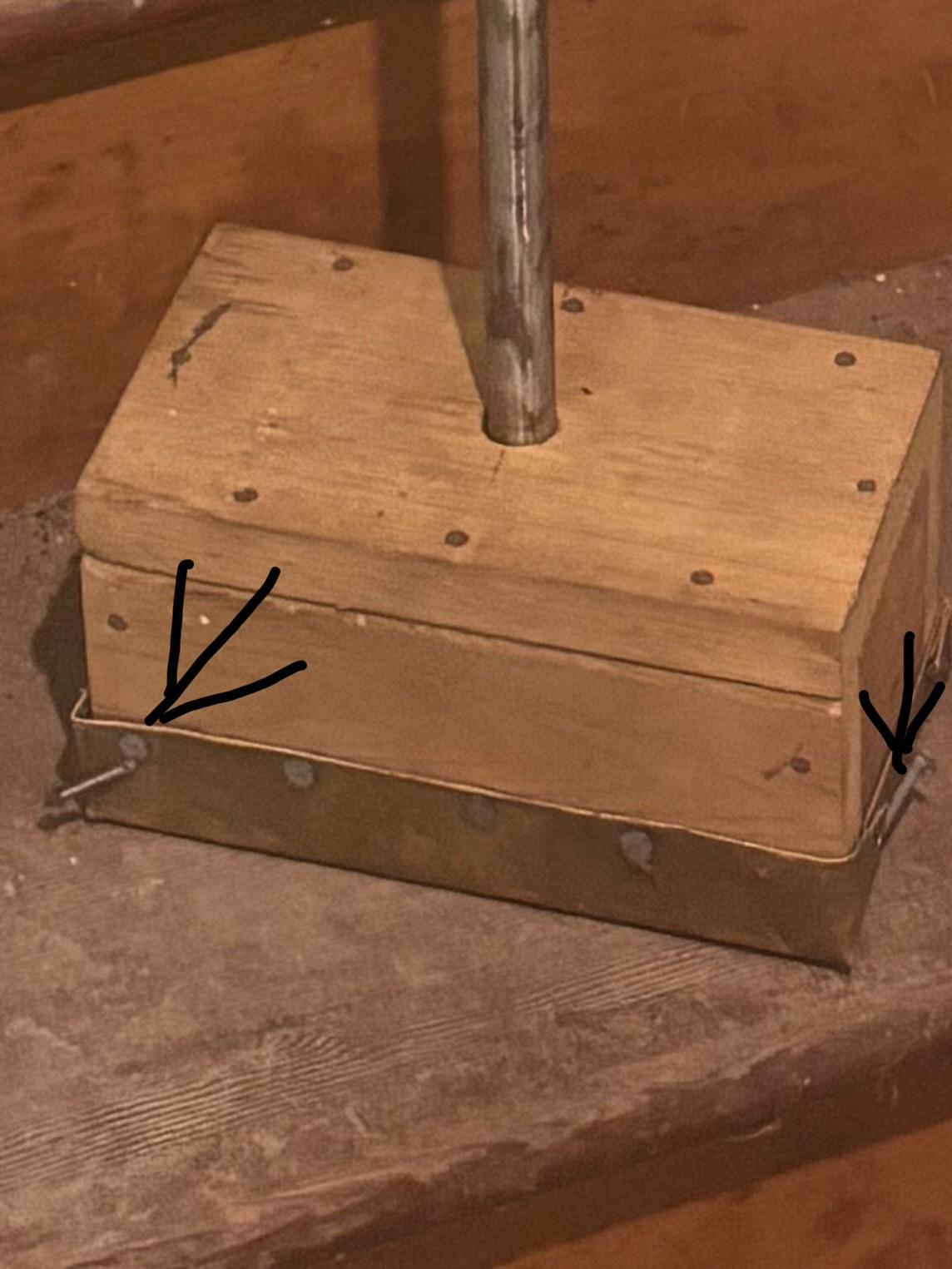

December 28, 2025Dec 28 9 hours ago, Mike BR said: How do you keep swarf from following the magnet up the sides of the box? The easy answer is “Don’t have a lathe!” The practical answer is that it’s not really a problem, almost entirely because of an unintended consequence of a design decision. Because the box is made of wood, its sides create a stand-off that weakens the magnetic field. In fact, the only places on the side where the field is strong enough to grab anything are where the steel nails hold the brass base in place: If this ever gets to be a real problem, I’ll replace the nails with brass screws. In the mean time, lowering the pick-up straight down and lifting it straight up (rather than moving it sideways across the floor) helps minimize the issue.

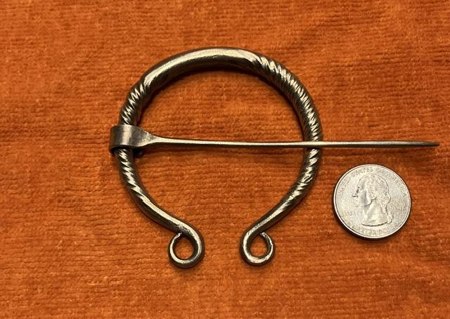

December 30, 2025Dec 30 Spent all day in the shop with my sons and nephew yesterday. Didn’t get a much done with helping them out, but it was a good time. I did get the last two coil springs straightened and put up on the material rack. I also forged a gift out for a gathering in weeks: Forged out of aluminum bronze with a wire wheel finish. It took a lot longer than it should have. Had a couple restarts and creative recoveries. The was a lot of distractions and the bronze wanted my full attention while heating in the forge. At least I didn’t braze my ash dump shut… Overall a great day in the forge! Keep it fun, David
December 30, 2025Dec 30 Sounds like a good day to me. Nice brooch David, I like it. Frosty The Lucky.

December 30, 2025Dec 30 David, that’s an excellent piece. I especially enjoy the lines on the pin portion: very elegant. I have not been in the shop in a quick minute. Usually I teach a student on Tuesdays but it is 50mph winds out of the west today, so the “feels like” temperature is 6f. My shop opens to the west, with an open front. This means that all that wind hits me, and the forge doesn’t do anything to keep me warm. I’m hoping the student can reschedule…

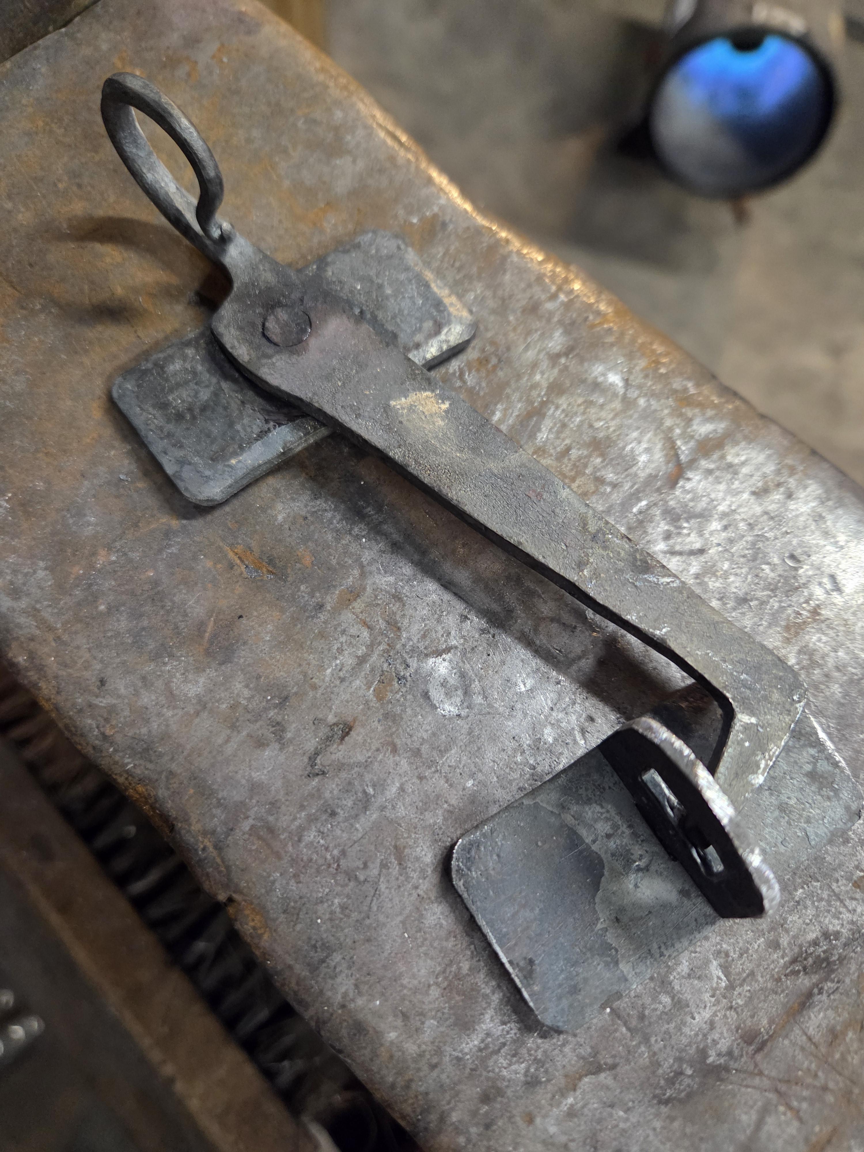

December 30, 2025Dec 30 Got my new kitchen knife ground and started to put the handle on. Got my scales cut, drilled for pins, and somewhat shaped. Mixed my epoxy, glued it up and set the pins. Clamped it up and went about other things. About an hour later i checked it and my epoxy was still wet. So my pro tip for the day is, mixing epoxy resin with epoxy resin does not make for a very strong bond, you have to use the hardener. The wife snickered at me... Last week i made a latch for a bedroom door to keep the cats out. The wife said we need one for the attic door. So i made this little guy. Not happy with the rivet so i will redo that and there is a sharp corner next to the rivet i need to knock down. And yes i forgot to chamfer the sides of the keeper and latch. The keeper is held on by a tab style tenon with a slot in the back plate. A few years back i made a slot punch that is 1/8" x 3/8" just for this purpose. I surprisingly got it centered with out a huge amount of effort. The bit of surface rust on my anvil is from Sunday it being 70° and rainy. The humidity had everything covered in dew, all day long. Yesterday it got up to a balmy 20° with 30mph winds.
December 30, 2025Dec 30 The resin would've set and cured it would just take a while. Maybe a couple years though probably not that long. Still a little hardener is quicker. Did she roll her eyes too or just snicker? I get the eye roll and for the doozies I get the lowered slow head shake and sigh. The bale should be a staple with two peined tenons. It's easier and a lot more solid. If the latch has a slight outwards curve from the tip to the angle it is easy to start and tightens the door a bit. All in all it's a nice practical door latch, utilitarian and not fancy. Exactly what a blacksmith would make to use him'er/self. Frosty The Lucky.

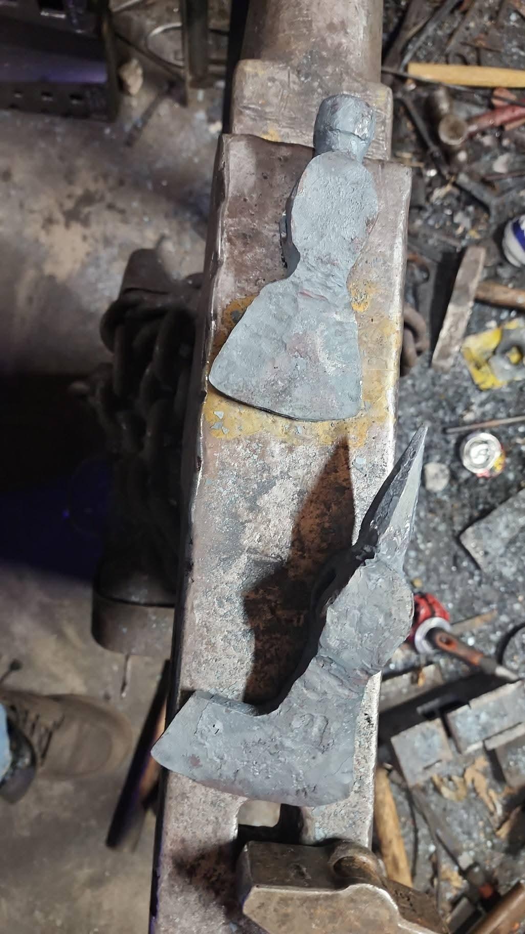

December 31, 2025Dec 31 Subfreezing doesn't bother me. The fudge keeps me warm and I usually have multiple projects in the forge. Tonight I modified 2 ball pean hammers into axes. One camp ax and the other... not a camp ax.
