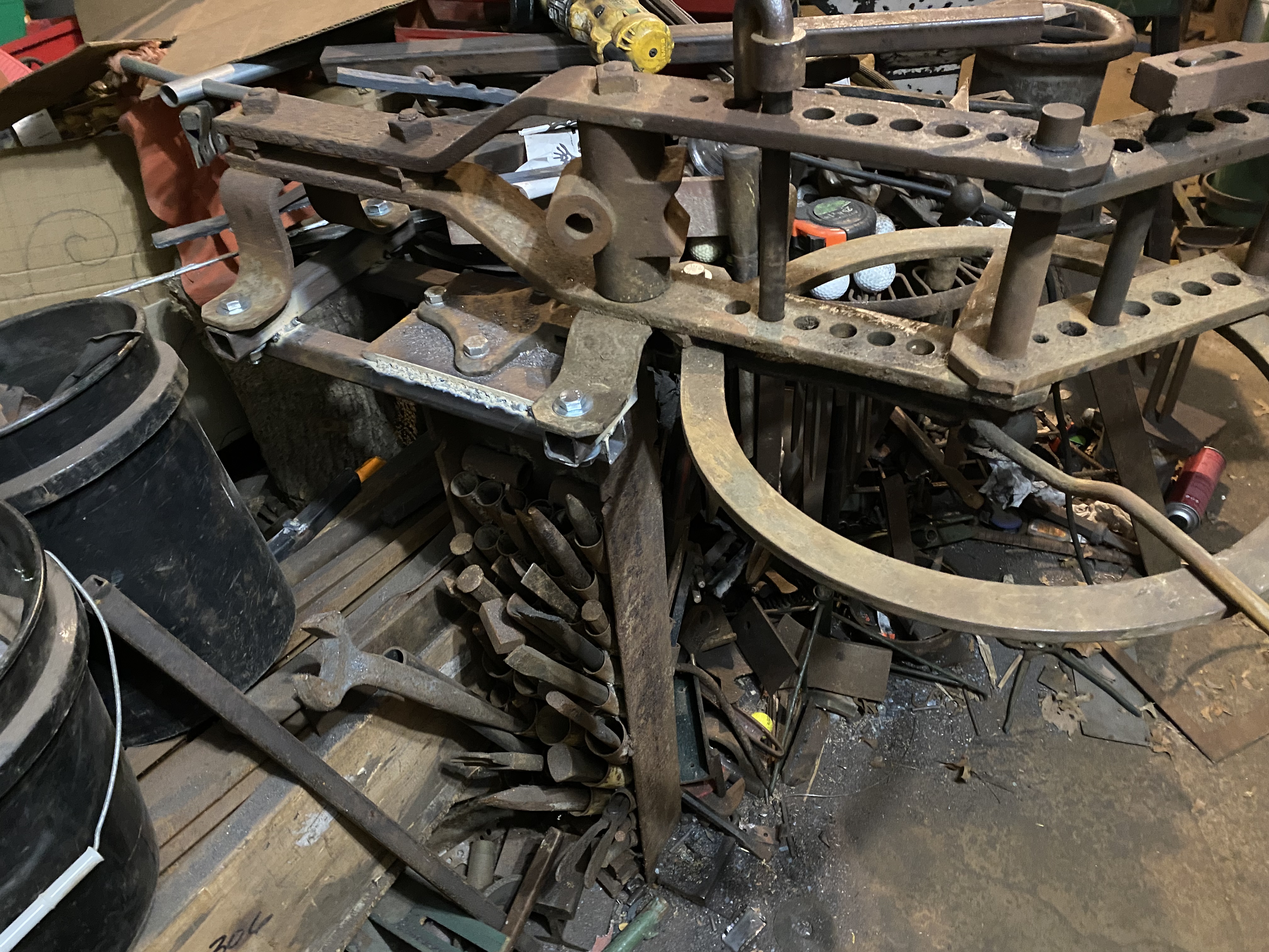

  I will follow along.  I have a homemade rig I built based on one my grandfather made, but without a lot of the accessories.  I already learned a lot from your links.  Thank you.

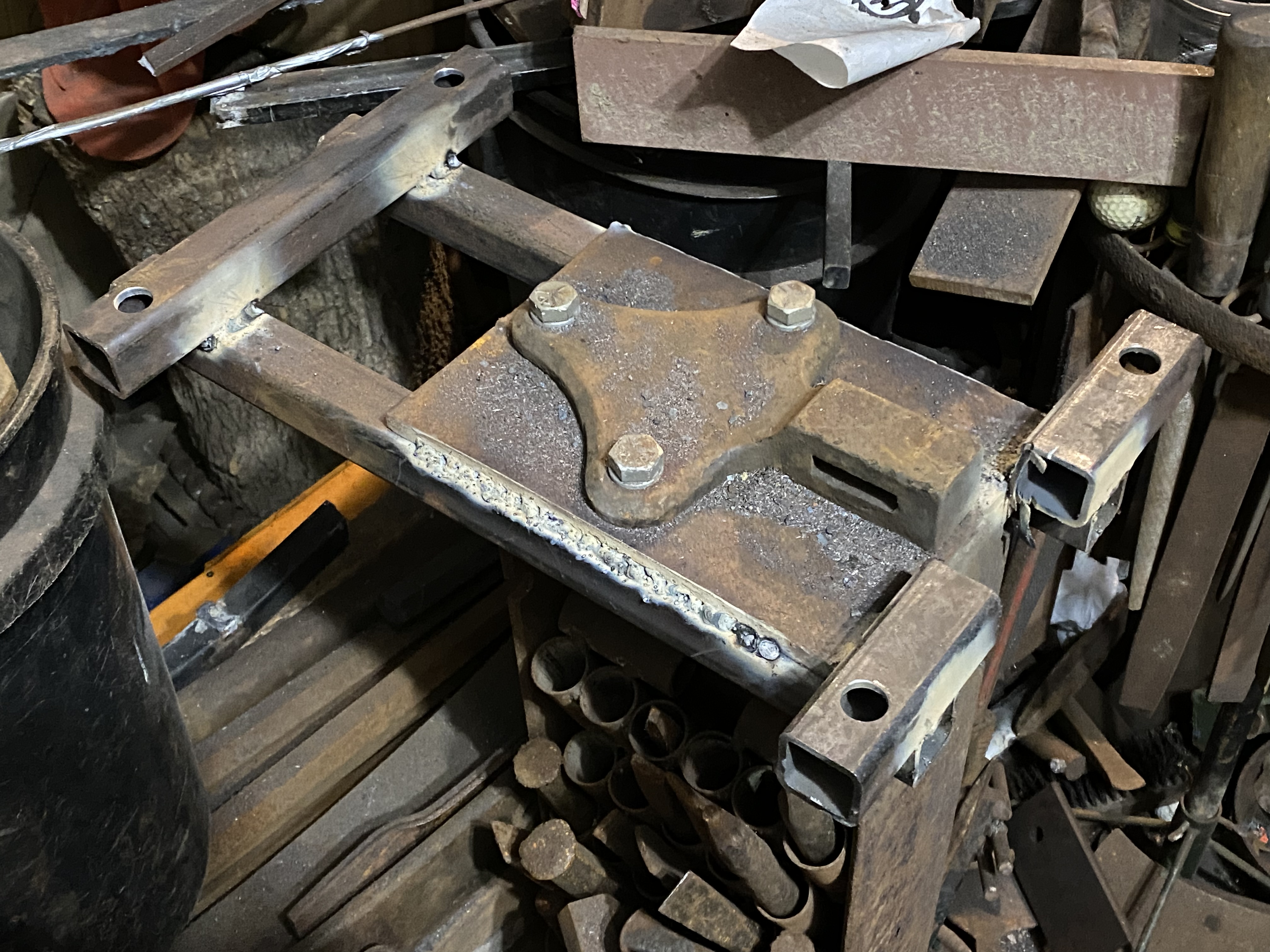

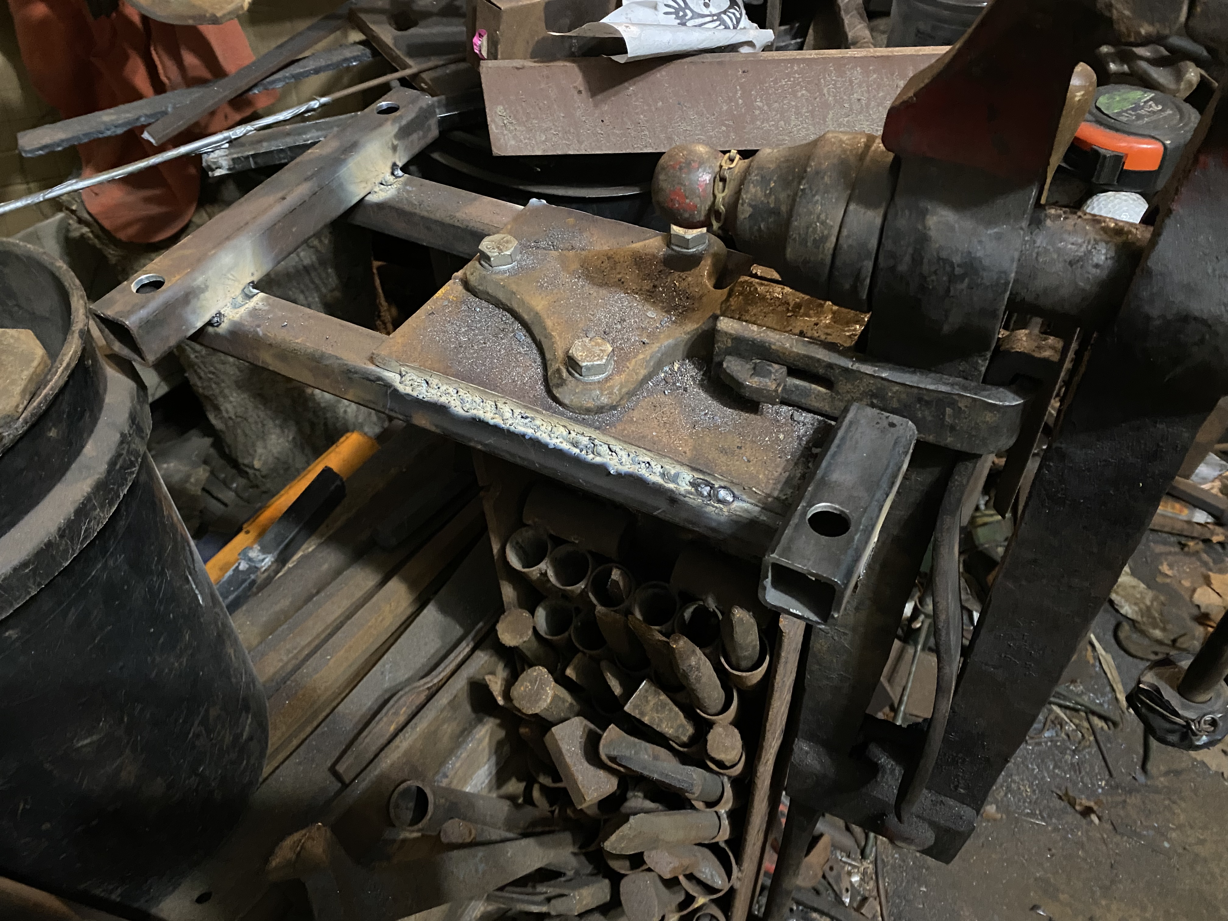

Figured out how and where to mount the bender. It occurred to me that I could simply weld a bracket to the top end of my post vise stand, since the vise has a similar need to resist lateral movement. A few bits of 1-14" square tube and some cutting, drilling, and welding later, and voila!
A 1/2" bolt in each corner, and we're good to bend:
Unbolt the bender, and the vise goes back on:
Needs a little cleanup of the sharp edges and maybe a bit more welding, but I'm pretty happy with it (especially since it's much less elaborate than some of my earlier ideas).

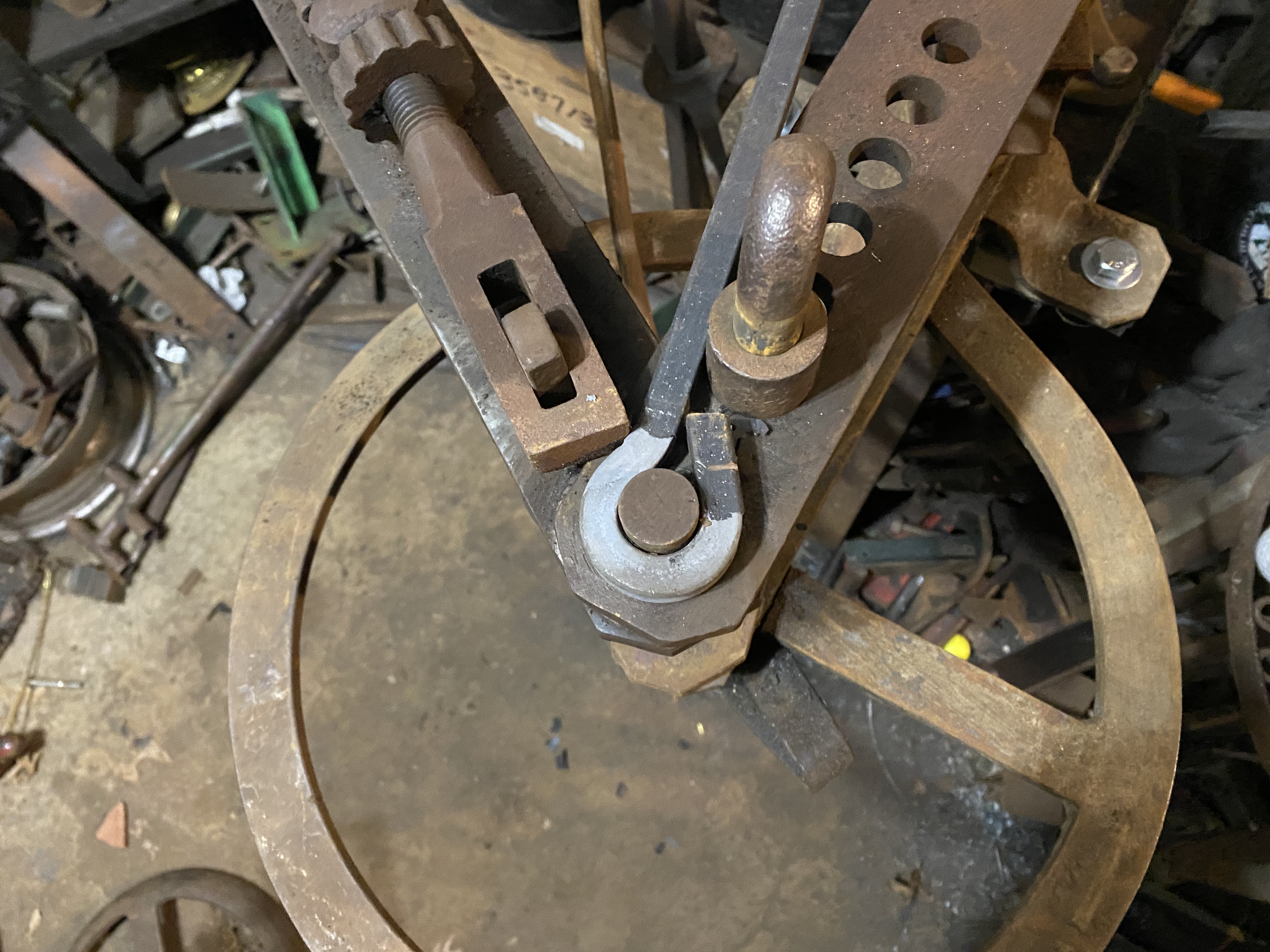

First test bend: an eye in 1/2" square, bent cold.
The bender needs some oiling, and a lot of the parts are a bit rusty and hard to set up. In particular, the center pin is rusted in place and needs some penetrating oil (I think I have some PB Blaster left over from the machinist's vise project). I have to be able to remove it to add various tooling (or to use the narrower end for a smaller eye), so getting that shifted is high on the priority list. For the rest, I see a lot of wire brushing in my future.
Also high on the list is making the handle extension. I was able to bend the 1/2" square without too much trouble, but I can tell that some of the heavier stock I plan to bend will take more leverage. According to the Grauman drawings, the extension is made from 1-1/2" black pipe flattened down to just under 3/4", so I have to see if I have any lurking in the back of my scrap pile or if I can scrounge some from somewhere. (I buy it if I have to, but I'd rather not.)
(On a side note, I had forgotten that I'd attached the vise mounting plate a bit too far to the rear, which makes putting in the wedges a real pain. The bolts holding the plate in place are threaded into the top plate of the stand, so moving that isn't much of an option. I might make a new shackle to reach a bit farther back, unless I'm willing to spend an extra 5-10 minutes of muscling the pieces around every time I want to switch over.)

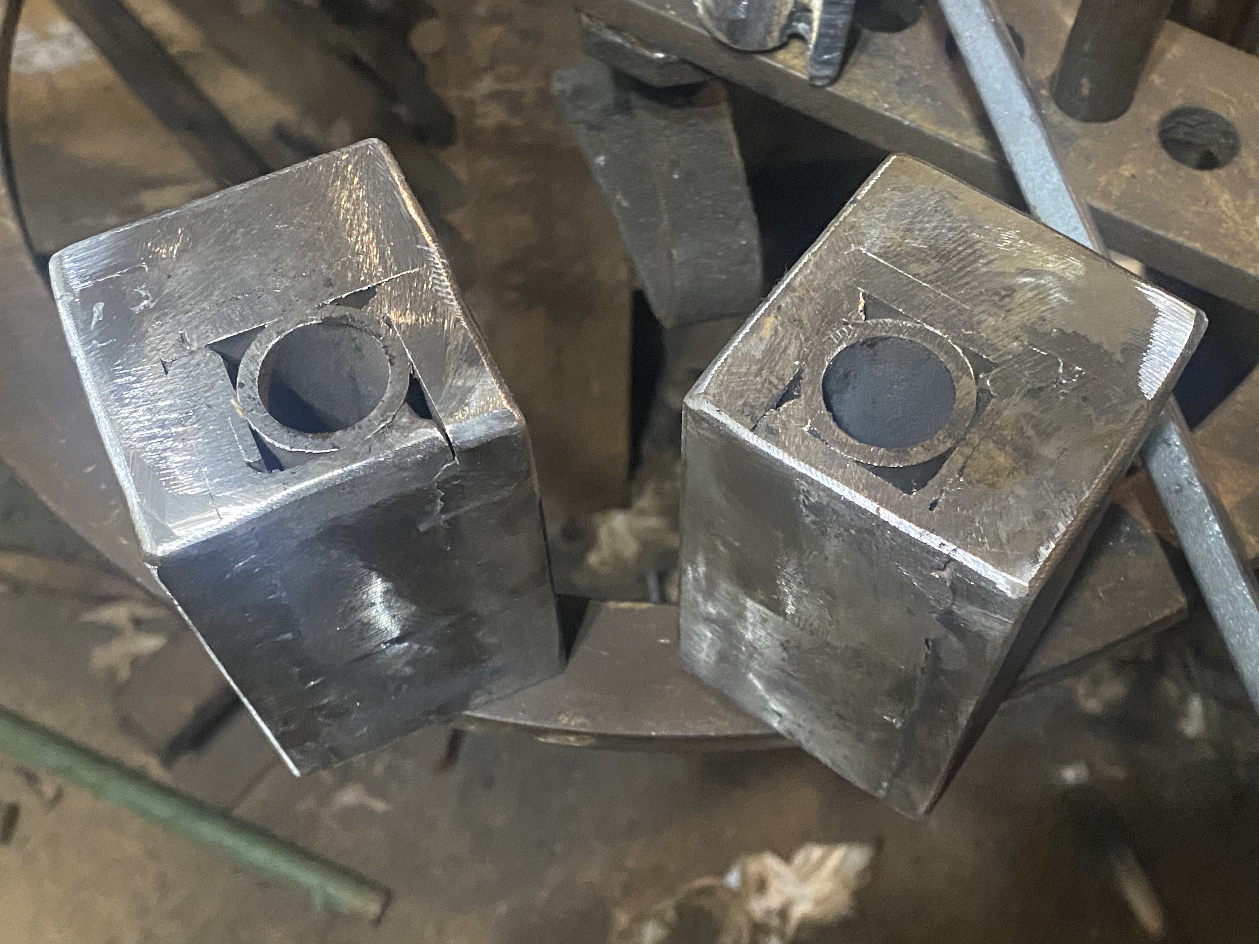

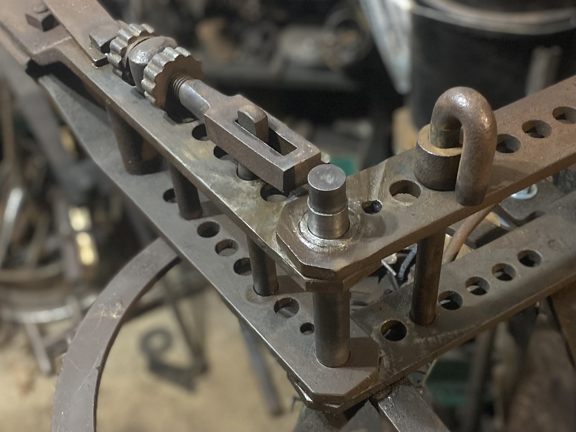

Knocked out and cleaned up the center pin. Fairly straightforward, although I did have to sand out some pitting that was keeping it from sliding in and out easily. Also cleaned up the eye bolt bending dog, its two thumb nuts, and the offset flat head pin (the pieces to the left of the center pin).
One interesting detail of the center pin is that its diameter steps down at both ends, so that you can change the diameter of an eye bolt’s eye by changing the pin’s height or by flipping it end-for-end. There’s a little gizmo underneath that helps you do this; I’ll post a photo of that later.

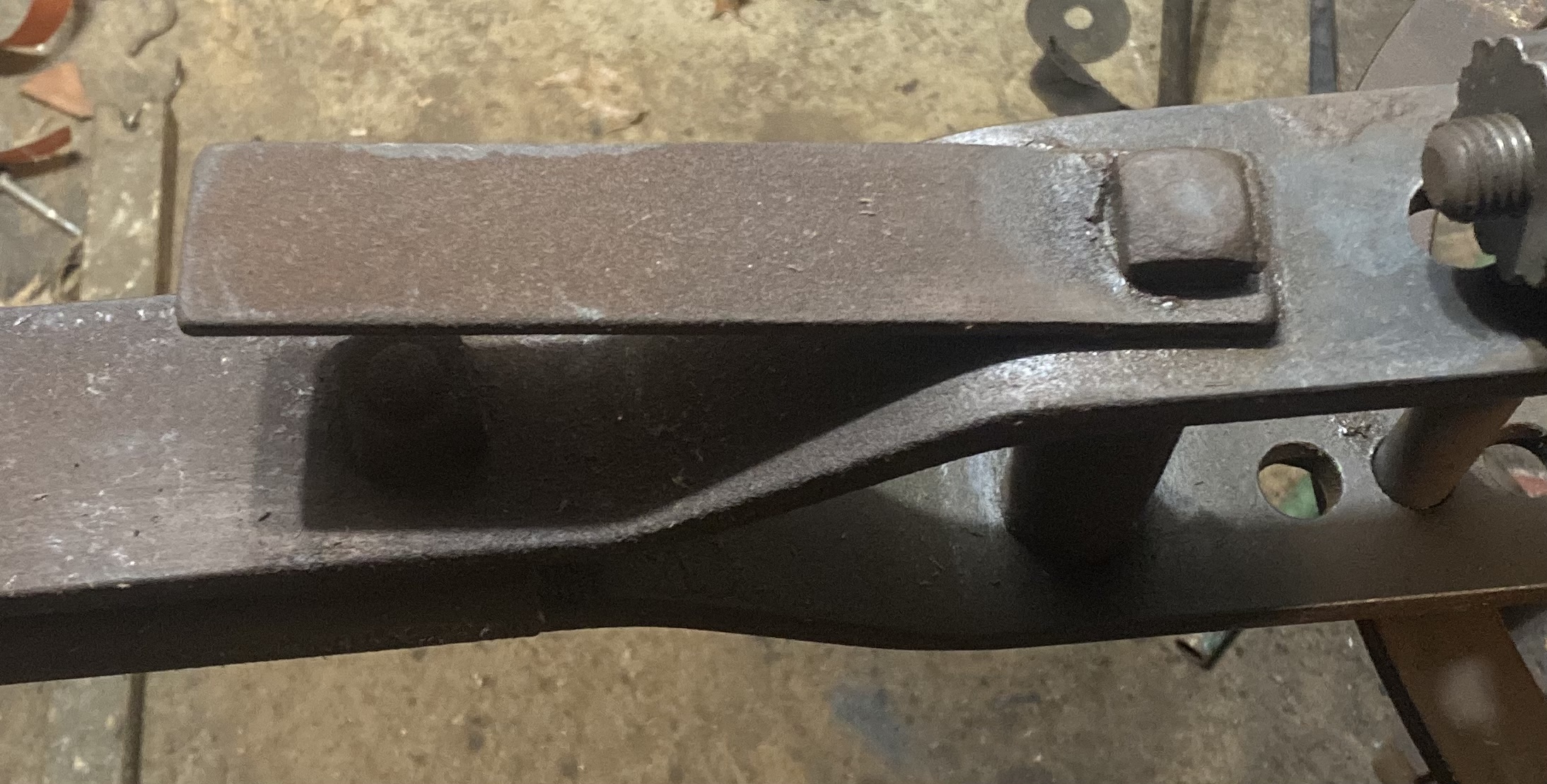

This piece is an anomaly, and I suspect it was added by a previous owner for reasons unknown. You can see it in the first photo in the top comment, angled out to the side. I knocked it around to be in line with the swing arm, as it was blocking the arm from travelling through its full range of motion.
I’ll probably remove it later, especially if I can’t find it in the manual (once that arrives).

John, your anomaly might be a stop for a repetitive project
I think it may have been, especially since the stop block that clamps on the circle assembly (officially the "27B circle gauge") is missing. I am planning to make one of those (and may even have identified a good piece of scrap to make it from), so de-anomalization won't be a problem.

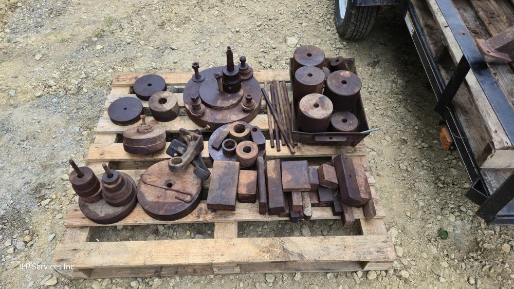

  Glad to contribute.....  :).  I'm amazed at how underutilized mine has been with just round homemade dies.  First thing I am going to make is the eye bolt bending dog and pin.
Do you have photos of your dies?
The bending dog and its nuts and pins are shown in the Graumann drawings linked in the top post.
  Unfortunately no, and most all of my things are boxed and crated up, being stored or I'd take a few.
  Basically, the smaller dies up to 4" are solid round barstock with a center hole and the larger sizes are slices of heavey wall pipe (with the ends beveled before welding) with a plate welded on each end, cut and ground flush with the pipe and then the hole drilled and pipe faced on the lathe.  A picture is worth a thousand words, eh?  ;)
I think I get what you mean; thanks. Probably beyond my machining capacities anyway.
  I think all sizes could be made out of pipe and the plate doesn't have to be thick.  Actually, no real need for facing them either, I just had it set up, soooo....  I'm not very good at describing things sometimes.

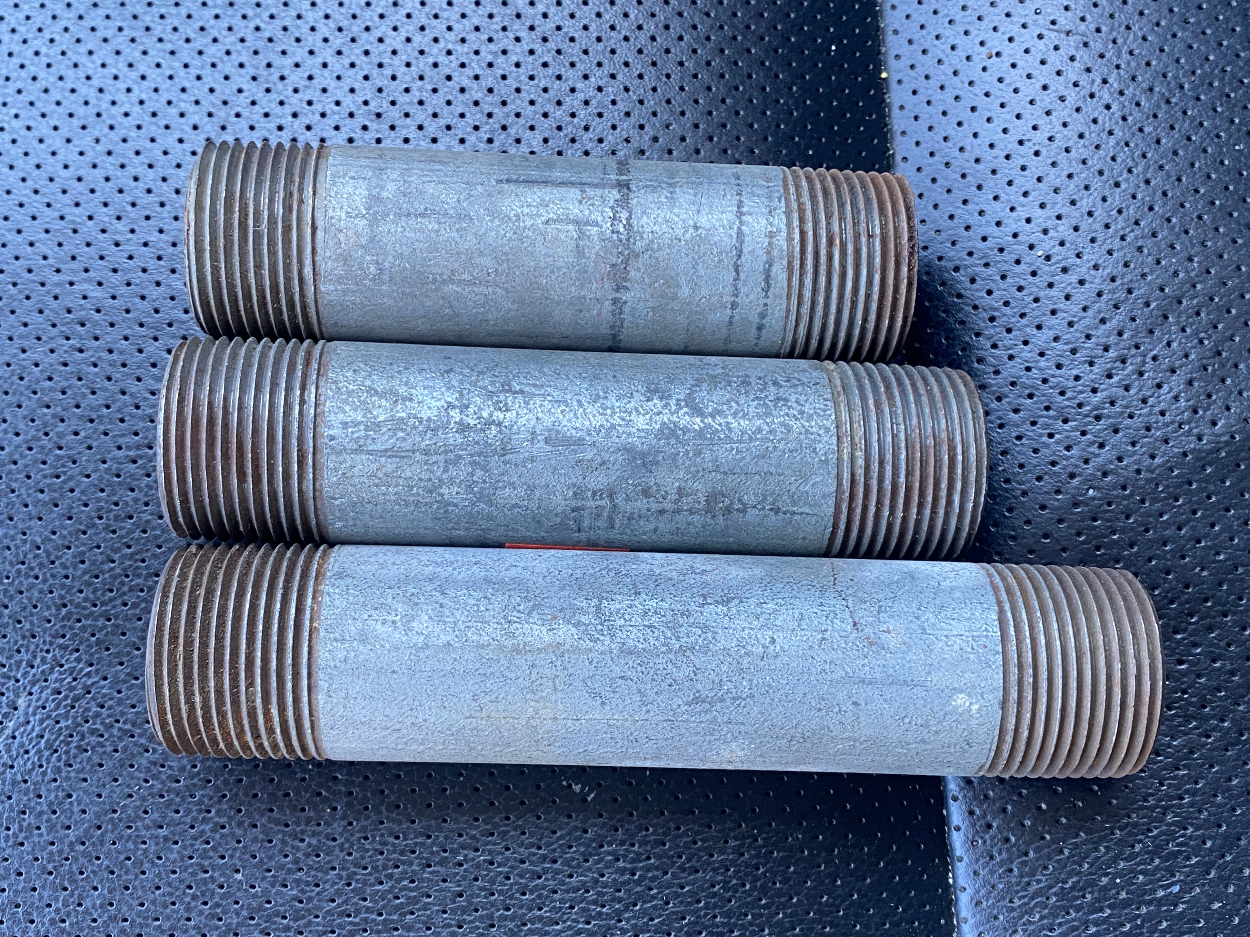

A quick stop at the ReStore yielded a trio of 1” Schedule 40 nipples that should — if my research is correct — serve as the foundations of some center tooling.
(Once a vinegar bath takes the galvanization off, that is.)

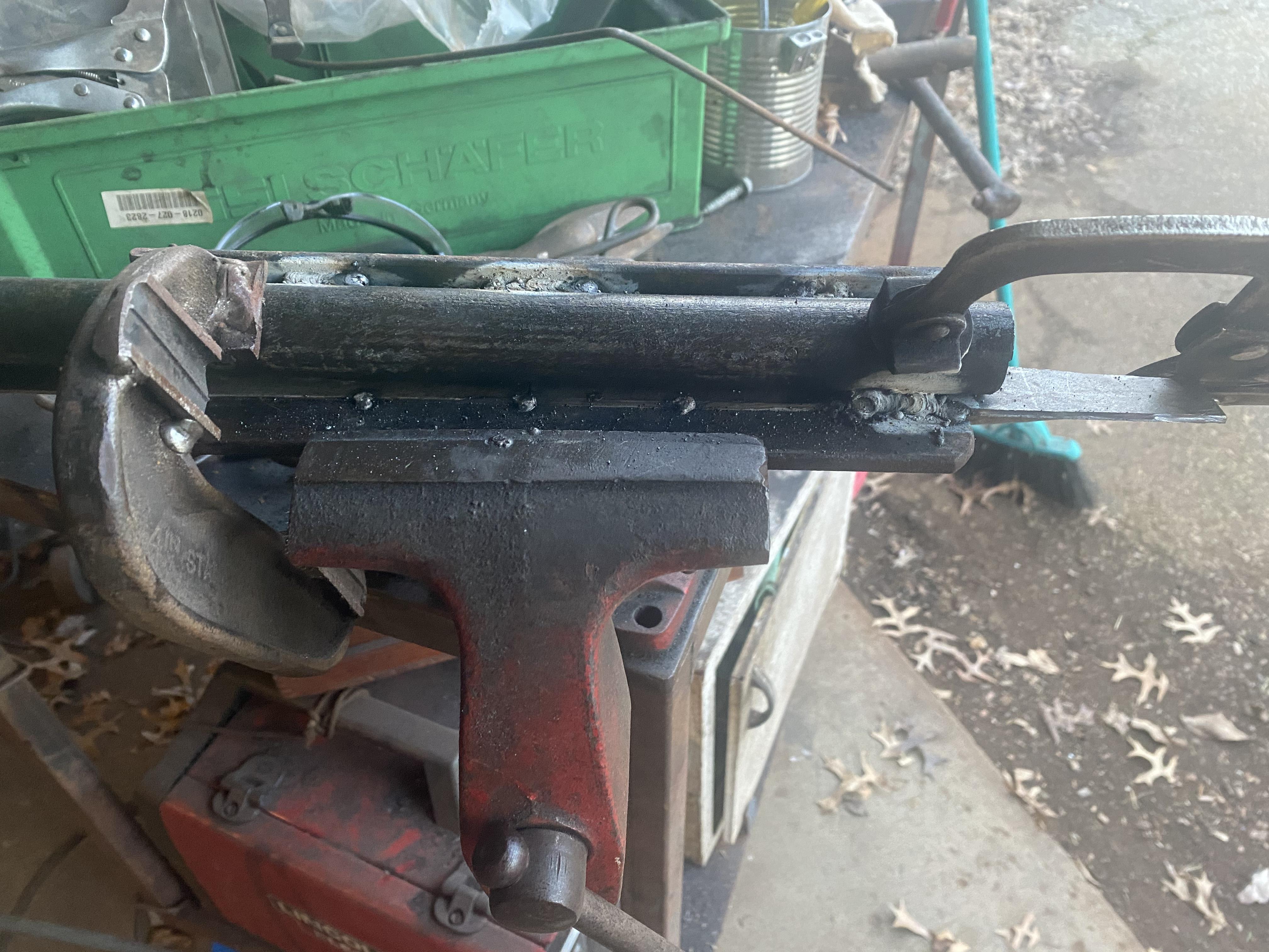

Took a stab at making the extension today, but it looks like the pipe I got from my friend is too big. I’ll need to think about alternatives.

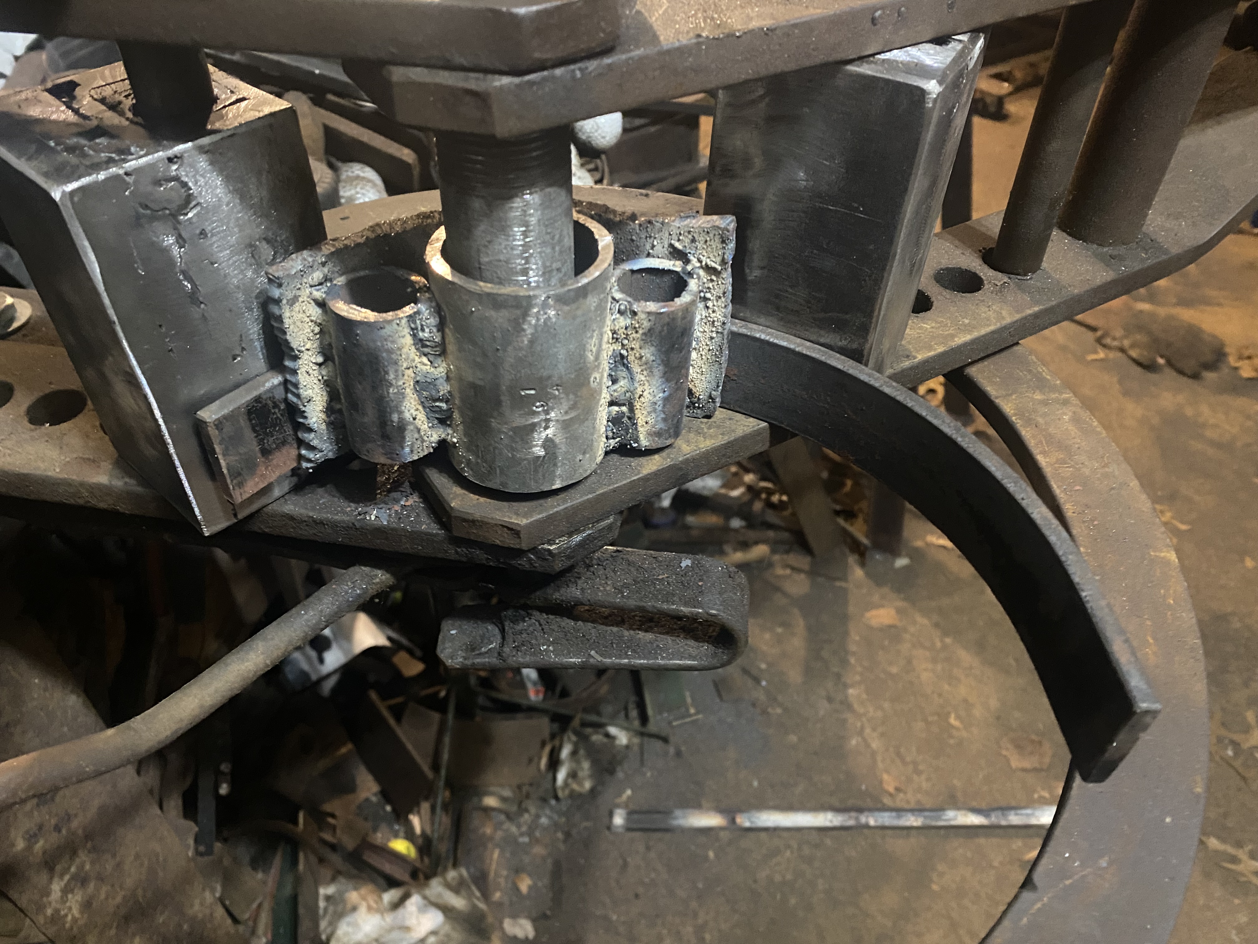

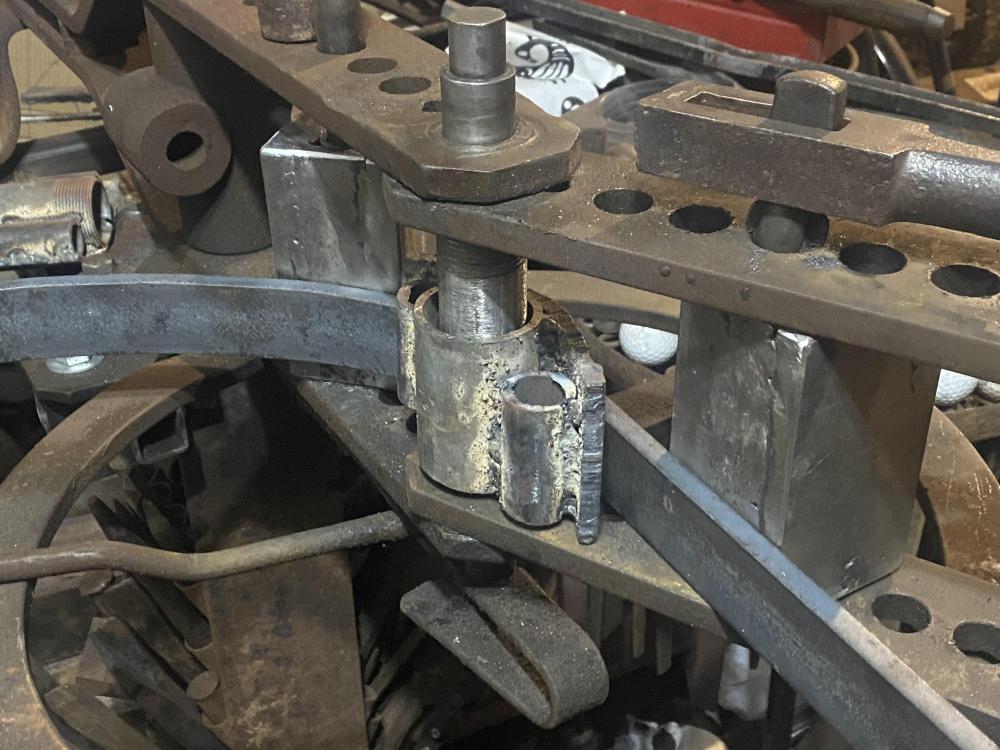

However, I did make a pair of bending blocks (part 11B) by welding up a LOT of pieces of flat bar on a core of angle iron and schedule 40 pipe.
Together with a piece of a circle jig I made for the fly press, I successfully bent cold some pieces of 1/4” x 1-1/4” and 3/8” x 1-1/2” flat bar.
The thicker bar was a bit off a pull, but I suspect it will be much easier once I add the handle extension.
Speaking of which, I ran across some shorter pieces of 1-1/2” pipe while I was putting something else away.
The plan is to flatten some 2” pipe for the handle extension. I’ll then flatten a piece of 1-1/2” and make an insert that will be welded into the extension, forming a sort of angled tenon. This will slip into the end of the handle and be pinned in place when I need the extra leverage.
