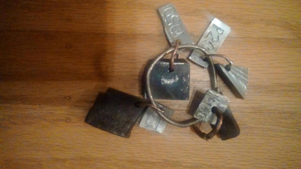

anvil Posted July 24, 2020 Share Posted July 24, 2020 Spark testing works as a comparative means of testing. Get some known samples of steel from your source. Mount them on a board and lable them. Then when you get an unknown piece of steel, test the unknown pattern against your known samples. Quote Link to comment Share on other sites More sharing options...
pnut Posted July 24, 2020 Share Posted July 24, 2020 Every time I get a piece of known steel I cut off an couple inches and label it for future comparative testing against mystery steels. Pnut Quote Link to comment Share on other sites More sharing options...
ThomasPowers Posted July 24, 2020 Share Posted July 24, 2020 If you can get a group of smiths together and everybody buys 1 3' piece of different steels and cuts it into samples and trades it can help to get your sample set grown faster. Note: STAMP the alloy into the steel; it's amazing how fast markers and paint can disappear in a busy shop. Also; be very careful about colour coding as different shops or suppliers use different codes! Quote Link to comment Share on other sites More sharing options...

Frosty Posted July 24, 2020 Share Posted July 24, 2020 If you use strip stock, say 1/8" x 3/4" x 2" it's easy to hold at the grinder, hang from a drilled hole and read the stamped ID. Frosty The Lucky. Quote Link to comment Share on other sites More sharing options...
ThomasPowers Posted July 24, 2020 Share Posted July 24, 2020 I think I'd like the samples a bit longer to allow for frequent use at the grinder...Hmm a garden rake would make a nice sample rack too. Quote Link to comment Share on other sites More sharing options...

evfreek Posted December 31, 2020 Share Posted December 31, 2020 I use separate tags made out of aluminum and stamp those. The links are copper. Kind of like a blacksmith's keychain. Quote Link to comment Share on other sites More sharing options...
