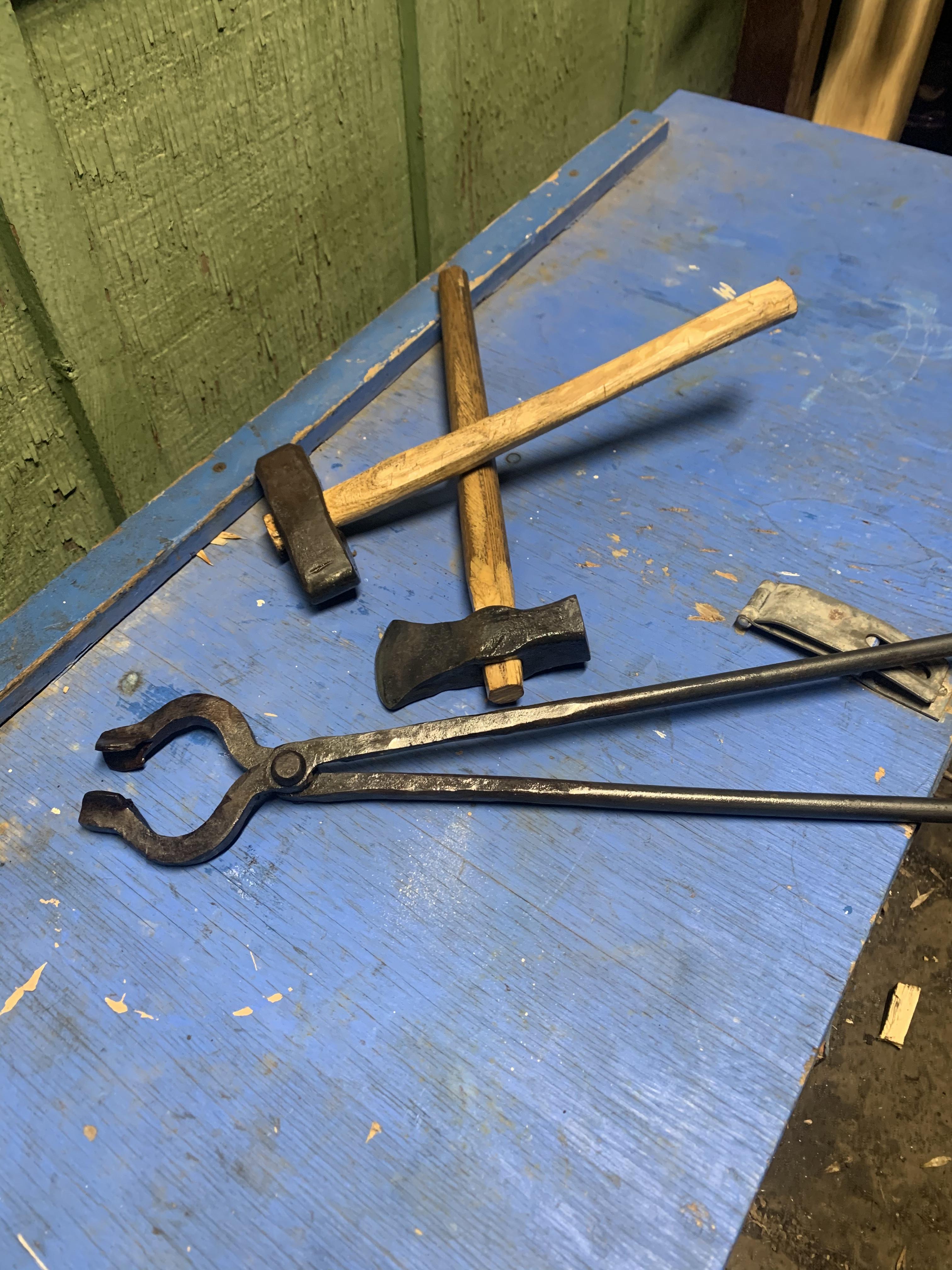

So I was wondering. I’ve made my top tools eyes like hammers tapered equally from both sides. Is this Correct? Should top tools be tapered/drifted  more from the bottom or top?
With hinges some alignment issues can be finessed by running a drill bit through the assembled but not pinned or riveted pieces.
Good to know Thomas. I’ll try that with next one
I was taught that top tools are tapered on the  bottom and not wedged
That’s what I knew too but I wasn’t suste if you should still drift from both sides or not
I saw an old conversation between Alec Steele and Brian Brazeal about Brian hot cutting 2” round in one heat. It made me curious so I attempted to hot cut 1.5” round but it took me three heats haha. I’m not quite at their level yet
Tapered bottom or no taper at all.  Handles on top tools were consumables..  Ideally just sliding in another piece of wood is all that is needed.
A taper or chamfer on the bottom allows for the wood to compress some when forced in and allows for an easier fit of the wood.
Top fuller, handled hot cut Both 4140, and bolt jaw tongs with forge welded reigns.

Perfection isn’t possible but we can still try our best!  I made a adjustable fullering jig to hopefully help with hammer fullers. My whisky turtle forge rounding hammer is the model for the picture to show how it works haha. It’s not great but it works well made out of free scrap so I’m happy. Only non scrap was the little area for hitting with the hammer and that’s some annealed 1045. I got lots of heavy/ thick scrap steel from farm equipment that’s some sort of carbon steel so that’s good
that will work nice..  as long as there isn't a lot of wiggle from side to side.. Which looks like you have control both over wiggle and over angle of bar for different thickness of materials.  Nice work indeed.

Thanks everyone. And yup the washers stop almost all wiggle. The holes allow for different thicknesses.
