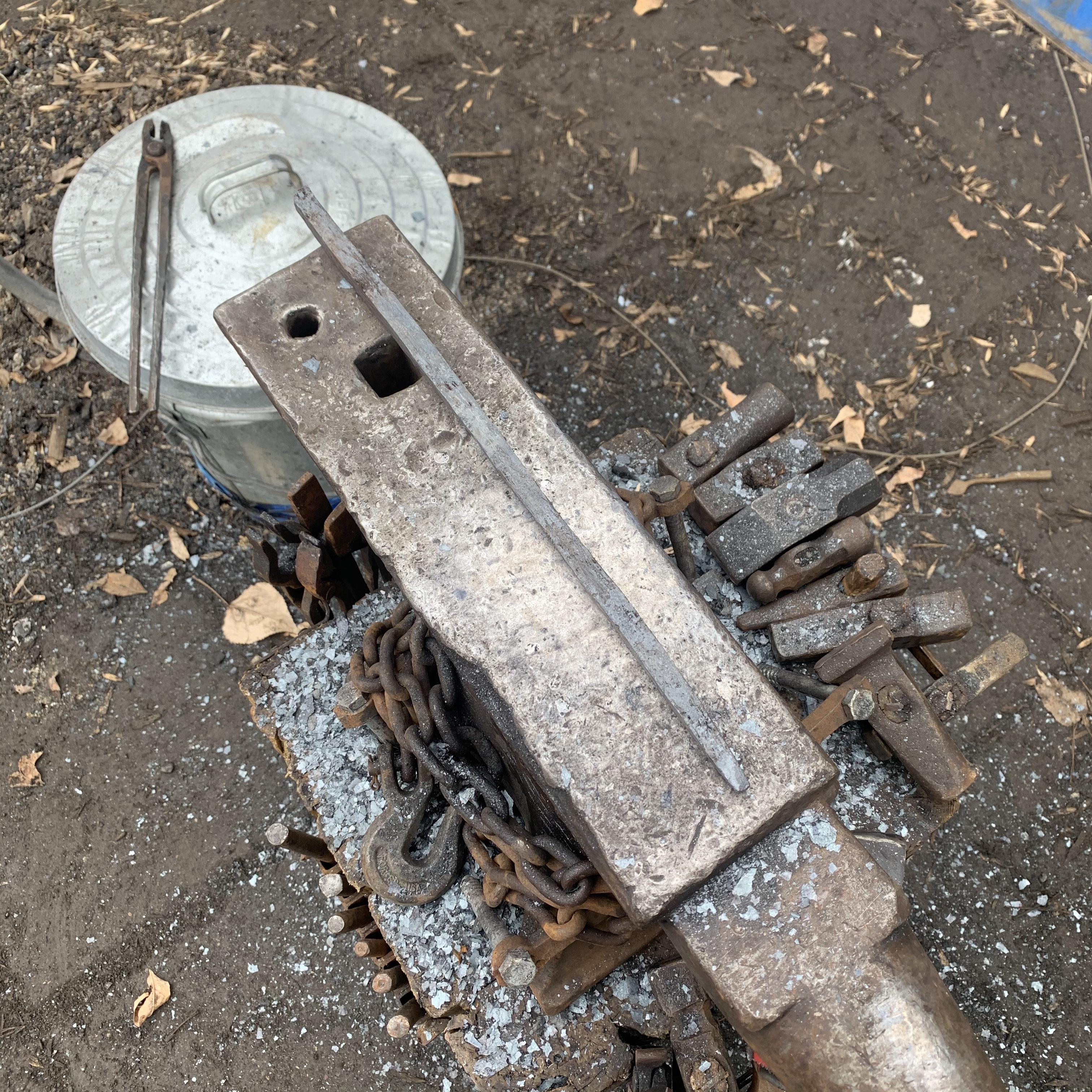

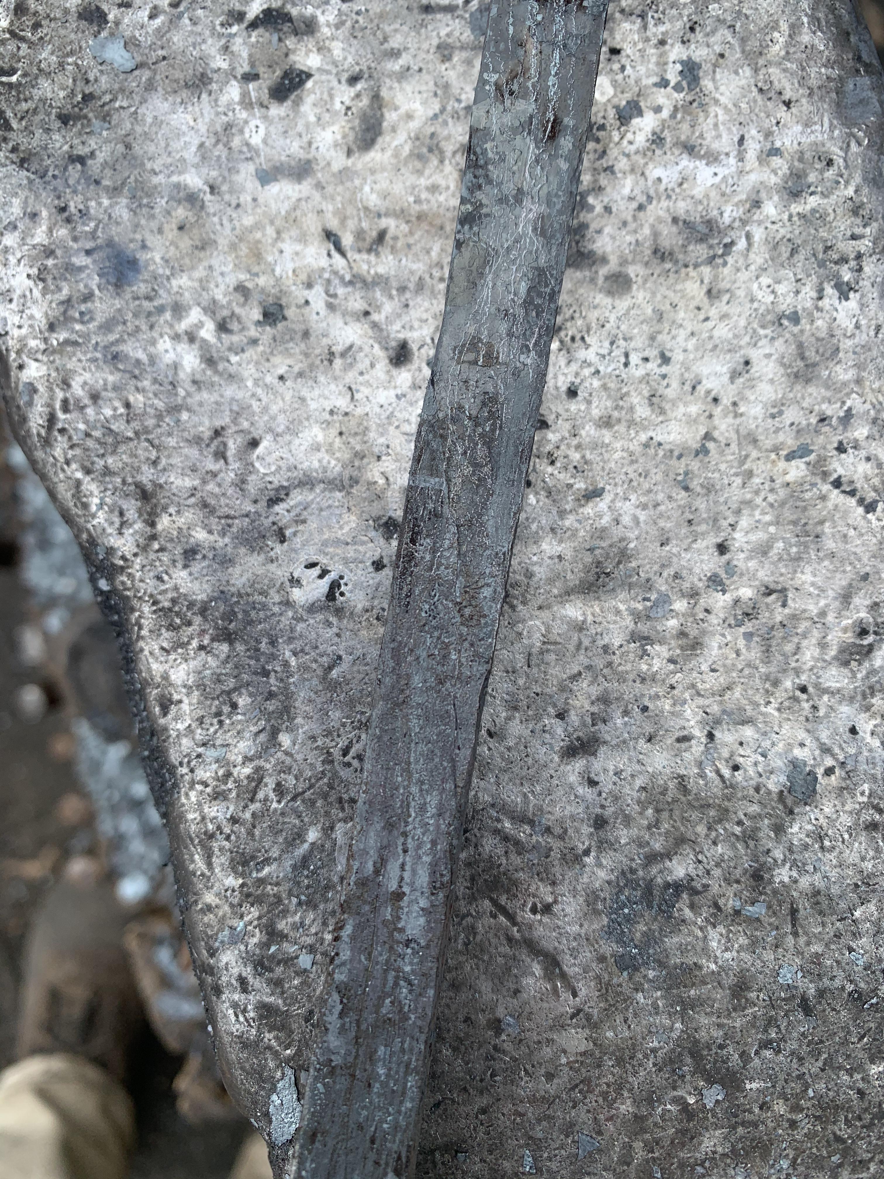

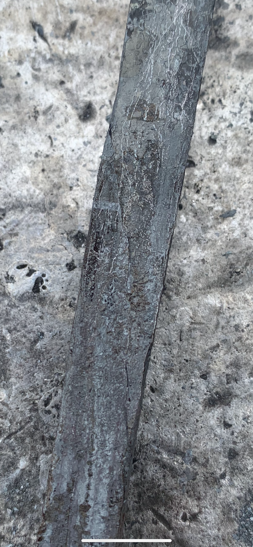

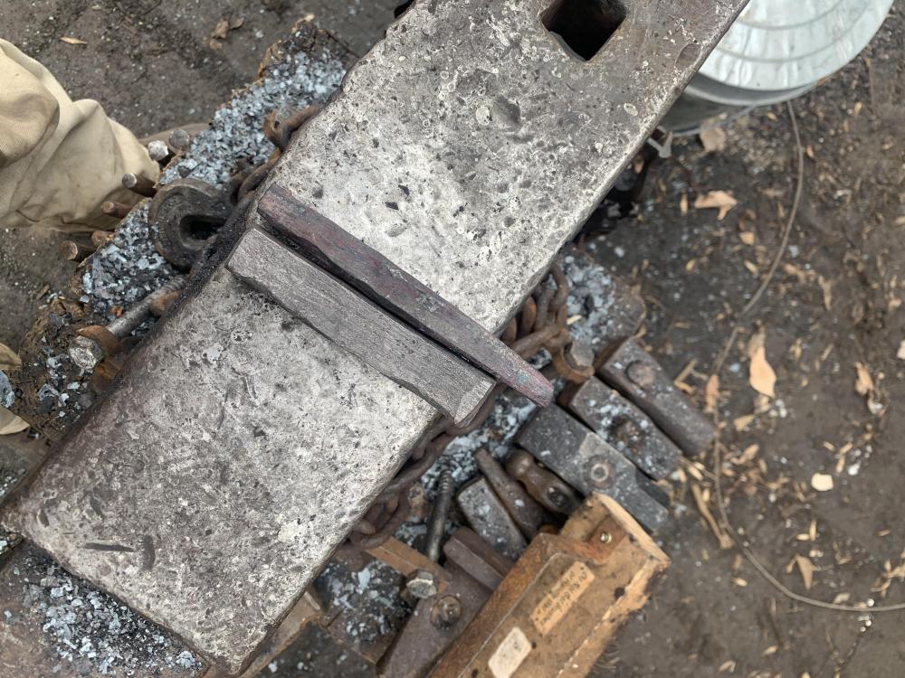

Justin Topp Posted March 25, 2020 Author Share Posted March 25, 2020 Practiced some Scarf welding today. And made a small swivel with a hook Out of wrought iron but it’s in the acid right now so no picture yet. Took some wrought iron horse shoes and forge welded into bars than I scarf welded the two bars together. Drew it out to 1/2” square for future projects like the swivel. not perfectly blended on the bar but it never split or anything so I’m confident it worked well enough Quote Link to comment Share on other sites More sharing options...

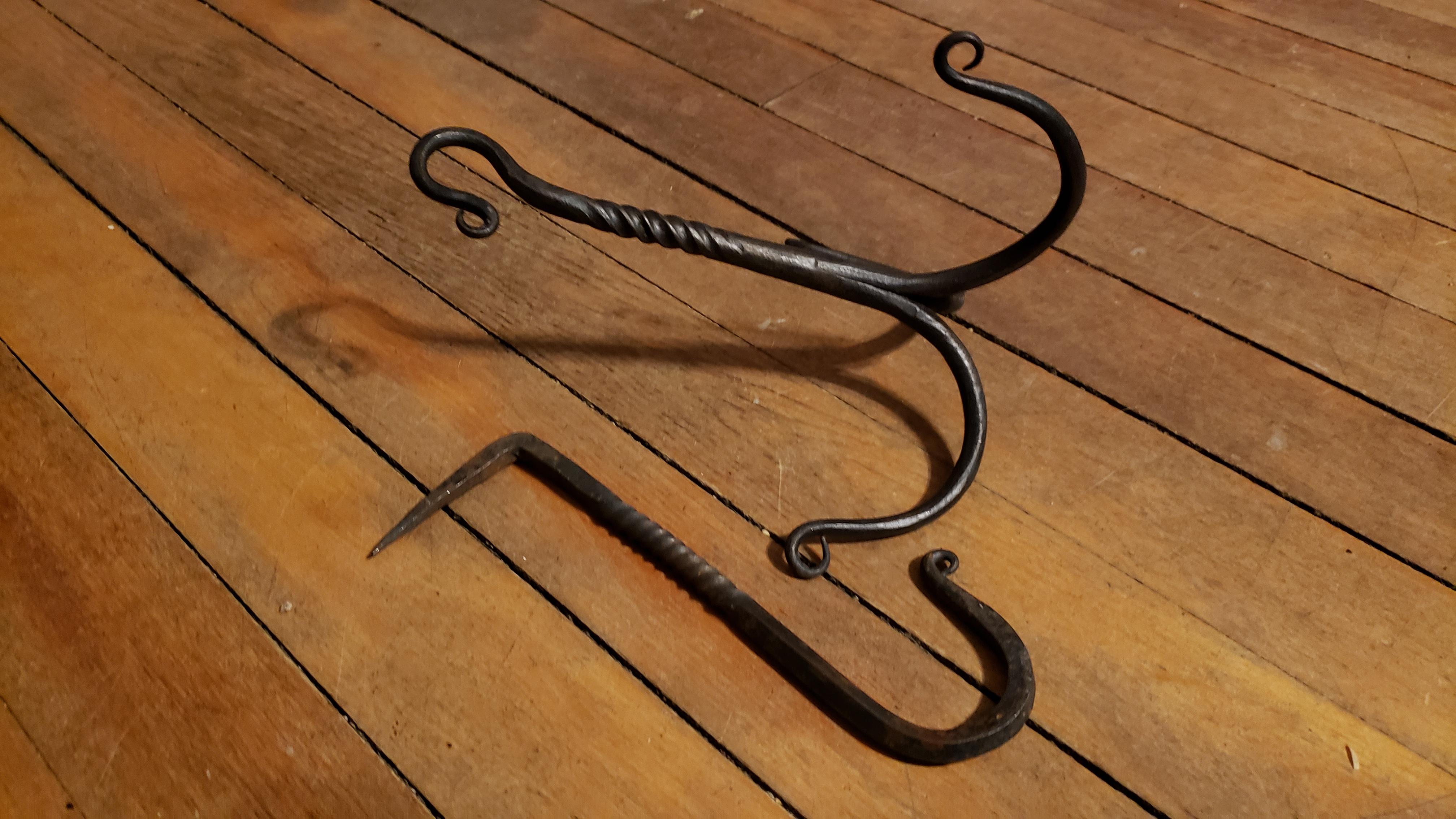

jlpservicesinc Posted March 26, 2020 Share Posted March 26, 2020 chain, hooks, hardware, nails, dog irons, andirons, hatchets, axes, tomahawks, brads, spikes, pontoons, spikatoons, pliers, screw drivers, peevie, ice tongs, hammers all varieties, adz, hand cuffs, locks, top tools, bottom tools, saw blades, files, welded rings, non welded rings, hitching post rings, herb hooks (all varieties), utensils. etc, etc. If you really are interested in colonial type items the best thing you can do is get a few books on the subject. Early Ameriacn Wrought iron by Sonn is a great hardware one. One of the best. If your primarily interested in tools light tools are called "Toys" and heavy tools are called tools. the other thing that can be done is to make your work spotless or I should say.. Make your work finish quality. this can open a whole new world because many think old iron was crudely finished.. Thats about as far away from the truth as it can be. People took extreme pride in their trade if they were good at it and produced works comparably to others in the same trade. It's only today that we see things are being crudely fashioned and sold. clean work is a sign of a true crafts person. Since your base line skill sets are pretty good then working towards perfecting it can be a very rewarding step. Quote Link to comment Share on other sites More sharing options...

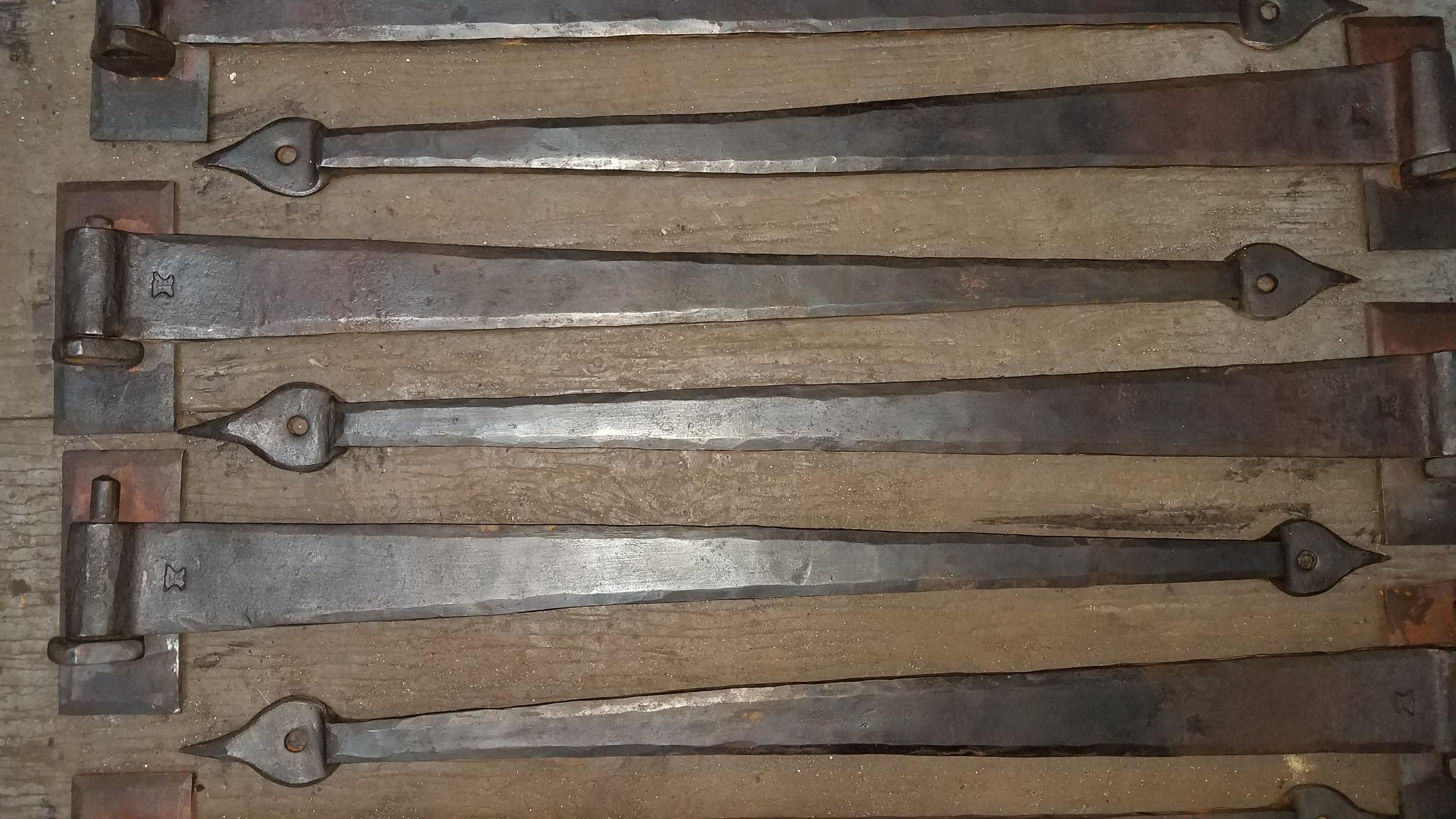

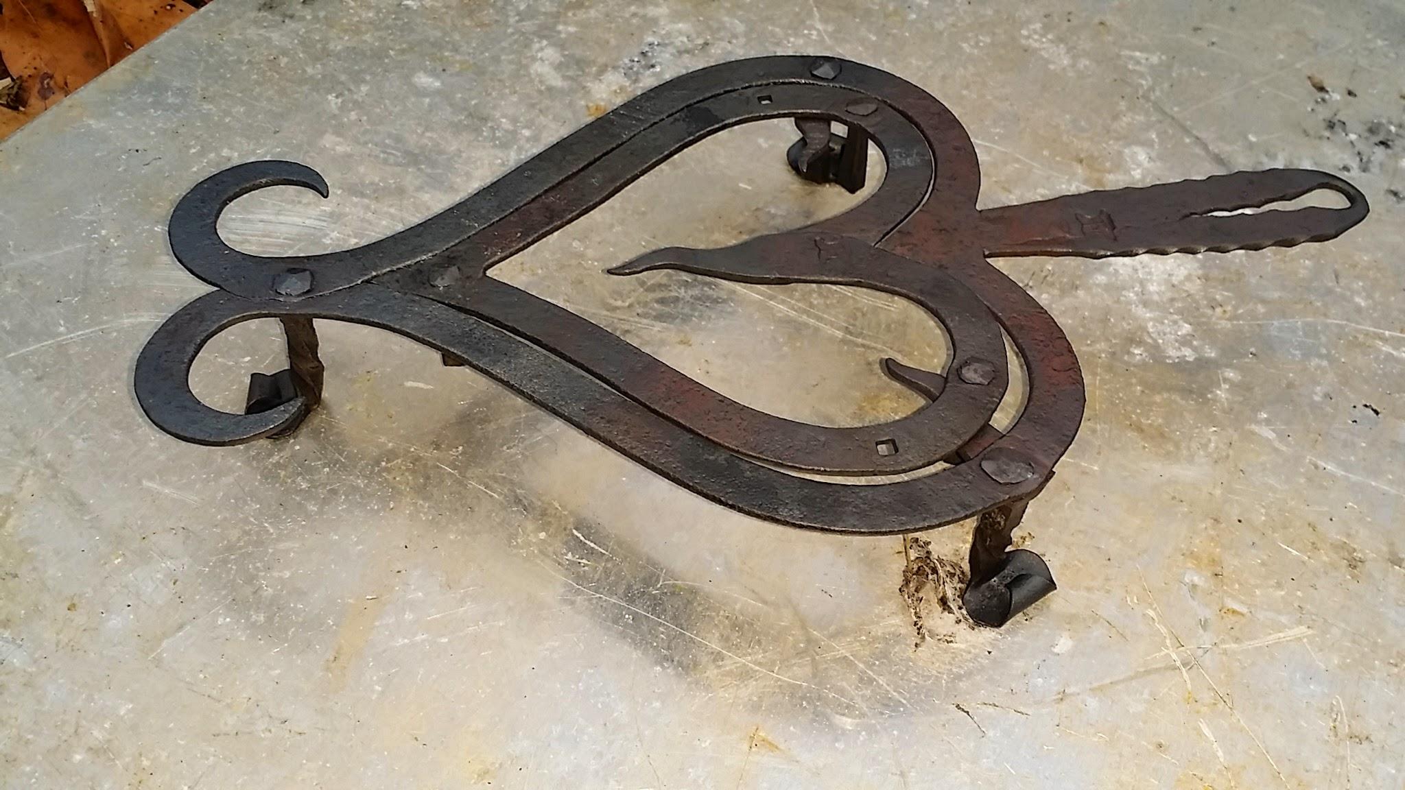

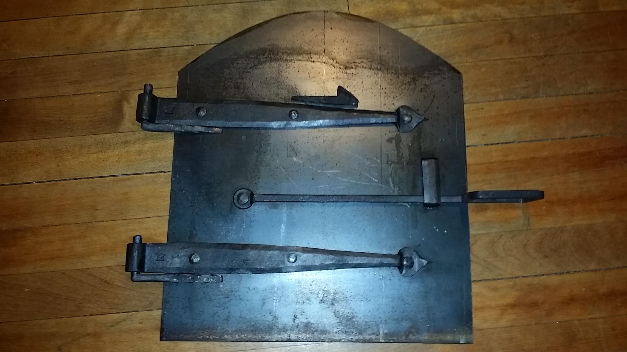

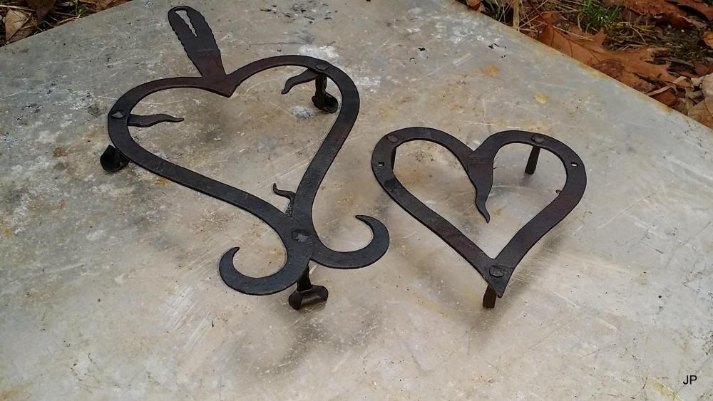

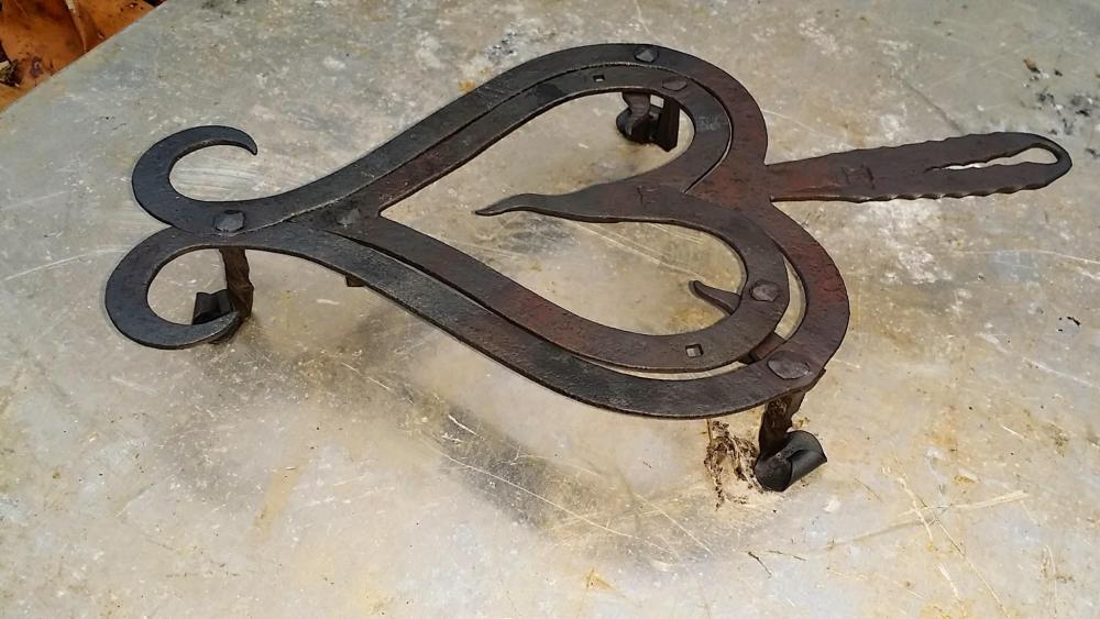

jlpservicesinc Posted March 26, 2020 Share Posted March 26, 2020 I consider all of this work as mediocre and could use refining. But it's where I am at since coming out of retirement. these are items I have forged since then.. Oh, and the referrence to toys.. are "Toys and Heavy toys". Quote Link to comment Share on other sites More sharing options...

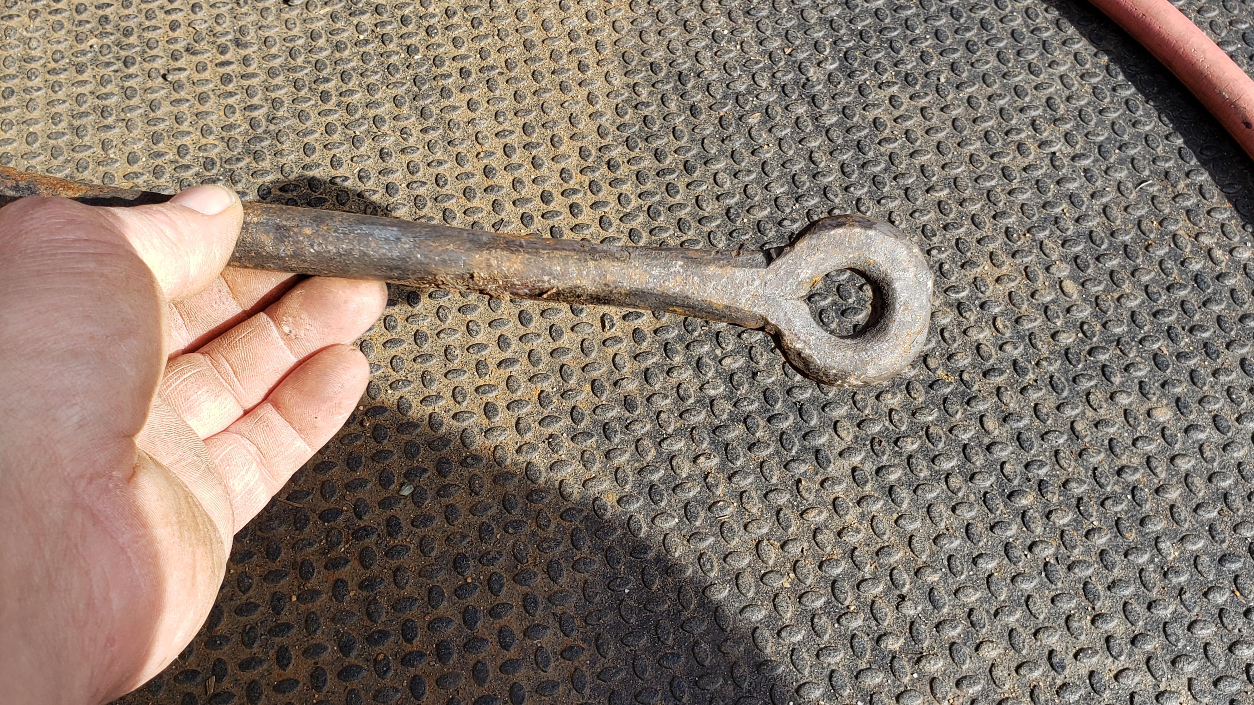

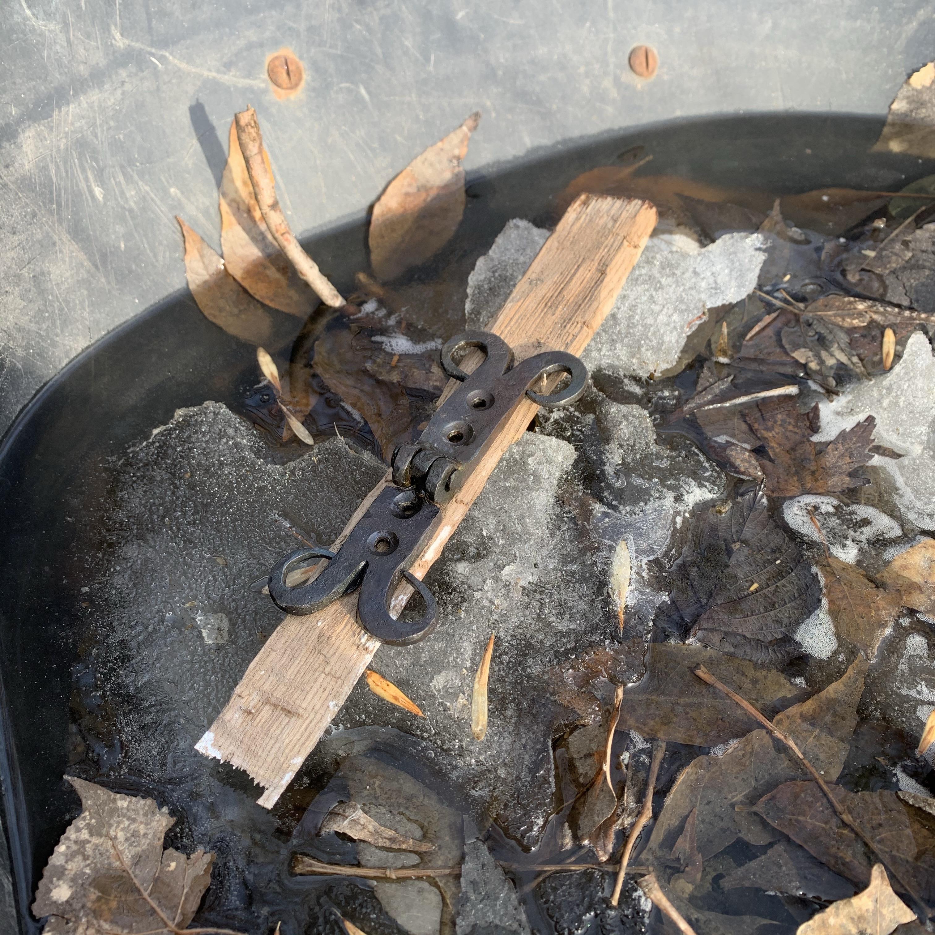

Justin Topp Posted March 26, 2020 Author Share Posted March 26, 2020 Yup. Refinement is something I need to work on. Here is the Very small wrought iron Swivel hook I made yesterday. Far from perfect but it swivels and can hold some weight. More for fun though. I think it can hold around 25-50 lbs probably. Quote Link to comment Share on other sites More sharing options...
Justin Topp Posted March 26, 2020 Author Share Posted March 26, 2020 I hung 200 lbs off it and it didn’t complain. I thought maybe 50 lbs max but geez this little swivel hook is impressive Quote Link to comment Share on other sites More sharing options...

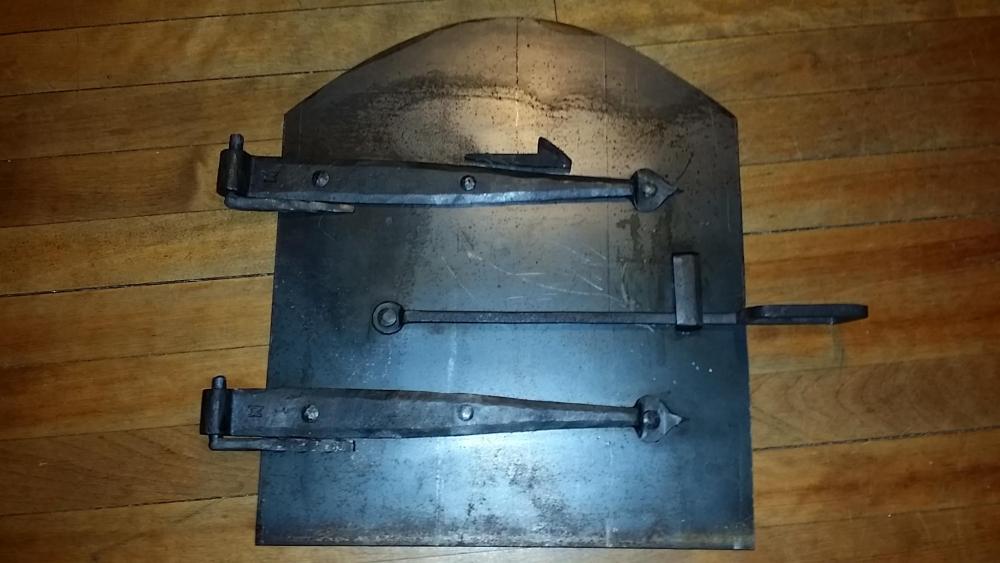

Justin Topp Posted March 26, 2020 Author Share Posted March 26, 2020 Well I suck at making hinges. Huge respect for the folks like JLP who can do this nicely. Here is my first attempt at a hinge Quote Link to comment Share on other sites More sharing options...
Chris C Posted March 26, 2020 Share Posted March 26, 2020 Well just let me say..............I hope I can "suck" that well some day! Quote Link to comment Share on other sites More sharing options...
Justin Topp Posted March 26, 2020 Author Share Posted March 26, 2020 Haha. I’m happy with it for the most part but the pivot area was my biggest area of challenge and didn’t come out too perfectly Quote Link to comment Share on other sites More sharing options...
Frosty Posted March 26, 2020 Share Posted March 26, 2020 Good GRIEF Chris! Here I was primed to tell GD2 how nice his hinge looked and you drop a straight line I'm restraining myself through supreme efforts to not get myself moderated for picking up! You're a cruel man Chris. C R U E L! Oh NO not another straight line! Tell me GD2 how DO you define "too perfectly?" Where is the sucky hinge? I don't see a sucky hinge, I see a pretty nicely made one. Mine weren't generally that nice last time I made hinges. Frosty The Lucky. Quote Link to comment Share on other sites More sharing options...
Justin Topp Posted March 26, 2020 Author Share Posted March 26, 2020 Haha thanks Frosty. Let me pick apart my horrid hinge haha. The pivot doesn’t line up perfectly. Rivet isn’t perfectly peened and even. The little scroll things are not perfectly symmetrical. But. It functions so it’s not as bad as it could be Quote Link to comment Share on other sites More sharing options...
