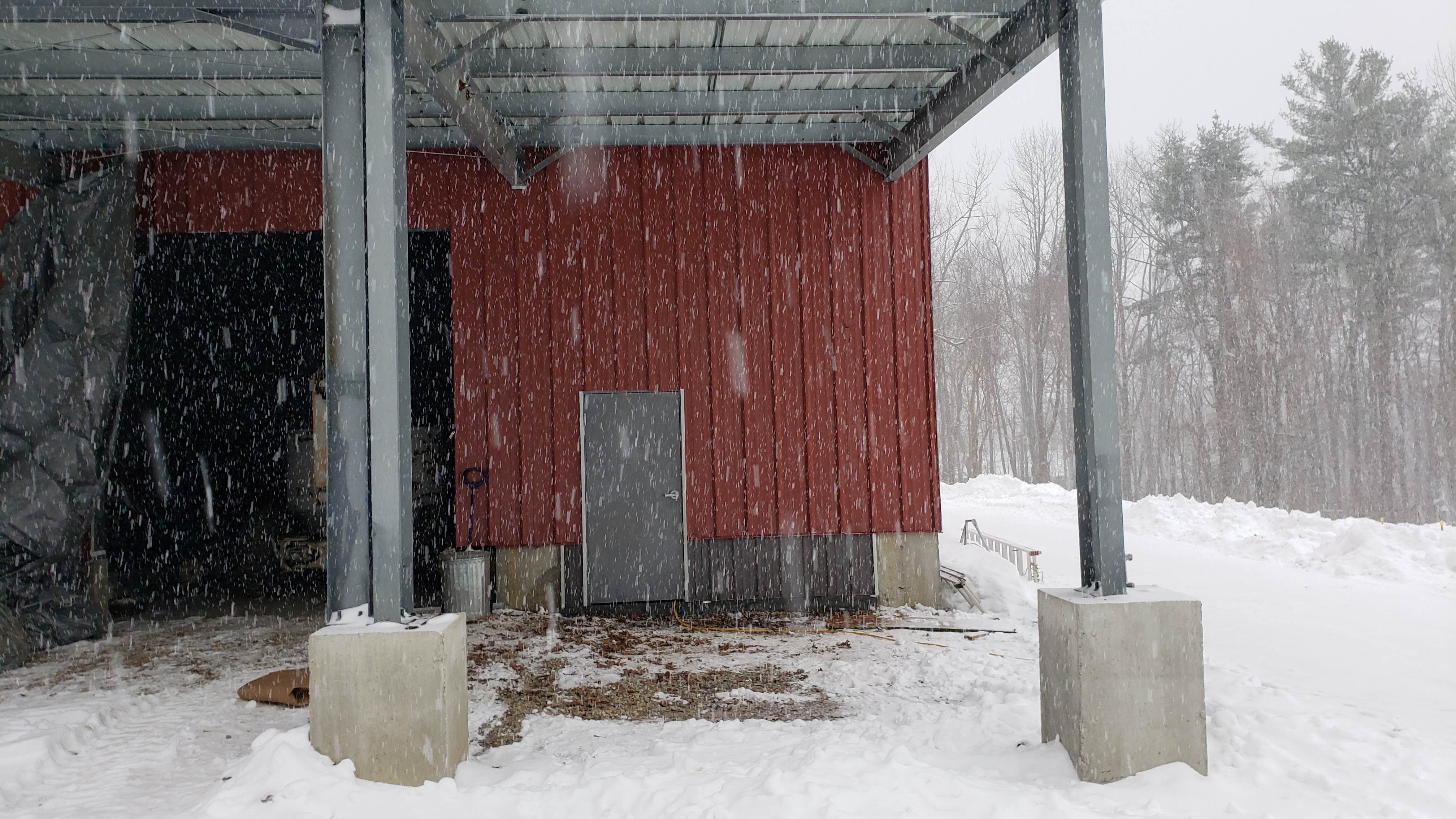

So, nice thing about the shop setup.. the roof definetly kept the snow off out where the steel supply will be kept.
Also there was no snow drifting into the front garage door area though the north side of the building still has frozen snow and ice stuck to it.
Not a whole lotta work was done today.. (have a really hard time getting going with snow and cold)..  With this said, with the light fading I did move the large 12ftX12 metal sheet that will be the bottom portions of the foundation covering/siding in front of the shop for easy cutting.
I'm hopeful tomorrow will bring inspiration and I might get the bottom panel cut for the front and around the bottom of the door.  The last side panel for the top will take some serious pep rally type stuff.  All else being equal I will work on the back door section that has the fume extractor pipe sticking through.

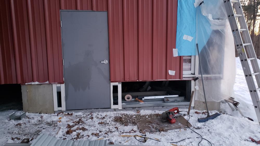

Anyhow, between the 11" of snow we got yesterday and the 18F temps it was a tough work day out there.
I did manage to get the bottom section of metal cut and then figured out there is no top lip for it to mount to.
So, then spent 15minutes trying to figure out a way that will both be pretty easy with materials on hand, offer the ability to insulate up into the newly formed area and make it strong and able to handle the stuff from entry and exit and foot traffic.
It was cold enough today, that when I kneeled down to saw the 3/4" stone froze to my coveralls on both knees.
Just before the snow storm I was able to clean up the area so there is room for the tank, the electric line run and organized all the items so they are well stacked.

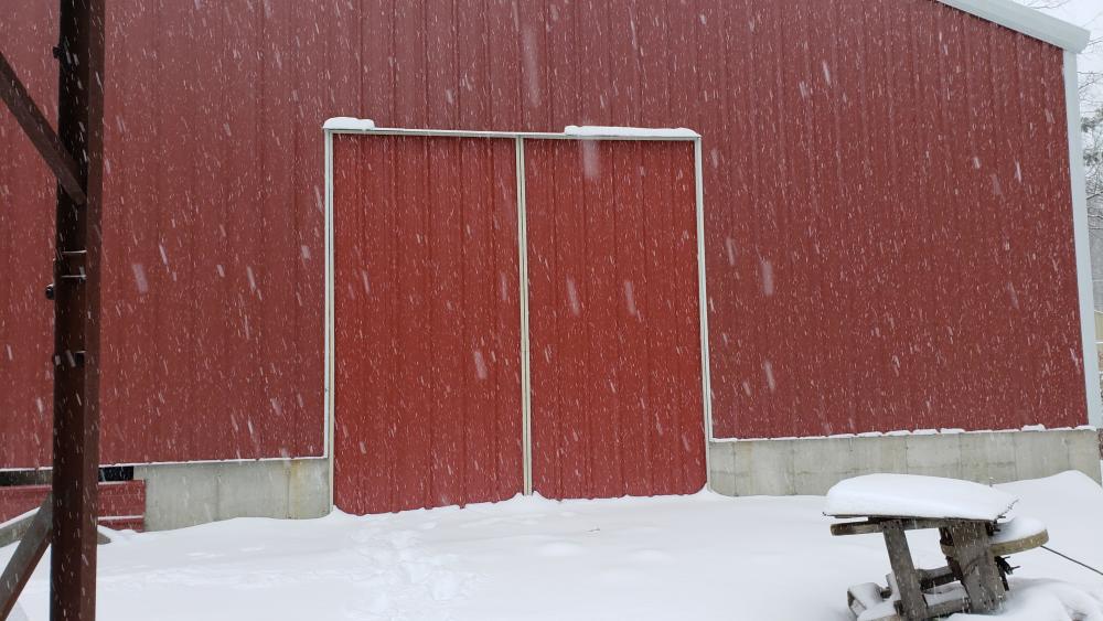

Nice to see the snow OUTSIDE the shop!  I had 3 friends forging in T shirts this afternoon, with the 10'x10' roll up door up and the open gables...we can see snow on the mountains; good place to keep it in my opinion!
Thomas, You can come and take all of it away. Snow that is. I'm not a fan..
Just makes everything harder..
My normal work as well as everything else I do..
On a fun side I do like snow and the opportunities it presents and if I worked inside all the days and had nothing to do but have fun in it, I would feel differently.
And yes for sure snow outside..  I did have to melt some snow that came in from the last big storm so had the IR propane tank mounted heater behind the grey panels..  I washed them up to get ready for insulation.
We usually have a little warmth between snows so things melt a tad.. Not this time.. Another 4" today.
I'm still figuring some of the building stuff out. I have to install the upper door trim and then install some rear supports to screw to.  The door frame is a little narrow for the installation of the metal siding and trim, so had to learn where to screw.
Anyhow, one step at a time..  And I would have loved to been forging in t shirts and complaining about it being to hot.
