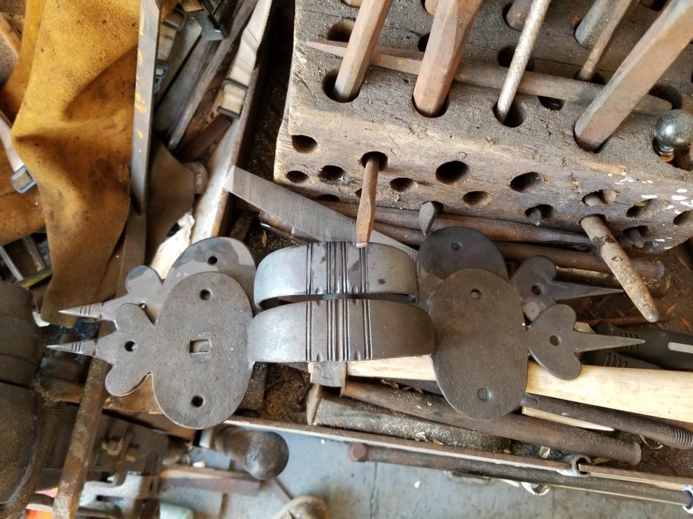

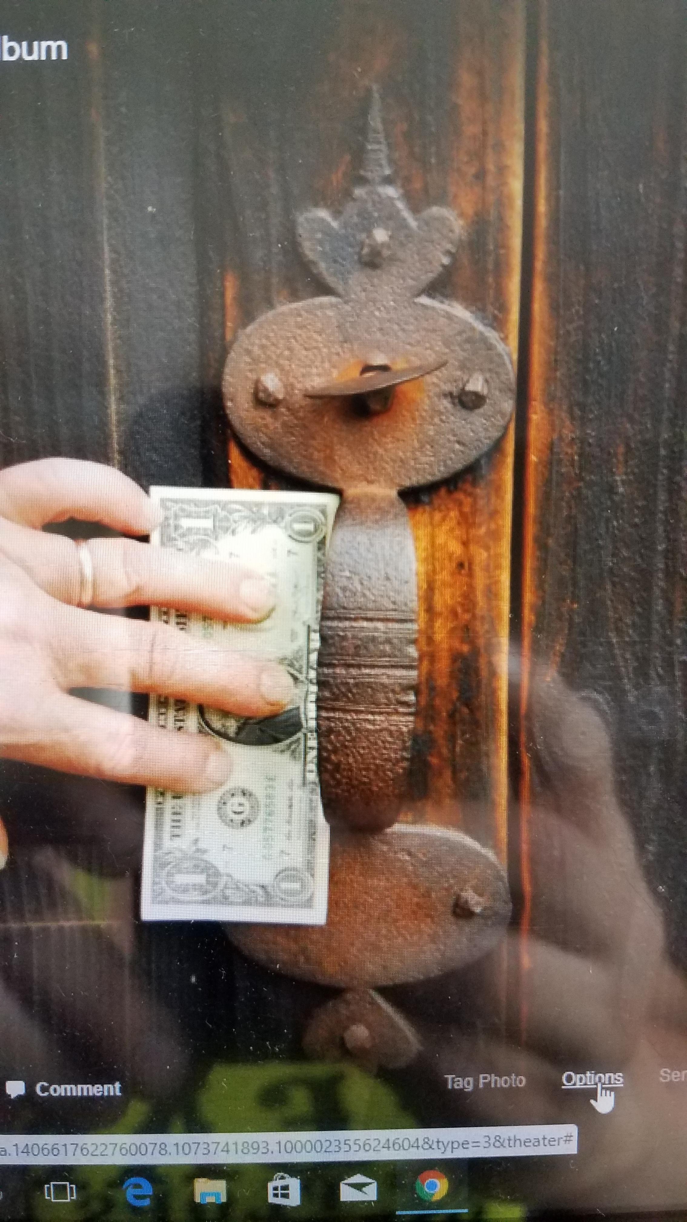

jlpservicesinc Posted November 26, 2020 Author Share Posted November 26, 2020 So there is a story behind this latch too.. I met a guy at a demo.. I did not know he was a smith of his own merit. he posted a photo of the latch with the dollar bill.. Not knowing the guy I told him I'd be happy to come to his shop and help him forge that latch. So, I made the latch from the photo he posted on FB. The sketch is of the latch. The photos are of the second latch which I documented and filmed for a time when I wanted to make a new video. Quote Link to comment Share on other sites More sharing options...
George N. M. Posted November 26, 2020 Share Posted November 26, 2020 J, I pretty much agree with you on everything including how to price a job. In the end, all we have to sell is our time and skill. And trying to make things faster and faster is, as you well know, the fastest way to burn out, when it isn't fun any more. Question on the dollar bill latch: Are the decoration lines struck or filed in? They are very well done. Have a Happy Turkey Day and stay safe. Better times are coming. "By hammer and hand all arts do stand." Quote Link to comment Share on other sites More sharing options...
jlpservicesinc Posted November 26, 2020 Author Share Posted November 26, 2020 Thanks George.. they were filed. Very few lines were struck on more modern hardware (mid 1600-up).. Files have been around for a really long time and the amount of work to chisel in everything is very time consuming. With that said, I do once in awhile do it for certain aspects where I want a really clean line.. I think it's different today also in that help or helpers are so few.. The dish to the handle makes it tough to do a good job quickly. I didn't mind the faster thing.. It was meeting with people that finally got me. The story is in the about me thread here on IFI.. Which at some point I need to get back over there to continue the story.. (Pheonix rebirth).. I love forging metal and once the shop is complete I will get back up to speed. Tough with so little time at the forge. Happy Thanksgiving to you and the family as well.. Much to be thankful for.. Quote Link to comment Share on other sites More sharing options...

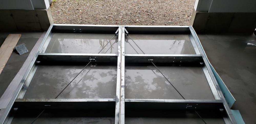

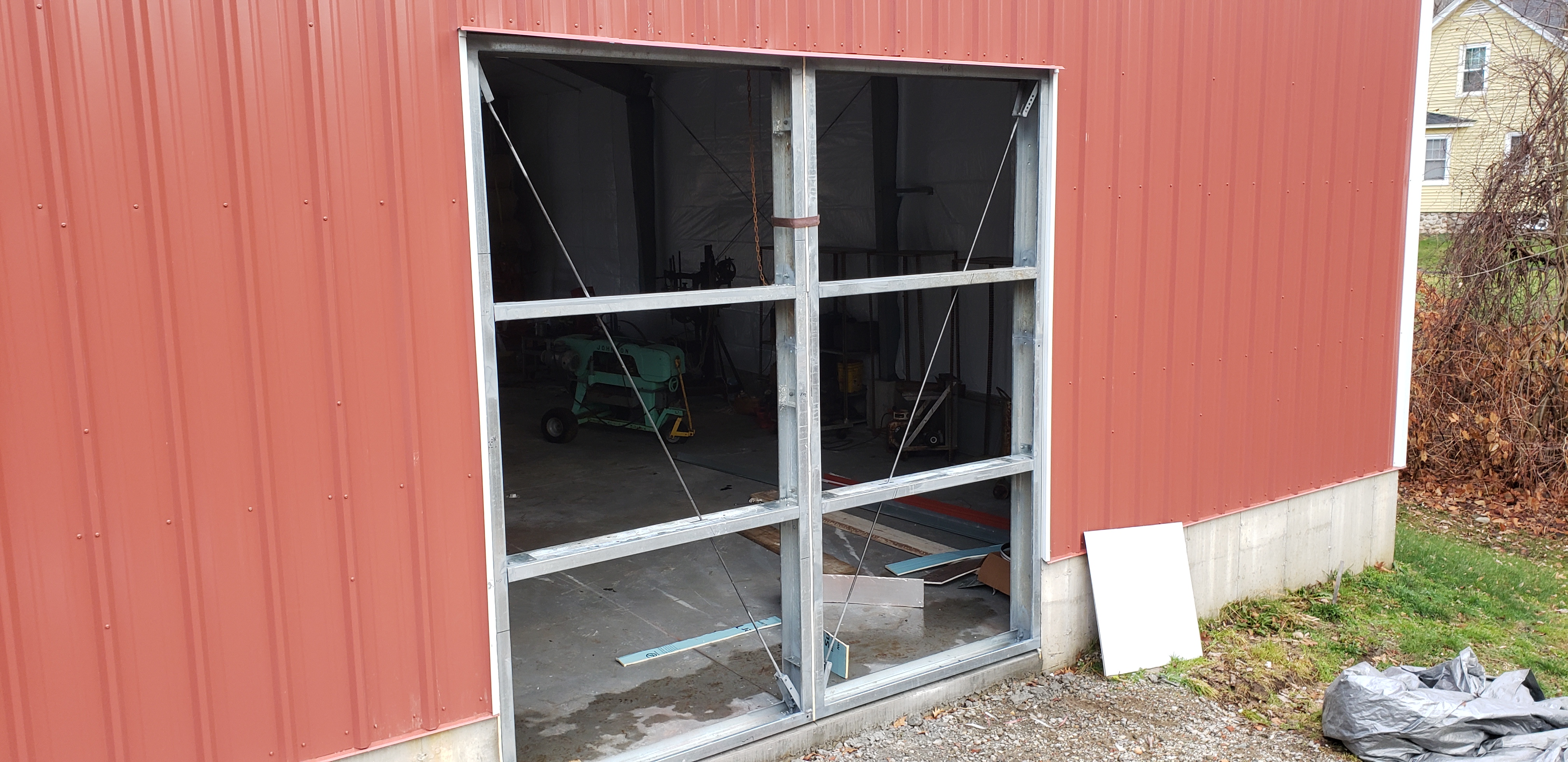

jlpservicesinc Posted November 28, 2020 Author Share Posted November 28, 2020 So, few days ago (like 4 days ago) I moved the doors into position put insulation between them both and bolted them together.. I then lifted them into position and they did not fit.. Few choice words were spoken.. Turns out because I only measured both sides at the walls (only way I could get a tape measure to stand up), the center sags some on the building so was exactly 1/2" off at the center.. I knew there was some sag but also figured part of the sag was the trim.. Not only are the doors large (tall) but also heavy and working by myself I had to figure out a way to get them into position. It took a few days but finally settled on a couple of straps off the man lift and once I figured that out I once again moved the doors into position knowing they would not fit. I get them into position and noticed if I used a lever between the door and trim/jamb the door would slide in but I could not slide in insulation which was my original plan.. So, I was able to slide the doors in but they will never move as they are 1/2" too tall.. ARgh.. To late in the game to make them operating doors right now anyhow and just planned on putting them up solid. I will next year pull them down and make them the required length keeping in mind now the adjustments that will have to happen then.. I'll have lights, electric and welders in at that point so will be easier to take care of vs moving out, over to the garage etc, etc.. Quote Link to comment Share on other sites More sharing options...

anvil Posted November 28, 2020 Share Posted November 28, 2020 Lol, measure twice( at least once!)cut once. Happens to all of us, at least once. A note to others, as I'm sure you know this, I use a 6' metal folding ruler for most of my measurements. It had its strengths and weaknesses. It doesn't burn up in the fire is a real plus. When I run into a situation measuring like Jen's above and a tape is not precise, I measure down from the top twards the middle and make a mark. Then measure up from the bottom to your mark. Add the two measurements together and as long as your math is correct, your total measurement will be right on "the mark." Quote Link to comment Share on other sites More sharing options...
Old Crew Posted November 28, 2020 Share Posted November 28, 2020 Jennifer You may not have to redo your door. You may be able to unscrew all of the sheets on the door header and prop it up with a 2x4 to the same height it is at the door jambs and then re screw your header sheets in new holes in the header. I see you un screwed to get your doors in. If necessary with the sheets mostly unscrewed you could trim the bottom of the sheets to get little more height? Sorry for the additional frustration though. David Quote Link to comment Share on other sites More sharing options...
ThomasPowers Posted November 28, 2020 Share Posted November 28, 2020 Sag and twist are the demons of building structures! Can you put a turnbuckle in to raise the center to where it's supposed to be? Quote Link to comment Share on other sites More sharing options...
jlpservicesinc Posted November 28, 2020 Author Share Posted November 28, 2020 Anvil, I have measured that space 300times if not a million.. Great info on measuring just the same and it wasn't the doors that were off but the center measurement which was in the middle of the air. Really I hate to sound like this but having a 2nd person makes all the world of difference in cases like this.. Someone with that second set of eyes and hands to keep things were they belong.. My metal tape measure has a magnet on it. but there was no way to really measure it accurately.. I'll know better next time to account for it right off.. Old crew.. I actually tried to loosen the bolts and do the prop thing when the frame was just there. A down and dirty so to speak. For some reason it sagged and i could not get it to correct with the limited 4 bolts I loosened and retightened.. I figured it was a design element they had worked in that would be corrected with trim.. In other words I imagine if I loosed all the bolts and then proped it up and then re did the sheathing.. It might level out. Honestly I don't know.. I am done with it this year though.. It will function as a wall that will be well insulated.. Next year i will have to make hinge plates and such for either side of the opening as well as for the doors so can address it in a shop that has power, and welders that can reach the spot handy.. Thomas, that actually might do it. But, that end wall is a total composite of 2 C channels bolted together with just a few uprights tying it all together. I realized now after looking at Garage doors and openers that the design is for that.. They leave just enough material to mount the items to. Ideally the sides need to have 2"X ?? to run all the way up to the torsion springs.. So there is not much more there. The outside sheating as Old crew pointed out would possibly be used to hold it in position.. With the inside bolts would have to be loosened then moved up and then new screws put in. So wires with turn buckles might do it. Quote Link to comment Share on other sites More sharing options...
Frosty Posted November 28, 2020 Share Posted November 28, 2020 It's possible to measure a thing too many times, I've been there done that. Another problem I've worked hard to overcome is my idea of precision. My idea is WAY too close for building construction, I kept getting yelled at by the builder who helped with the house for measuring +/- 1/8" and that's so sloppy it gives me the willies. On the other hand the roof is square to within 1/64" on any corner to corner or 3,4, 5 measurement we took. I had to yell at him for trying to guess how to compensate measurements when I was cutting. Don't try to figure out which side of the mark I cut, give me a number and that's what you'll get! Bummer about the door. I'd almost be tempted to grind some of the concrete but they I'd have to polish it to make it right. Take a breath, eat some leftovers and take it with a steady strain, it'll be okay. I have confidence. Frosty The Lucky. Quote Link to comment Share on other sites More sharing options...
