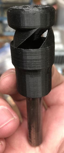

I finally dusted off the printer and have something to report here.  I got distracted playing with ham radio again.  Here is my latest flame:
It's not perfect but it is tiny:
It is coming out of an eighth inch(nominal) burner.  I thought the quarter inch burner was small.  Rocking a 2.25" long mix tube.
Mikey and Frosty have mentioned the smaller the burner, the more critical the build.  It is apparent with this little guy.  Using printer nozzles as orifices, 0.4mm runs purple lean and 0.5mm runs a tad rich.  If the nozzle overhang is changed a 1/16th of an inch either way, the flame lifts off or goes rich.  It is picky but I got it to run stable in it's narrow range.  It sounds like an angry little jet.
I finished turning down all the 3D printer nozzles into burner orifices and thought I should attempt to use some of the smaller ones in a micro burner.  Since this guy likes around 0.45mm orifice, imagine the burner that would use the 0.2mm orifice.  I am already gilding the lily with this one, I probably won't attempt a more critical smaller build.
Being so critical, I am going to be tinkering with this guy.  I am experimenting with nozzle shape to see what I can learn and hopefully extrapolate improvements to the larger burners.
You mean 1/8" schedule 40 pipe? Actual internal diameter 0.405" or 10.3mm.
Looks very nice! I'm planning a ~10mm (probably linear) burner for hand held use, and was expecting around 0.4mm printer nozzle to work (based on data on Mikey burners, they seem to like jets about 4% of mixing tube actual diameter), so you have confirmed I'm probably in the right neighbourhood so far.
Thanks Frosty.  I'm already playing with bits so small that if I drop them, they go into the abyss. Waldo work sounds like it requires a good deal of patience.  By multiple orifice burner, are you talking about a micro NARB?  If so, that had not entered my thoughts but now I am going to have to give it a try.
1/8th" schedule 40, yes.  Though 0.405" is the OD.  I got tired of looking up the chart, then cutting the diameter in half and then converting to metric so I made a spread sheet.
The ID is 0.269" for 1/8" pipe.  I got the calipers out and my pipe is at an actual of 0.264" so it is close.  Anyway, I am running 6.7mm at the 0.4 - 0.5mm orifice but my burners tend to run with a larger orifice.  If you are talking about a 10mm Mikey burner, the 0.4mm sounds like a good starting point.  Wouldn't it be great if your 4% observation holds true?
Every time I guess, I am wrong.  I have a trial and error collection.
Thanks for asking, my model was based on the chart not on actual so I have updated my model.  Every little bit counts and 5 thousandths probably matter.

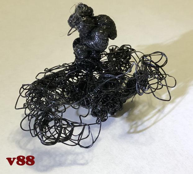

As I was writing this, I heard my printer finish printing.  It was printing another 1/8" inducer head with a change.  Here is the new version:
I trust my printer and this was a 1 hour print so I just clicked print and ignored it.  I walked into this.  Good for a laugh.  I wonder what size orifice it needs.

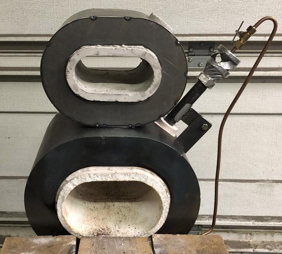

Been so busy enjoying the forges, we haven't spent much time on R&D.  I have a couple of burner experiments which will be showing up soon but we worked on forges.  3D printed forge forms have turned out awesome and now we are again after the unicorn forge.  Or maybe we just like lots of forges.
Here is the latest mini and big'un.
Of course, we have already thought of possible improvements we are plotting on the next one.  We are also going to do an in between size as the 3/8 burner can handle it.
I have long wanted to play with the idea of a split forge with a bottom mount burner but securing the refractory in the top portion has been our biggest hurdle.
Here is a burner size line up:
Thank you Mikey.  I mostly made the 1/8th inch to see if I could.  I imagine the forge it could support would be tiny even by my standards.  Nail makers forge.
Thomas, the bottom mount burners I have done are in the round edge pointed at 45° ish.  I also build with the wider floor space so I keep the metal away from the burner port as much as possible.  I have not had a problem with stuff falling in.
Here is a previous post with a shot of one of the bottom mounted burners

"We are seeing the same issue with the K26 bricks that we had with the K23's."
Are you sealing the hotface sides of those K26 bricks with a good hard refractory coating to keep their vary porous structure from flame damage?

Mikey, I sure didn't refractory coat the bricks.  I coated some in Matrikote 90AC but I did not butter the brick when applied so it pealed off in short order making it a poor test.  I intended on kastolite facing one but we made the kastolite/blanket half bricks before I got to that experiment.  The kastolite bricks are so amazing for my uses that I never looked back at the K26 bricks.  The 4 replacement kastolite bricks maybe took 5lbs of kastolite and have outlived an entire case of Morgan Thermal Certamic K26 bricks.  A case of bricks costs more than a 50lb bag of kastolite where I am.
