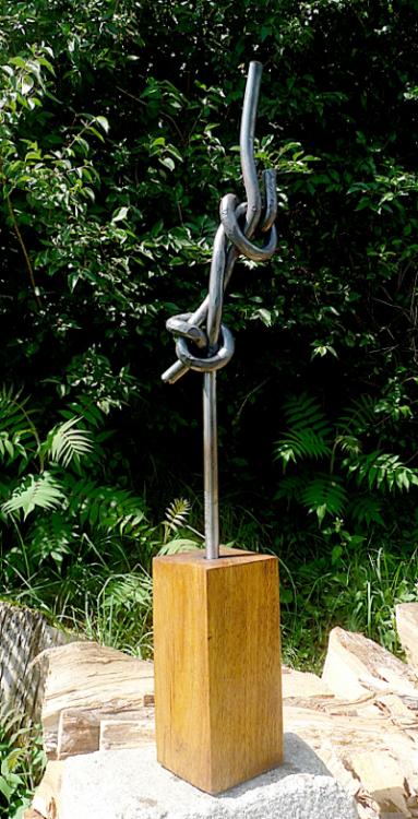

j-v Posted December 28, 2017 Share Posted December 28, 2017 20mm stock Quote Link to comment Share on other sites More sharing options...

Daswulf Posted December 28, 2017 Share Posted December 28, 2017 Awesome work. I can't imagine wrestling 20mm bar to make those. Thank you for sharing. Quote Link to comment Share on other sites More sharing options...

MotoMike Posted December 28, 2017 Share Posted December 28, 2017 I love those sculptures JV. I wouldn't mind seeing a WIP if you have one . I have trouble thinking how I would go about manipulating that much iron that much. Quote Link to comment Share on other sites More sharing options...
j-v Posted December 28, 2017 Author Share Posted December 28, 2017 i haven't got a real wip , a few pics taken .. Quote Link to comment Share on other sites More sharing options...

Marc1 Posted January 1, 2018 Share Posted January 1, 2018 Would it work to pull the knot tight using a chain pack? Quote Link to comment Share on other sites More sharing options...
j-v Posted January 1, 2018 Author Share Posted January 1, 2018 where would be the fun , the challenge .??? Quote Link to comment Share on other sites More sharing options...
Marc1 Posted January 1, 2018 Share Posted January 1, 2018 I see ... how about hanging it hot from a roof beam and hang a weight from the other end and encouraging it along with a hammer? Quote Link to comment Share on other sites More sharing options...
j-v Posted January 1, 2018 Author Share Posted January 1, 2018 lol !! i like difficulty ..i've got to find a heavy cooper hammer , to avoid making marks .. Quote Link to comment Share on other sites More sharing options...
Marc1 Posted January 1, 2018 Share Posted January 1, 2018 Mm ... a copper hammer will probably mark it the same if it is hot enough. i am planing a gate and was thinking in adding a bar with a knot in the middle, inspired by your sculptures. I can see how to do a knot at the end of a bar, how would you make a knot in the center of a one meter long bar in say 16mm diameter? One would need to heat at least one half of the bar to loop it around and make the knot ... mm ... now that I think about it, i can fold it in half by heating the center. then heat again to fold it over and finally heat from one end to the knot to thread it in the loop. Mm ... I like it ... still the chain block is my fall back plan Quote Link to comment Share on other sites More sharing options...
j-v Posted January 1, 2018 Author Share Posted January 1, 2018 post some pics once it's done ..thanks Quote Link to comment Share on other sites More sharing options...
Marc1 Posted January 1, 2018 Share Posted January 1, 2018 Will do,. As far as no marks, try a hardwood mallet. A nice chunk of Ironbark ... mm ... you are in France ... really old oak? Quote Link to comment Share on other sites More sharing options...

j-v Posted January 1, 2018 Author Share Posted January 1, 2018 11 hours ago, Marc1 said: Will do,. As far as no marks, try a hardwood mallet. A nice chunk of Ironbark ... mm ... you are in France ... really old oak? yes i'm french, really old oak , i should find a piece , i'll try it ..or black locust ?, 38 minutes ago, Frosty said: Nice work J-V. One of our guys up by Delta Junction is your kind of knotty. Frosty The Lucky. thanks !! Quote Link to comment Share on other sites More sharing options...

ThomasPowers Posted January 2, 2018 Share Posted January 2, 2018 Marc1, do it on the end and weld the other section onto it. Quote Link to comment Share on other sites More sharing options...
j-v Posted January 3, 2018 Author Share Posted January 3, 2018 merci !! i want to trie a monkey fist during 2018 , i think it's going to make me sweat !! Quote Link to comment Share on other sites More sharing options...
jeremy k Posted January 3, 2018 Share Posted January 3, 2018 A monkey fist??? Wow you like challenges - As one who has tied many many monkeys fists - the retightening process in steel will be a major chore. I don't think Ive ever seen a steel monkey fist knot. Good luck Sir.!!! Take pictures Please. I'm sure it can be done though. Quote Link to comment Share on other sites More sharing options...
