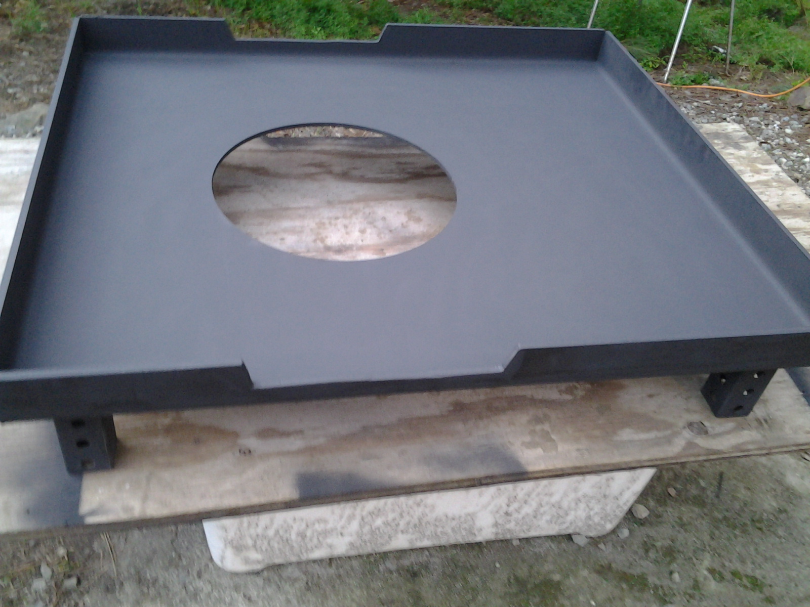

Charles R. Stevens Posted November 1, 2017 Share Posted November 1, 2017 If your building a trailer, why not build a steel forge pan? a steel pan, hood etc. can be lighter and more durable than brick. Link to comment Share on other sites More sharing options...
old school blacksmith Posted November 2, 2017 Author Share Posted November 2, 2017 A forge pan?? Can you please show me a picture of what it looks like so I have a better idea of what you are talking about. Link to comment Share on other sites More sharing options...
Charles R. Stevens Posted November 2, 2017 Share Posted November 2, 2017 I raided these images from other IFI posts The first is a steel hearth pan for a bottom blast forge with a fire pot and the second is a steel hearth for a sideblast forge. As brick, you can as well make a pan to line with brick. Charcoal still requires you to contain the fire in a small efencent shape, wile coal is more self limiting and the coal itself can act as the fire bowl. One can also weld up a trench like the ones we are digging out of dirt in the dirt box forge . A fire pot can be built side blast. Steel, being fire resistant makes for a more portable forge than either dirt or brick, that's why we see rivit forges with stamped steel pans or cast iron ones. Traveling and mountain howitser pack forges were using sheet iron pans as well. Being that they didn't have flamible materials making up the bottom, they were about 6' deep insted of 8" Link to comment Share on other sites More sharing options...
