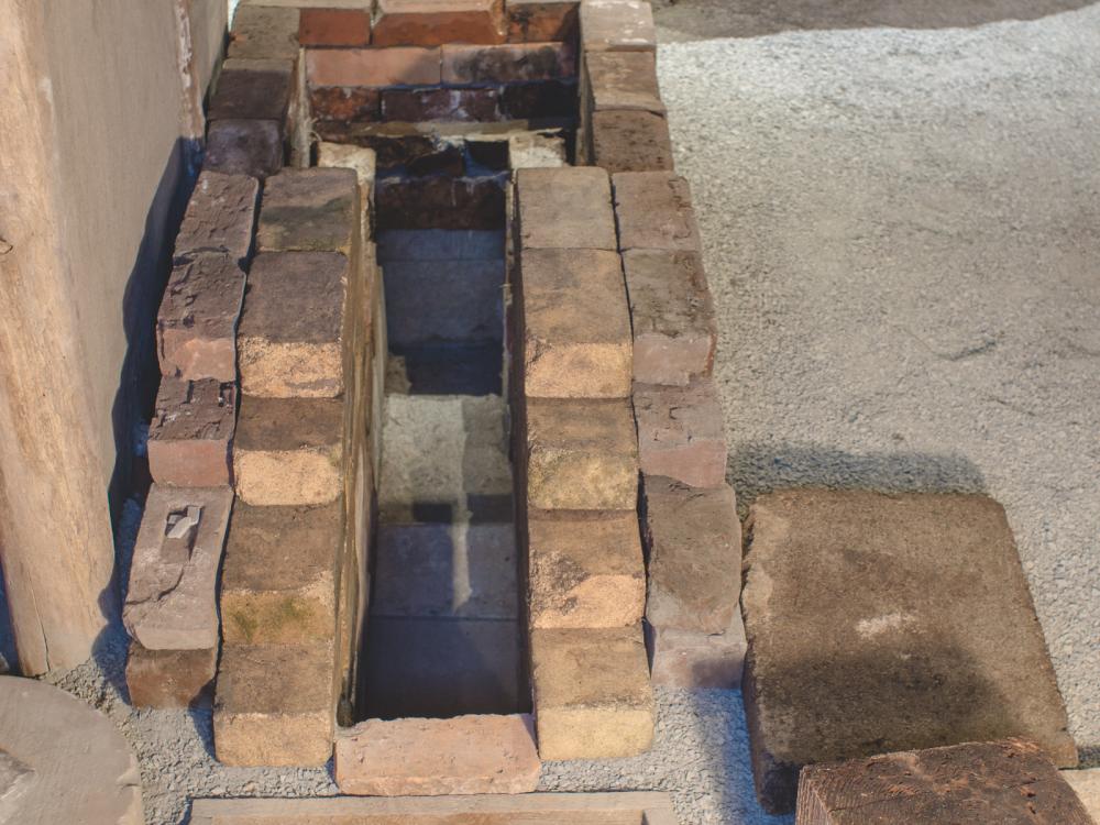

old school blacksmith Posted May 19, 2017 Share Posted May 19, 2017 hey if you are a blacksmith that has a brick forge or knows some knowledge about brick smithy forge please I need major info. On how I can seal up the bricks that I have for my forge and what is the extremely best thing to do so. Also if you do this for a job mostly and not as a hobby please reply a.s.a.p.! Hobbyist you can answer as well. oh the attachment pic is somewhat what I'm trying to build. so please help me! and it needs to be at least under $55.00! Link to comment Share on other sites More sharing options...
Glenn Posted May 19, 2017 Share Posted May 19, 2017 Did you review the Forges section on the site? Was the information there helpful? The cost of the project is directly related to your ability to scrounge materials. There are several different types of mortar. Choose the one that works for your application. What do you plan on forging? The type smithing you plan on doing will determine the size and shape of the forge. If you add your location to your profile there may be someone close to your location. If you join the local blacksmithing group or organization, you cal learn more in a single day than you can ever imagine. Link to comment Share on other sites More sharing options...
old school blacksmith Posted May 22, 2017 Author Share Posted May 22, 2017 swordsmithing that's what I'm going to do but like I said I need some way or name of a sealant that can hold it together ! Link to comment Share on other sites More sharing options...
Glenn Posted May 22, 2017 Share Posted May 22, 2017 You may want to use different type bricks and different mortars for different parts of the forge. The heat zone motar would be different from the construction morals. A quick search for refractory mortars Indianapolis IN gave 3,900,000 RESULTS. Indianapolis IN is a large place and you should be able to find a source locally for the motors you need. Link to comment Share on other sites More sharing options...
Frosty Posted May 22, 2017 Share Posted May 22, 2017 Welcome aboard Old School(?) Blacksmith, glad to have you. You REALLY need to slow your roll, all you'll accomplish being in a rush if making mistakes faster and more permanently. I don't believe you know enough about blacksmithing to know what you need, it's certainly not what you want. Believe me I know. Did you think about what you were saying in your first post? "extremely best?" There's Totally no such thing. You specify you want smiths experienced with what you want to do to reply ASAP? What's the emergency, you aren't going to bleed to death if you don't know how to lay a brick forge are you or maybe Guido is going to break your legs if you don't forge the Don a sword by Wednesday? We'll be more than happy to help you learn the craft but learning it is on you. I don't want to discourage you but you don't know enough to even ask basic questions let alone understand the answers. Spend some time and do some reading. Iforge archives have I don't know how many thousands of pages of posts from folk talking about blacksmithing. The archives are broken up by subject to make navigation easier. The people discussing things here are at all levels in the craft from acknowledged masters to guys like you with no idea other than the desire to make things from hot steel with hammers. Okay I confess I'm only a hobbyist and don't use solid fuel to heat my steel. Please, do some reading, take notes, draw sketches or print out pics and posts you think will be helpful. At least learn the language so you can ask good questions and understand the answers. I could make a couple dozen suggestions for how to build a brick forge with what you have in the picture but you wouldn't understand more than one word in five and none of the context. Honest, we love to help folk, it's why a lot of us are here but you have to have a handle on what you're asking. Frosty The Lucky. Link to comment Share on other sites More sharing options...
JHCC Posted May 22, 2017 Share Posted May 22, 2017 Okay, let's take this back a step further -- you posted this in the "Induction Heating, Oil forges, etc" section, but that looks a lot like you're planning on using a solid fuel? Maybe? What fuel DO you plan to use? If you're looking to do charcoal or coal, look up the 55 forge or the JABOD forge in the solid fuel forge sections. Those can be built for practically nothing; my own JABOD cost me about five bucks, but that was only because I had to buy some drywall screws. Link to comment Share on other sites More sharing options...
ThomasPowers Posted May 22, 2017 Share Posted May 22, 2017 If charcoal I would commend to your attention the `Tim Lively washtub forge` as an easily and inexpensively built charcoal forge designed for bladesmithing. If you are not a skilled bladesmith you don't need to worry about swords quite yet---sort of like telling us you plan to race in the Indy 500 and you want to buy a race car cheap to learn how to drive in... I spent 4 years near the Castleton Mall in the Indy area; hope to see you at Quad State one year and please look into going to the IBA Conference June 2-4 where there will be a bunch of smiths and blacksmithing equipment for sale; well worth selling plasma to attend! http://www.indianablacksmithing.org/Conferences/2017_Brochure.pdf Link to comment Share on other sites More sharing options...
old school blacksmith Posted May 23, 2017 Author Share Posted May 23, 2017 I know a very good portion of blacksmithing because I've been doing research and studying the topic. also when I say ''extremely best'' I mean what is the known and best sealant that you guys already used and it held together. that's what I mean also I'm using fireproof bricks for doing this. and I'm not rushed I'm just having trouble finding the right sealant to do so that's all. and the reason my username is old school blacksmith is because I'm doing is 100% old.... medieval style! and thanks for trying to help me out guys! Link to comment Share on other sites More sharing options...

Buzzkill Posted May 24, 2017 Share Posted May 24, 2017 If you only have $55 to get started then you were already given the best advice you can get. Look at this thread: https://www.iforgeiron.com/topic/44842-just-a-box-of-dirt-or-a-simple-side-blast-forge/ In simplest terms a forge is a hole in the ground with an air source. We elevate that hole for convenience. You have a nice pile of bricks, but just because you have something doesn't mean you have to make a forge out of it - at least not yet. A brick forge is usually a rather permanent object. Even if you want to build that some day you'll be better off getting started now hammering on hot steel with something cheap and simple. When it comes time to build that brick forge you'll have a much better idea of what your wants and needs are. You can easily get started under for under $55 if you don't have tunnel vision. You need a hot fire, a hammer, and something solid to put the hot steel on when you hit it. If you insist on a brick forge, a London pattern anvil, and starting out by forging swords it's not very likely you can get started for $55 or less. Don't focus on what you see as the problem. Define what it is that you want to *do* not what you want to *have*. That way you can consider other possibilities that will take you to where you want to go, even though they may be significantly different than your original plan. Link to comment Share on other sites More sharing options...
