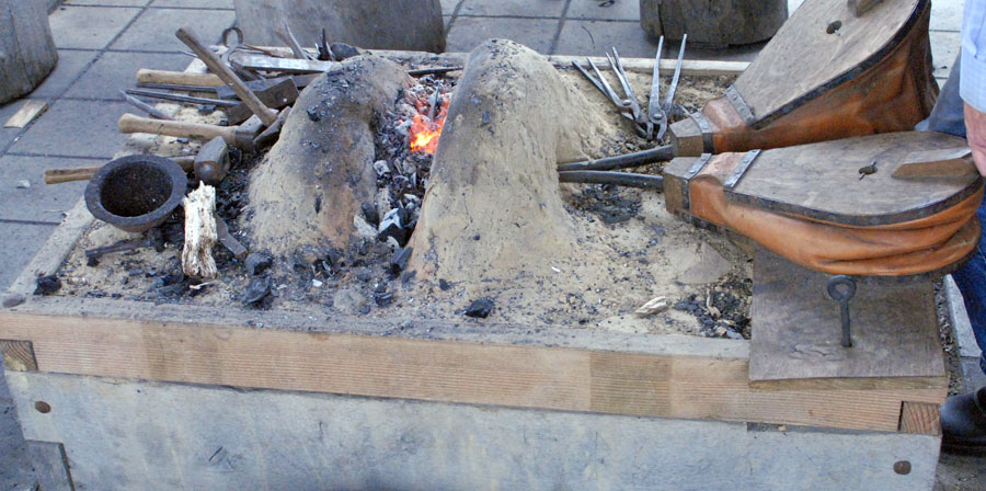

third we will recomend to you to start with a small general use forge, Vikings, romans, Iron Age Gauls, etc all forged swords in forges that heated about 6" at a time to forging temp. You only need a long forge to heattreat a long blade.
so here we go,
The bricks will be fine just as a loose pile, untile you figure out what you are doing and how a forge works. Clay rich mud has been used as mortar for milinia, and its cheep, so that's were I would start, I would also find a way to keep my forge dry, brick absorbs water, water turns to steel, wet hot bricks explode. We call this spalding, but it's no diferent from shrapnel from a grenade going off two feet from your face.
i have done a lot of experiments in building cheep sidblast forges for charcoal, and I commend you for not starting with a brake drum. You would have spent your whole budget on 2" pipe fittings.
I personaly don't like the noise of hair driers. Electric bed pumps or vacuumed cleaners, and for charcoal the make way more air than you need, I suggest the lowly double action bed pump.
$10 at a sporting goods place neir you, combine it with a schedual 40 black pipe nipple about 8" long or so and we are off to the races. I like this particular one because it's larger than most, and the air outlet is on the base not the handle. It works like an Asian  box bellows.
So let's look at the particulars, you want at least 2" of brick under the fire to keep the bench or table you set up on from burning, and at my age a ground forge is hard on ines knees. Chose a table that will put the heart of the fire at about anvils hight. So about 2'. Lay a layer of bricks down to make at least a pan 18" square, up to a 30" square, now lay out a 8" square for the fire, you want the tuyere ( the pipe) at least Ann inch off the bottom and flush with one side, mud works just fine to fill in around it. Now lay up more brick to have 3" above the tuyer. This is the center of the fire were you want the steel for most work. On at lest one side stack brick as a wall at least 4" tall, best if you do both sides. This holds the fuel in a pile and conserves fuel. For a more effecent fire for knives and most of the work a young guy will do, the 8x8 whole can be made 4x8 and the walls be 4" apart. Saves fuel and charcoal being low density burns fast.
This gives you the basic idea. By the way a brick with 3/8 of mud mortar takes up 2"x4"x8" so walla. Later on you can build your sword forge by making a longer trench with 2-3 tuyere and burn a bushel basket of fuel at a time, but you only do that to heat the sword to quench it. You will still forge it in the small effecent forge, because repeatedly heating the whole blade length will degrade the steel.
Oh and FWI, many of us have ADD (and worse) we manage it. Medication is good to cut the edge and give you breathing space to learn the tools you need to manage it. I personaly won't take that as an excuse, I will expect you to be responsible for managing it. Welcome to the club little brother.
Nice forge!   a "Y1K" forge lifted up to a convenient height and even has a bench for the bellows thrall to sit on!
We keep trying to reinvent the wheel, TP. As you well know the historical record provides so many elegantly simple solutions to problems. High tech often is expensive, wasteful of resources and more polluting than tried and true tech. I was surprised to find evidence of the use of heavy copper tuyere in direct process blumidary smelters of the Iron Age. Y'all involved in experimental archioliy rock
