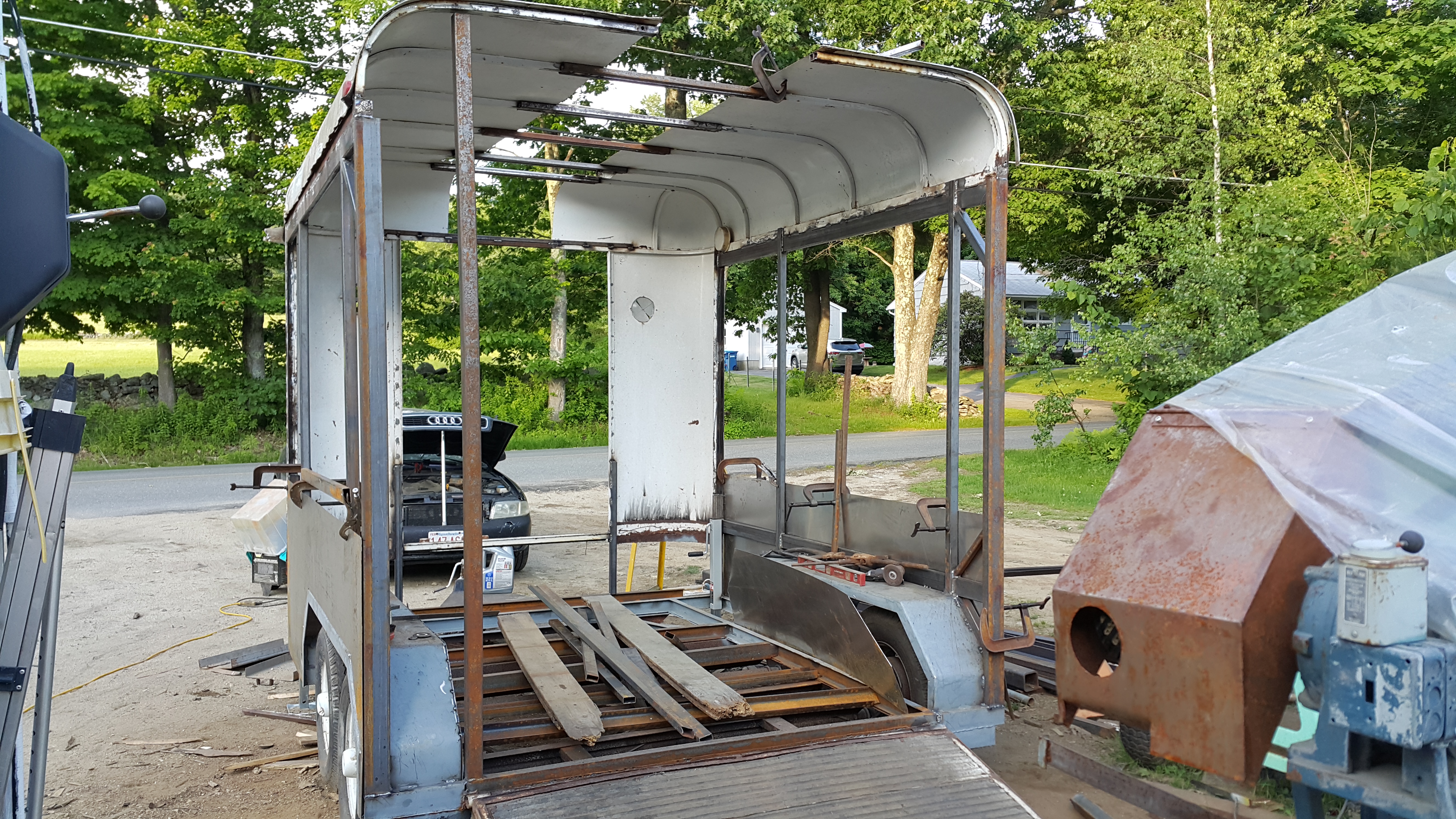

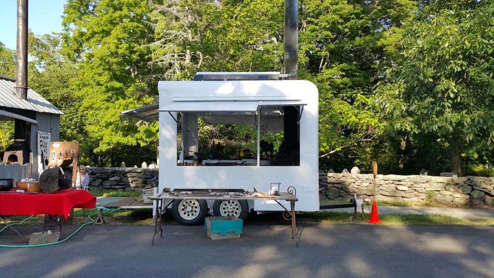

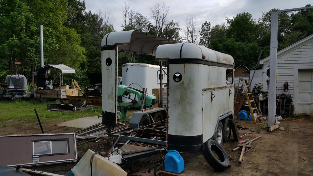

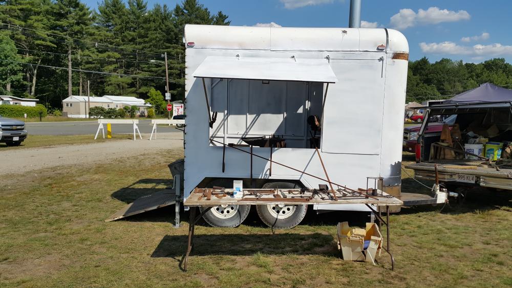

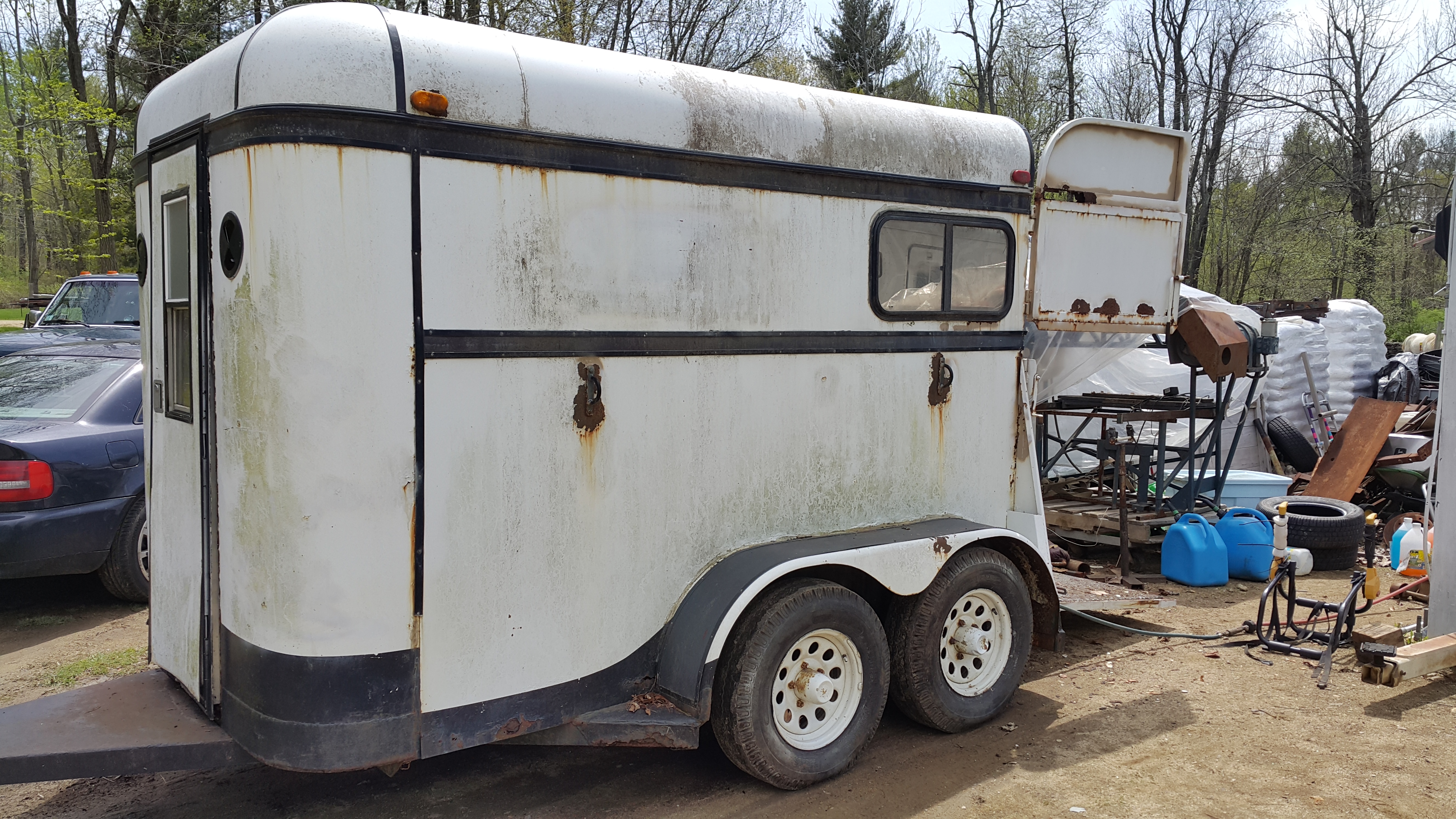

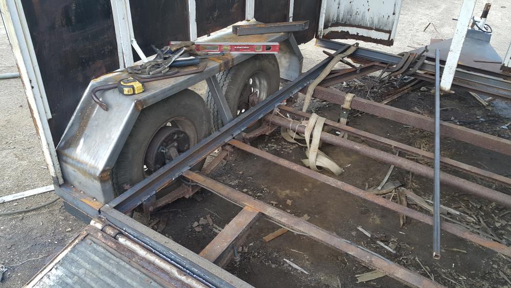

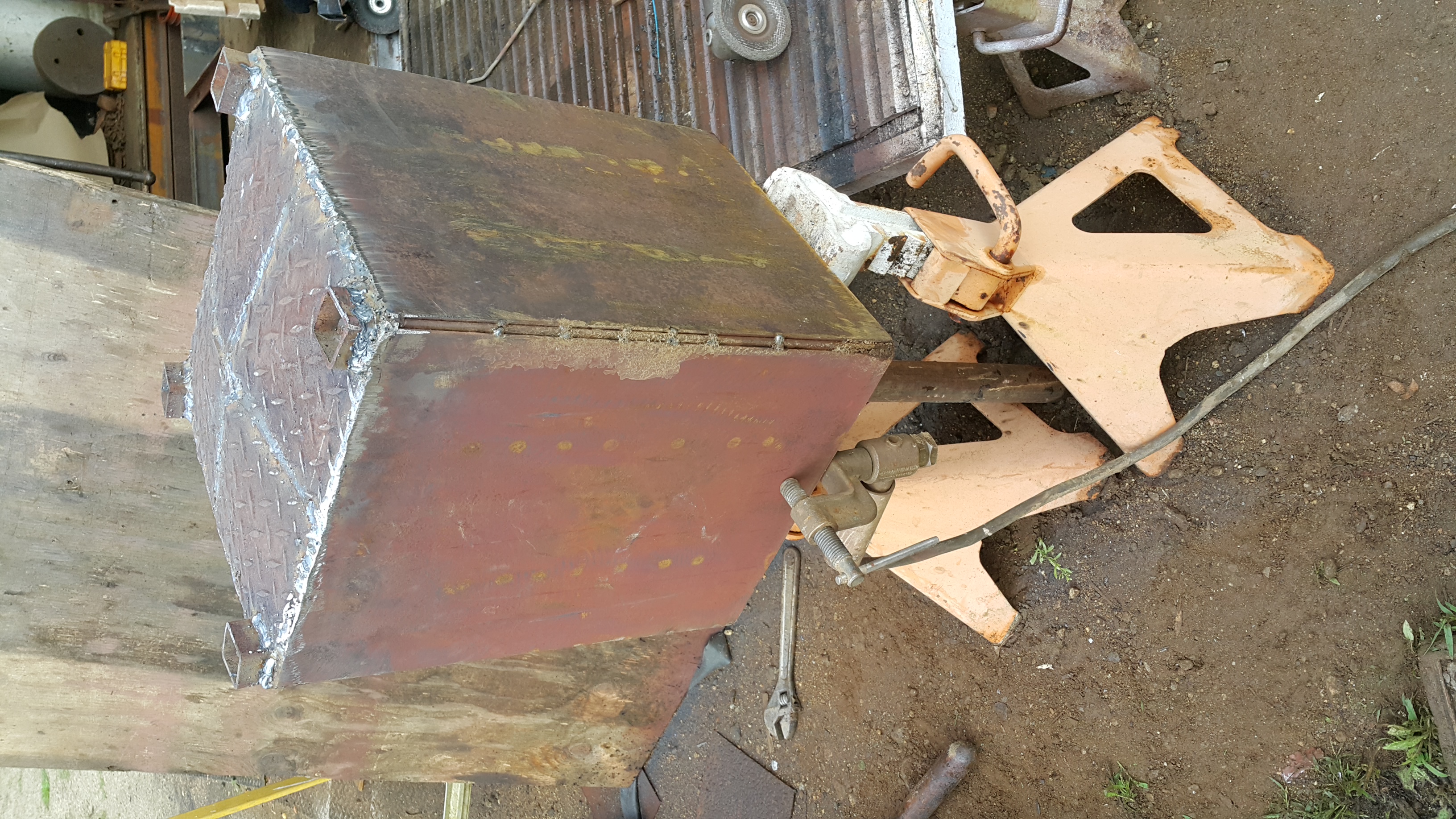

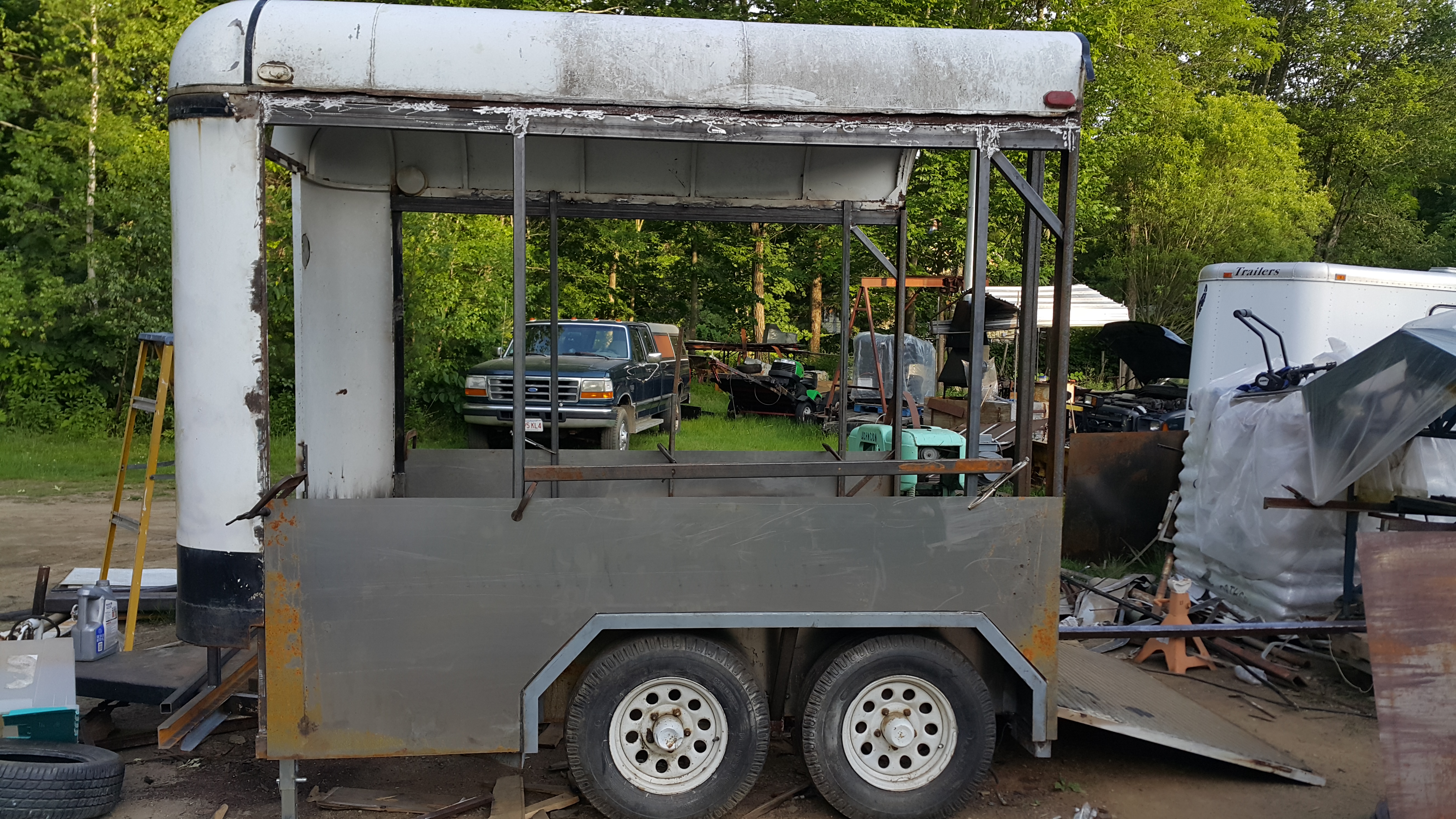

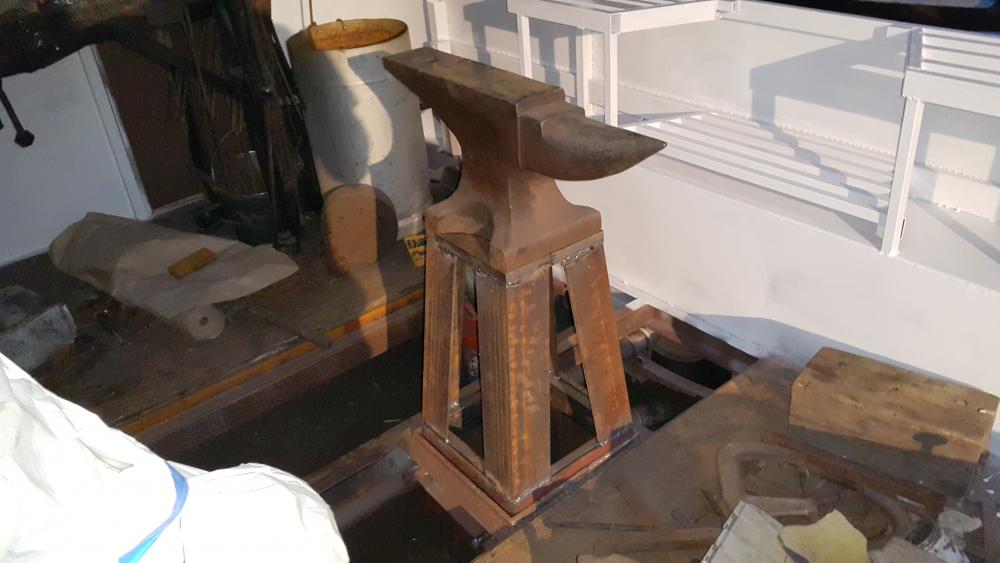

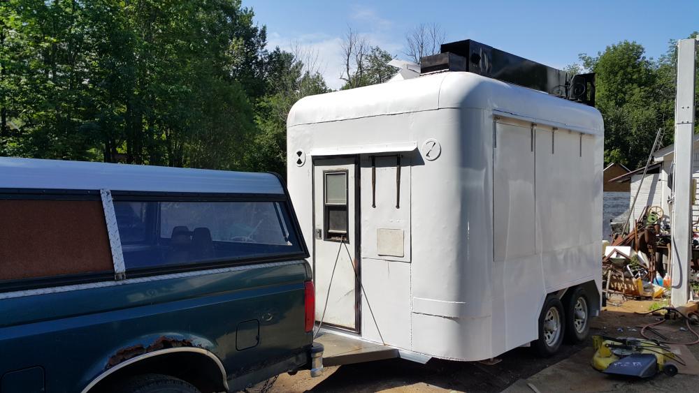

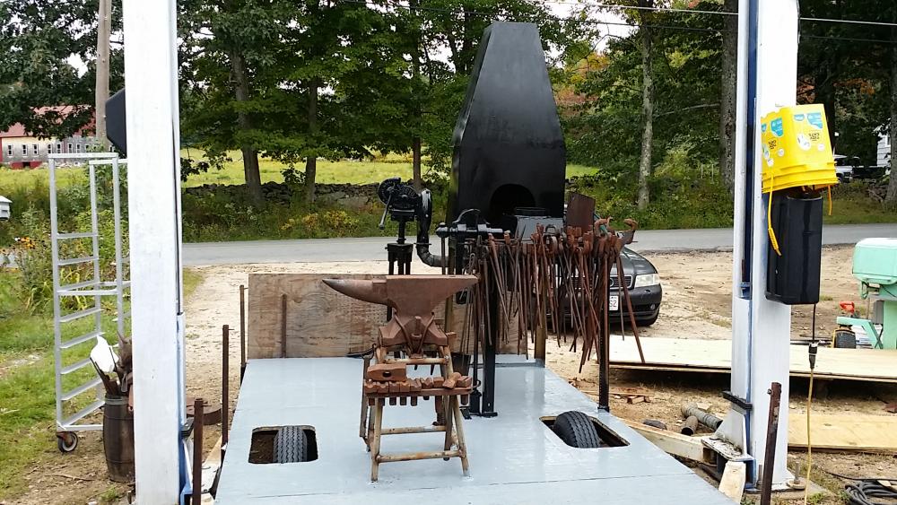

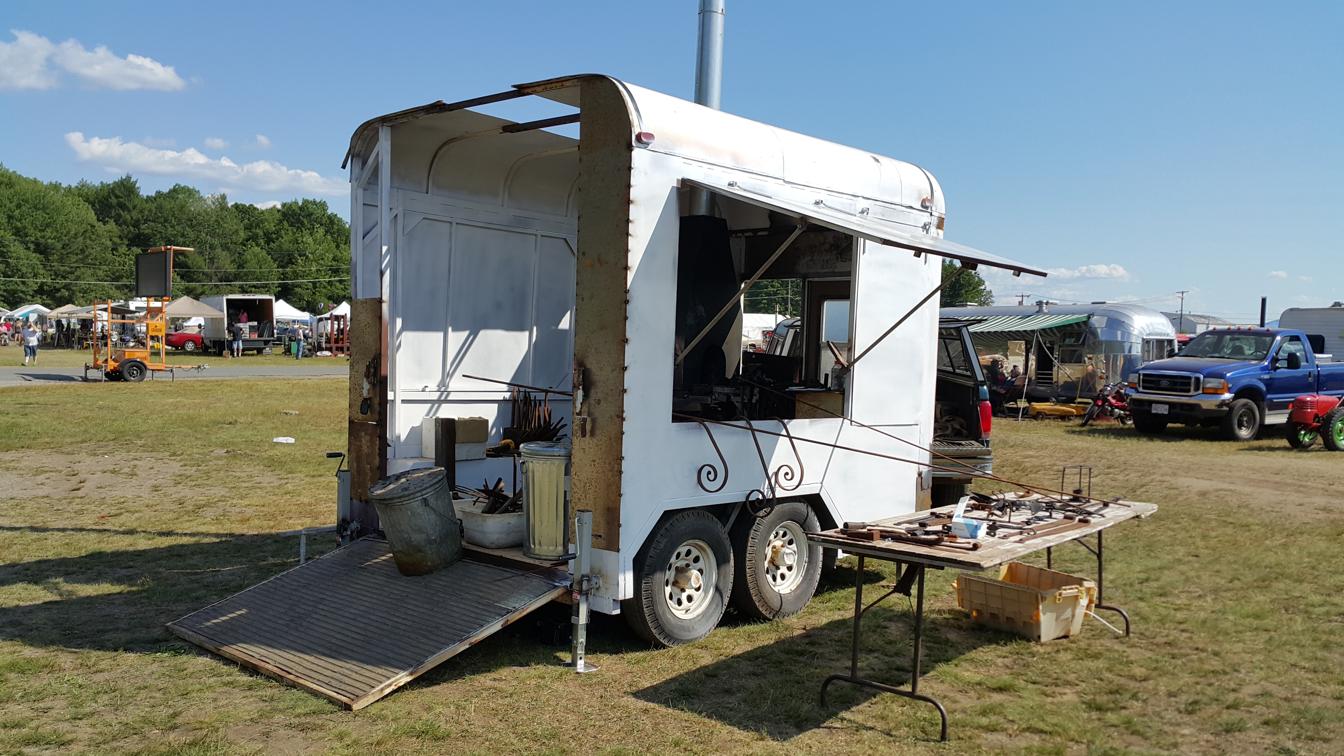

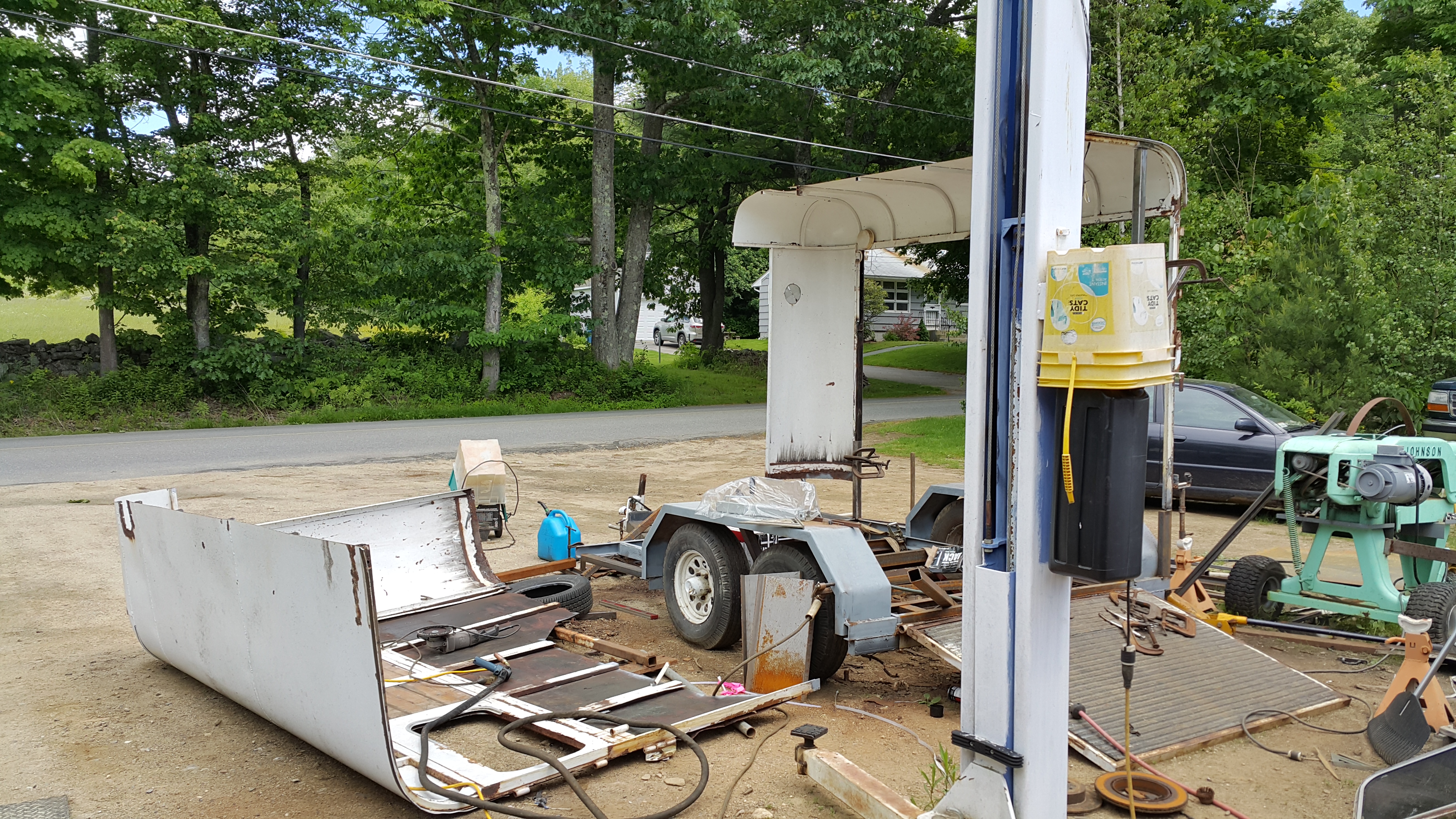

jlpservicesinc Posted June 26, 2016 Share Posted June 26, 2016 Been at this a long time.. This is my 4th trailer setup in 30 years.. I hope it will be the last I will build.. Took and old horse trailer and made it a full 8ft wide and 8ft tall inside and 10ft long inside. it is still a work in progress as I had to have it done for a demo day so was only able to get it done enough to use.. Will finish it this week or the next.. The anvil will be on a stand that rests solidly on the ground and will winch up for transport.. Currently using the stand from my other trailer which is light pipe bolted to the underframe.. STill to much bounce.. It has awnings on all 4 sides with 2 on each side, 1 in the front to let bar stock to pass through and the back will have 1 large one on the top. All these to control cross flowing winds, will have a roof much like a sugar shack with windows so they can be opened for ventilation.. Undecided if I should put clear glass or not as the sun shining in when it's 90F out is a big problem.. Yesterday was it's first voyage and it passed with flying colors.. Out in the middle of a field 85F and it was or felt like it was 10F cooler inside.. White color to reflect as much sun as possible but also to brighten the inside with reflected light.. Has jacks' at all four corners.. Quote Link to comment Share on other sites More sharing options...

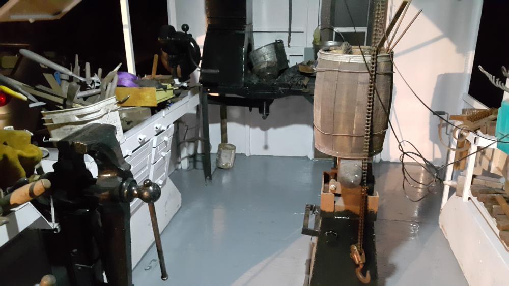

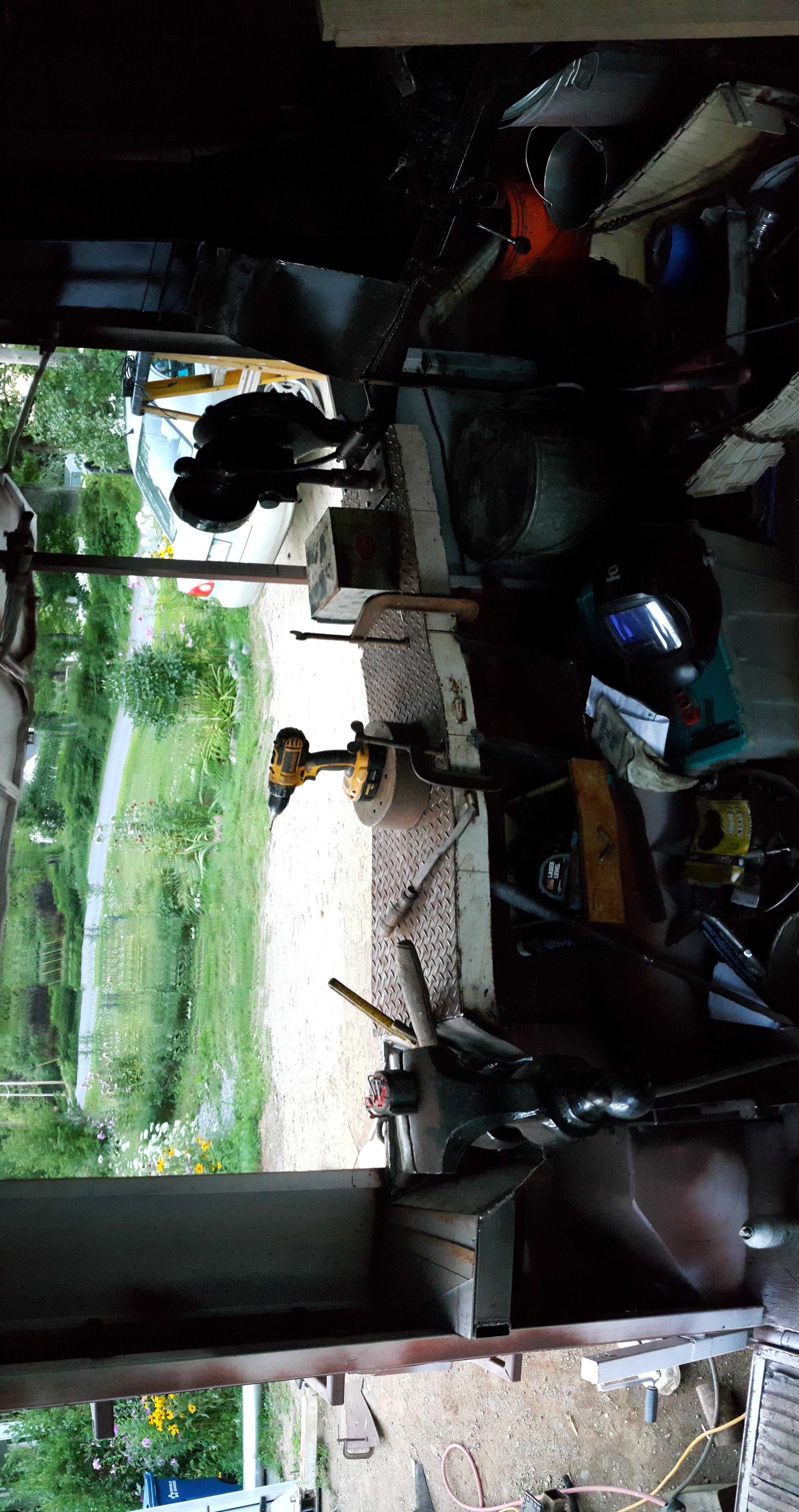

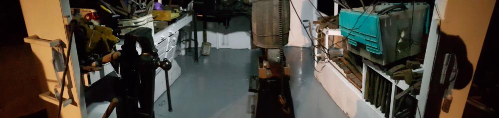

ironwolfforgeca Posted June 26, 2016 Share Posted June 26, 2016 nice set up !! how about a pic of the inside ? to Quote Link to comment Share on other sites More sharing options...
Anachronist58 Posted June 26, 2016 Share Posted June 26, 2016 Keep those pictures coming, and thanks for sharing! Robert Taylor Quote Link to comment Share on other sites More sharing options...

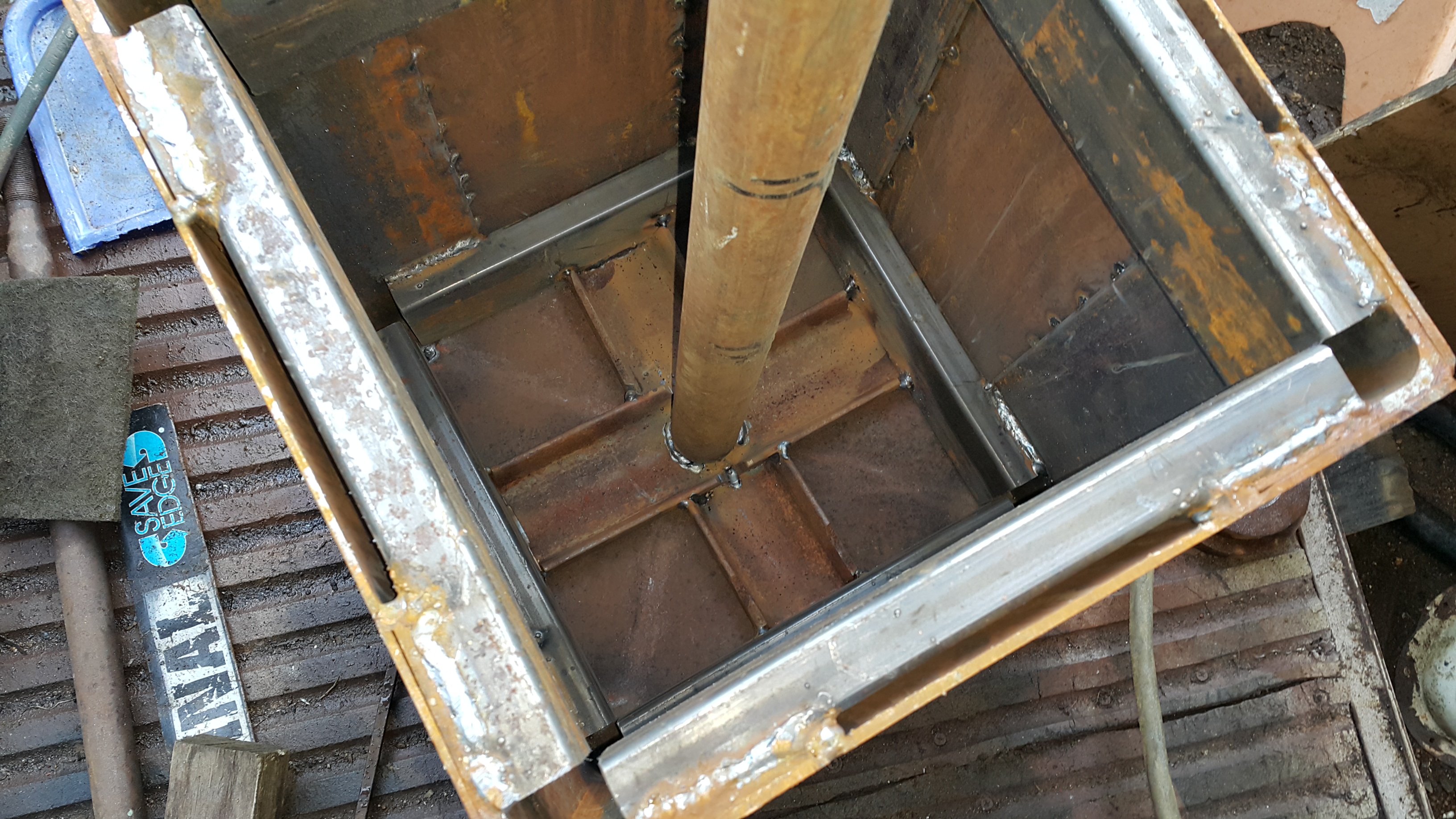

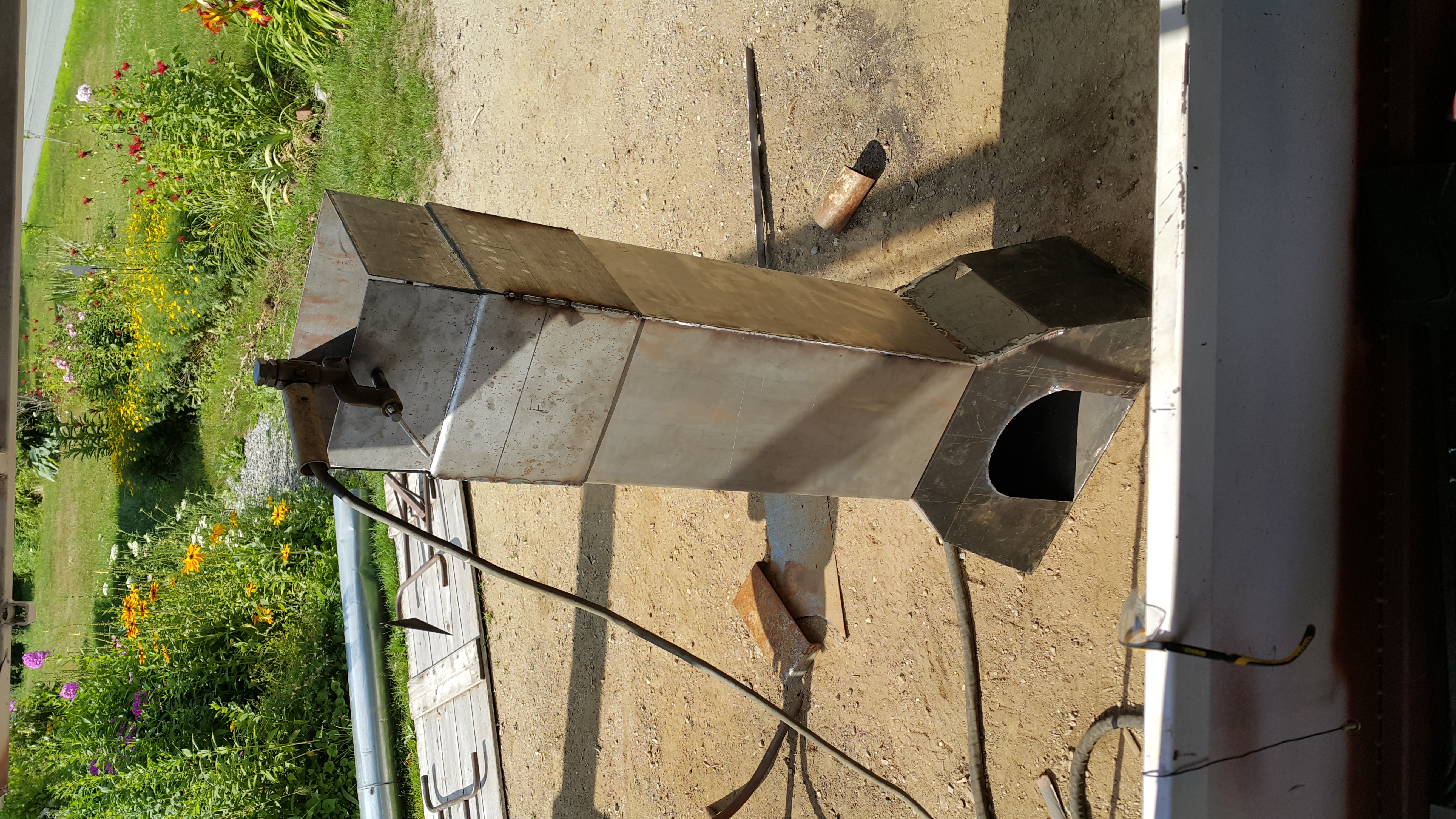

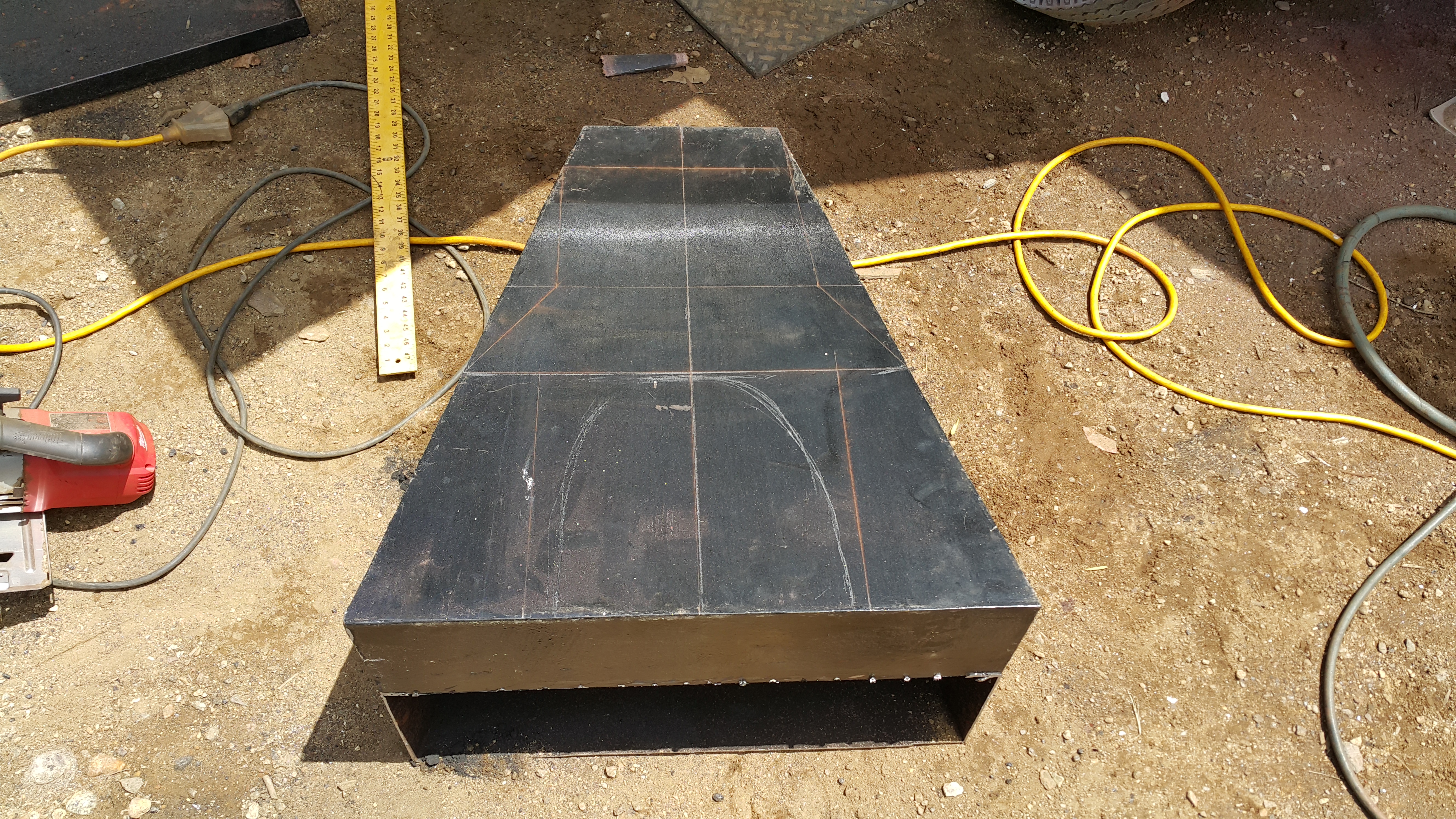

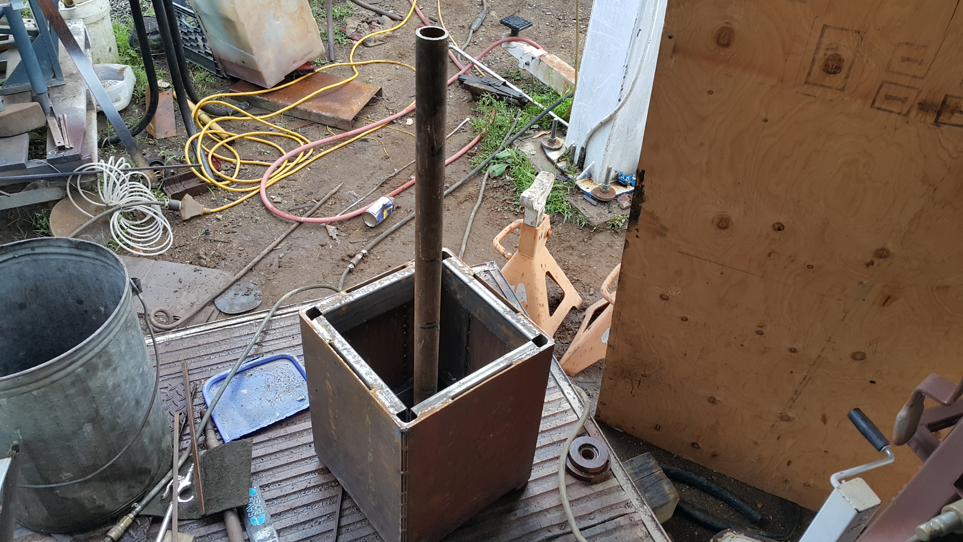

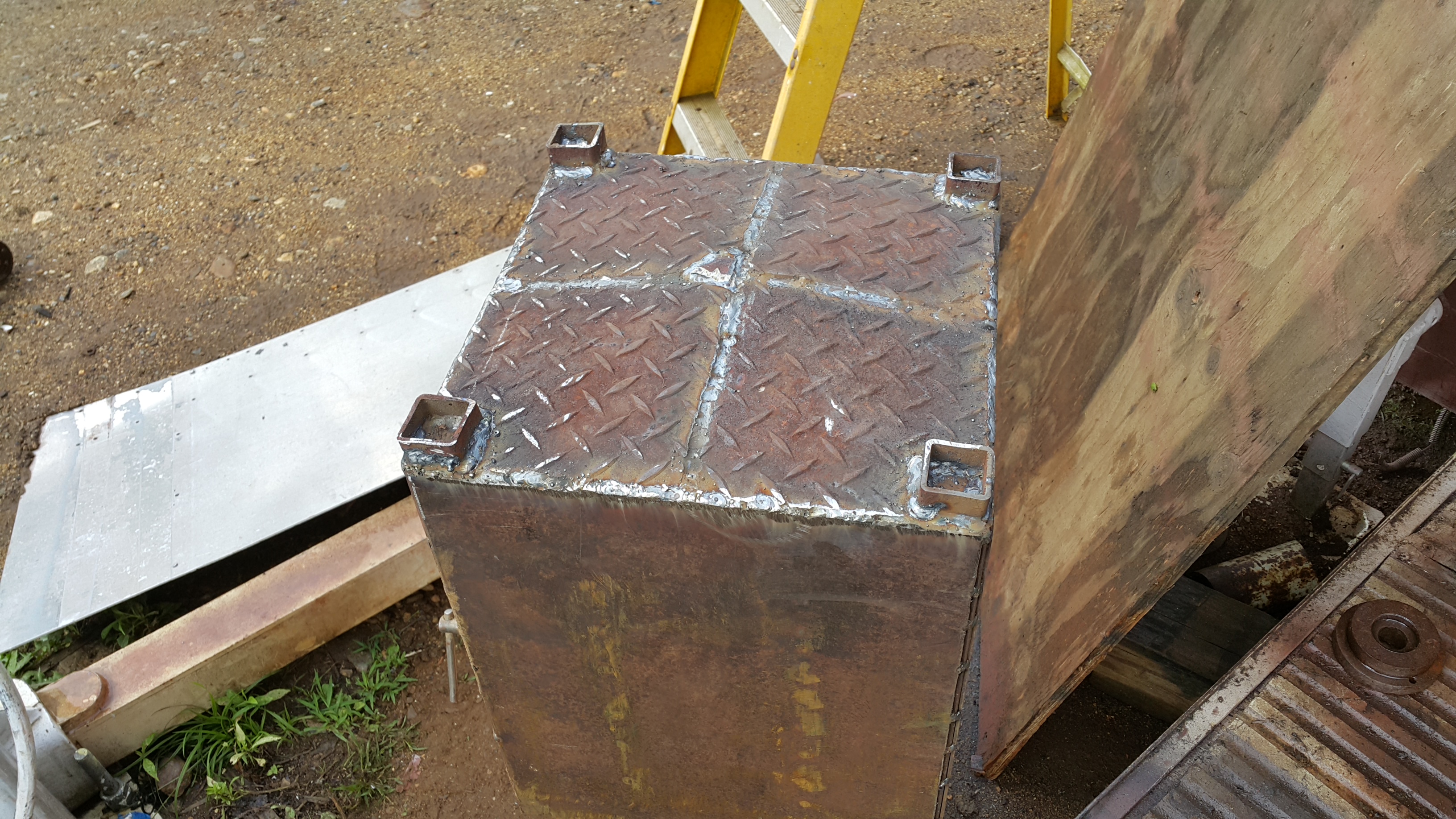

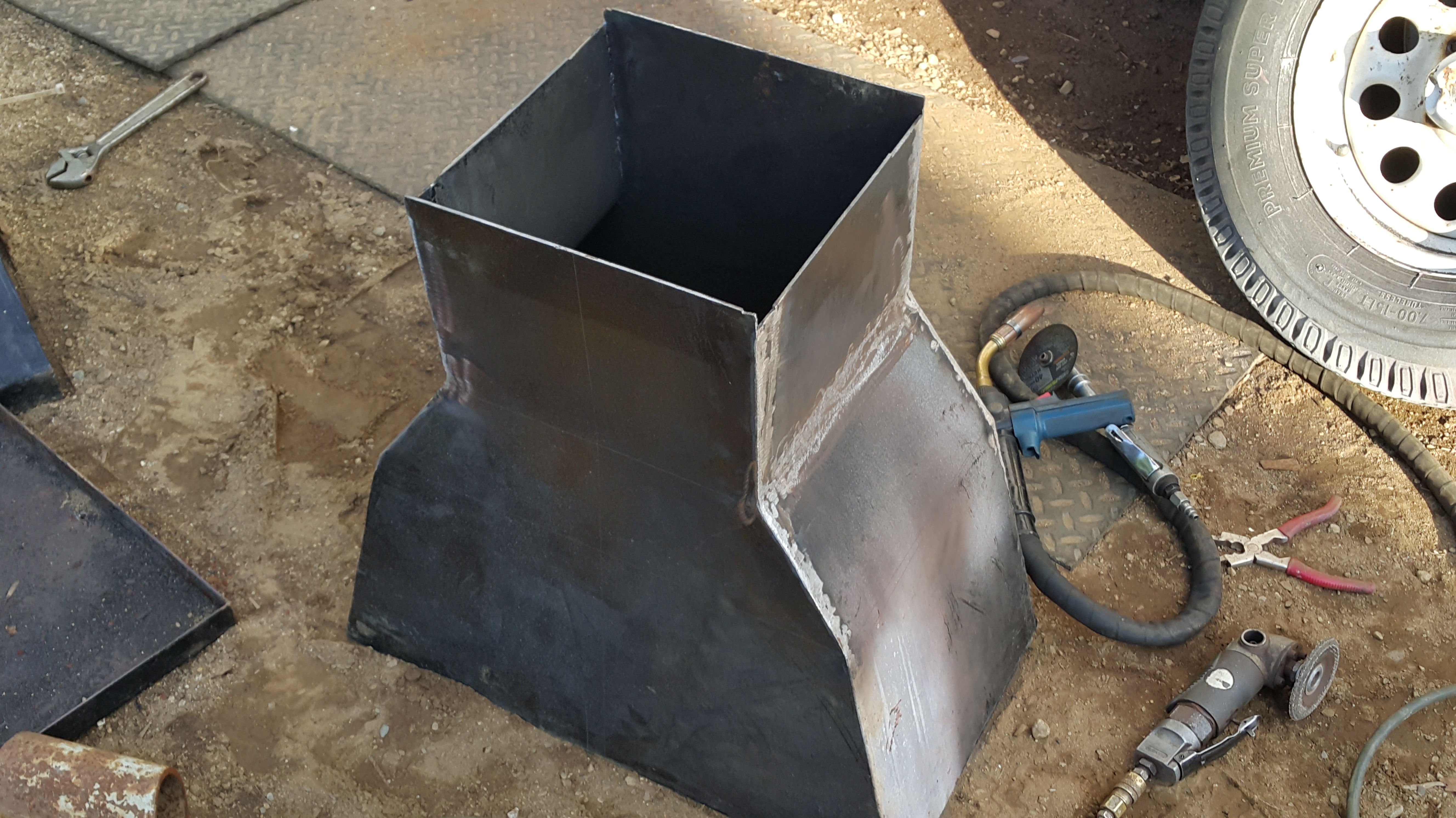

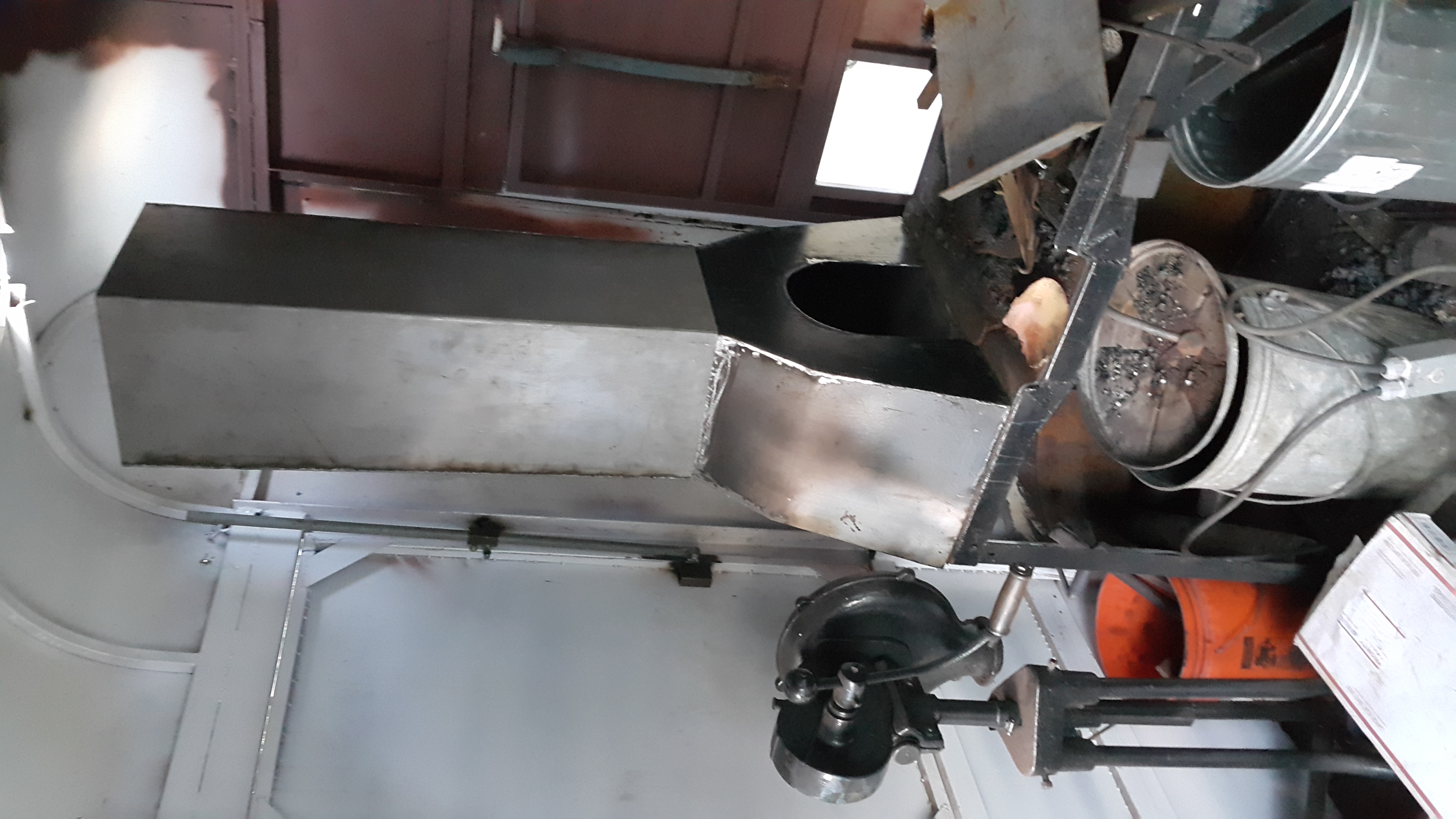

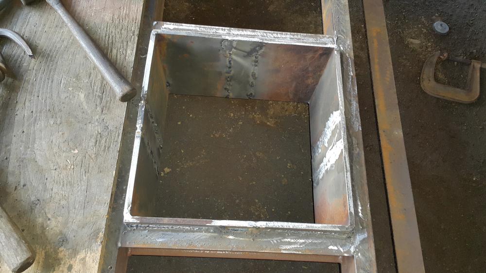

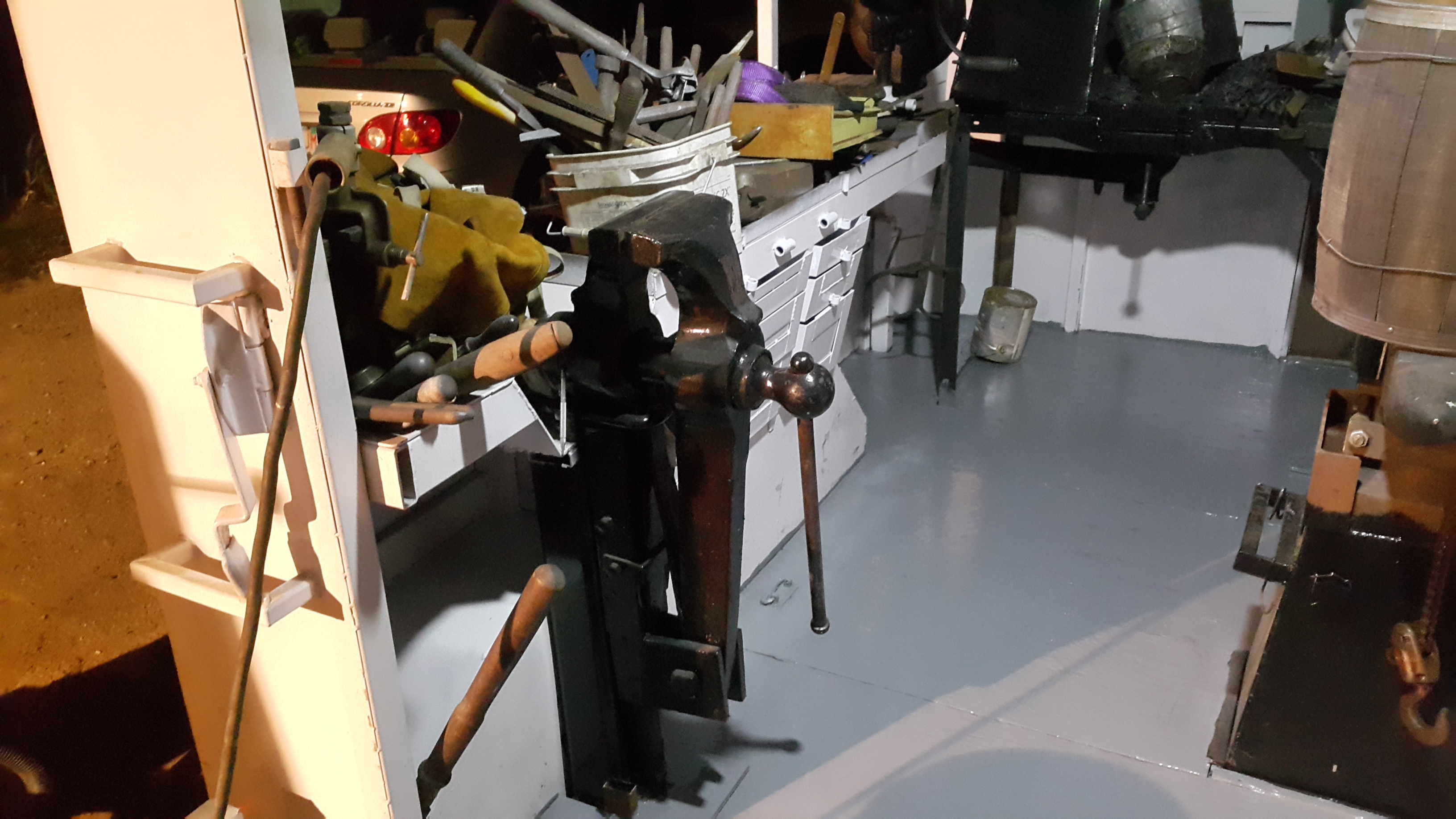

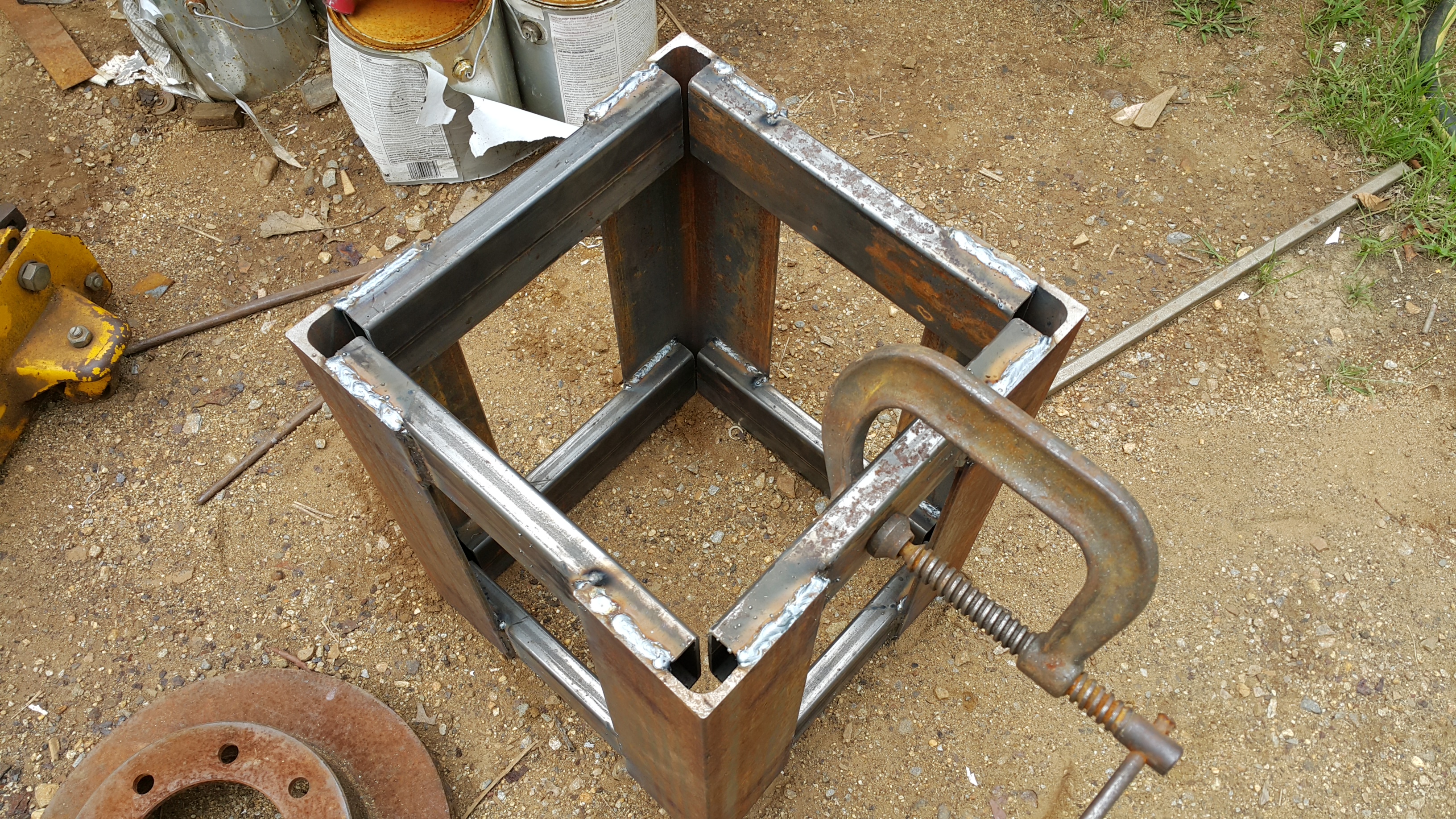

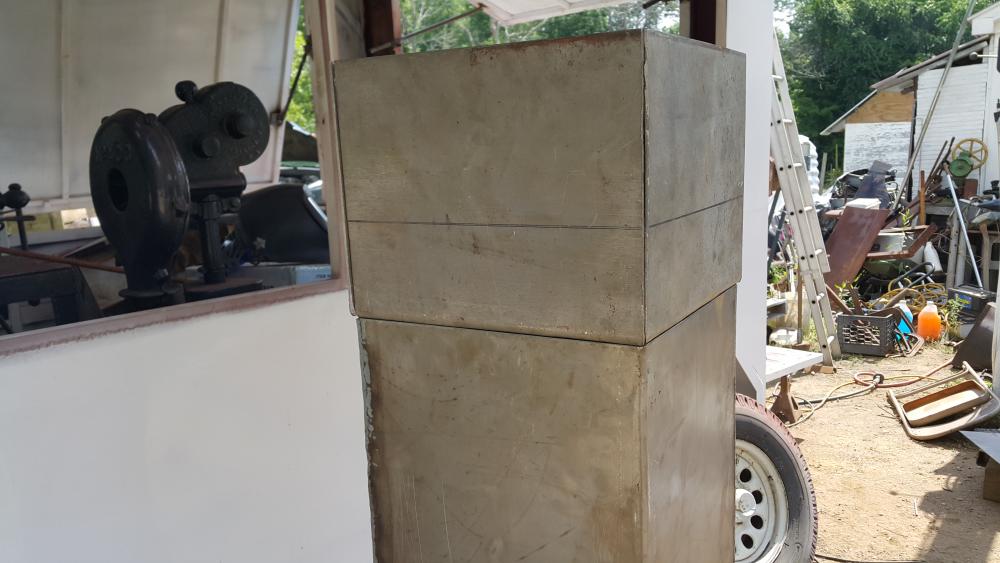

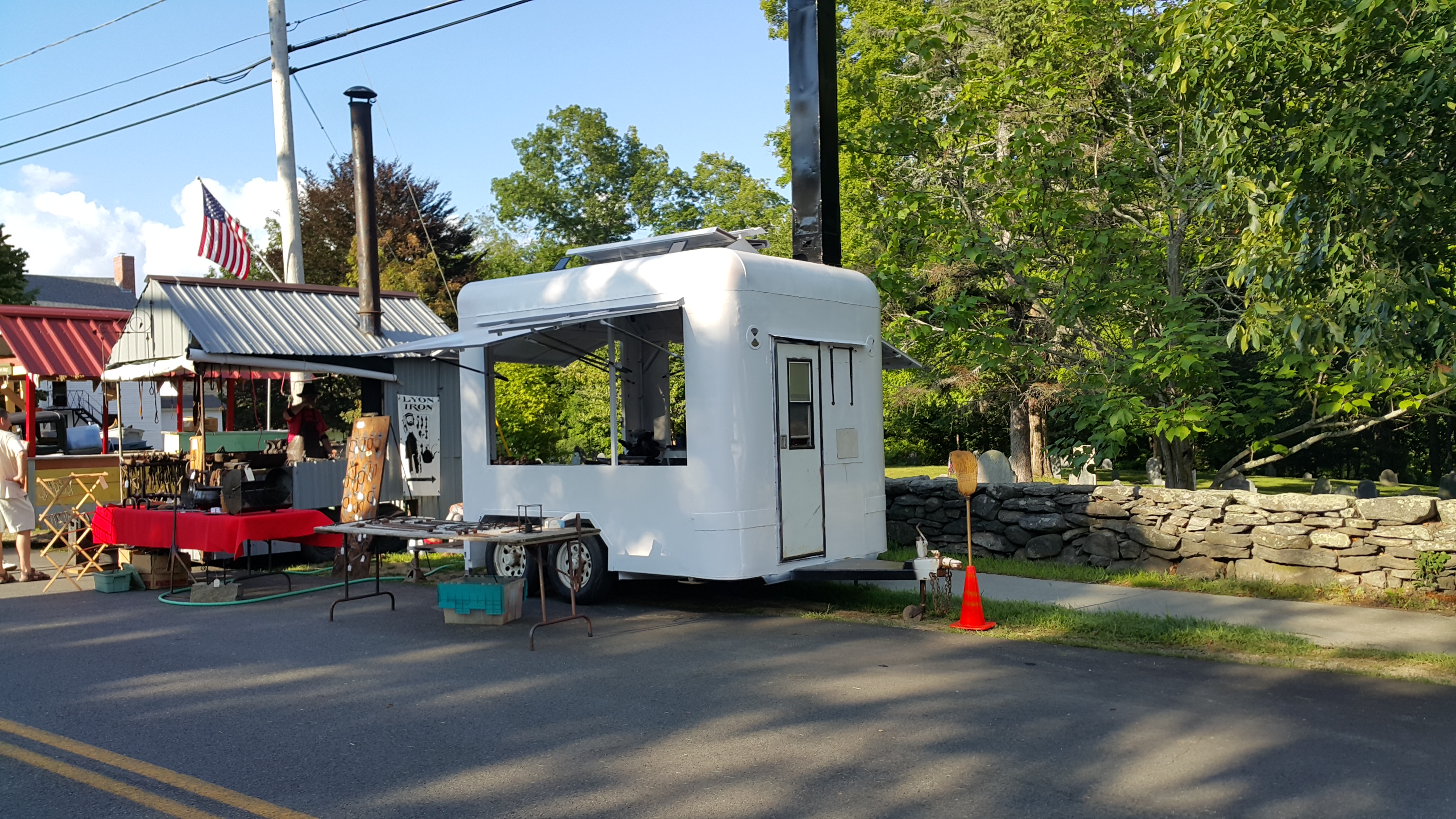

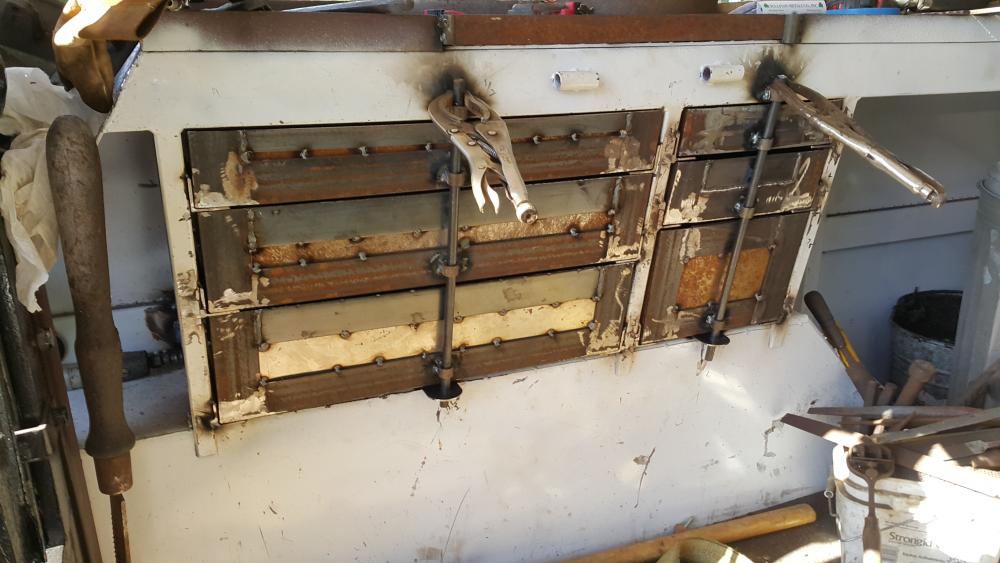

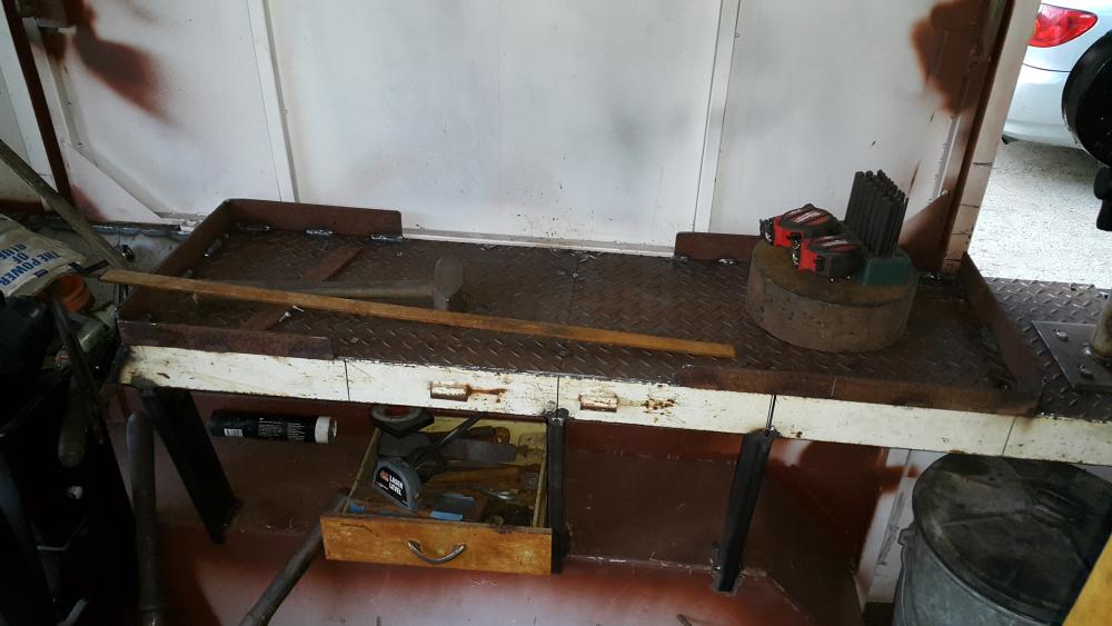

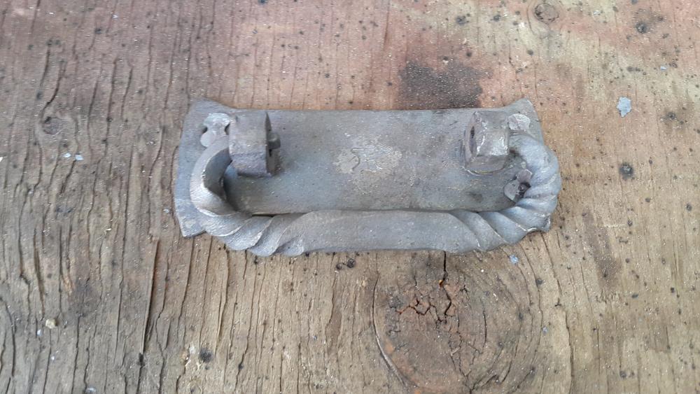

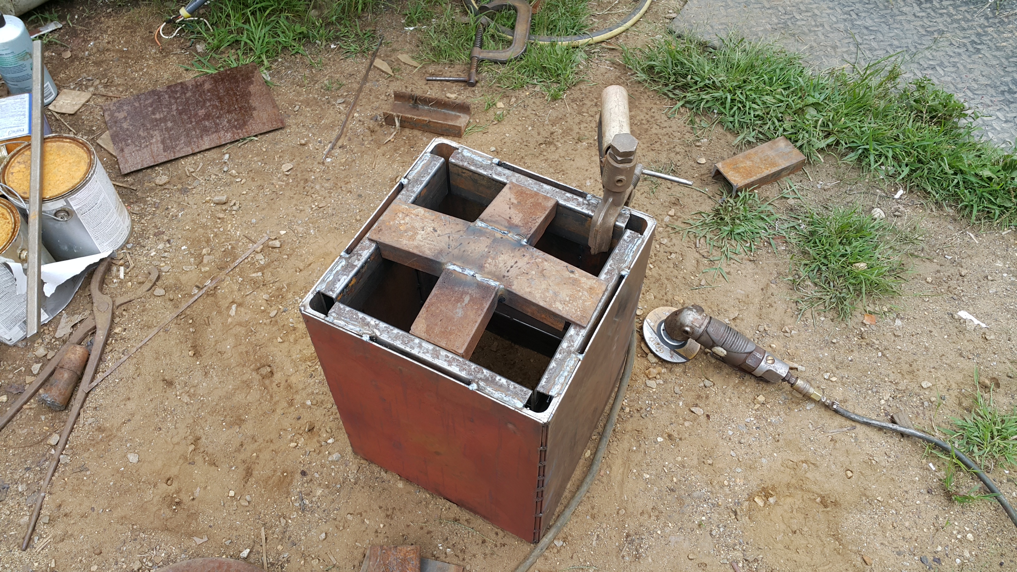

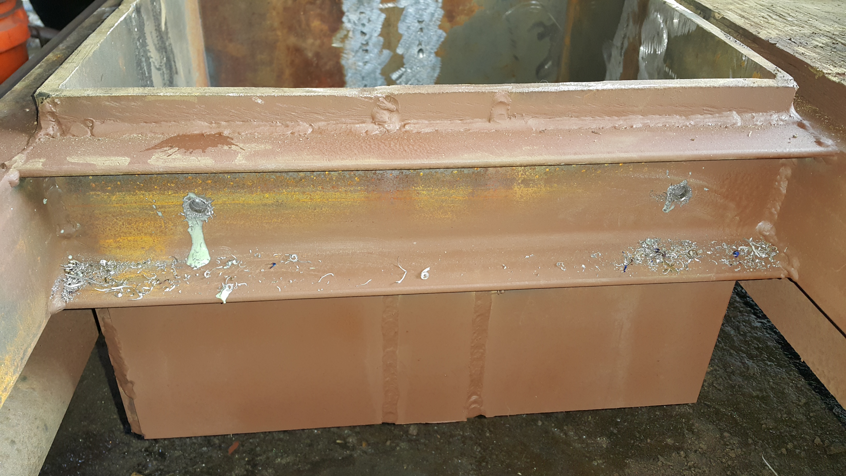

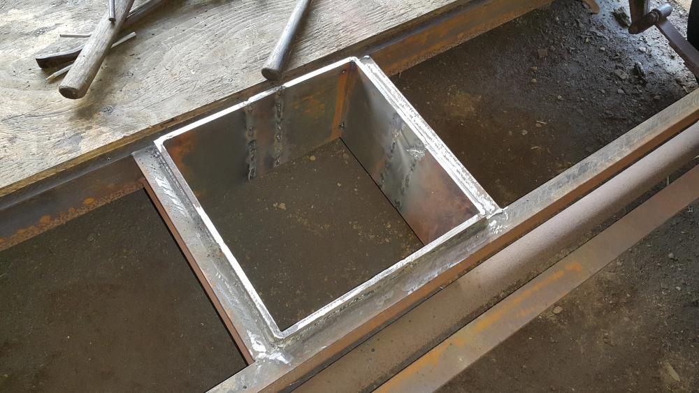

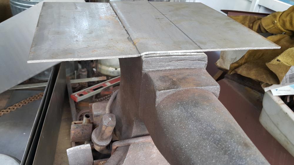

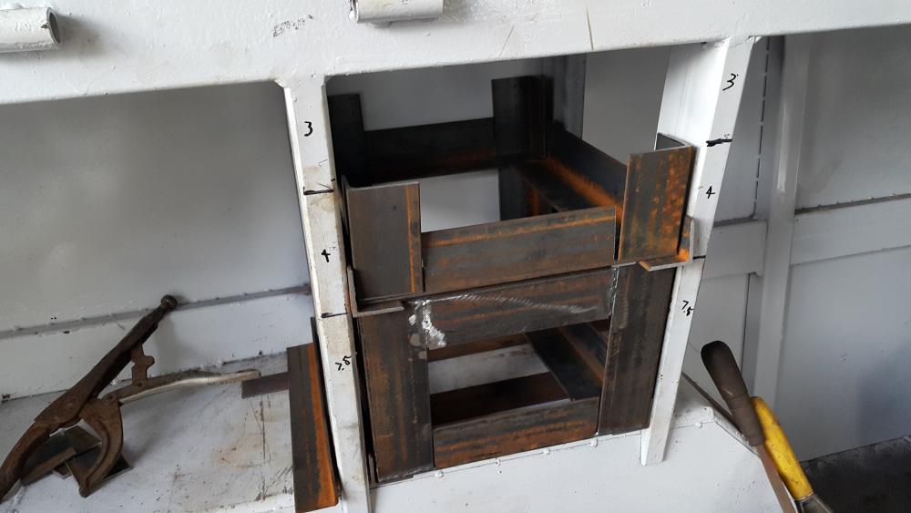

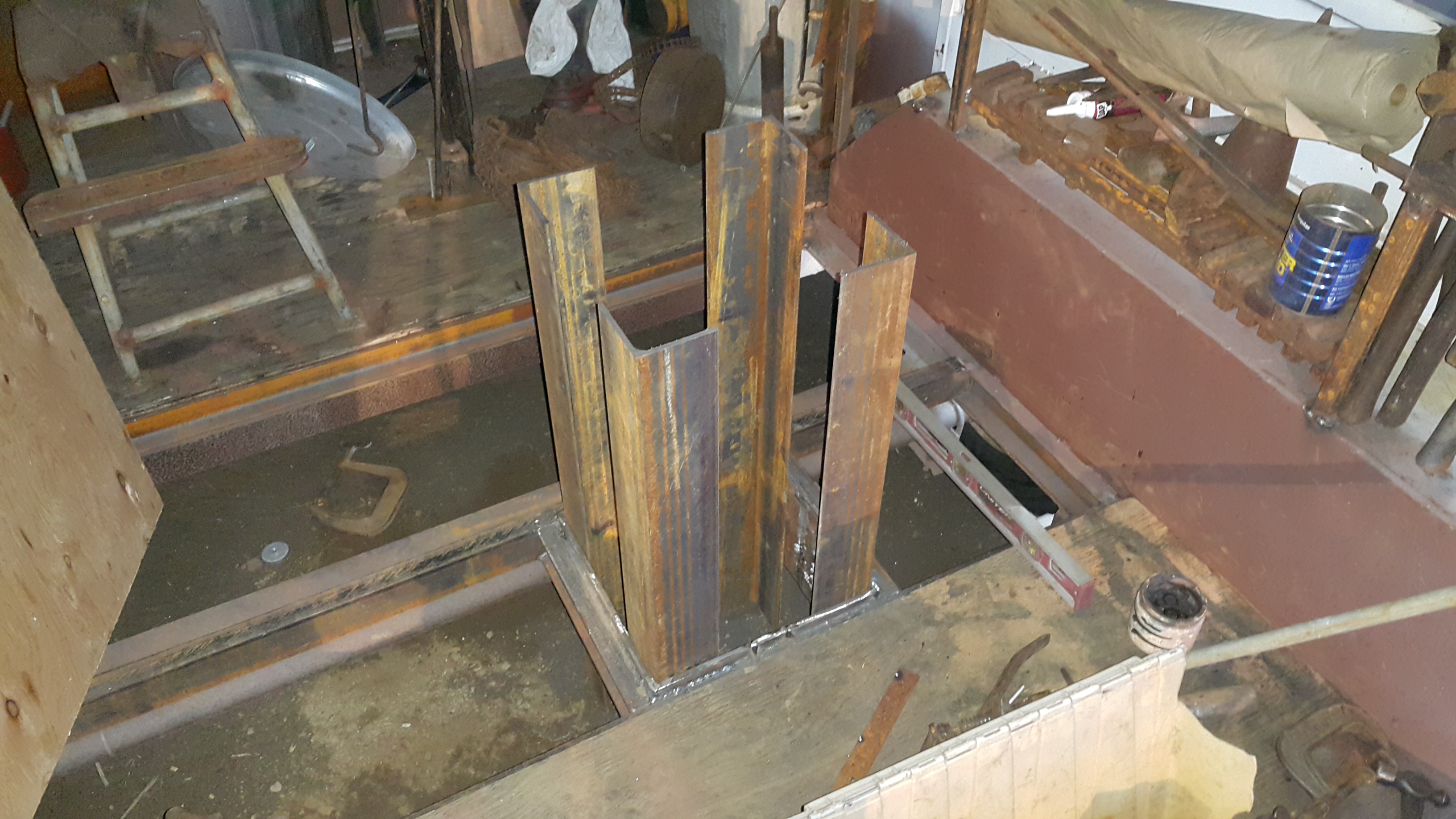

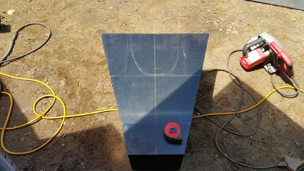

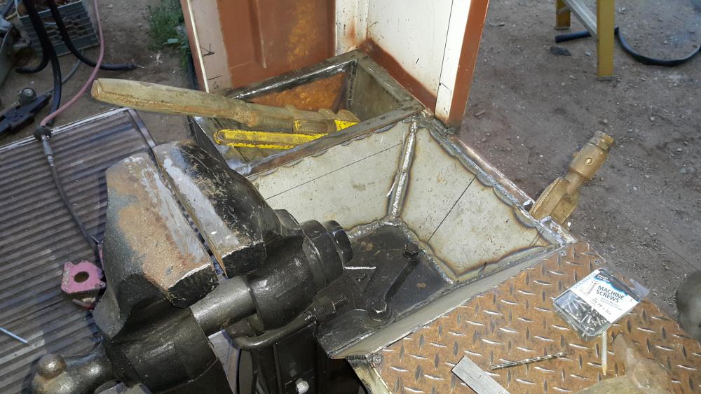

jlpservicesinc Posted September 8, 2016 Author Share Posted September 8, 2016 Sorry I have been lax on getting back to here.. I've been struggling with drawer making for the work bench and it takes 16 pieces of metal to make one drawer not including 2 runners.. Anyhow, I got 2 done as of today and have 4 more to make.. Here are a few teasers till it's completed.. I have engineered, designed, cut and fabricated every piece of this thing.. It took on a life of it's own but is the ultimate demo trailer.. Not sure how many I can add at once but here you go.. The roof vents open. the blower is mounted to the work bench and is height adjustable. The edging for the work bench is removable so I can pass steel out the back side of the trailer instead of towards the audience.. The anvil stand passes through the floor and rests solidly on the ground.. Quote Link to comment Share on other sites More sharing options...

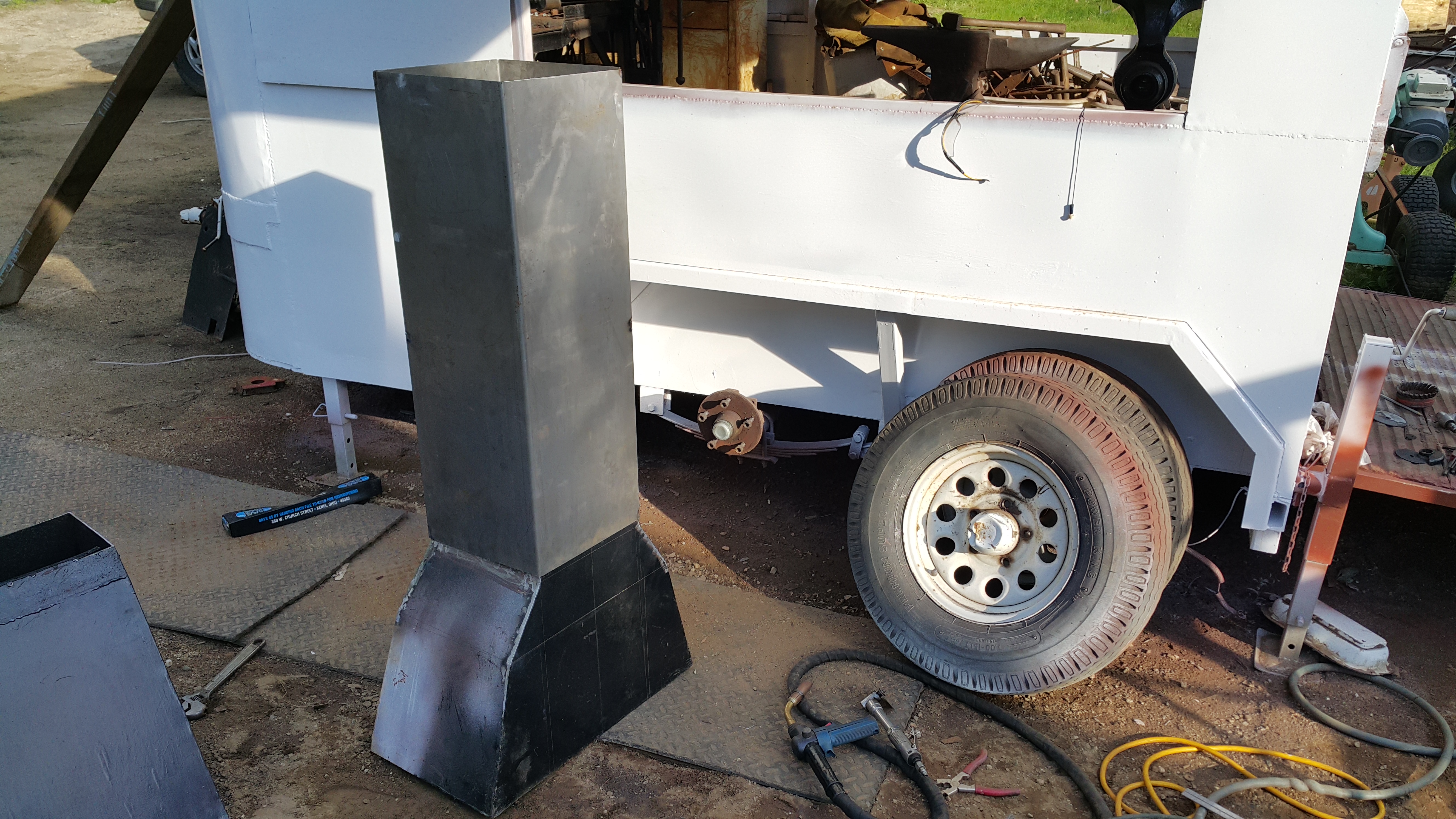

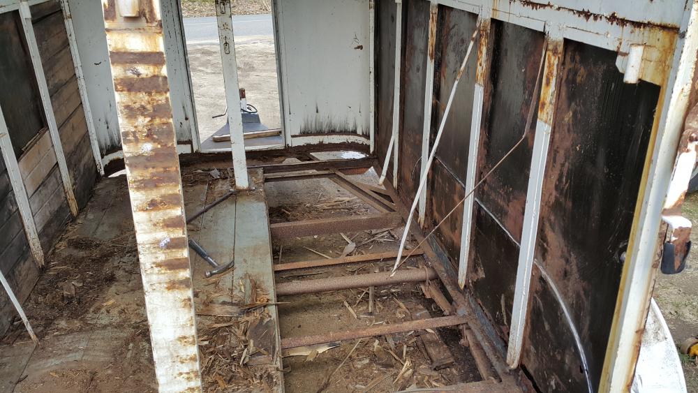

jlpservicesinc Posted September 8, 2016 Author Share Posted September 8, 2016 So here we are getting things moved along.. Funny now looking at it but there is 2.5 months of 10+ hrs a day up to Aug 23 which was a half a day, the day of the fair demo.. 20160818_185451.mp4 the pictures moved out of order.. So they are out of sequence.. But you guys will get the picture.. Quote Link to comment Share on other sites More sharing options...
FlyingXS Posted September 8, 2016 Share Posted September 8, 2016 Wow you have put a lot of thought and effort into this. As a transportable smithy it looks fantastic. For use in demo situations I have a few concerns. Isn't the audiences view limited and obstructed? Yes they can see your working in there but not really see what/how your working? it would be more difficult for the audience to be engaged as there is physical barriers closing you off from them. Being on the ground in front with a simple rope barrier has an appeal and less of a psychological effect than walls even partially open. I mention this as I used to design and build trade show/exhibition stands for a living and may have a different perspective. Quote Link to comment Share on other sites More sharing options...
jlpservicesinc Posted September 8, 2016 Author Share Posted September 8, 2016 57 minutes ago, FlyingXS said: Wow you have put a lot of thought and effort into this. As a transportable smithy it looks fantastic. For use in demo situations I have a few concerns. Isn't the audiences view limited and obstructed? Yes they can see your working in there but not really see what/how your working? it would be more difficult for the audience to be engaged as there is physical barriers closing you off from them. Being on the ground in front with a simple rope barrier has an appeal and less of a psychological effect than walls even partially open. I mention this as I used to design and build trade show/exhibition stands for a living and may have a different perspective. Thanks, Ah, you certainly are in tune with audience flow.. The total idea is to limit people going where they are not supposed to.. When I demo I build or make the same exact stuff I would make in the shop.. If you have ever cut a bar or had a hammer head fly off or any thing at all or a piece of welding flux head into the crowd.. You will see why.. The trailer was actually designed more to be freindly to me as well as the audience.. After doing this for over 30 years you start to understand how and why certain things happen.. One of them is heat exhaustion, another is breathing soot, cinder and dust and smoke when it's 90F+ on the demo days.. The trailer is designed so I can control how the wind approaches the forge and stack and is the reason the stack has a large shape at the bottom.. When I designed it I made the side walls at the spectator side the correct height to catch 90%+ of the weld flux and scale at or around eye ball height for children since the splatter heads out at a descending arc from the anvil face.. As you know the people watching are more likely to be hit with hot slag or flux than the smith is.. Last demo some was watching the smith next door and the smith was doing some welding.. the guy was maybe 10ft from the smith when the smith hit the hot metal the guy jumped back and started rubbing his eye.. YUP..he got slagged.. Could have been very serious.. I don't want people right on top of me.. I actually put the display table about 10ft from the trailer and then put ropes up to keep people back.. So, the design has a lot to do with how to protect the on lookers first and foremost but also how to make me the most comfortable.. As for being able to see.. The only areas I care they see are the immediate work area and this was taken into consideration when designing the doors.. There is a perfect view of the anvil and forge and vise when both doors are open.. If its windy I can close all side doors but the main viewing door and this totally controls the wind and still allows full view of the anvil and big vise if standing in front.. I'll post video of the view into the trailer at some point.. If you look at the first full side picture you can see the top of the anvil, the vises, work bench, blower and forge.. If you are one of those equipment junkies who revels at the equipment than it wouldn't be your gig.. But it makes for conversation as I'm always happy to have someone comer around and inside to look.. Just not while I'm hammering unless they are a striker, helper or in full PPG.. It's pretty amazing.. Quote Link to comment Share on other sites More sharing options...
aessinus Posted September 8, 2016 Share Posted September 8, 2016 On top of a demoing summer, you have been busy. Quite the trailer shop. Your fab skills are to be commended. No I'm not suggesting you are a welder! I applaud your efforts & It looks like you have thought it out well (You will never change a thing, smiths never do). The anvil stand & vise mount are just awesome! Quote Link to comment Share on other sites More sharing options...
jlpservicesinc Posted September 9, 2016 Author Share Posted September 9, 2016 One other thing.. I failed to mention.. This is a public demo rig.. vs a hammer in, or blacksmith meet.. 21 hours ago, aessinus said: On top of a demoing summer, you have been busy. Quite the trailer shop. Your fab skills are to be commended. No I'm not suggesting you are a welder! I applaud your efforts & It looks like you have thought it out well (You will never change a thing, smiths never do). The anvil stand & vise mount are just awesome! Yes, thanks.. It's been crazy busy.. This trailer has eaten the summer up in full fashion.. I haven't been swimming once this summer.. I started the trailer back in early May, 5/14 to be exact. Been so long now it's all blended together.. Today I made great progress on the drawers and got the finial coat of paint on the roof.. At least I hope it's the finial coat.. Sadly I wasn't able to do it earlier in the day as it was still wet and humid.. So I waited to this afternoon.. Now we are supposed to get rain tonight and the paint was still tacky I hr ago.. Thanks.. It has been one of those projects where I was going to just do this and it morphed into what you have seen.. I figured it would be a down and dirty trailer build and it took on a life of its own.. Quote Link to comment Share on other sites More sharing options...
Frosty Posted September 10, 2016 Share Posted September 10, 2016 I'm glad you don't over think things like some of the guys here. Darlin. I don't do many demos, certainly not enough to justify building a trailer special for the purpose. I think the only thing you've forgotten are bleachers. No joke an elevated spot for kids to see what's going on from a safe distance and a place for their parents to take a break might be a real plus. I rarely weld at demos and if I do I turn around so I'm between any flux spray and spectators. It's been a long time since I used enough flux to make a properly showy spray, I hardly get a pop now. Non the less I don't take the chance. I find the audience likes twists, they can see directly how heat softens the steel and the transformation in real time and slowly enough to grasp it entirely. Folk seem to like seeing just a plain old simple twist more than a pineapple, cable, cube twist or other fancy twists. No I'm not signing off without saying just what one FINE demo trailer I think that is. Your years of experience, thought, planning and a summer's worth of work show in every detail. I do think you should paint the stack like brick or stone masonry though for the cool factor. Thanks for sharing, I'd be setting it in parking lots up just to show off. Frosty The Lucky. Quote Link to comment Share on other sites More sharing options...

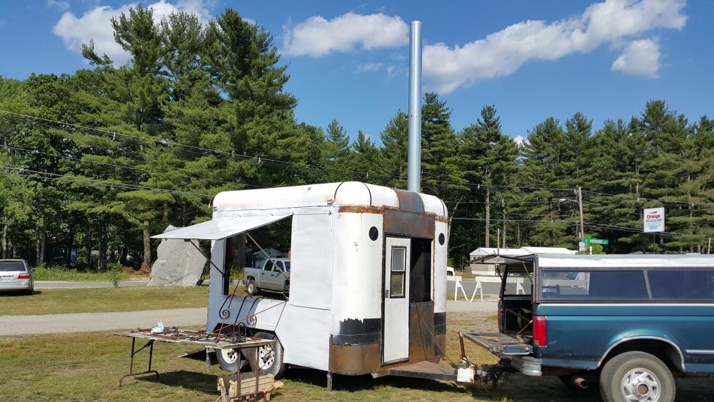

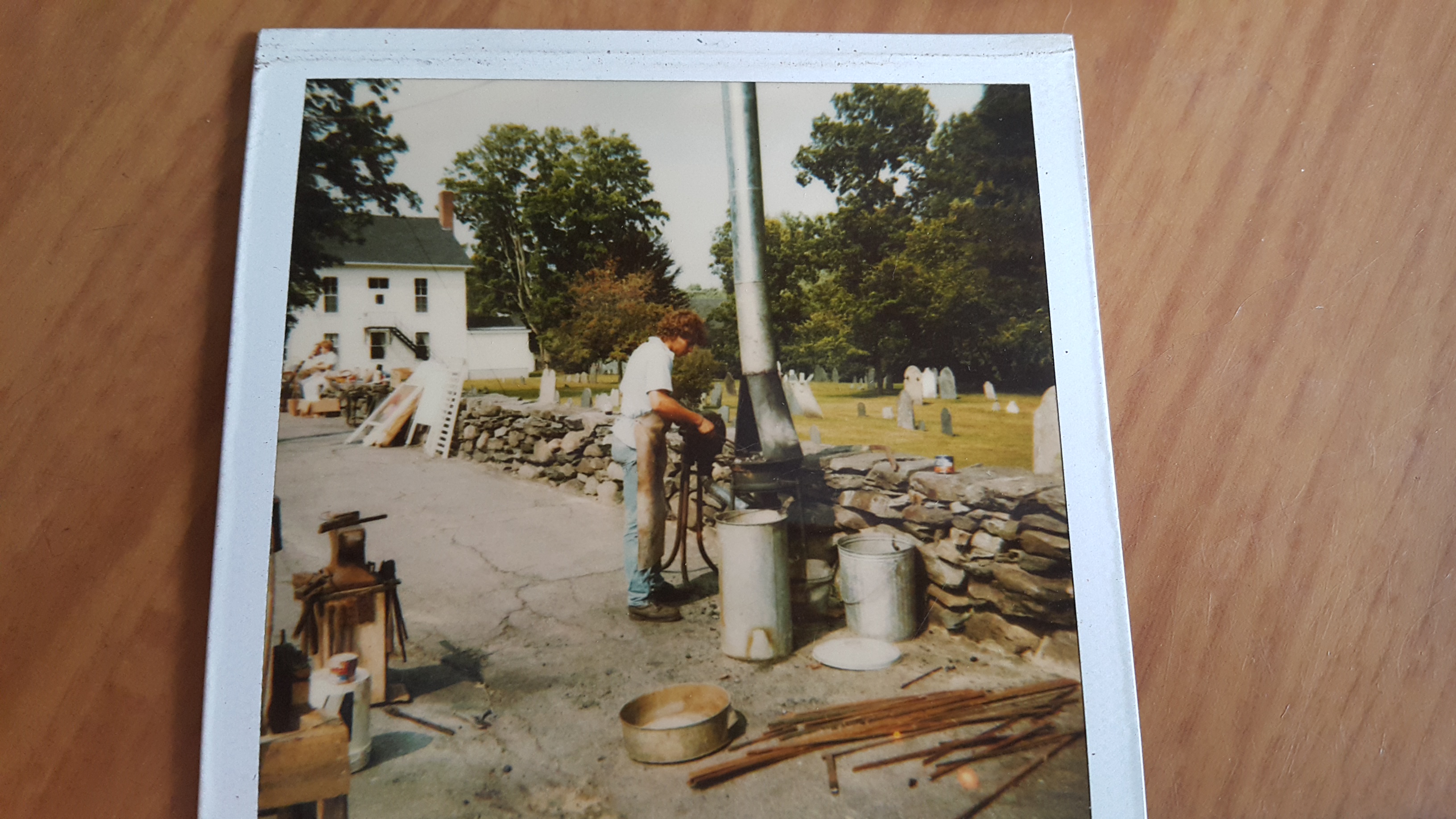

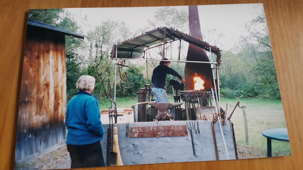

jlpservicesinc Posted September 11, 2016 Author Share Posted September 11, 2016 Here is the progression of demos and trailers.. the first pic is 89(the sun was a major problem) next 92 with a roof that did little good except at noon time, then 95 first trailer this one as designed only lasted about a year, and I then put metal on the roof and this lasted another 2 years, then 2nd trailer (3rd edition) in 2000 which I made longer one and reinforced the frame even more I basically tried to use stuff from the previous version especially the roof so the roof doesn't cover the front of the trailer.. If funny looking back now As I had made that forge and hood way back in 93 and I thought I made it about 12-13 years ago I did a complete rehab of the last trailer 9/25/14 because my feet were falling through the floor and i started doing demos again.. It sat idle about 7 years except for occasional use. And last few were of the last demo I did.. Quote Link to comment Share on other sites More sharing options...

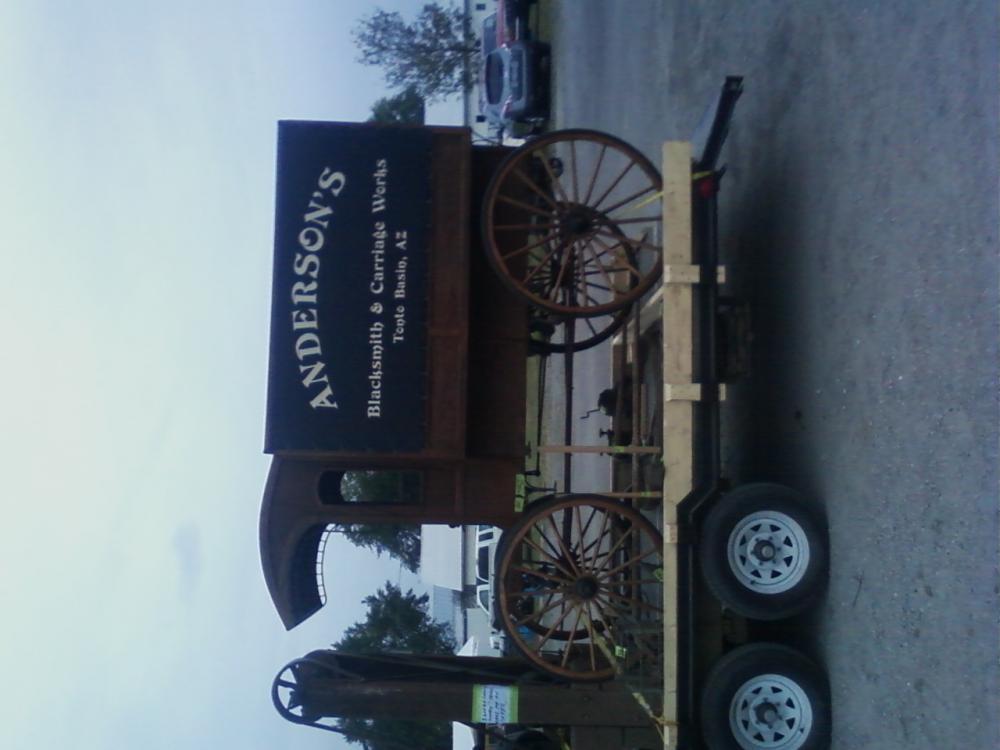

WayneCoeArtistBlacksmith Posted September 12, 2016 Share Posted September 12, 2016 I saw this one at Quad State a couple of years ago. It was really nice right down to the stained glass windows. Sorry, I don't know why this picture is rotated. It is not on my Pictures folder. I also don't know why the type is like this. Quote Link to comment Share on other sites More sharing options...
jlpservicesinc Posted September 12, 2016 Author Share Posted September 12, 2016 1 hour ago, WayneCoeArtistBlacksmith.c said: I saw this one at Quad State a couple of years ago. It was really nice right down to the stained glass windows. Sorry, I don't know why this picture is rotated. It is not on my Pictures folder. I also don't know why the type is like this. I love the carriage but is there any equipment inside or just for advertisement? Quote Link to comment Share on other sites More sharing options...

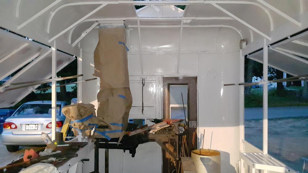

jlpservicesinc Posted September 18, 2016 Author Share Posted September 18, 2016 So today was banner.. The trailer is just about completed.. just a few small things left to round it out.. Quote Link to comment Share on other sites More sharing options...
matto Posted September 18, 2016 Share Posted September 18, 2016 Really is coming together nicely and we are all jealous of you!!! Quote Link to comment Share on other sites More sharing options...
