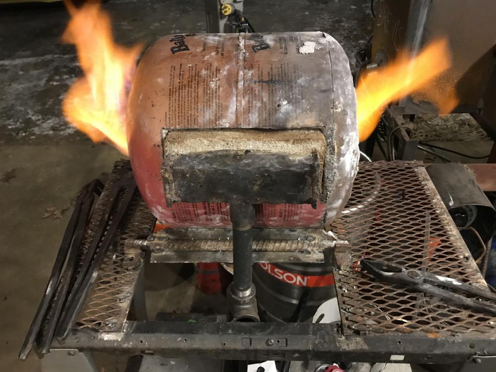

Finally got my forge set up last night for a curing test burn. Note that the T-burner runs vertically down, so the intake is as far from the exhaust as possible.

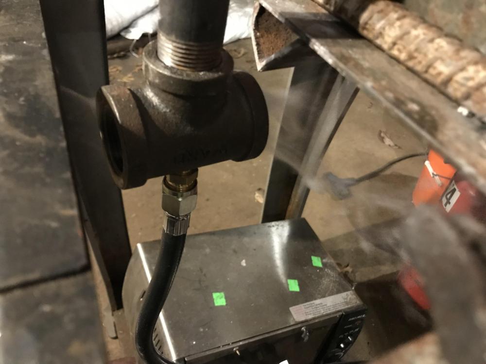

I’ve been getting white smoke coming out of the T after I shut the burner down. I suspect there’s still some bits of crayon inside the plenum that will eventually burn out.
And here’s the face of the burner, running about 2 psi. Ended up going up to about 5, but didn’t want to get too hot before the forge’s refractory was properly cured.
Looks really good. That's an ideal way to mount the T inducer, no need to mess with all the fittings to protect the rubber hose.
Is that really smoke or steam? I expect steam and crayon residue smoking makes sense, mine did some interesting little things the first couple firing I wouldn't worry.
Flames look good too.
I like it John, can't wait to see it at melt the distracted smith's project temps. :huh:
Here are the flames at ~15psi. There was much less of the smoke/vapor around the burner, and none when I shut the burner off.
These flames do not indicate anything wrong with the burner; they indicate that the burner is simply being run on way too high a gas [ressure. If you want to run the these burners hard try 4 PSI.
Interesting. I shall keep that in mind next time.

I've given this orientation a lot of thought Lou and all you really need do is put longer legs on the forge and an elbow between the hose and the burner fitting so the hose can lay flat. It'll still be a few inches below the forge body and clear of heat.

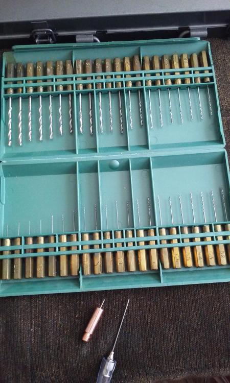

Burner with rich flame that wont stick no matter placement of jet had 40 holes a 1/2" unrefined intake and 4" long mix tube with a .025 mig tip. Aside from increasing the intake slot width and smoothing the flow path I have also decided to reduce the orifice to .020 with a dispensing needle interference fitted into another .025 mig tip (I plan on tapering) and cleaned up with tiny drills as well as increasing the outlets to 72. I remember reading Mikey's post about smaller orifices making hotter burners but this is the recommended size for a 3/8". Would it be too much of a drop? At work now, cant do anymore experimenting so I am asking and reading. I know this is kinda starting from scratch since I've changed so many variables.

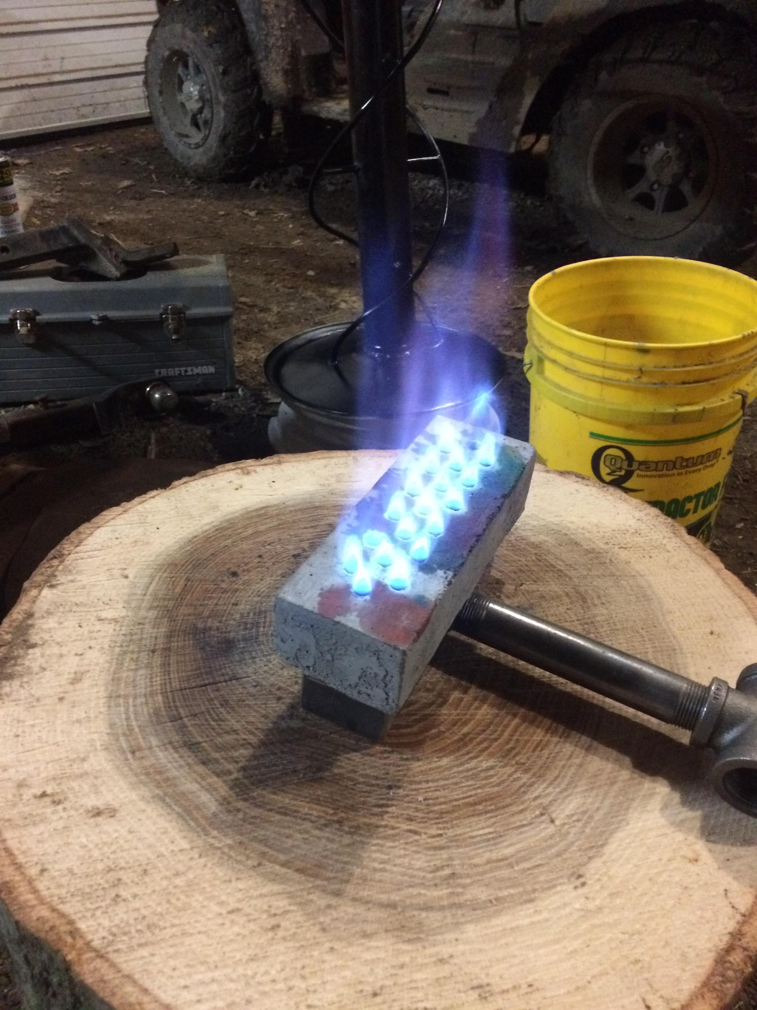

Also an experimental multi outlet with the bottom of a water bottle for a mold. The bottom of the bottle has interesting grooves and shapes (different brands have different shapes) that could possibly influence the flame. I have fitted it with 15 coffee stirrers and 1 larger soda straw in the center. the plenum is a 2" x 1" reducer.

I've got to say the second pic looks like the gnarliest brand party soda I've ever seen!:unsure: Party because of all the people who must be drinking from the bottle.

I'm not sure what you're asking in the first part. If you're wondering about attaching a NA inducer to a plenum and multi outlet burner block then I don't see why not. You will have to balance the inducer to the burner block of course. Getting the right # of outlets was the most important part and I went through a number of test blocks till I got one that worked.
I think you're doing of a lot of work with higher a risk than I like.
I think I'd dig out a hole saw I could hose clamp a can that diameter to and drill stir stick sized holes in the board. Fast easy and cheap. Yes? The test blocks don't have to last more than a few seconds to tell if they're close enough to work. If you need more time then soak the wood burner block is a saturated solution of borax in water and the block will take a little more time to start burning.

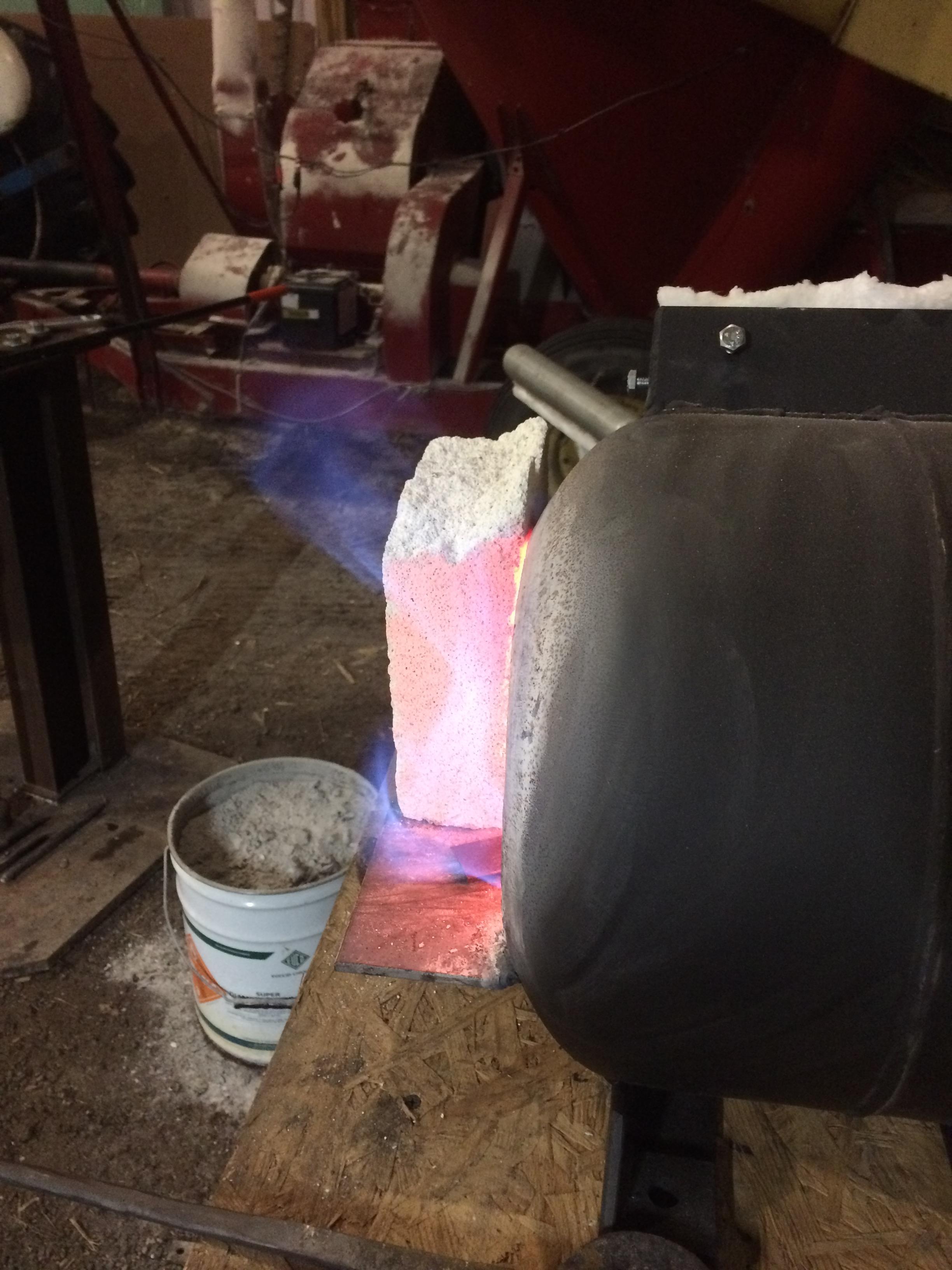

So, seeing JHCC’s pictures makes me think mine is running a little rich. The dragons breath out of mine is much different. The top 2 picture were at 2-4psi which is were unusual run  the third one was closer to 15 psi. I’ve played with my jet length a little with minimal change. I’m wondering if my mix tube or a touch too short since I didn’t use the thread protected and just welded the pipe stub to the burner. The last two are the burner outside the forge at first light up, and the forge without the front fire brick.

Yes, it looks a little rich to me too. How far have you trimmed the mig tip back? Try sneaking up on  the right length with a fine file or sand paper and don't forget to clean the burr with torch tip files. You're close now, don't get crazy and use a saw or something. She wants to be kissed and sweet talked into behaving.
Well, from what I remember just a touch over an 1/8." Since I threaded the MIG tip into an 1/8" pipe nipple I was able to back it out a little to increase the air gap and didn't notice much difference. When I get a chance to get back out in that shop I plan on trying a shorter tip.
