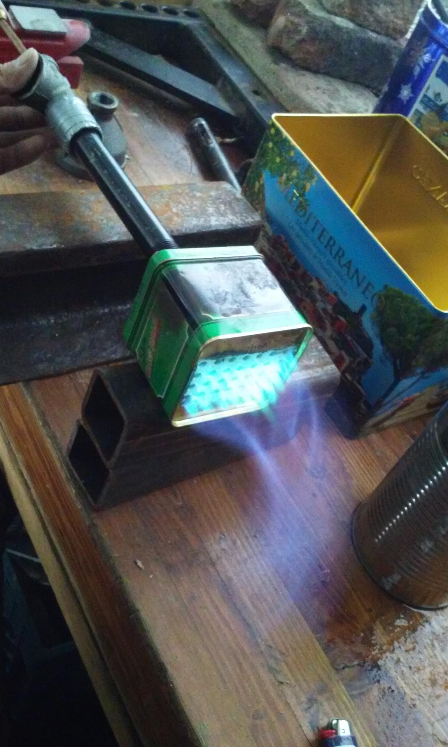

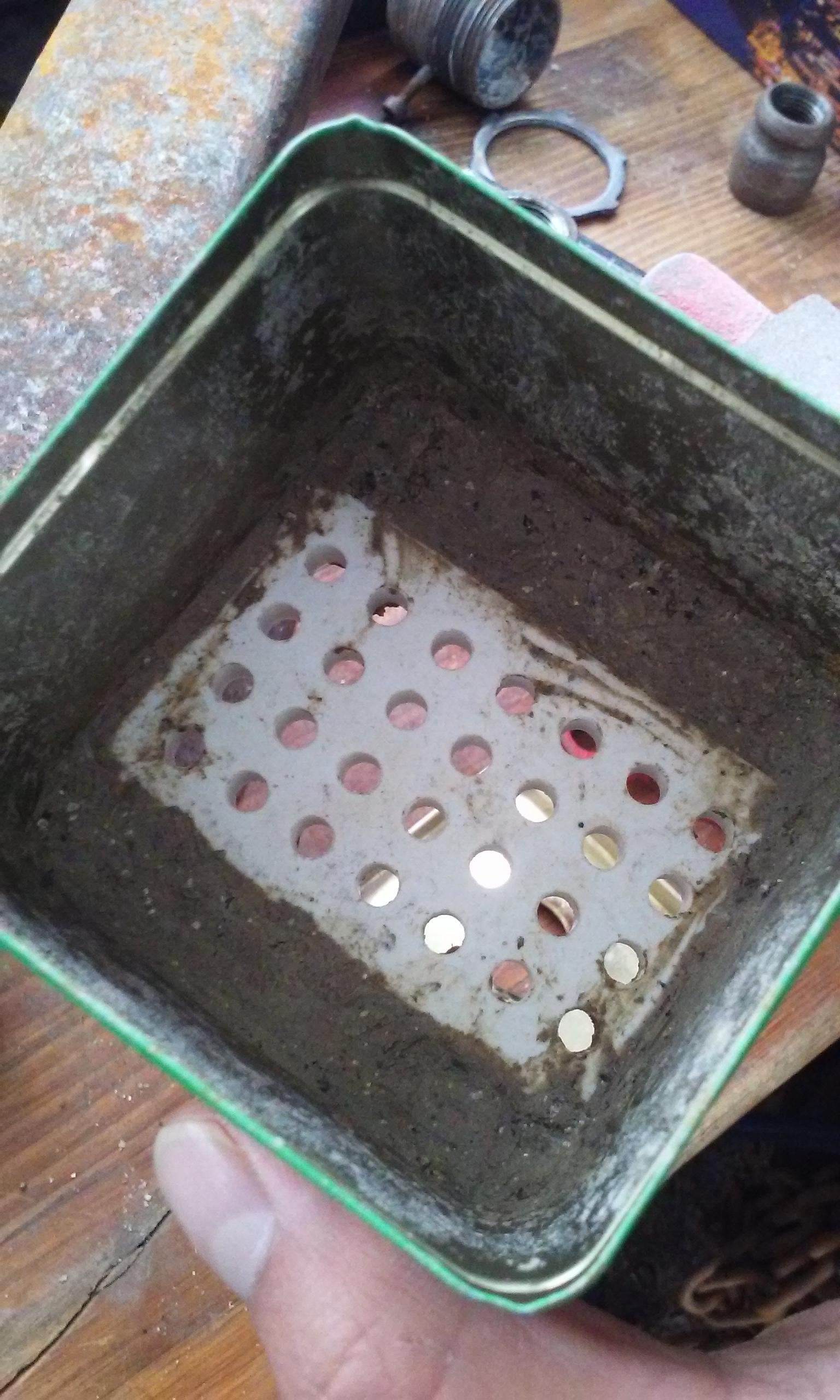

I have been out sick, I will recreate the burner and get some pics. i still have the parts. I had to cut one row of 4 off in order to fit in the bag balm plenum.
Any thoughts on a castable like Kasto 30 sticking to this ceramic? expansion issues?
On first glance looks like they are cast from some kind of high alumina ceramic.  Differential thermal expansion might be something you will have to contend with.  They sure look like they would work well for a burner face.  Will take some creativity to get a good seal while still allowing for thermal expansion.  Dudley uses a similar material, but his joint is much further away from the burner face.
Kastolite might work, it sticks to everything. Don't know how it works as cement though. Might need to sift the aggregate out first.

how could it be clamped? An easy plenum would be nice. The thin walls would probably need to stay away from the heat and the head would have to extend into the forge. the plates are too thin too extend inward unless 2 or 3 three are somehow fused maybe?

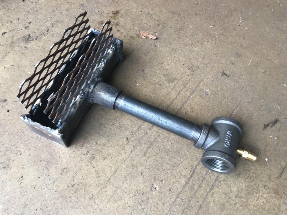

My own ribbon burner has some metal mesh welded to the plenum and extending into the block, but that's a different kind of thing.
(This was as-welded; I ended up trimming it back before casting the block.)
I've had good luck by casting the plenum into the block as John shows above.
I've been thinking about the plates and think the easy way to connect them to the plenum is cast them in the same manner. A short piece of expanded metal welded to the plenum extending down the side of the plates far enough for a good bond and cast or ram in Kastolite or equivalent.
While thinking about that last night it occurred to me stacking those plates would make excellent heat isolation. HOW you ask? Buy or make wax cores maybe a touch larger than the existing holes in the plates. Maybe roll balls between your palms, more later. Then you sift the aggregate out of Kastolite, we only want the high temp binder here. Mix it with zircopax at. 80% Z to 20% K. Here's the tricky part I haven't worked out to my liking, I'm basically lazy and this'd be a lot of fiddly work. With the wax cores stuck into the holes in a plate, carefully fill the space with the KZ mix. Press the next plate on and repeat till you have a 3 plate block. Immediately cast the plenum to the stacked block so the KZ and Kastolite bond well.

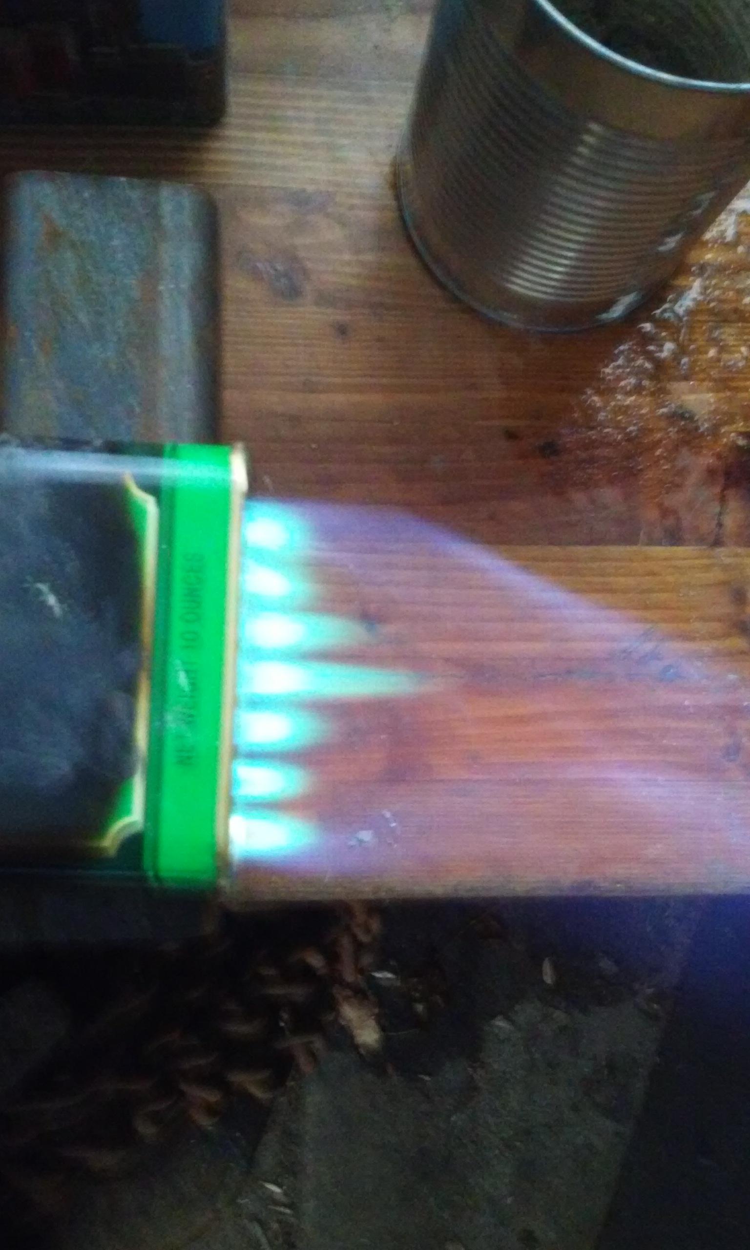

As lean as I could get it till it back fires. 5 psi. Ever seen a burner with duct tape?

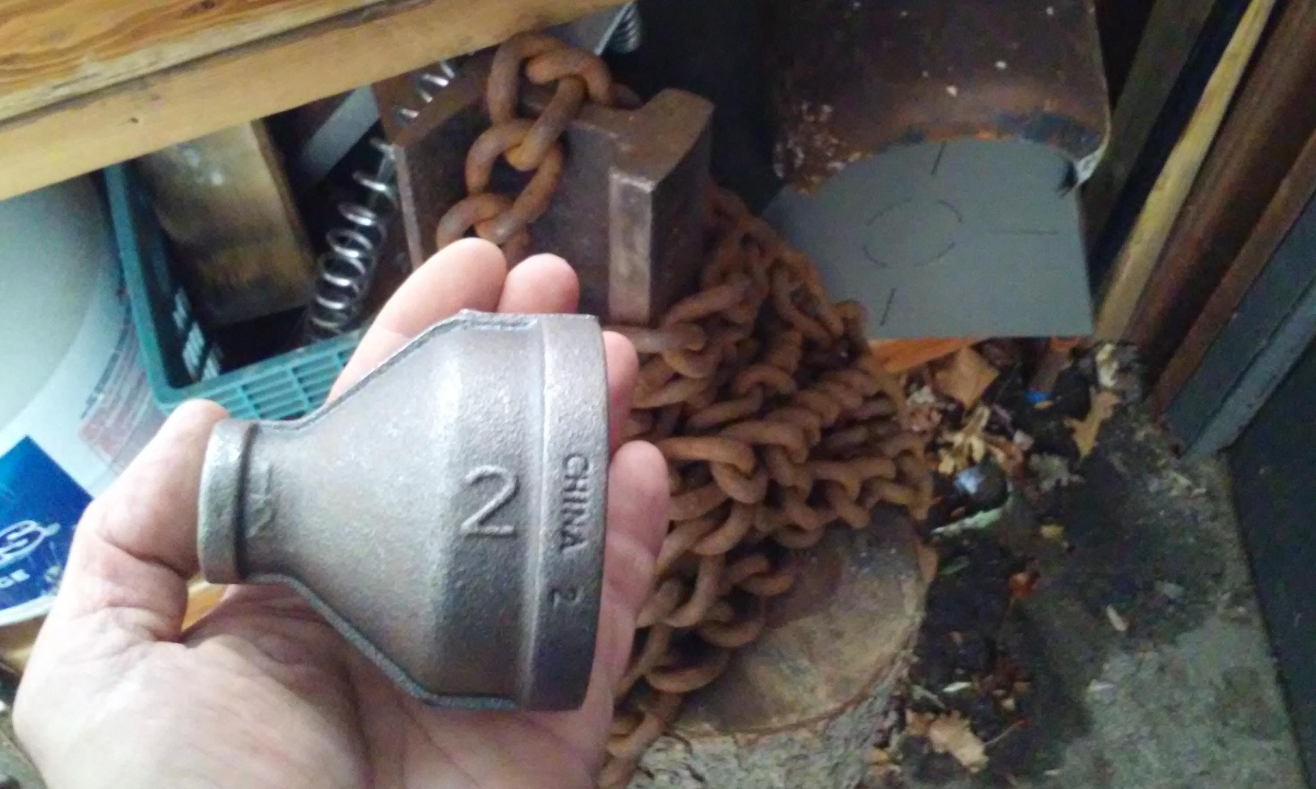

Also check out this reducer

I've seen burning duct tape. Why do you have your finger over an air intake, it's burning rich you know. If you can't get it to work below 5psi. then don't run it below 5psi. The purpose isn't to see who uses the least pressure it's about a HOT fire. Set your sights on what counts a reasonably neutral flame.  Hmmmm?
A 2" x 1/2"  reducer would make an excellent choice on a linear burner to feed your gas plate.

yea, i didnt explore its range as I probably should have to get a better understanding of what needs to be done. It seemed it didnt want to stay lit the more I cranked the psi. I used a 1/2" mikey the last time and it didnt backfire at the same psi if remember correctly. the sound that plenum chamber makes when it flashes reminds me of the soda can cannons i used to make as a kid.
I will give it more pressure and/or increase intake openings to create more induction?.  Im running a .025 mig jet.
That burner is a side arm burner.  The best I have seen for side arm are the modified side arm or the z burner.  Both use a larger fitting then the mix tube size for increased air inlets.  Even still, if you follow the link to the z burner page, you will see a rich flame.  A Frosty T produces a better flame with similar fittings.
You might try an 023 mig tip, it seems trivial but it makes a difference.
