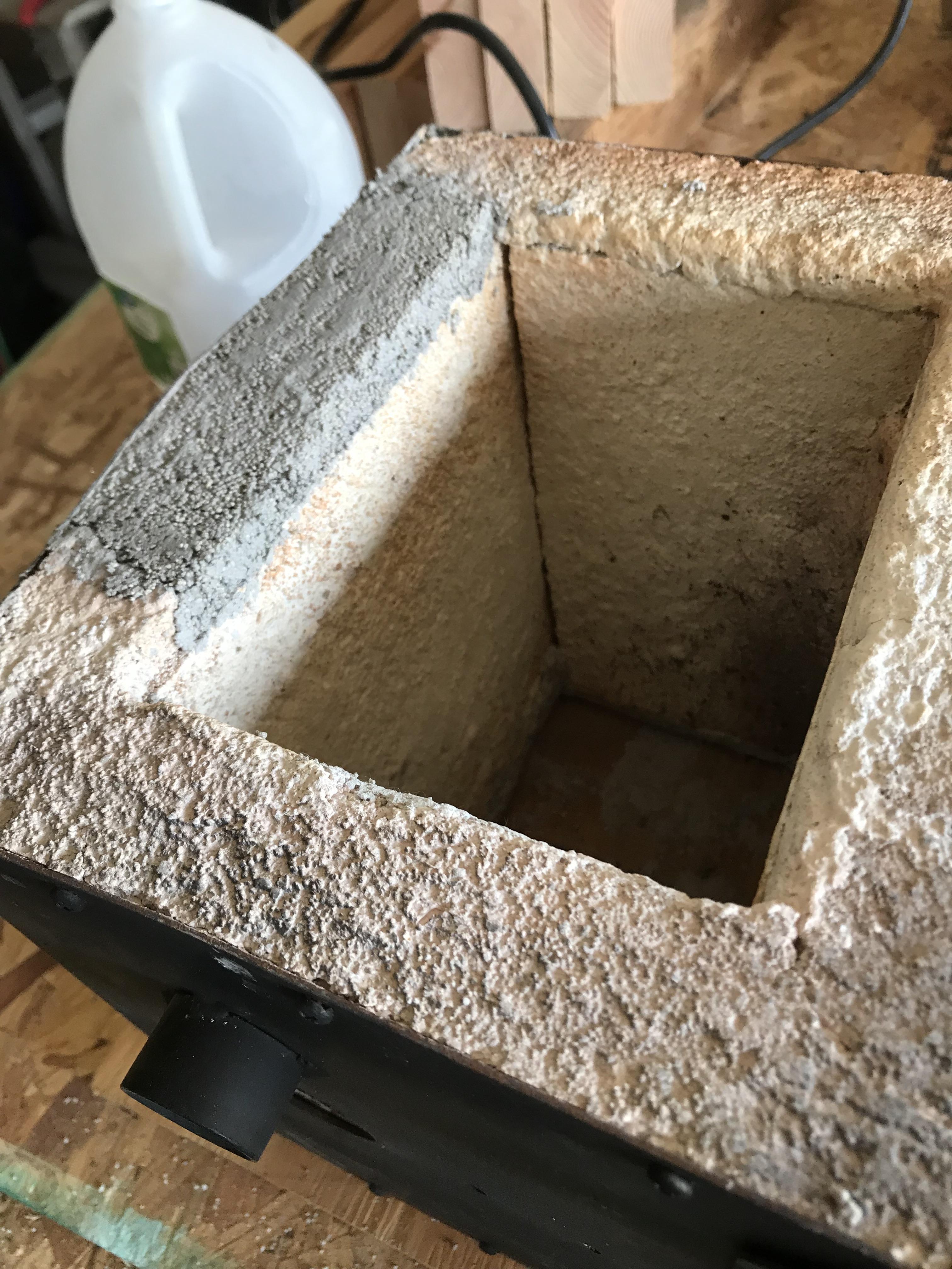

  1. Five years later and it still works. The pedestal is a bit clumsy and I managed to drop the forge from about tailgate height but it came through needing just minor repairs. In fact the repairs were to re repair the first patch and re do a bit of the other end. it did crack at the burner bur not seriously. So I suppose I can safely say the dog box travels well even at a high rate of speed in a vertical direction.
