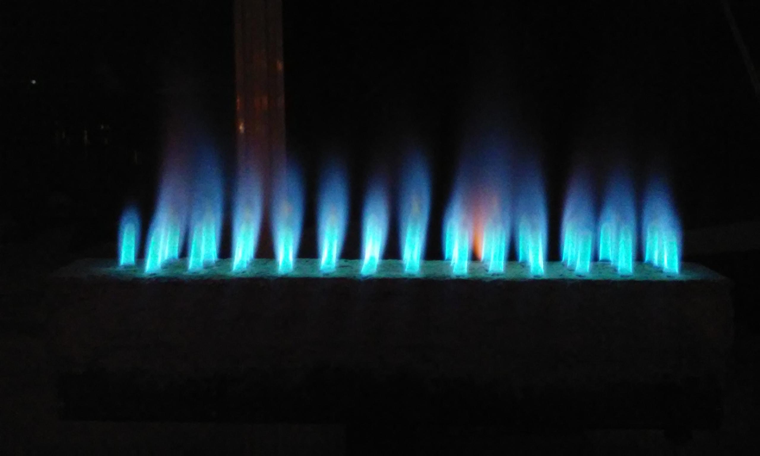

671jungle Posted January 25, 2019 Share Posted January 25, 2019 On 1/24/2019 at 11:28 PM, 671jungle said: Perhaps lengthen the choke slots (2"x3/8")? I remember reading anywhere past 2" length is waste. i forgot to mention this is the slot length now. looking at commercial ribbons and noticed a trumpet-like flare leading to the outlets im wondering if this helps even things out. I have also noticed trumpet-like intakes on venturis. Are these the most effecient ways to draw and distribute air? If so, a complete system would look like an elongated hourglass. Any thoughts on this? I was thinking of a stream with a leaf floating. As the leaf reaches a narrow choking point it speeds up and shoots through the narrow then slows as the opening widens. If I were to put a dam with a set # of holes some point after the narrow would this be the same way a NARB works? Quote Link to comment Share on other sites More sharing options...
Frosty Posted January 26, 2019 Author Share Posted January 26, 2019 20 hours ago, 671jungle said: The lift is happening when the jet is around 1/4" down the throat. Stabilizes around an 1" down the throat but is very candle-like and rich. When you say down the throat are you talking about putting the jet orifice past the air intake ports? Are you taking notes? did you note that the farther you inserted the orifice the more rich your already WAY too rich flame got? I know this isn't my burner and Mike uses a different strategy to tune but holy MOLY, PULL THE JET BACK! The farther the jet is from the throat the more air it will entrain. In the future when you're trouble shooting anything, make ONE change at a time and test. Pay attention to the results. If it makes things worse do NOT DO IT MORE! Frosty The Lucky. Quote Link to comment Share on other sites More sharing options...
Mikey98118 Posted January 26, 2019 Share Posted January 26, 2019 The tip end should rest 1/4" to 3/8" short of the forward end of the air openings for peak performance, depending on the individual characteristics of the burner. Quote Link to comment Share on other sites More sharing options...

671jungle Posted February 3, 2019 Share Posted February 3, 2019 So far: 40 coffee stirrer holes at about one 1psi starts to lift around 5. I'm hoping the back pressure of the forge will keep it steady. Probably not. I'm thinking 9 more holes will keep it steady throughout the psi ranges. The jet tip is about a 1/4" past the intake. I've played a bit with it's position, and this is the most stable and lean I could get it. I think refining the intake and increasing output ports will get it closer. Any thoughts on this? Much appreciated! Also the history in the stories y'all share are good reading. i forgot to mention this is a 1/2" Mikey ejector. Quote Link to comment Share on other sites More sharing options...

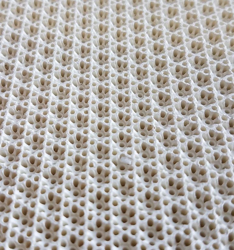

Another FrankenBurner Posted February 3, 2019 Share Posted February 3, 2019 An idea I had been rolling around to prevent blow back, use more smaller ports. It's less convenient to make but it would provide more cooling to the block. The block could also be shorter to maintain laminar flow which would mean less mass to cool. I have seen commercial NARBs which purposefully run the block hot for infrared heat transfer. They run a large orifice at a little over 1/10 psi through a stamped venturi without blow back. All of the commercial versions which I have dealt with have lots of very small ports. Here is a picture of the plate in one of them, it is 1/2 inch thick: I don't know if what I am thinking is viable so I wasn't going to mention it until I had played with it a bit but you all were talking about plenum pops. I also don't know how more smaller holes vs less larger holes reacts to pressure changes etc. It seems as much a balancing act as the NA burner driving it. My other thought was to 3D print a mold for the block which could add tapers or steps at the outlet to act as nozzles on each port. A question for Frosty, I thought that the purpose of zircon was to absorb energy, become very hot, and radiate energy. If I have that right, wouldn't adding it to the face of the block cause the block to heat more because it has a hotter face? Or did I misunderstand the function of zircon and it would somehow provide a shield in this case? Quote Link to comment Share on other sites More sharing options...
Frosty Posted February 3, 2019 Author Share Posted February 3, 2019 44 minutes ago, 671jungle said: The jet tip is about a 1/4" past the intake. The flame is blowing off the block because it's burninng rich. Mike and I have both told you the problem is your jet is IN THE MIXING TUBE. We've both told you to pull it back OUT, Mike even gave you specific distances. It wn't matter how many outlets you put in it, it's burning rich. 20 minutes ago, Another FrankenBurner said: A question for Frosty, I thought that the purpose of zircon was to absorb energy, become very hot, and radiate energy. If I have that right, wouldn't adding it to the face of the block cause the block to heat more because it has a hotter face? Or did I misunderstand the function of zircon and it would somehow provide a shield in this case? Good question. Zirconia absorbs and reradiates heat because it is a poor conducter. Like anything energy takes the path of least resistance so zirconia tends to radiate more towards the least resistance, open space, conducting heat through direct contact isn't it's forte. I don't know how close to the way it "really" works but that's my understanding and why I think physically backing it against a high temp reflector might make a difference significant enough to be worth the effort. Yes, I looked at commercial multiple outlet burners long and hard before making test burners. The problem being making such thin castings in a hobby shop setting. They aren't THAT expensive to just buy. I like to tinker though. Frosty The Lucky. Quote Link to comment Share on other sites More sharing options...
Another FrankenBurner Posted February 3, 2019 Share Posted February 3, 2019 That clears it up. I did not understand how zircon worked, just what it did for us. Understanding that it is a poor conductor explains the how. Thank you sir. I'll have to pick up a bag of zircon flour so I can play with it. Which reminds me, I was at the local Potter's Center, chatting them up about all this kind of stuff and he gave me an "ITC replacement formula" they had. He didn't know where the recipe came from. By weight: 2 parts Alumina Hydrate 2 parts 35 mesh Kyanite 2 parts Zirconium (Zircopax, Opex) 1 part Vee gum T or Bentonite Quote Link to comment Share on other sites More sharing options...
671jungle Posted February 3, 2019 Share Posted February 3, 2019 1 minute ago, Frosty said: the problem is your jet is IN THE MIXING TUBE. Thank you Frosty. I have pulled it out to almost the very end (furthest away from mixing tube). The flame leans out but is not stable. I think refining my intake will help induce more air, they are knife edged but could be smoother. just realized the mix tube is over length. 8", should probably be 4 1/2" ish? I must have some kind of mental block. Im really trying to understand the "hows" and "whys". Thanks for the input. Quote Link to comment Share on other sites More sharing options...
