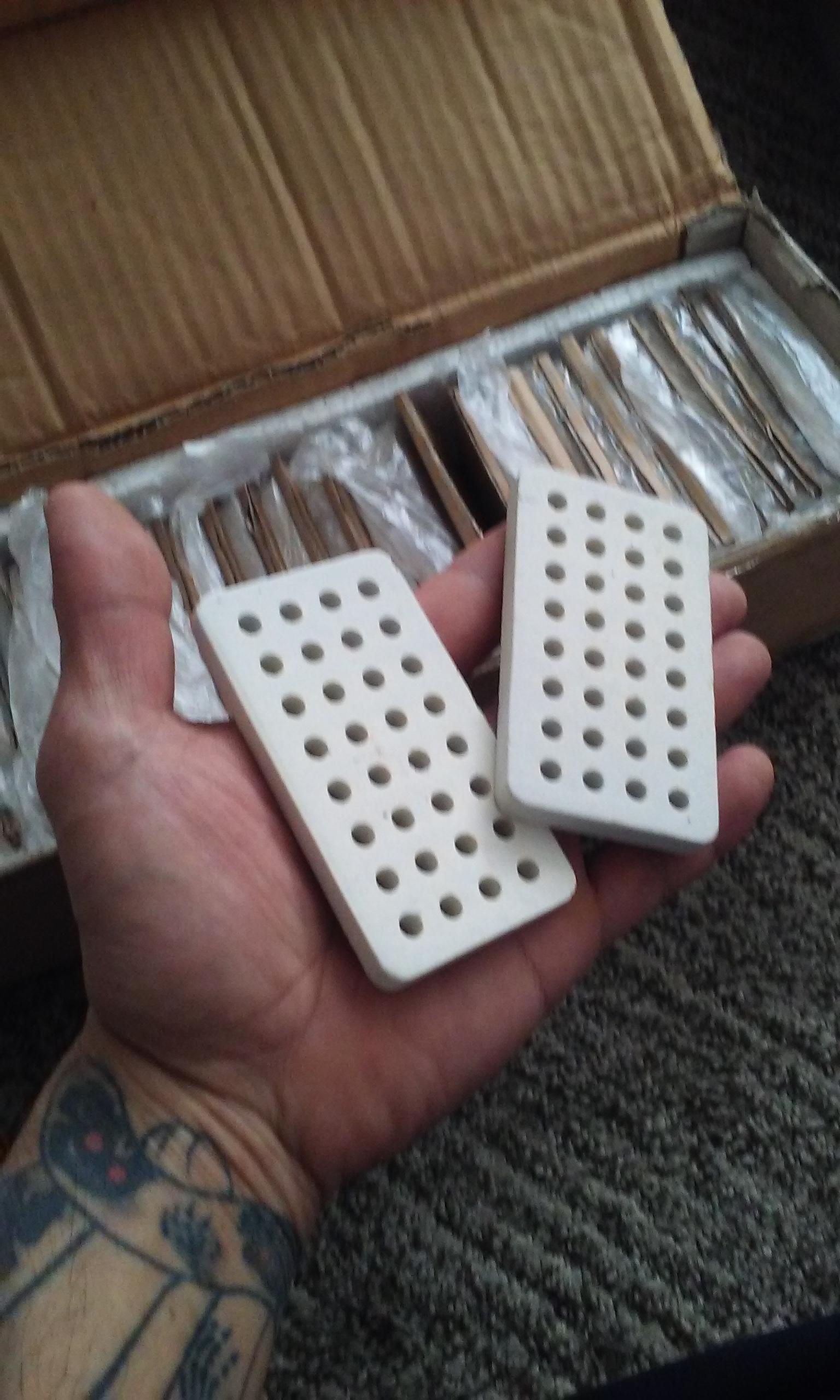

671jungle Posted December 31, 2018 Share Posted December 31, 2018 https://www.amazon.com/gp/product/B013H6PHE2/ref=oh_aui_detailpage_o01_s00?ie=UTF8&psc=1 these might be of interest Quote Link to comment Share on other sites More sharing options...
671jungle Posted January 1, 2019 Share Posted January 1, 2019 I ordered those Ceramic bbq blocks. I will fire test them in the forge and see how well they hold up before fabricating to them. It would be nice to have pre made flame faces. Im sure I will need to stack to avoid super heating and ignition in the plenum. But then again, I have no idea what I'm doing. Quote Link to comment Share on other sites More sharing options...

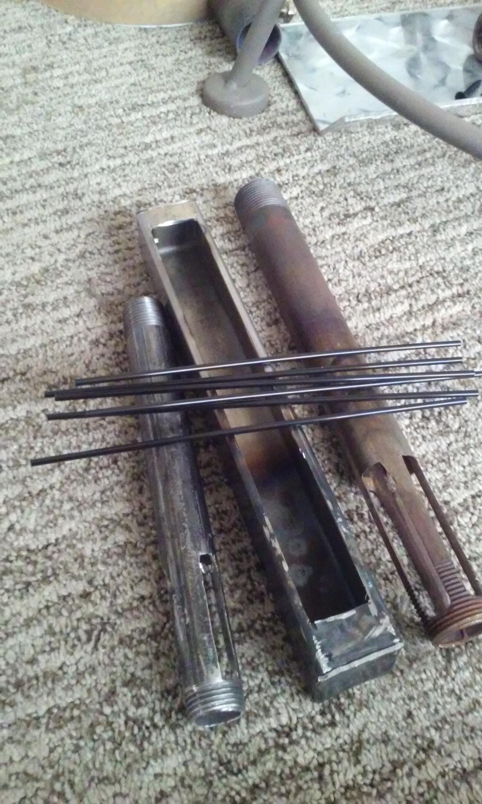

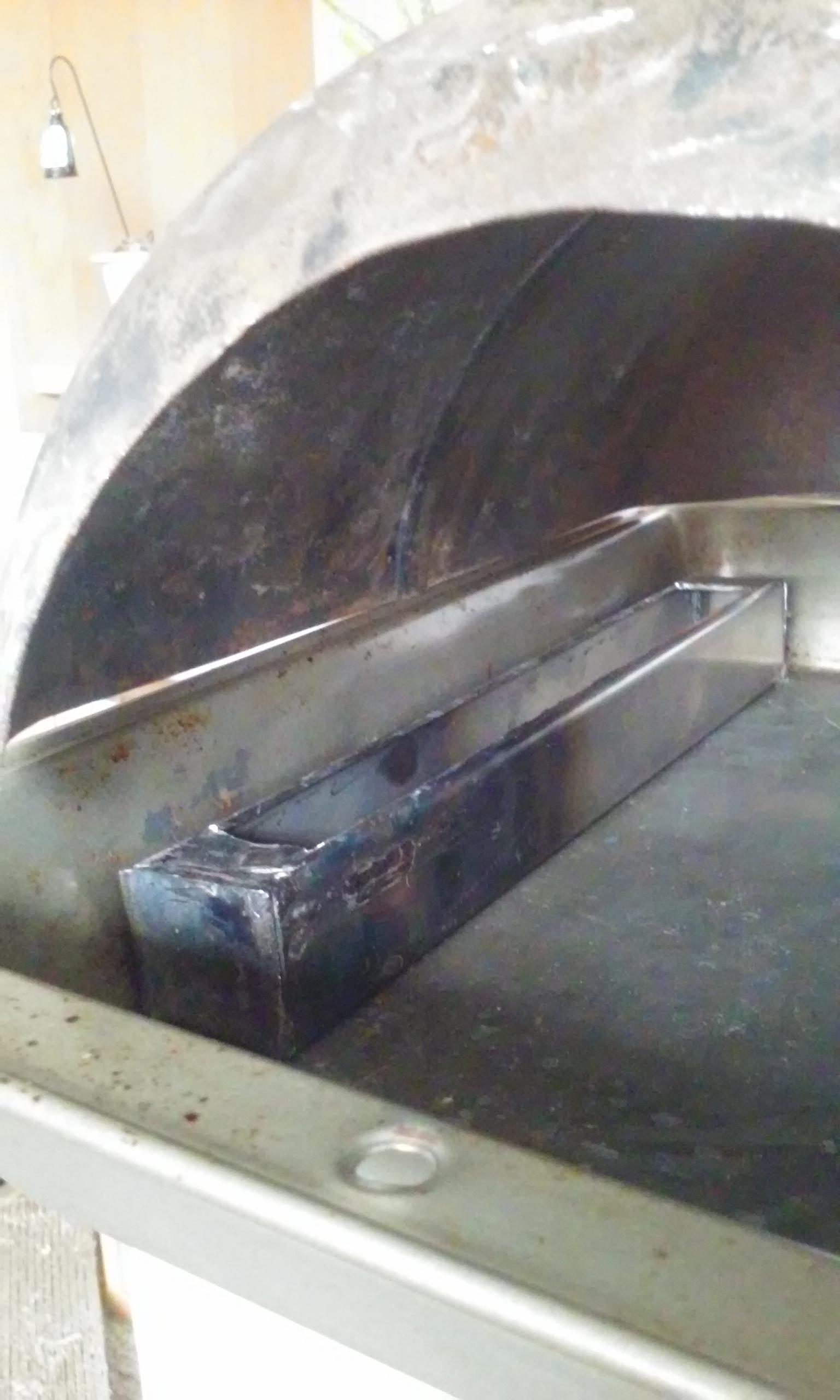

671jungle Posted January 9, 2019 Share Posted January 9, 2019 Put'em in the forge and brought up to yellow during a short session (about an hour). Took em out after cooling and still as hard as they were before. Stuffed a 1/2" sidearm with a plenum from a bag balm tin, glued all the seams with kitty litter and experiment test fired. It lit immediately and turned up to about 5 psi before backfiring. A little adjusting and got it roaring before the tin warped and failed. But results were already in! It works! Now for a design. I can't think of any way to secure the pre Made faces to anything other than making a mold and surrounding with kasto. Lol, might as well just cast an actual ribbon. But I have these and paid for them. Creative tank needs replenishing. Quote Link to comment Share on other sites More sharing options...

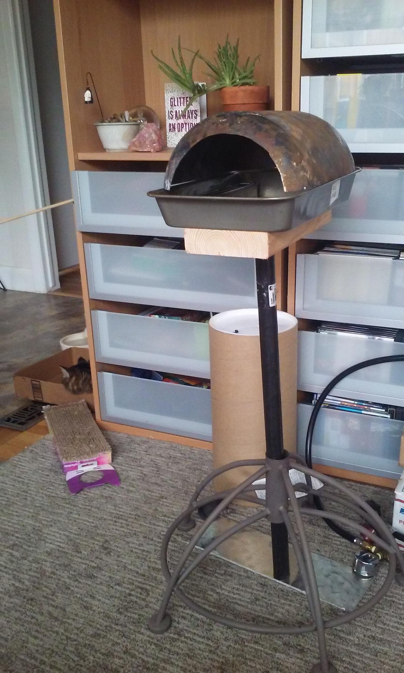

671jungle Posted January 20, 2019 Share Posted January 20, 2019 Ditching the pre made faces. Casting instead. Go figure Just wondering if the 1/2" burner will work with this 1 1/4" plenum. I plan on using stir straws for nozzle holes. I know it's a thing of ratios. How much space in the plenum is needed? I will use two 1" wool split with a layer of perlite rigidized in place and a thin layer of kasto 30 for the dome. A layer of wool covered by mostly perlite glued together with a little kasto for the floor. Any tips? Quote Link to comment Share on other sites More sharing options...
Frosty Posted January 21, 2019 Author Share Posted January 21, 2019 Sorry about the slow reply, my memory sucks. I think that's plenty of plenum but I've never built one that size. The thing is to have enough volume for the pressure to equalize over all the burner outlets. 17 hours ago, 671jungle said: I will use two 1" wool split with a layer of perlite rigidized in place and a thin layer of kasto 30 for the dome. A layer of wool covered by mostly perlite glued together with a little kasto for the floor. I don't understand what you're doing here. Is the perlite between the wool layers, between the wool and kastolite, or what? Why are you using perlite at all? It melts at just under 2,000f so if I understand how you want to make the floor it will fail pretty quickly. In part I can't tell in what order you're building the liner. From the shell in: wool, 2 ea. 1" 1 lb. Then 1/2" Kastolite 30 or equivalent. Lastly, Kiln wash about the thickness of two coats latex paint. I can't think of anywhere to use perlite. If you put it directly behind the hard refractory, Kastolite, it'll melt. The outside of the Kastolite layer is going to get almost as hot as the interior of the forge. Perlite doesn't stand a chance. I know Mike talks about where a person could use it but doesn't recommend it. Jerry Quote Link to comment Share on other sites More sharing options...

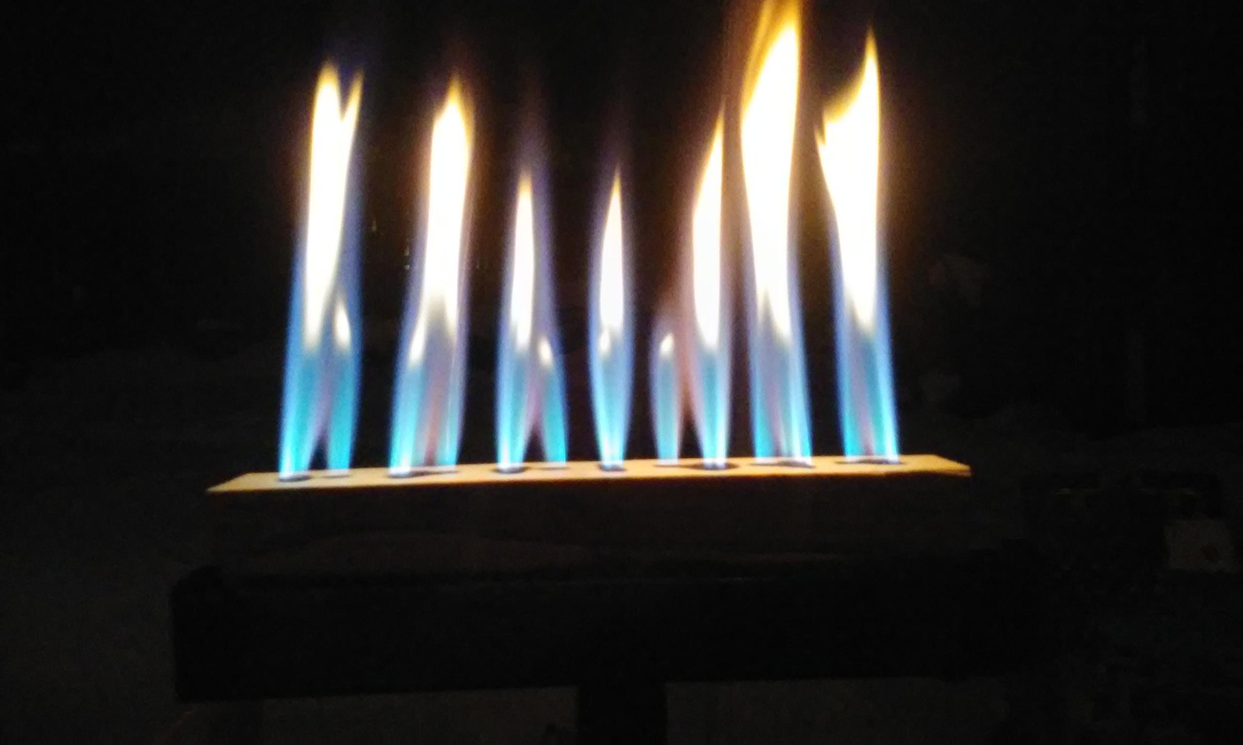

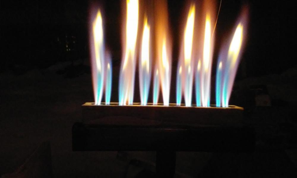

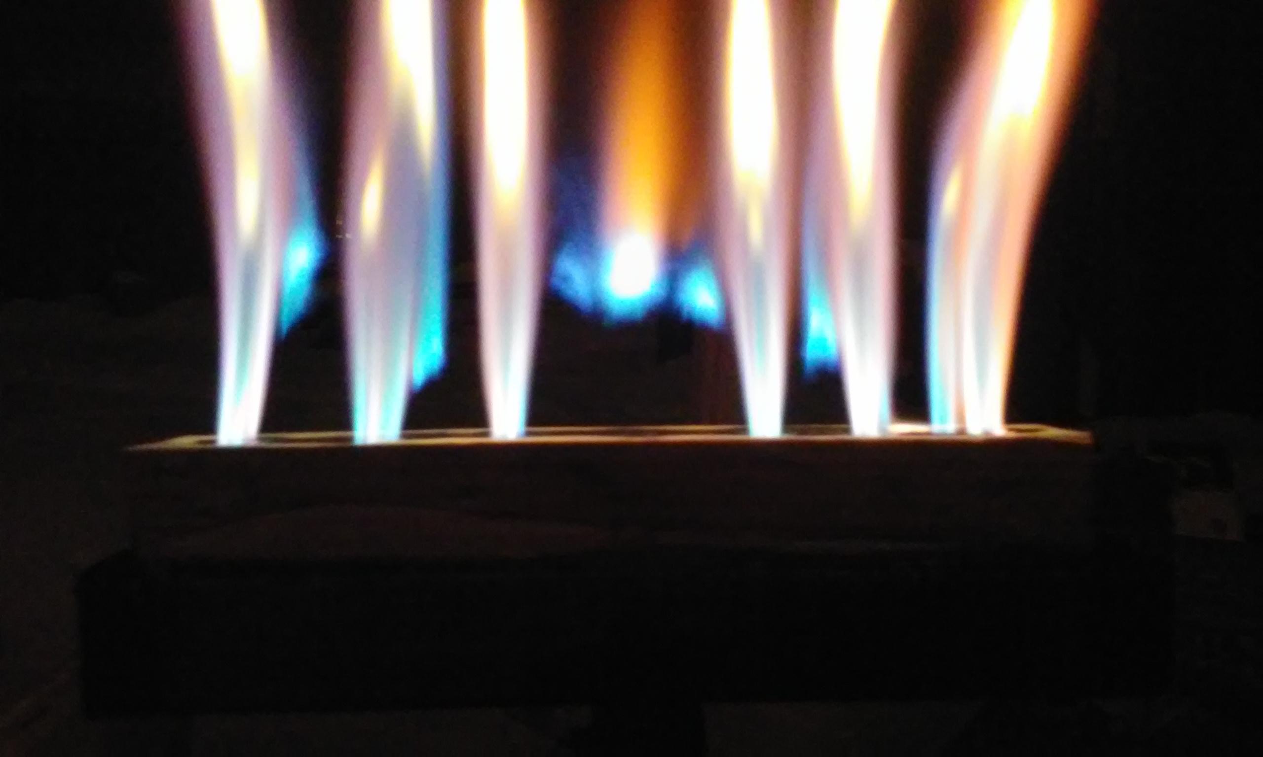

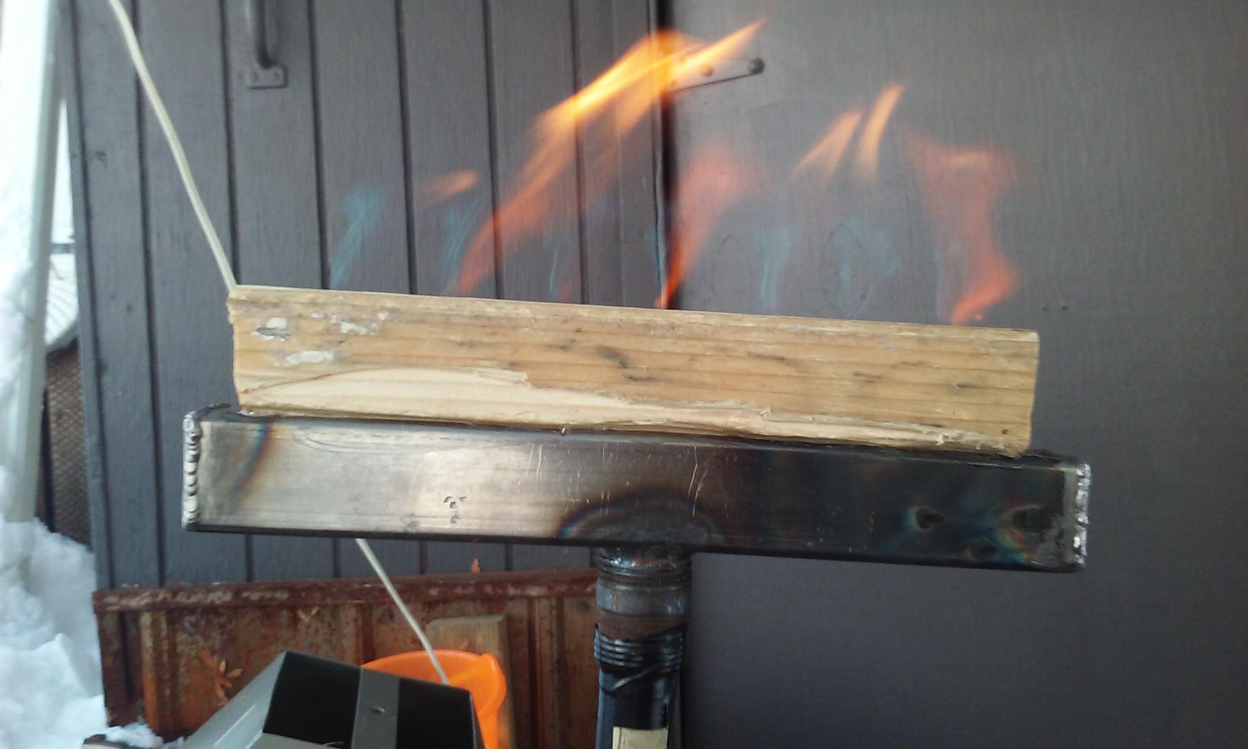

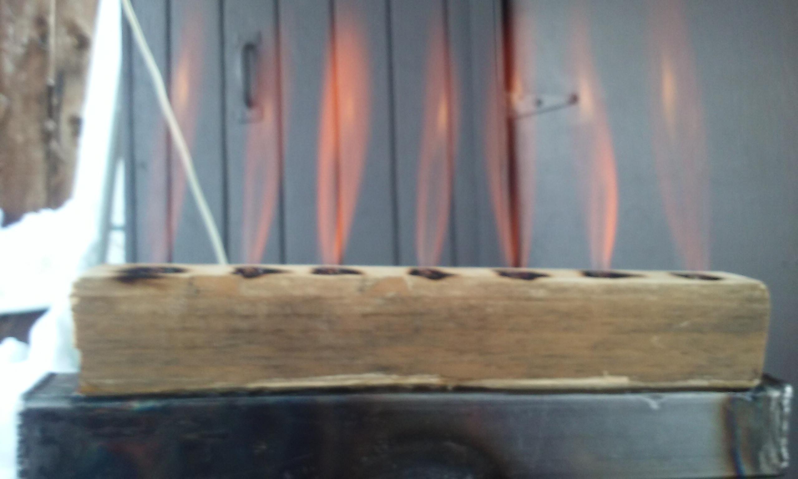

671jungle Posted January 23, 2019 Share Posted January 23, 2019 1st test block fired with 1/2" Mikey injector. Couldn't get it to roar consistently. (Induction issue?) Didn't backfire and was blowing out at higher psi ranges(5-10). 1 1/4" x 9"ish plenum 3x7 rows of coffee straw O.D. holes. One more row might do it without too much back pressure from the forge? I hope I'm understanding the direction I'm going about back pressure. 2nd shows those demented candles Frosty mentioned at the beginning of creation. Quote Link to comment Share on other sites More sharing options...
Buzzkill Posted January 23, 2019 Share Posted January 23, 2019 I used 14 holes of 9/32" diameter for my NARB which uses a 1/2" Frosty T burner. Unfortunately I have no idea how to calculate the number of holes of a particular diameter needed, so my general approach is to start with too many holes and then start plugging them until I get the results I want. If you're blowing the flame out at 5 to 10 psi my guess is another row could get you pretty close to where you want to be. I'm definitely interested in seeing where you end up because I was already thinking about casting the next one with more holes of smaller diameter. Quote Link to comment Share on other sites More sharing options...
Frosty Posted January 24, 2019 Author Share Posted January 24, 2019 It's not roaring, multiple outlet burners don't. Yours is running rich, the second pic is very rich. It needs more psi to induce properly and needs more outlets. The disparity in flame length might indicate it needs a difuser. More holes, more psi or open the choke. My wood block 0* inlet didn't have even flames either and led me to try the 90* inlet. The difuser I put in the 0* crossed the plenum about half way from the inlet. It was about 2"-2.5" "long". It evened everything out nicely though not completely. Buzz: I started with my best guess # and drilled more holes till it was right. Wood doesn't last long but you only need to see it burning a few seconds once you know the look. Frosty The Lucky. Quote Link to comment Share on other sites More sharing options...
671jungle Posted January 25, 2019 Share Posted January 25, 2019 Thanks Frosty. You and Mikes knowledge and experience has been critical in this project of mine and many others. Much appreciated. Used the same block but drilled seven more holes. One between each row of three. Seems to run a bit better. Still some lift when I try to tune the 1/2" Mikey. The lift is happening when the jet is around 1/4" down the throat. Stabilizes around an 1" down the throat but is very candle-like and rich. More holes? Or make the single holes slightly larger? Perhaps lengthen the choke slots (2"x3/8")? I remember reading anywhere past 2" length is waste. Anyway, this is fun stuff! Quote Link to comment Share on other sites More sharing options...
671jungle Posted January 25, 2019 Share Posted January 25, 2019 Thanks Frosty. You and Mikes knowledge and experience has been critical in this project of mine and many others. Much appreciated. Used the same block but drilled seven more holes. One between each row of three. Seems to run a bit better. Still some lift when I try to tune the 1/2" Mikey. The lift is happening when the jet is around 1/4" down the throat. Stabilizes around an 1" down the throat but is very candle-like and rich. More holes? Or make the single holes slightly larger? Perhaps lengthen the choke slots (2"x3/8")? I remember reading anywhere past 2" length is waste. Anyway, this is fun stuff! Also I am using a .025 jet. Smaller May be what is needed? Quote Link to comment Share on other sites More sharing options...
